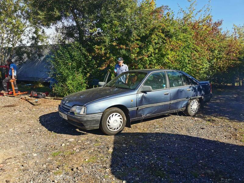

Today's extra joy is the Carlton saloon is running, sort of!
Definately sort of...

Great to see the Carlton now running - was it just that leaky pipe that needed sorting in the end?  I reckon it would have gone last time but I stopped when I could smell stale petrol!  Hopefully the smoke will clear once it's been run for a bit, unless it has other issues.   It's a smart old thing, dents aside, and deserves to go again.
I replaced the leaking fuel pipe but it still didn't want to start. Then I found a wire with a connector on it which wasn't plugged in to anything. Consulting with@Andyrew, our resident Vauxhall guru, who fortunately was at the FoD and actually used to own this beast, produced the matching loom and connector, which apparently goes to the crankshaft sensor. This was plugged in and after a fair bit of cranking it fired up. The clutch was a bit sticky but eventually it was mobile. The initial blue smoke turned more to grey as it warmed up. It was a bit tricky to drive as it refused to idle and kept stalling. We did discover that number 3 plug was actually loose, but tightening it up did not seem to improve matters much. The oil in it looked very clean, but also very thin. Maybe a change to some thicker stuff will reduce the smoke output. More investigation required I think.

the Carlton only had a minor* smoking problem, Mmm burnt engine oil and stale fuel...

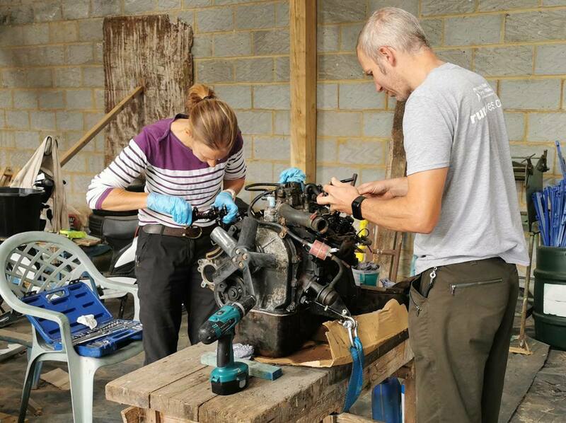

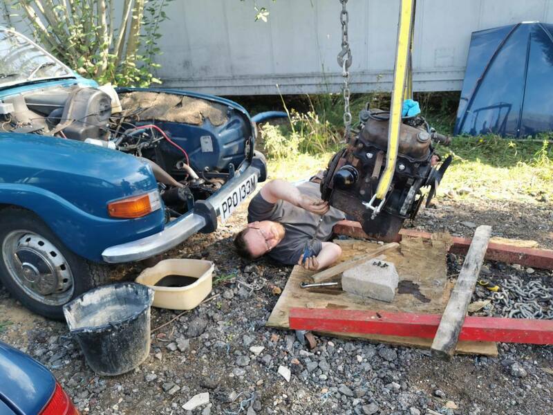

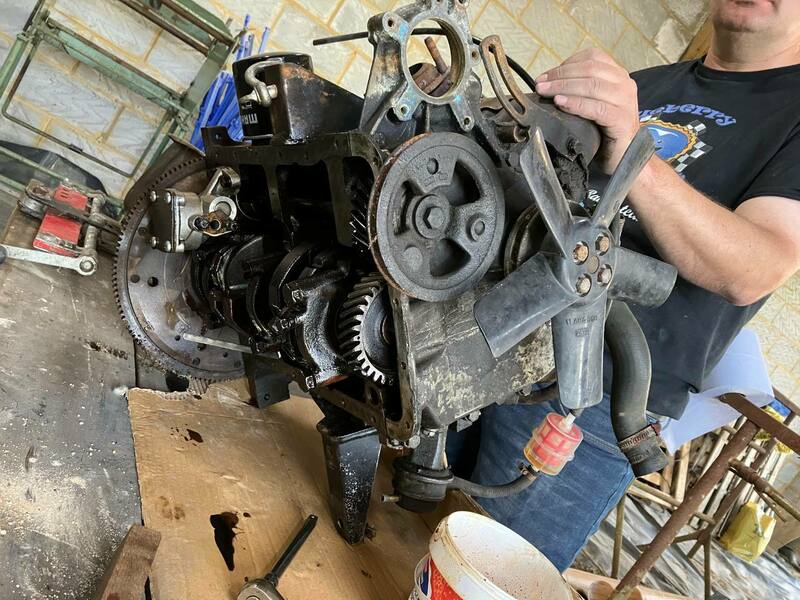

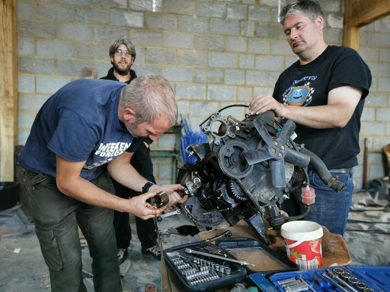

So how did the Saab 95 engine end up?
We got it out on Saturday even though it was surprisingly heavy for a 1500cc engine. There was gunge in the bottom of the sump that we cleaned out. We took it in the new barn and took a main and big end bearing cap off furthest away from the oil supply and all looked well. We took the oil pump apart and that seemed just fine.
Sunday we put a bore scope in the plug holes to reveal some light scratching but nothing to make it rattle. I then took the decision as we had found nothing to lift the cylinder heads. Yes we had a husband v wife race to see who could get there bank apart first!
All we found were heavy carbon deposits but still nothing to make it rattle. I think I will take the pistons out next.
