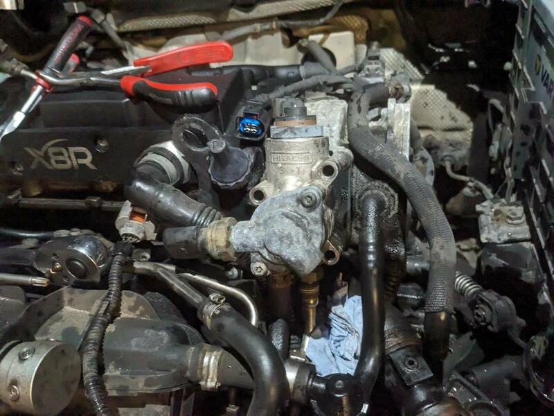

SiC Posted February 10, 2024 Author Posted February 10, 2024 Noticed this on the wing mirror glass earlier. At least I now have evidence it definitely has been welded rather than fibreglassed! My Amazon parcel arrived today with a few bits including the cam follower. Basically the cam follower is a bucket type shim that rides between the intake cam and the high pressure fuel pump plunger. These have a special coating on to resist wear. Unfortunately that coating simply does not last and ends up wearing through. When that happens, the pump plunger rides against the cam and both get destroyed. Over the years VAG and their suppliers have tried to improve the life of the coating. However they have never completely solved it. On later engines their solution is a roller tappet which solves the problem entirely. That can't be retrofitted to the older engines and so these are just another in a long line of consumable VAG parts that shouldn't be. Thankfully it's not that hard to get to. First job is to remove the engine cover. On these engines it houses the air filter and MAF. The air filter looks in excellent shape and not that old. Very good sign this has been serviced regularly. Not sure what the date code is on this as I can't remember which bit is the Bosch magic code that you need to convert into a date. MAF is genuine VW and looks to be a date code of 2013. So not original factory item and a quality item. With the cover off, something interesting was quite obvious. This is a PCV delete kit. It keeps the cam cover connected to the crank case (which happens under boost normally) but stops the manifold sucking a vacuum into the cam-cover when at idle. I'm not sure about this and extremely tempted to put back to stock. After all, VAG are cost conscious company and they wouldn't design+make something if they didn't have to. It does also suggest this car has been worked on by an enthusiast and/or a specialist. The fuel pump has three torx bolts. You need to be exceptionally careful to not round the heads off. Otherwise you're going to have a bad day. This connector is broken and suggests someone has been here before. In getting to the fuel fitting on the bottom of the pump, my hand pushed against a coolant flange. Naturally the old, brittle, shit VAG plastic snapped right off. Balls. Thankfully Bezo and his team of minions can get a replacement out to me tomorrow. For now I've deleted that hose with a screw and superglue. Sealing it and making the area cat and wildlife safe. With the bolts out, the pump pulls right off. I couldn't easily get to the hoses on the bottom of the pump, so I decided to play it safe and not disconnect them. Here is a new cam follower on the left with the old cam next to it. I think the words just in time come to mind! The protective coating has entirely worn off and just relying on engine oil to not destroy the cam and pump. The cam is completely undamaged thankfully. Tomorrow I'll get that flange replaced and give it a run. FakeConcern, Joey spud, rainagain and 8 others 11
SiC Posted February 10, 2024 Author Posted February 10, 2024 This is the main stages of wear these cam followers have. Thankfully this was between Stage 1 and Stage 2. If the cam started eating into the metal then it'd also be eating the cam up too. Plus metal shavings being deposited into the oil system too.

Popsicle Posted February 11, 2024 Posted February 11, 2024 17 hours ago, SiC said: This is a PCV delete kit. It keeps the cam cover connected to the crank case (which happens under boost normally) but stops the manifold sucking a vacuum into the cam-cover when at idle. I'm not sure about this and extremely tempted to put back to stock. After all, VAG are cost conscious company and they wouldn't design+make something if they didn't have to. I've fitted a few things made by X8R over the years, it tends to be well designed and well made stuff - they're a good company for fixing common faults on vehicles, might be worth leaving it in place, it does read up well. https://x8r.co.uk/pcv-valve-delete-kit.html Joey spud 1

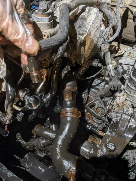

SiC Posted February 12, 2024 Author Posted February 12, 2024 With the Merc E320 out of action, the TT sold and this broken, I don't have a working car for myself. This will mean I'd have to catch a bus into work. No thanks. So instead of the gym, I need to do some evening repair action and allow me to get to the office tomorrow. To be honest replacing this flange was a piece of piss. Clamp the pipes to reduce coolant loss, three hose clamps and replace. I didn't replace the o-ring on the high pressure fuel pump when I did the cam follower. I forgot to order one and so didn't have it to hand. This is a decision I regret. I ran the engine up tonight and it doesn't show up a leak but I really should have changed it as it was all flat. I've ordered a new one and should be arriving tomorrow. That said, as it's not leaking, I'm tempted to leave it now! Risky to keep removing those HPFP torx bolts. Speaking of oil, it says it need a service. However not only is the oil quite clean looking, it's actually on the full marker! I don't believe it is really due a service as any TFSI showing full must have been recently had it changed. Can't possibly be the case it doesn't burn it nor is it not leaking. 🤣 I've got a tub of oil, a filter and sump plug in the garage though, so I will do it soon. Might as well get a few miles under it first. Took the cambelt cover off. All broken up unsurprisingly as it's probably been off several times in the cars life. The belt is still there at least. I mean it's obviously worn and I don't see any writing on it. However I don't really know how to judge it. I know it needs doing but is it imminently needing doing? Was a right arse getting that cover back on with everything in the way. No wonder it's broken already. After faffing around with that, I took it for a blast. Pez shot. I put the good stuff in. It's probably feeling spoilt as I bet most owners don't bother. I won't likely long term, especially commuting but right now I want to make sure she runs sweet as a nut. Full fat stuff will mean it'll not be retarding the ignition at all from knocking and should be giving me the full rated power. Pumped up the tyres and gave her a good blast. Certainly is boosting absolutely fine. Enough that flooring it makes the front Avons scrabble for grip. I do miss the hard bite that Quattro (including Haldex) gives. Coming home I checked the coolant temperature with my cheapy code reader (my nice one is in the Merc still). Appeared to be perfectly okay. This is good as the thermostat is a nightmare on these to change. Also a good indication again that someone has spent money on this car as ime thermostats most people don't realise or notice need doing. Cooling fans didn't kick in but did previously on the drive home. They're really loud and sound to be on full. Apparently this happens if the small fan stops working and the fan controller puts the large only ever onto full speed to compensate. I'll get my VCDS out and do a check at some point to confirm. That can be done when the cambelt is done. At least it's working - even if a bit embarrassingly noisy. I need to check the engine number as it feels too healthy for a 198k engine and I can't help wonder if it might have been changed. It could just have been looked after and done mostly motorway miles too. Steering and gearbox feels tight. I can't decide if the gear cables look new. They don't look particularly dirty. Steering creaks a bit of you dry steer but iirc TADIS with the electric steering rack on Golf. VW said it's normal and didn't accept any warranty claims for it creaking. Brakes grab hard - typical modern over boosted setup. But discs and pads look fresh too. There is a intermittent rubbing noise from the rear when braking, so I need to double check that's all okay. Offside rear has been replaced in its life, so maybe the nearside rear has started to fail from age too. I've also been looking at track days. I definitely want to do one and I think this would be a good car to do it in. Respectably fast, great handling and steering feedback and decent safety if I make a big mistake. It's cheap enough that it'll be annoying if it break it (crash or blow up) but not a huge sum to loose. Thinking maybe this track is a good one for my first as not far away and doesn't look too fast: https://www.llandow.com/ Castle Combe is the nearest track near me but that I know is a notoriously fast and unforgiving track. I even remember my boss in my first job out of school (gap year) telling me that he stacks his not very old MGF into the tyre wall and quickly learnt what brake fade was. Before then though, I want to get a few miles under the wheels and make sure everything is golden. The mix of Falken and Roadstone (or whatever it is) on the rear will need sorting. Likewise prudent to change that cambelt if I'm going to be driving it really hard. Weather can warm up a bit first before I do that though! Short term I really want to fix that headlining. Also a bloody good scrub inside and out. GrumpiusMaximus, Back_For_More, wesacosa and 11 others 14
