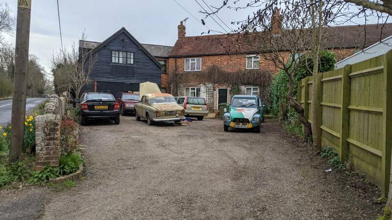

Ah I didn't realise this was an AS car (I was parked next to it in the C class).  Would have said hello. glad it made it
The W210 the other side of you was Talbot from the forum!
ah ok, sorry for pinching the spot between you both @Talbot @juular. I had assumed as it was a sell out and each place would end up full and seemed a good idea to park next to a similar era Merc but hadn't realised both your cars were together
The space just happened without any particular intent. Glad to have an AS representative next door.

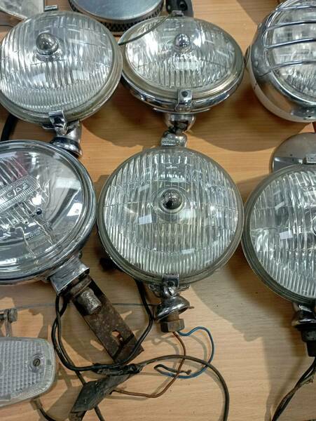

Enjoyed the autojumbles, perhaps a little too much as we came home with a set of four Lucas driving lights.

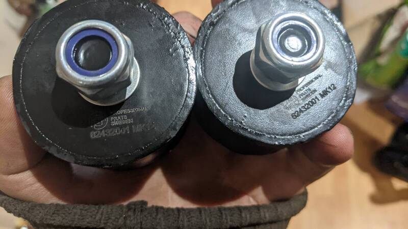

To round things off, when I got home I had a nice surprise waiting in the form of a Professional Prat.

Feels like Christmas, and Rally Santa has been.
What's more, he's left me a pair of Prats this time.

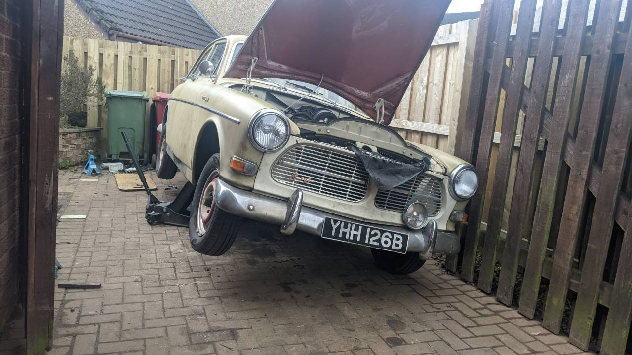

Started on the upper wishbone bushes as they started being quite loose after Rustival.
Value for money has been fully extracted from these.
Those were so knackered I just poked them out with a finger. Absolutely shagged.
Poly bushes back on.

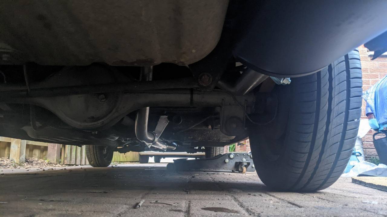

Next up will be to polybush the rest of the car, and fit the new exhaust, which should sound a little bit like this.

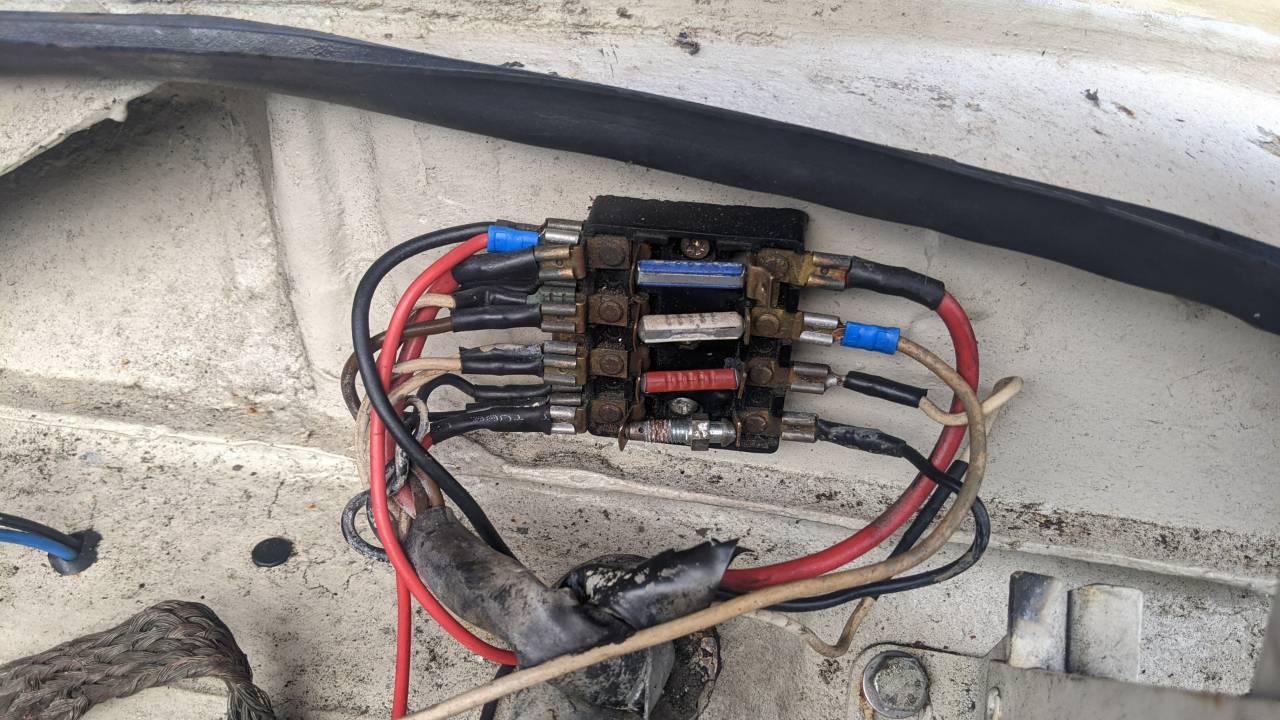

Some more stuff tackled. Trying to keep in my head all of the things I thought about fixing while on the Rustival trip. Writing notes? How quaint! Just stay awake at night trying to sift through jumbled thoughts until 3AM.
It would probably be good to sort out the broken headlights.  Brief recap. A few weeks ago I fitted a latching relay which allowed me to control the full beam entirely through the flasher stalk instead of the antiquated floor switch. This worked brilliantly until it didn't.  Turns out that £3 of Chinese "INDUSTRIAL CONTROL" electronics aren't suited for, you know,  anything.  So the PCB basically melted (it wasn't even carrying notable current).  Before the Rustival trip I simply reinstated the floor dip switch to get us on the road.
Turns out I wasn't wrong to try and get rid of the floor switch because as soon as it got dark, I went to switch between main and dip on a dual carriageway and lost all headlights. We pulled into a layby, consulted the wiring diagram, and crimped a couple of wires together so that we had headlights (but no mains).
Time to fix that permanently.
The solution here is to use a 'proper' relay, in this case one designed for an old VW bus / beetle. The relay number is DNI 0127. There are also Meyle and Durite equivalents, so they are easily come by.
Step 1, remove floor switch and hurl it into the depths of the garden.
Step 2, crimp spades on the end of the wires to the floor switch.  Also tee-solder the smaller red wire into the bigger one, as that's more structurally sound than crimping two wires into one spade.
Step 3, RELAY
Here is the pinout.
And here is what that looks like in real life.
Step 4 : Replace the fuse you blew because you forgot to disconnect the battery, and touched the permanent +12V against the metal dash. Oh wait, there's no continental fuses left..
So it turns out this lighting setup is even better than the one I set up previously with the INDUSTRIAL CONTROL relay.
- When the dipped headlights are off, the flasher stalk operates as a main beam flasher.
- When the dipped headlights are on, the flasher stalk toggles the main beam on and off like a modern car.
- The relay also serves the purpose of being a relay for both the mains, flasher and dipped.  So it takes away the load from the light switch, provides full current to the headlights (brighter!)  plus it means I can remove the flasher relay and wiring in the engine bay as it is no longer required.
So far this seems a far more robust and efficient setup, time will tell.
Engine and gearbox mounts replaced.  The gearbox one was particularly hanging and the propshaft was bouncing off the bottom of the transmission tunnel.

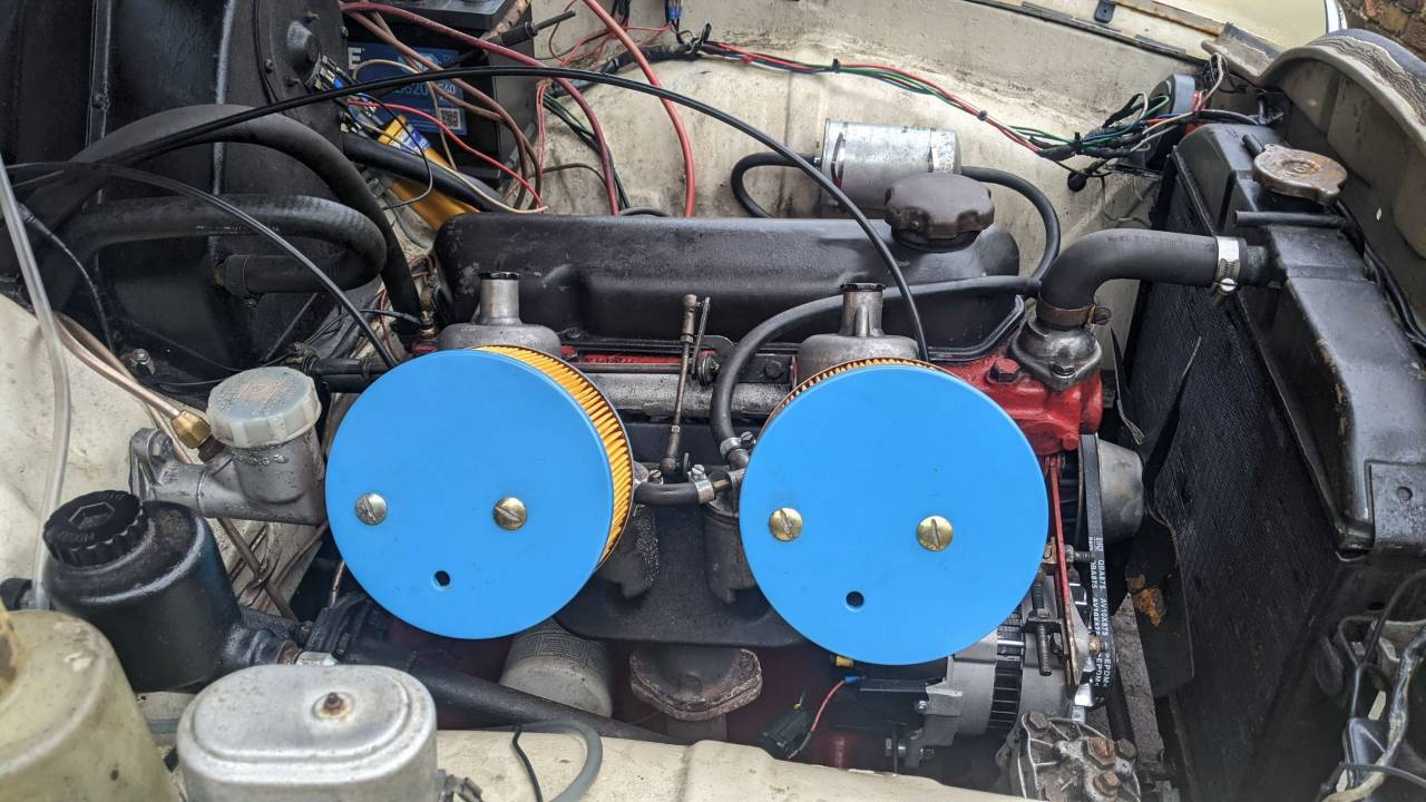

A set of high performance air filters attached.  The purpose being twofold. The generic SU HS6 pancakes I had on would sometimes smack against the clutch master cylinder reservoir on hard cornering or acceleration.  I also felt they were strangling the engine as they were so thin and miserable looking.  These by comparison are offset specifically to fit the Amazon, and are significantly more chunky.

Test drove this and was quite impressed.  The wishbone poly bushes have sharpened up the steering a fair bit. The engine and gearbox mounts have changed the gearshifts significantly, and overdrive seems to snick on in a much more dignified fashion.
A little bit of the induction roar from the pancakes has actually disappeared, but it still sounds great when opened up. I'll take it.
Next up, I'll be fitting the sports exhaust, more polybushes, and doing a number of electrical upgrades to make it more reliable.

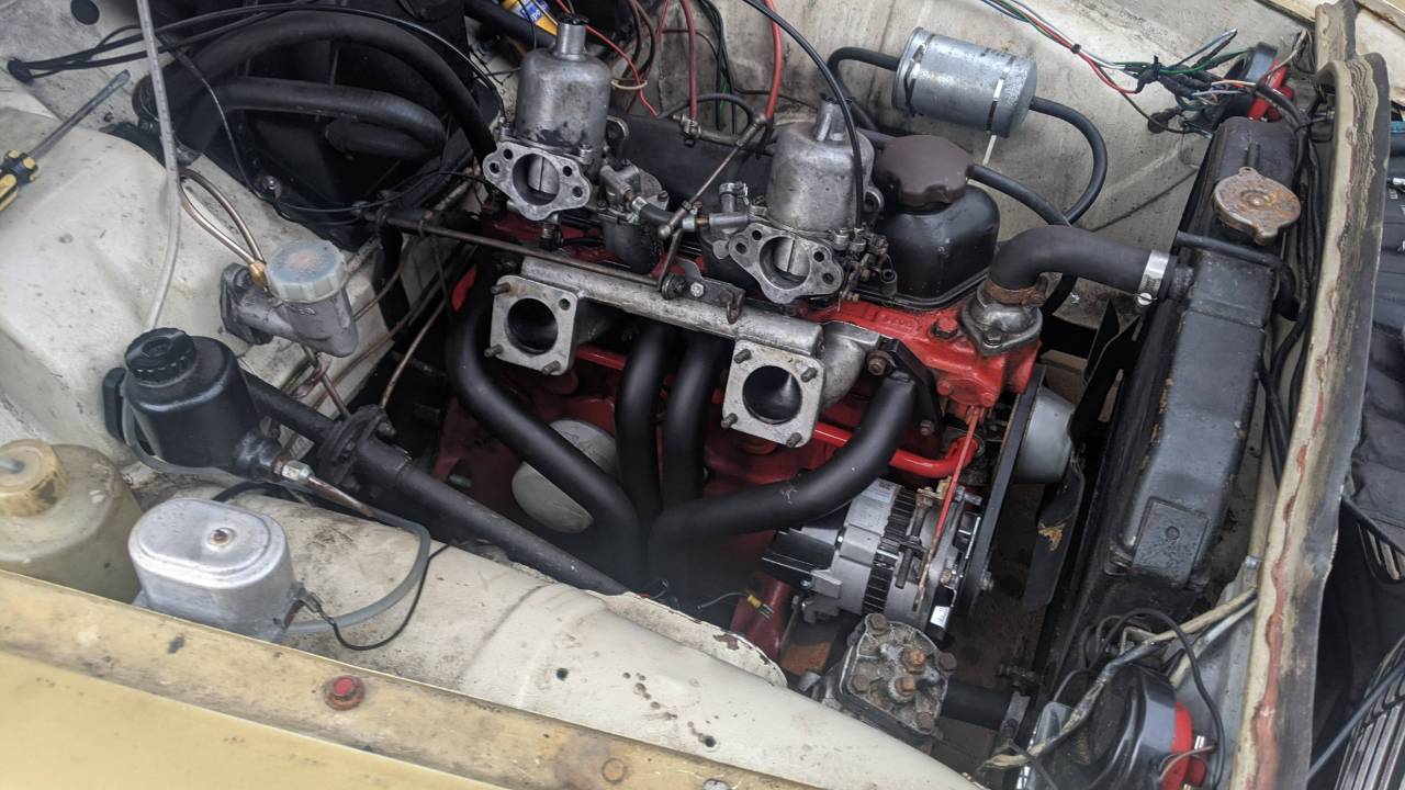

Begone, pea shooter.
Had to retap one of the threads on the head as idiot here used a wrong thread pitch manifold stud off another car.
CHONK PIPE
It won't start now as I've fucked up the idle screws and choke position, and it got dark. So I'll have to wait till later to annoy everyone.

Feels like it's added 30bhp, breathes so much more freely.  Not noisy either.
