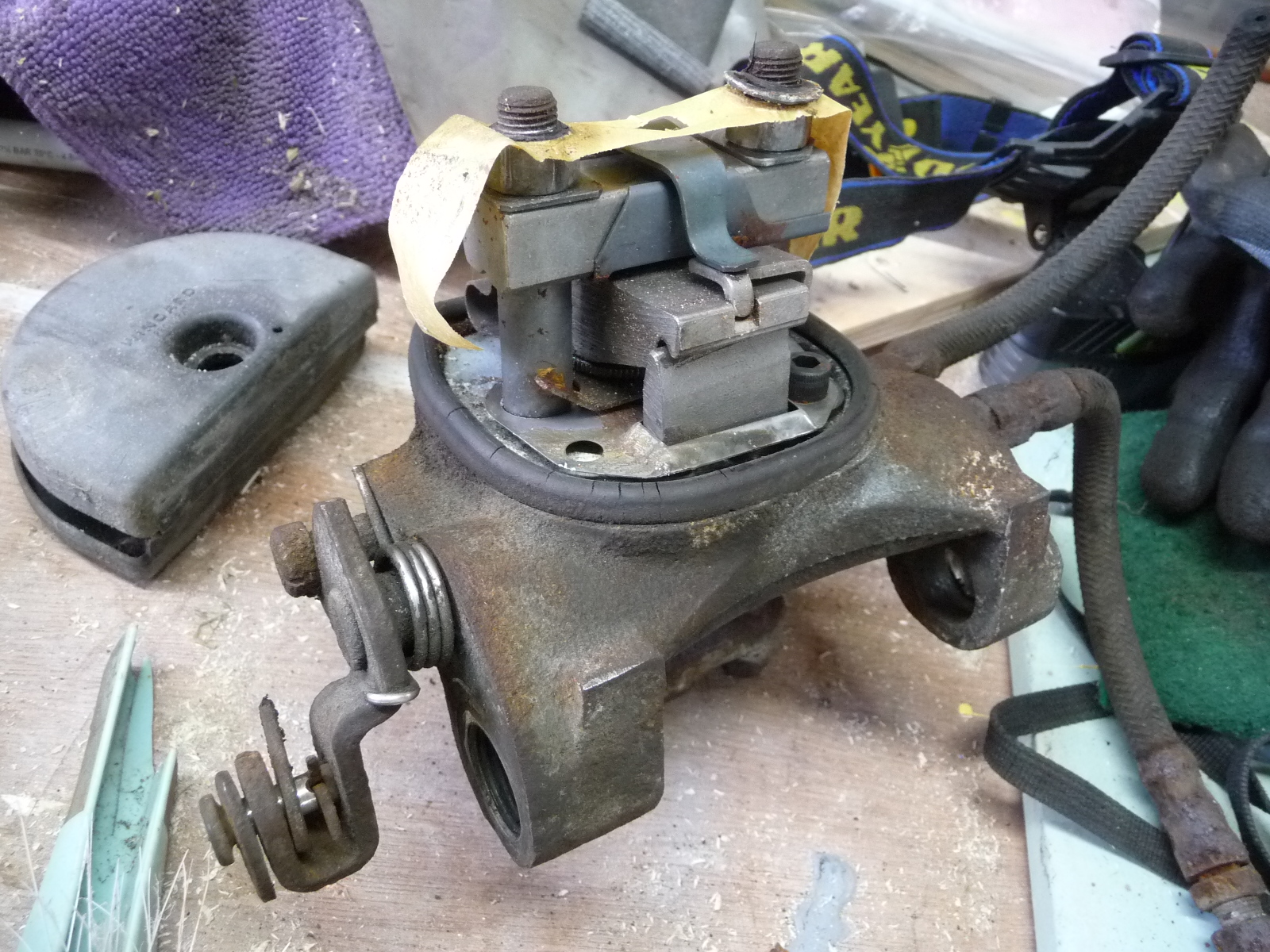

Angrydicky Posted August 11, 2021 Posted August 11, 2021 5 hours ago, Mr_Bo11ox said: Then I had a brainwave when I realised that the main piston is not actually hydraulic at all!!! its the little one on the left of the X-section that is, that must be the one that PP resleeve. So actually, those miserable looking pistons will be perfectly OK after all. I will just clean them up as best I can and chuck loads of vaseline over them to protect them. Yes, this is correct. It's only the small piston bore that gets resleeved. They used to recon these calipers all the time, but JR Wadhams (I think) sell exchange ones cheaper now so people don't send old units in anymore. Had some lovely new splined adjusters made for them, as the teeth are often stripped, now they're just sat on the shelf gathering dust! This is an absolute barg, check out the bench seat! You'd feel on top of the world wafting around in that, burning up vast quantities of petrol. Much more interesting than a P6 and on the rare occasion you do see a MK4, it's always a Zodiac; the Zephyrs don't seem to have survived very well in comparison. Joey spud, Snake Charmer, R1152 and 4 others 7
