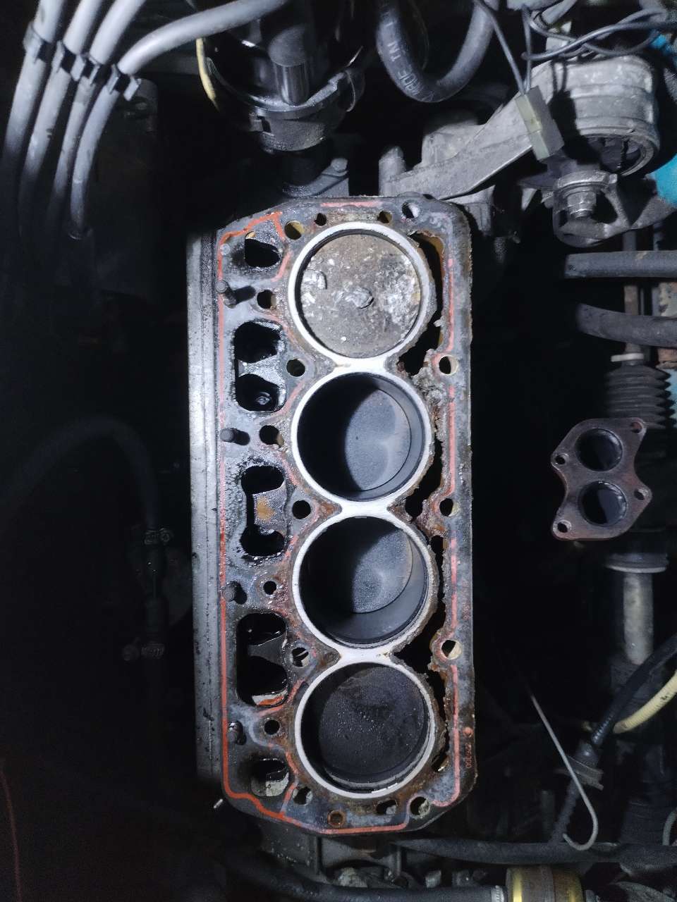

How can an apparently simple job go so catastrophically wrong?
I shall put the full run down in my own thread at some point but at the moment I just can't sum up the enthusiasm.
The exhaust manifold started blowing on blue (standard) Favorit. I wasn't sure if it was manifold to head or manifold to downpipe but it looked an easy enough job to take it off and do both.
First thing that went wrong was two of the studs in the head snapped when I tried to undo them. So I thought I may as well get new studs for the whole head and while I'm at it I may as well get new nuts.
Long story short, having new nuts meant I didn't notice one of the old ones was missing. Put it all back together, started it and there was a nasty mettalic rattle from inside the engine.
I think we can see the problem. IMG_20241213_155205.jpg.2250be62f5cb3cdbed1452ba75e0c67a.jpg
Do you want to look a little closer?

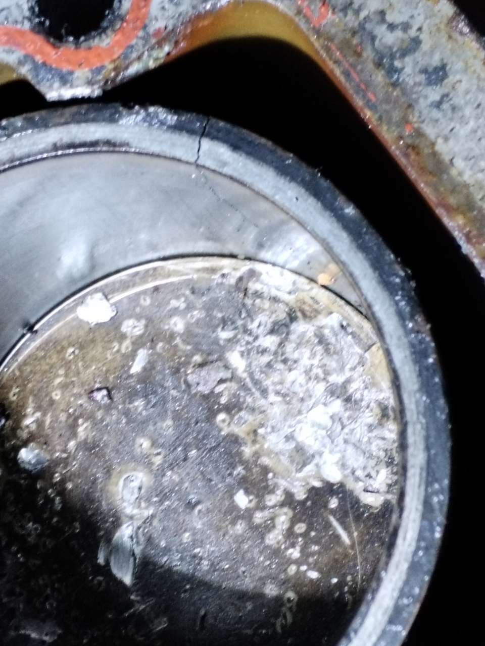

As you can see here, the piston is near the top of its stroke so I thought I'd turn it over and see what state the bore was in. It still looked okay until I started cleaning it up.
Well that's fucked then.

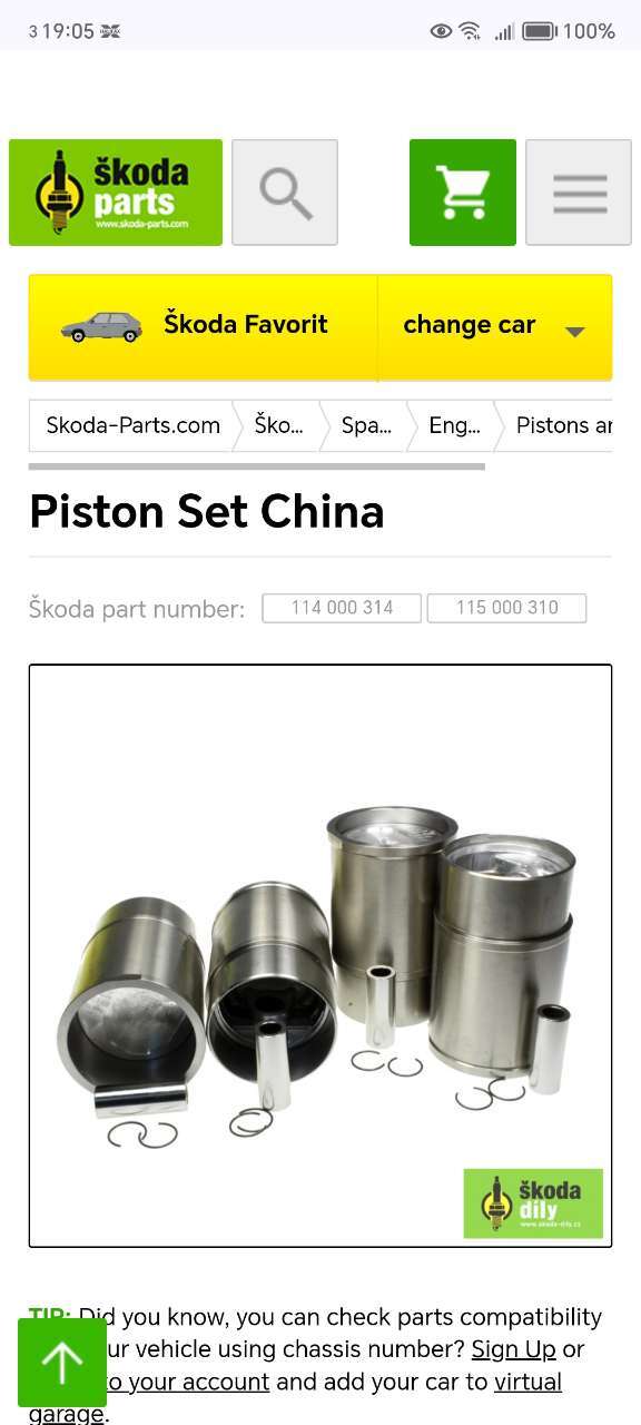

The only good thing is our friends at Škoda Díly have complete brand new piston and liner sets available.
Along with the brass sealing rings for the bottom of the liner in three different thicknesses.
Okay so they are made in China but what choice do I have? It's good that they've had the foresight to make them at all, along with practically every other moving part for the Favorit engine. Only slight problem is they do two different types and I'm not sure which type I need. One set is €87 and the other €93 which is stupidly cheap. At close of play today I've just got the sump hanging off and can see that if I remove the oil pump pick up pipe I should be able to get to all four con rods with the engine still in place.
