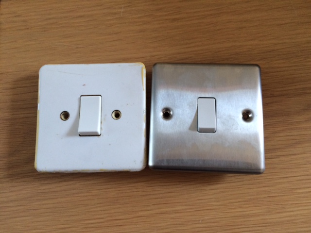

I recently bulk bought a load of switches and sockets off screwfix so I could gradually replace all the sockets and switches in the house.
NO PROBLEM SO FAR. I as I was off today I'd change the light switch and sockets in the kitchen that look particularly shite after it was just re-tiled.
I took the old light switch out first and it fell to bits. Never a good sign.
I wired the new switch up and go to screw it into the wall.  Hold on though the screw holes on the old switch are in the middle of the fucking switch. Like right next to the button and not out on the edge like every other socket made in the world.  As a result there's no way to attach the new socket to the wall.
On further inspection the box bit in the wall is a circle and obviously left over from then the house had round bakelite switches.
I go to the local electrical factors to try to find one of these oddball switches who inspire confidence by not saying "oh aye I remember those they stopped making them years ago" but instead said "no mate never seen on of those in my life".
I buy a square mounting box having resigned myself to the fact I'm going to have to chisel out a bigger squarer hole in the wall. I go home and start hacking away but can't get the old circular box out the wall. I finally realise that it isn't going to happen as it seems it's permanently connected to the trunking buried deep, deep in the wall.
WHY ME?
I hatched a plan and went down to my lockup and cut the new box in half so it was only a a couple of cm deep, cut a large hole in the back and a sliced out the top so it can go around the trunking. I then drilled holes in either side and tapped them out so I could screw the switch mounting screws in them.
I now drilled 2 holes into the brick and put raw plugs in them and put my mangled mounting box in with the back facing out. I screwed it into the raw plugs then screwed the switch into the two holes I tapped in the metal.
4 hours elapsed. Only about 20 left to do.
I fucking hate DIY
Surface mount shallow boxes over the top. How old is the cabling though? Is it multi strand or solid? What type of insulation?
I know exactly what you mean though, I've seen installations like that.
It's solid with plastic insulation. I think the house was re-wired about 20 years ago and they just used the original boxes and trunking to avoid having to rip the walls to bits.

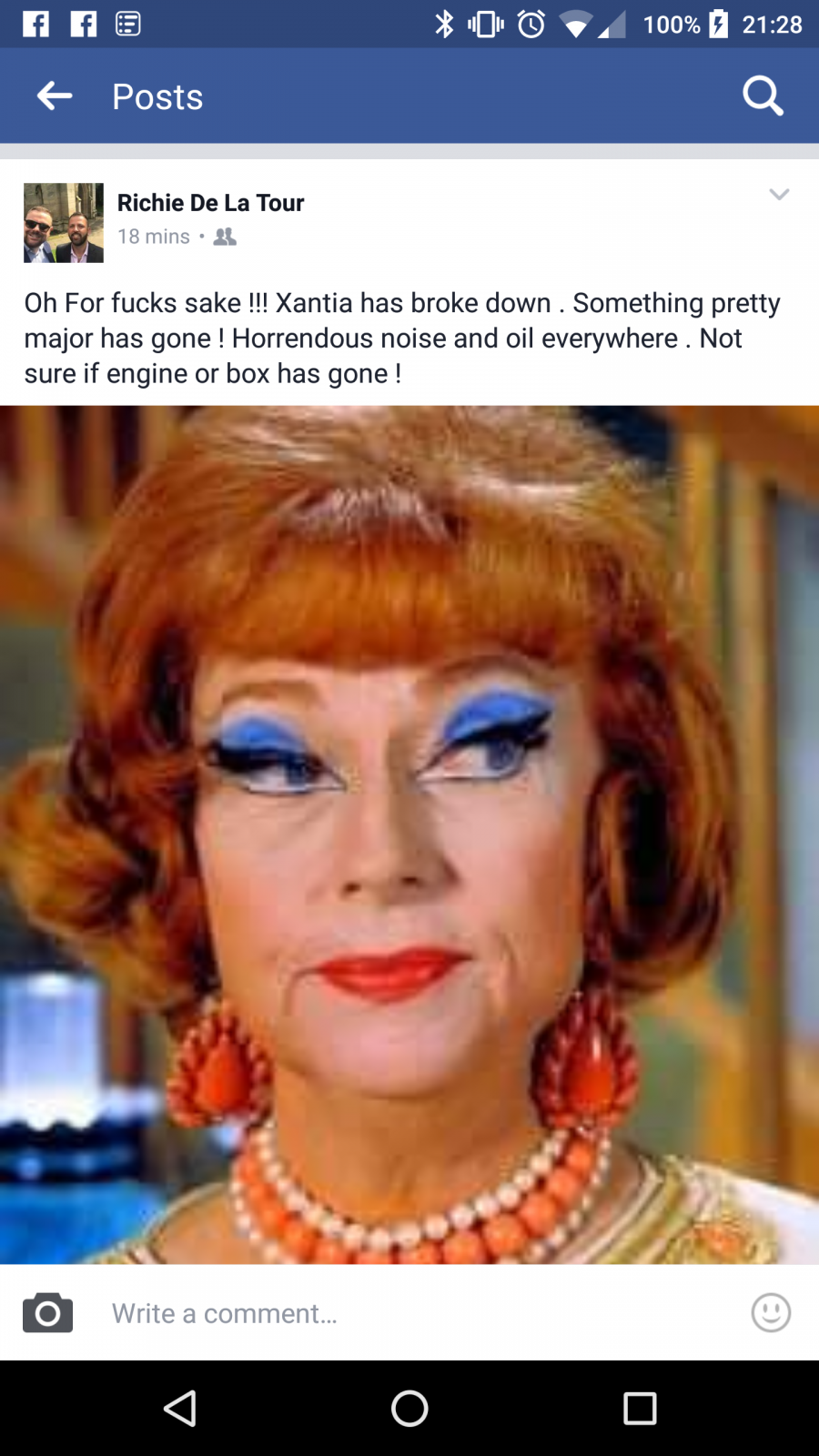

Luckily he has a spare engine (which is probably much better...). He's just got the interior sorted too
So people don't recognise him driving a Xantia?
If I still owned the xantia tonight, I'd be crying and phoning the scrappy

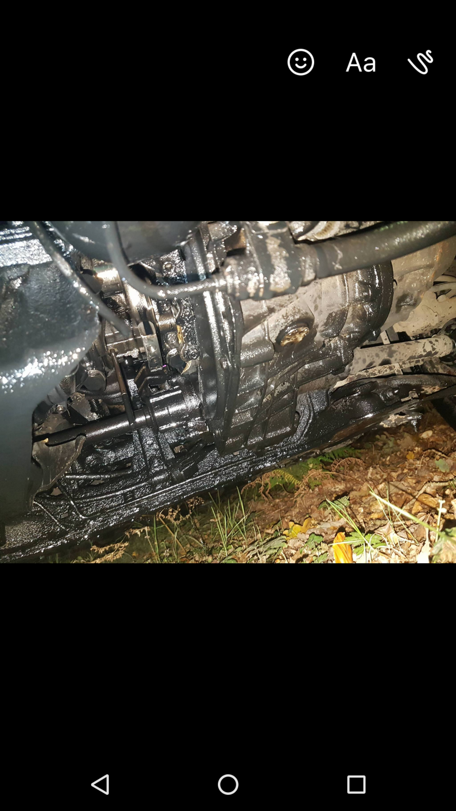

Another engine is being found by cyanide_steve and fitted forthwith. Wonder what made a bid for freedom?
Eesh. There was a spate of XUDTs putting rods through the block, but I thought that was cars built around 1998.
I think it's fettled history, and even me limping it off the main road when the cambelt slipped possibly played a part. All fully disclosed upon handover of course... Knowing Steve it'll be fixed by monday*
Looks like no4 conrod...

I had a look online last night and can't find any similiar switches. Is it possible the council had these commissioned when the refurbed the house so they could re-use the old trunking and boxes?
I would suspect such things existed in the 50s and 60s(?) for exactly such purpose but disappeared with the introduction of standard dimensioned back boxes. I presume it is a complete nightmare to remove the end unit on the conduit and replace it with a back box?
If its my/chompy/moog/foad/beko then it is a 1998. Im led to believe it had an hard life with the tuning done to it.
A friend had a 1998 306 DTurbo with no mods at all, and that hurled a rod through the block. Not sure what the problem was, but it was a weakness of the engines for a time. So much for bulletproof...
The very same. Can't say it's a huge surprise given its history, but he got 6 months out of it and has a few spare engines. Plus the clutch clip went again 2 weeks ago so he was pondering a new clutch, ideal time!
Just a thought you do have an earth wire on the lighting circuit don't you?
Yes there's an earth wire screwed to the back of the old round box. The wiring itself looks modernish although I found a horror behind one of the plug sockets I'm going to get a spark to look at as it doesn't look too safe to me.
To put a square back box in I'd need to rip all the trunking out the wall. Don't fancy that much.
^^ I'm a sparky and you've landed with a real bastard of a situation there. At least it could be if you absolutely must have faceplates flush with the wall. Don't try to alter the steel conduit, far more trouble than it's worth, and butchered plastic back-boxes behind the fittings throughout the house is definitely a no-no.
Easiest solution is to fit "extra shallow" 1-gang square surface-mount boxes which screw onto the face of the wall over the existing round box and hole. Very easy to do but you do need to have (or extend) a bit of spare cable to reach the switch terminals. Extra shallow boxes are only 16mm deep rather than standard ones which I think are about 30mm.
Metal faceplates on white plastic back boxes might look a bit unusual to some but lots of people couldn't give a fk about it. I'd prefer white plastic faceplates but your choice. Often only a sparky would notice it. But ffs do mount the surface-mount boxes level or it will look mega shit.
If you do fit metal faceplates you MUST earth the faceplate, leave the existing earth wire connected to the conduit as it's earthing the conduit in case the conduit is broken somewhere further back and take a new earth wire from the conduit to the faceplate.
You can do it, don't panic! Check with your sparky if he's coming round anyway.

What's the horror? :D

Bare wires covered in a single strip of insulation tape disappearing into the wall. Okay then I'll just screw this back on and walk away.
