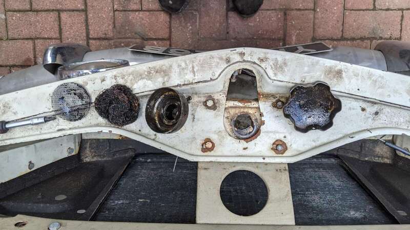

The silicone gasket completely sorted the perpetual valve cover oil leak on the Amazon, but I was still getting the occasional whiff of oil vapour. I figured the reason for this was probably the crankcase breather 'system', which on this car involves nothing but lots of fresh air.
On the side of the block there's a flame trap and a pipe going out and under the car.  But the intake for the breather is actually the oil filler cap which has an internal filter and is open to the atmosphere.
I'm thinking that when I am flat out / high rpm this breather isn't handling the crankcase gases adequately and some is being burped back up into the engine bay and thus into the cabin via the scuttle.
Here's the disassembled cap.

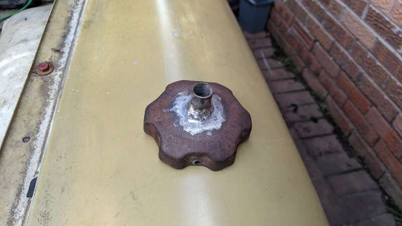

 My plan here is to upgrade this to the later filler cap that takes air from the pancake filter on the front carb.
Firstly, a clean.
Then welding on a bit of tube.
Then sealing up the intake on the cap, which in this case is the underside of the petals.  I'm using foil tape as a proof of concept, I'll bung it up with sealant at a later date if this all works.
Finally, a bit of hose between the cap and the filter.
So far this seems to have improved the bad smells. I still get an occasional whiff when I come to a stop, but I think that might just be the side breather pipe gases being blown around.
At some point I might replace the side breather pipe with a line to the intake manifold and a one way valve, creating an actual PCV style setup. Then I can apply for my green number plate.

Does it need some sort of 'catch can' between the rocker box and the air filter? will it be pumping 'neat' oil vapour to the filter when hot ?
Just a thought ...
Just a thought ...
I've retained the mesh / wool filter material inside the cap, which is the same stuff as you'd find inside a catch can.
As designed, the flow of gas is meant to go inwards to the filler cap only, so it shouldn't be a source of constant oil vapour, just the occasional burp. The exit pipe on the block is angled to the road in a way that it creates a venturi that pulls gases through when moving.
Here is the updated B18 system which I was aiming for, although I haven't connected it to vacuum (#3 below). That part is handled by the venturi.
6 minutes ago, juular said:
That looks remarkably like the plans for the inter-dimensional spaceship that were beamed down from space in the movie 'Signal' starring Jodie Foster.
Ah, thanks for that , so once '3' is connected should work as you expect. 👍
Should still work as the side pipe is providing a pull via the venturi, just not as effective when stationary where #3 would be pulling a strong vacuum through the system.
That's the next step once I get hold of the right threaded fitting for the manifold, and the right side pipe with a vacuum takeoff.

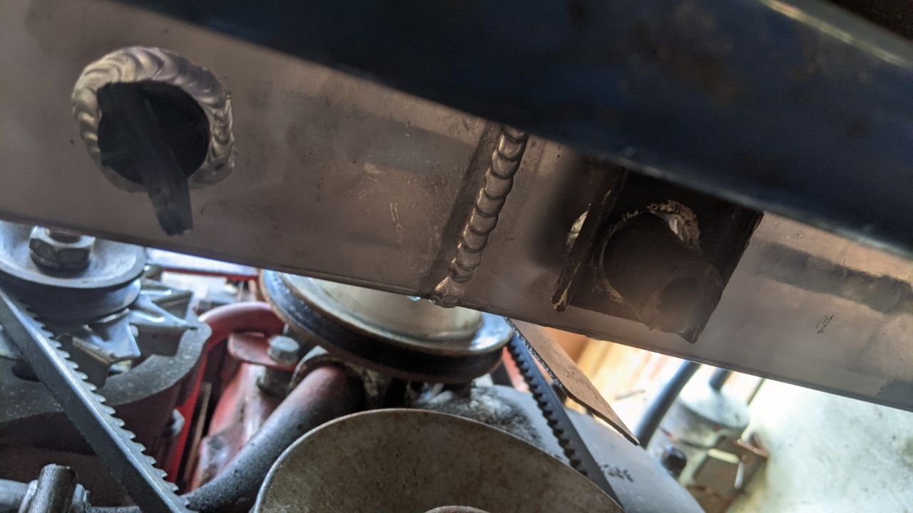

Next minor emergency was the alternator bracket snapping.  To be fair I did a half arsed job of welding together two alternator brackets, so they were already pushed beyond their original design limit.  I decided it would be best to weld it back together again and reinforce it with a bit of angle iron to prevent any kind of flexing.
Of course I made this as neat as humanly possible.

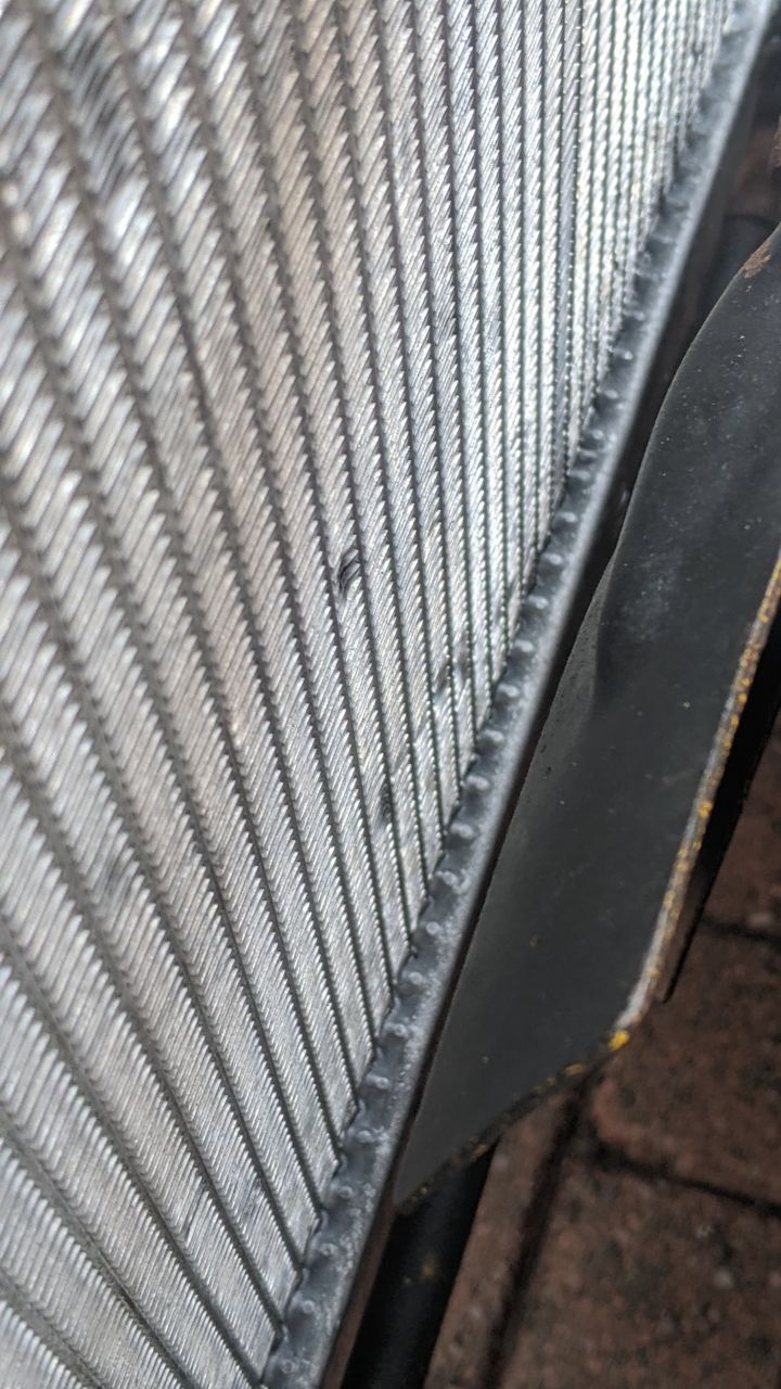

The Amazon's radiator did decide to shit itself on the way home, just to make sure we didn't forget the chod god was watching over us.

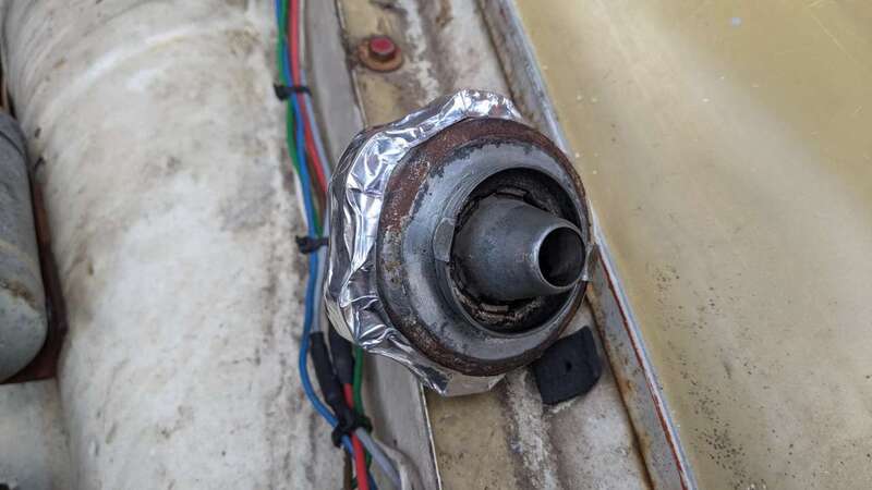

Another week, another mucking about with the exhaust session to try and rid the Amazon of the droning noise.
I've been reading that the resonator that comes with the Simon's exhaust makes the tone significantly deeper, so I thought it would be worth trying to replace it with something else.
Bought a length of straight pipe and a small Jetex silencer. Together these were only about £50 so worth a shot.
Laid out here is how I planned to attach it between the front pipe and the axle pipe, with the old resonator laid underneath to show where I had to cut things.
Also had to transfer the exhaust hanger bracket from the resonator to the new silencer.
Everything mounts easier than the original Simon's setup, since the straight pipe has a lot more clearance against the floor.
First impressions - definitely sounds much nicer. Sort of fruity sound, less deep.  Exhaust no longer smacks the floor when taking large dips in the road at speed.

Thought I was being clever.  Instead of spending £40 on a pressure testing kit, I found that I could achieve the same with a £2 bike inner tube and a tyre pump.
The source of the leak pretty clear here.
Cleaning off all the epoxy repair stuff I can see that I didn't even get near the actual source of it which is the big crack near the pipe.
I thought I'd continue to be smart, and took a plumber's blowtorch to the solder in the hope that I could reflow it and add some more. Nope.  All of the solder instantly fucked off inside the radiator and the pipe fitting fell off.
Oh well.

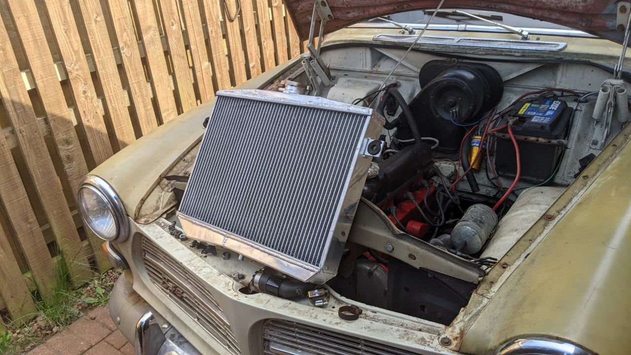

Back to the Amazon saga, my refund for the damaged radiator from Autodoc finally arrived - not without some serious fighting with them though. But at least that's over with.
I never look at the Bezos scam site or use any of their services as I hate the twat and can't stand the way they do business, but I reluctantly did a search and noticed they sold the same radiator Autodoc did for fractionally less money. So I bought one.
To give them credit it arrived in 5 days.
However nothing ever goes that smoothly and I immediately noticed that it didn't fit.
The mounting lugs were too far back.
This forced the fan almost right into the radiator.

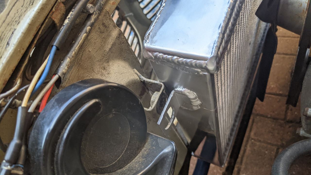

It also sat far too high and caused the top and bottom hoses to not fit properly.

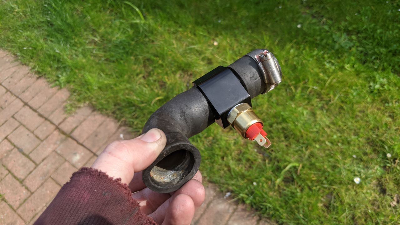

The solution was as usual to employ Mr Angry and cut the mounting points off the car, then drill new holes for bolts slightly higher up.
I also modified the top hose by adding a switch for an electric fan which I was going to add in the future.
This all fit really nice now.
Refilled and tested, I noticed a drip right away.
Ah shite.
I'm thinking the core may be leaking.
I dried it up and checked it again and the dampness came back.
I'm going to give it a chance and see if it's just residual coolant from when I filled it up. It's difficult to tell as I expected any dampness to evaporate once the engine got up to temperature, but weirdly the bottom of the rad remains cool even when pushing the engine hard and coming to an abrupt stop.
It doesn't overheat though and in fact the temp gauge seems more stable than ever.
Could it be that the aluminium is just that good at cooling?
SUSPICIOUS.
We'll come back to this.

Great progress!
The rad issue may be a Volvo issue. I fitted a late 1966 rad to my early 1966 car and had to chop the mounts off like you have, so it may be designed to fit 'most' Amazons, not accounting for the earlier mounts.
Screenshot_20250413_175357_Gallery.jpg.c198346824e3464e1f86f3ae670a3f05.jpgScreenshot_20250413_175410_Gallery.jpg.b5949ccc0b09ac6a345907542ff57efb.jpg
18 hours ago, warninglight said:
Great progress!
Reassuring to know it wasn't just another half arsed pattern fit. I forget that the later cars have expansion tanks and different shaped radiators.
Checked it this morning and it has remained dry.
Was it just my extreme cynicism of aftermarket parts?
Cynicism of new parts is never a bad idea.
if you’re keeping the belt driven fan, finding or making some sort of fan shroud will help it stay even more MEGACOOL in Traffic on warmer days. I recall reading from some engineer type some years ago how without a shroud the fan just pulls in air from anywhere as it takes the path of least resistance.
If you’re fitting an an electric one and binning the belt driven one, sod it. Then you get all of those benefits the Kenlowe ads used to tout in Autocar.

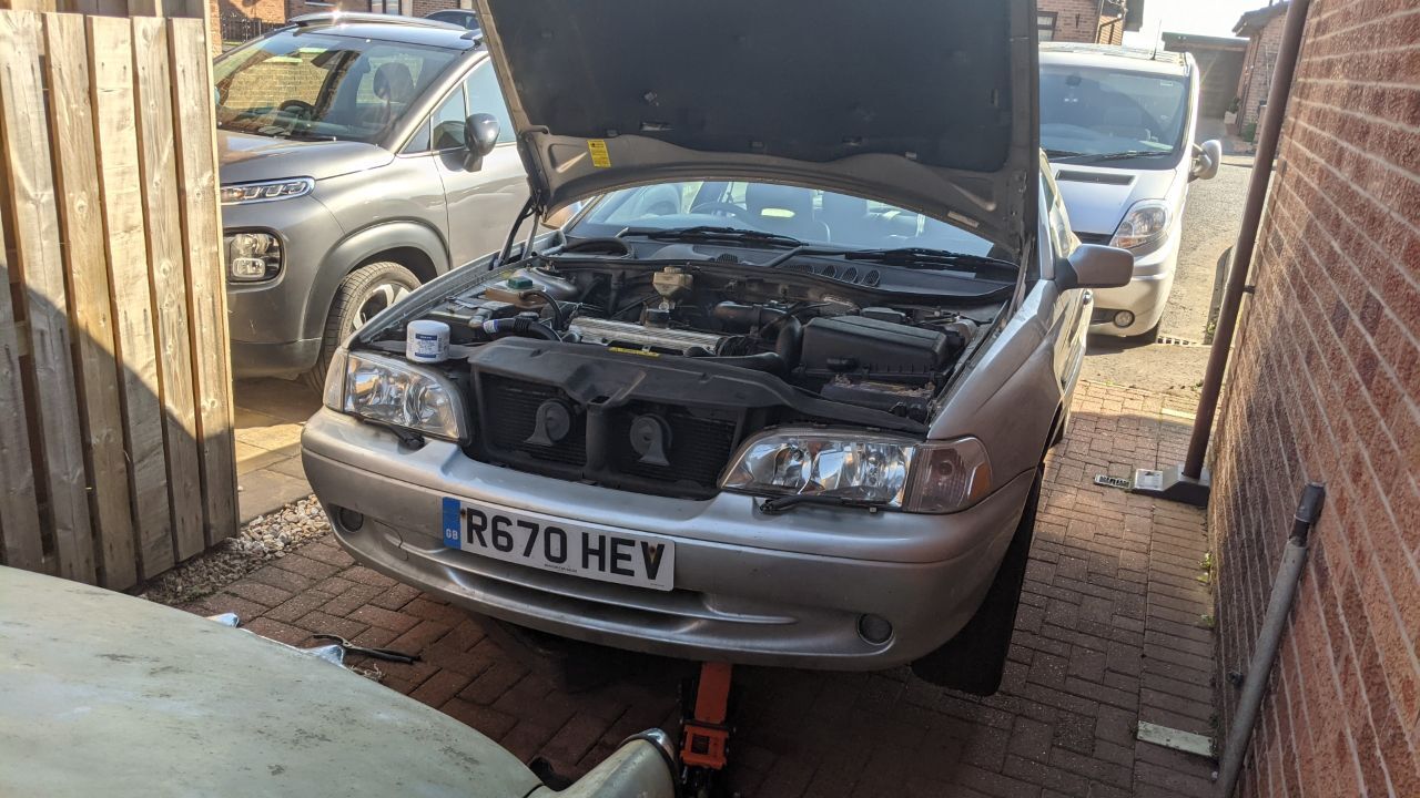

When I got home I noticed the trans cooler on the lower half of the radiator had a very slow but still troublesome leak from the top pipe.
Not a big deal to replace but I thought I may as well dump the fluid and take a look.
Oh dear.
That's not a good colour at all!
Clearly running low on fluid has burned it. I was surprised by the colour as I swapped the fluid a couple of years ago..or so I thought!
I had to scroll back through my thread to see that I last changed it in 2020. I didn't even think I'd own the car this long. How time disappears.
Anyway, I had enough left in the 5L to refill to the correct level and tested the car. It seems fine for the moment, but I'll get that cooler changed.

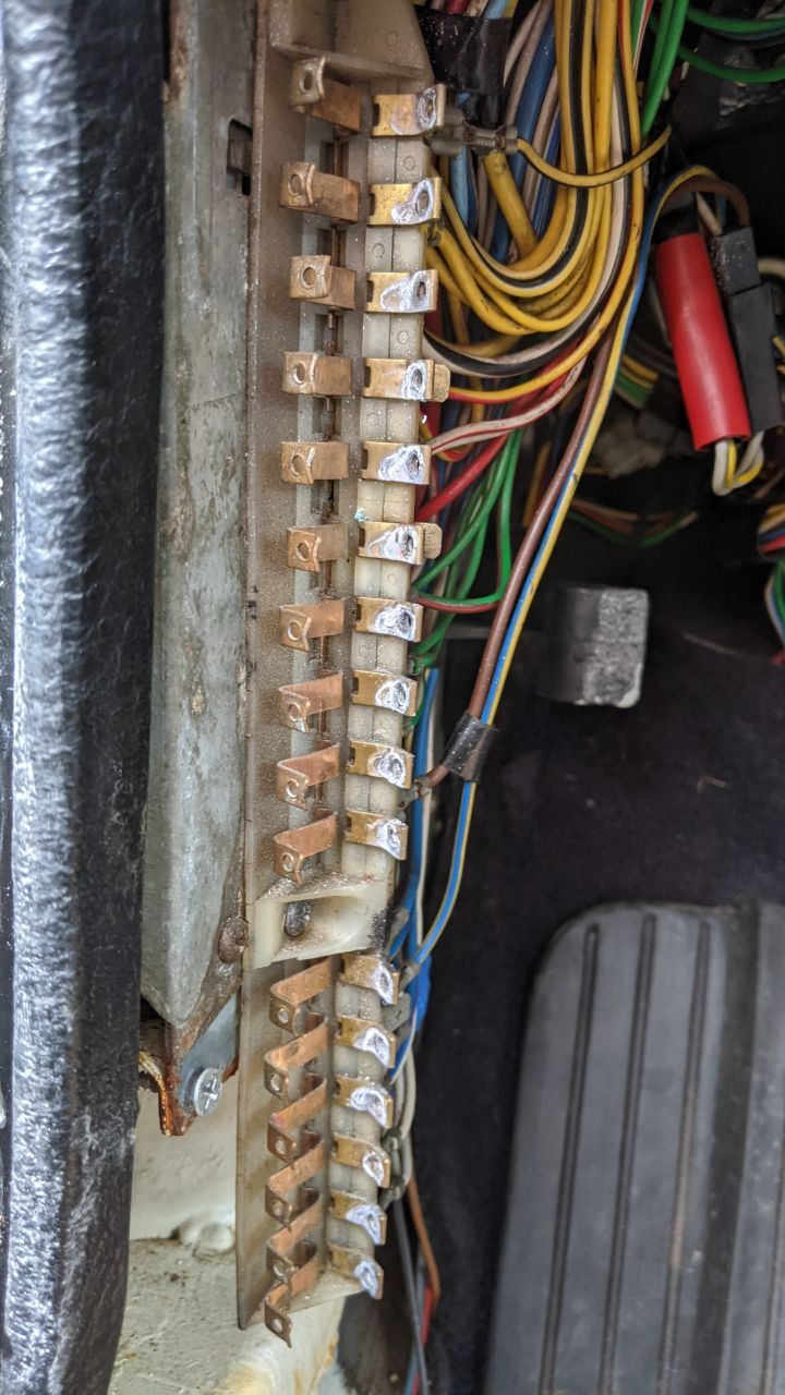

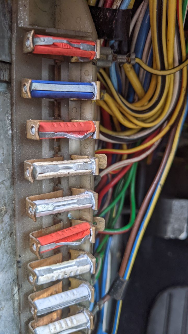

This has been sitting a while as I've been getting annoyed at the electrical problems with the dodgy fusebox (TADTS).
Check out the white fuzz on every single fuse. I cleaned those a month ago.
Several of the fuses have warped and melted due to the shite causing high resistance and heat.
An attempt was made to clean and grease all the connections, but realistically I need to replace the fusebox, which I've ordered a blade replacement for.
A bit of a general tune up was done (dizzy cap and rotor was filthy) and it fired right up and happily took me to the first day in my new job. Good old bus!
