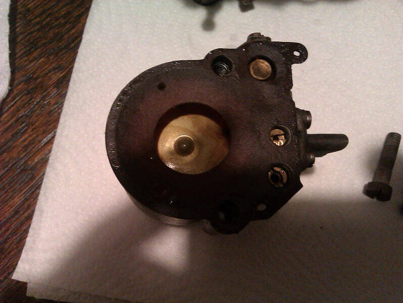

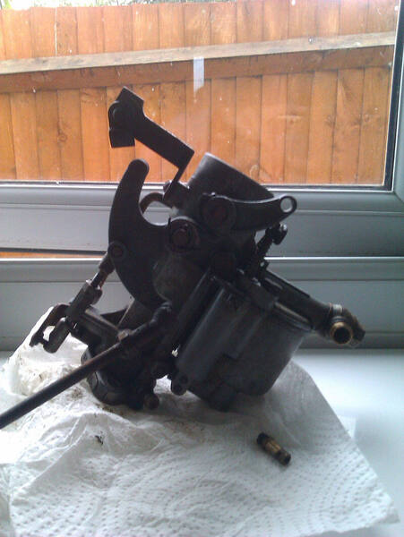

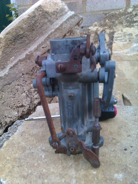

While not the worst I've ever encountered, the carburettor was definitely in need of a clean and probably in need of some new items inside, we now had all the tools in place to do that.
It's a fairly simple thing to take apart and to make sure it was a simple thing to put back together I took a lot of reference photographs so I could understand just what bits went where in what orientation and this helped massively.  The float bowl comes off with just two large bolts/screws and once removed it was immediately apparent that the old gasket was if not worn out, then certainly not in great shape.
With that and the float removed - interestingly the float is just that, there's no arm to set, it's just a hollow brass cylinder that floats, we tested it and there's no holes which is good - we could get our first look inside the bowl.  There's quite a bit of sediment and general detritus in there.  One neat feature is that the end of one of the bolts that holds the float bowl on has a square headed end to the thread, this fits the plugs in the bottom of the float which I'm sure is no coincidence since it allows you to remove those and clean out the space underneath them.  It's not often you encounter a specialised tool built in to the thing you're working on, what a sensible feature.

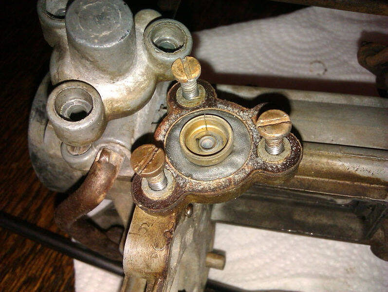

The diaphragm on the side of the carburettor was removed next.  This comprises two gaskets sandwiching a rubber gasket that has a brass cup which holds a spring.  The rubber gasket was stretched and seemed a little brittle while the brass cup had a large crack in it so replacing this will no doubt help.
On the back of the float bowl there's some sort of block held in place with five screws.  As far as I can understand this directs the fuel from the float bowl past the brass tang which, presumably, makes it spray in a finer mist to draw it down into the manifold easier.  The gasket here was in reasonable condition and it was fairly clean.
The float needle (I assume, it sits above the float and seems activated by the float pushing against it) showed signs that it may have been replaced before, little nicks all over it.  The top is also ever so slightly mushroomed over, you can just feel it with a finger nail, so this is also due a replacement I'd say.
After stripping everything else down that needed it, namely the parts I could replace with the service kit, I spend the rest of the day feeding the various parts through my small ultrasonic cleaner.  I must say thank you to @Zelandeth for his tip about putting a larger plastic container in the cleaner, this really helped for the float bowl which was quite dirty and benefitted from full submersion.  The water shown here is one of the cleaner runs, when we did the main body of the carburettor the water was impossible to see through.
It took a while to do everything since it had to be done in batches and alongside my work commitments, eventually everything had been run through for about 20 minutes total and it was all as clean as it seemed to want to go.  I did notice the cleaner not only removed dirt, it also removed some of the surface rust on the steel components, I imagine with a few more passes I could have removed the rust completely, it just didn't seem that necessary since what's there doesn't affect the operation of the carburettor in any way.  Reassembly time next.
It was mostly a case of just looking at the photographs I'd taken, matching the parts from the kit with the parts I'd removed, and putting the whole thing back together again.  It was really very easy.
That is, until we got to the float bowl and I had to improvise a little.  In the kit are four tiny brass blind rivets and I had no idea what they'd be for initially.  They appear to be used to hold the float bowl gasket in place.  I had a suspicion someone had been in and worked on this carburettor before, hardly surprising given how old it is, and there was some proof of it here since two of the blind rivets had the heads sheared off.  When I tried to remove the other two, one of them sheared off and one came out fine.  I couldn't then get suitable purchase to drill the others out and even though I did fit one new rivet, I ended up pulling it out again and going a different route.  The reason for this is that all these little rivets seem to be there for is to keep the gasket held in place to aid alignment.  These days we'd just use RTV or similar to stick the gasket in place.  You'll note that when I remove the float bowl the old rivets weren't holding the gasket anyway since the gasket came away with the float bowl instead of staying on the carburettor chassis.  Suffice to say, I used a couple of smears of sealant to hold the gasket in place while everything was put back together and that worked just fine.
Another interesting find was the fuel filter.  There's a small gauze filter in the base of the float bowl, there's also a hidden filter which I thought was a brilliant bit of design.  The banjo bolt that goes from the fuel inlet to the float bowl hides a delicate brass mesh which serves as a fuel filter.  Ignore the little blind rivet there, not sure how that snuck into shot.  The banjo bolt can only go on one way too since the hole one side is larger than the other and this seems to be to help keep the brass filter in place, presumably to stop it being accidentally crushed when you tighten everything up.
Before very long I had the entire carburettor reassembled and looking much better.  That's when I spotted something I hadn't when it was dirty which is that the float bowl doesn't line up properly with the chassis.  I was told on some of these 'pedestal' type carburettors that the main chassis can warp and move the float bowl away from sealing and that, in turn, can cause running problems by letting air in.  What I can't remember is who told me, if there's a fix, and how bad the gap has to be before it's a problem.  I did a check online for similar designed carburettors and there's quite a few out there with this very same gap problem, though information on why it's there and how to fix it seems sparse.
I'm not going to worry about it right away.  If I need to address this later on I'll find some way to do that.  Perhaps some sort of gasket in this area would help, there doesn't seem to be one as standard and there wasn't one on this car or in the kit.  The good thing is the carb looks much nicer now, has all the bits renewed that were worn out, and is far more pleasant to handle than it was.

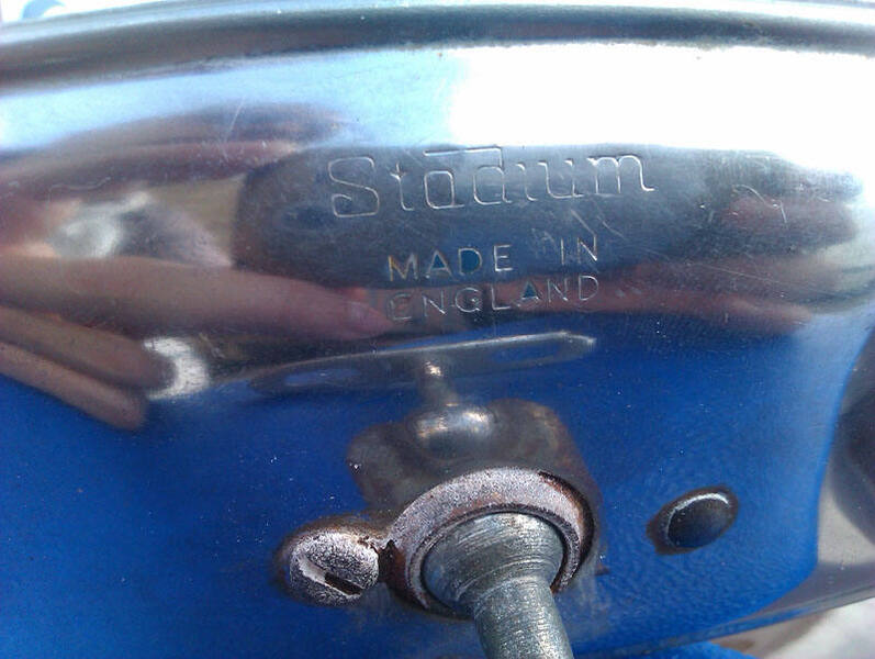

I found two suitable screws that fit the holes already drilled in the car which lined up nicely with the slots in the mirror and in no time at all had it fitted.  The mirror itself frames just a little more than the rear window of the car and is height adjustable to a degree due to having a double balljoint arrangement for the bracket.  The mirror is slightly tarnished around the edges while not being so degraded you can't see anything and now it looks like the mirror has always been there, just like the auxilliary lights.
