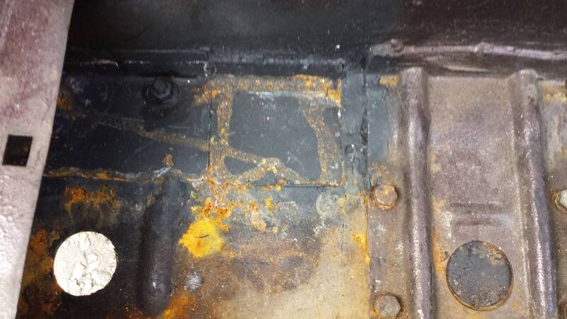

Just got the car back from its tuning and welding session.  And the verdict?  Huge transformation - it drives almost perfectly!  The engine is very smooth and has plenty of power, more than I expected to be honest, it powered up a relatively steep hill in 3rd gear and no longer gets hot at all, the gauge sits nicely in the middle.  It easily got up to 60mph on a straight NSL bit of road, I'm amazed.  It's like a totally different car.  I'm now absolutely positive that getting the suspension properly sorted is worth every penny and I cannot wait for that to happen (17th August I think) so I can drive it properly.  I would currently describe it as 'bumpy' and it won't be doing it any good driving it much like that, so I will try to avoid using it too much until then.
On top of that, his welding on the passenger floor looks superb, all it needs now is a bit of brown paint to blend it in which is fortunate as I now have some!

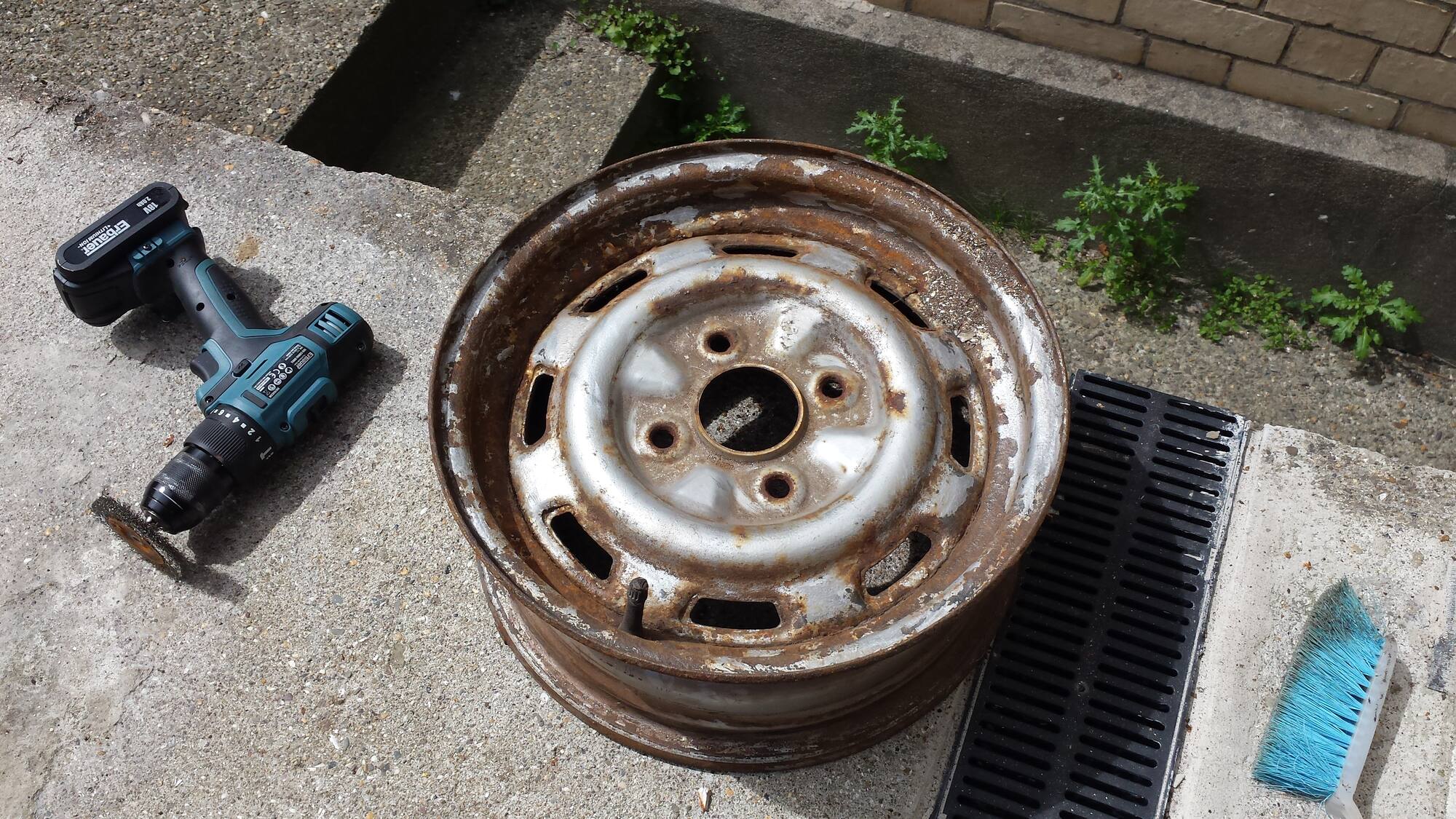

Part of @vulgalour's Princess care package included an Austin Ambassador wheel as mine is missing its spare.  It's slightly wider than a Princess wheel but fits and will be fine to live in the boot.  Before I get a tyre fitted it definitely needs a tidy up though.
I attacked it with a wire wheel drill attachment to get the flaky bits off and rummaged through my garage for some high quality* paint products.  I selected a moderately fresh can of grey stonechip and a mostly empty can of satin black which I'm pretty sure was at least 16 years old - perfect.
Stonechip first to seal the surface...
Then what was left of the satin black on the front and back, fortunately I had exactly enough left to do this plus touch up the cast iron drainpipe on my house.

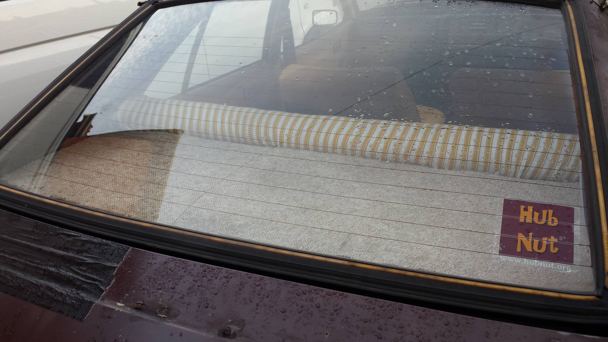

A few little jobs done today.  First of all, I pulled out the completely destroyed parcel shelf a few weeks back and kept hold of the rotten mess only as a template - I dug it out of the garage today along with an old bit of carpet and after some quality hacking with some inappropriate scissors, I produced this.
It isn't good, but it's better than the tattered vinyl flakes stuck to mouldy chipboard and better than the bare metal shelf.  It'll do for now.

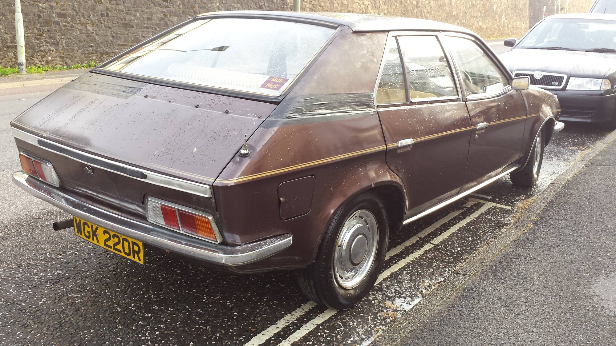

The boot floor is overall 97% solid, there's one scruffy welded plate in the storage area beneath the floor and some holes in the rear valance and light surround but nothing major.
Then to cap it off, a much-needed wash.  As ever, photos of it wet are much more flattering.
The eagle-eyed among you might notice there's a couple of chrome wheelarch trims missing.  I gently* removed them as they were both hanging off anyway and the front passenger one was crammed with leaf mould which wasn't doing the metalwork any favours.  Both have served as a bit of a rust trap but it's not too bad, the front bare arch is quite solid and should come up fine with a rub down and some paint, the driver's rear one not so much, it's had work on the front corner before and the rear corner is mostly not there.
I actually think it might look better without them - they certainly aren't doing it any favours at the moment as they're all loose/wonky in some way and trapping dirt and rust so I will remove all of them for the purpose of cleaning up the arches but not sure if they will go back on or not.  I'm not planning to put any of the stainless trim back on around the C pillars and boot, it's all extra fussy details which don't benefit the car at all but they will all stay in the boot with the car.
It's not bad really for 30 years of neglect - having just caught up on @captain_70s Dolomite repairs, this seems very insignificant.  Not sure what I will do about it yet, I'll pay more attention to the bodywork when the mechanicals are near enough 100% which shouldn't be too long now.
