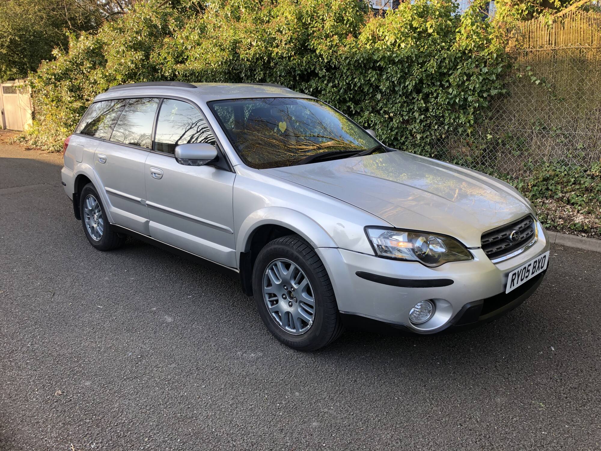

My BIL has failed to find the E39 estate of his dreams and last week a work colleague offered him his 83 year old dad's Subaru Outback 2.5 auto. The old boy was getting lost on route home from the supermarket and his family decided that it was time to hang up his driving gloves.
It's a 2005 car, in silver, with a decent spec that includes sat nav and working a/c. The car came has 131k and FSH, including two stamped up service books and came with 3 months MoT. In recent years, the car has done approx 1k miles between MoTs.
The Good. Drives well, 'box changes smoothly, engine pulls well, nothing leaks. It's been properly serviced and mechanically, the Outback is in rude health. A couple of months ago it had a new alternator and last week a new £100 battery was fitted. The cam belt and auxiliary belts were done at 121k miles. It has a matching set of 6.5k mile old Michelin tyres and a decent spare. The interior is very tidy and all the toys work.

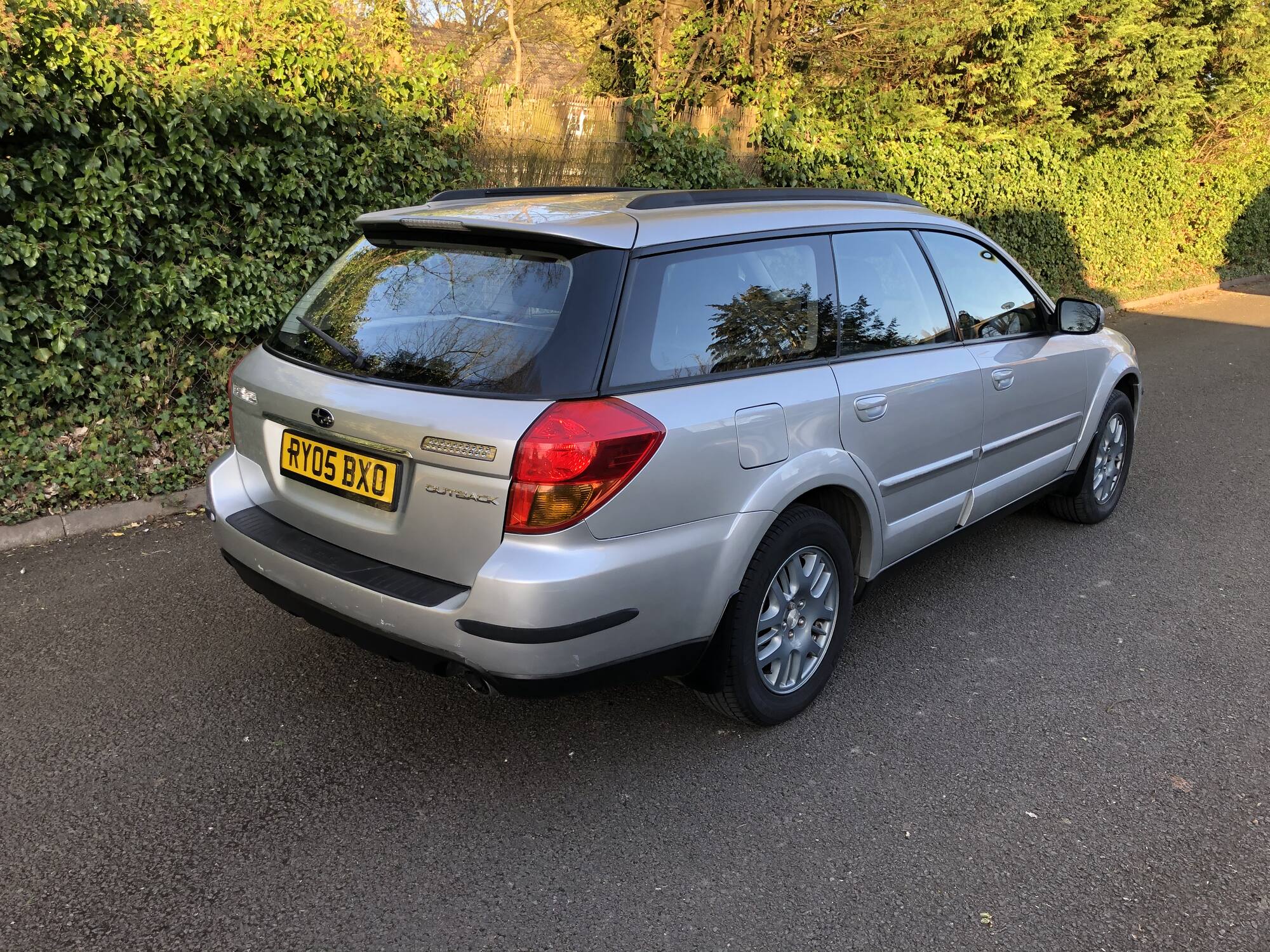

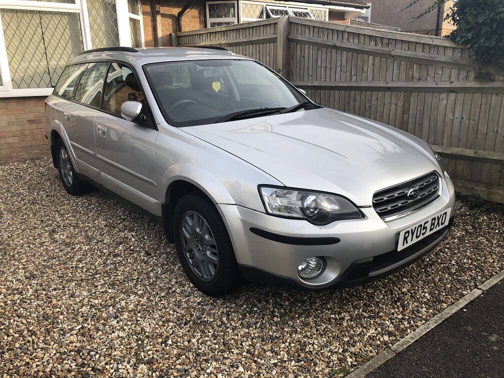

The bad. The bodywork. Giffer related damage to most panels - see photos. The worst is the rear nearside arch and rear passenger door.
How much did this piece of automotive art cost? £320, which I think is reasonable.
Aside from sub 30 MPG fuel consumption, is there anything that we should know about the Outback? I am guessing that these Subarus are generally low tech and reliable old things?

BIL and I spent the afternoon in isolation on my driveway tarting up the Outback. It certainly looks like it’s worth more than the cost of a night out.
