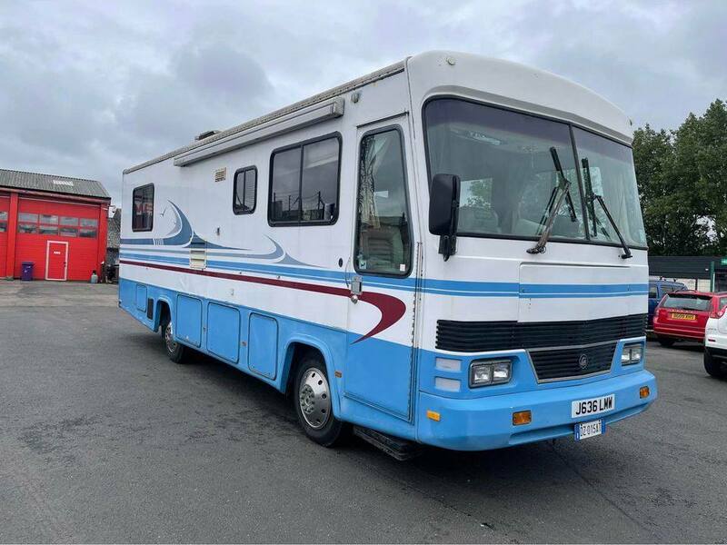

.... it's a Spartan Gulfstream 30ft motorhome although not made by Winnebago but by Spartan.
Here ya go.

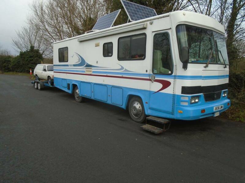

About time for a write up on the mobile house I suppose. The Mot ran out the month before I bought it so a pre arranged Mot got it from Hartleypool to Doodlay to my Mot man where it was found to have iffy brake lights which were sorted there and then. A bit of misting on the back shocks, which I will replace soon, although I would expect it to wallow a bit at the back if they were shot  and it doesn't seem to, and it was good for the road for a year. That will do nicely thank you very much.
Partly the reason I bought this was because the previous, and only, Mot was clean and since then had done about 700 miles so not a lot, although these things don't tend to do much really. This one is on 74k in twenty nine years 2500 ish a year.
After that it was down to the warehouse that the client I did maintenance for let me use so inside coming up to autumn and wetter weather. This gave me the opportunity to go over the roof and make sure it was water tight, something that has to be done on a regular basis. Every 3 to 5 years. There must be a reason why they don't make them out of something water proof to start with. So in spare time I patched a couple of bits I wasn't happy with and put 5 coats on of a rubbery paint that had to come from Canada where they seem to have cornered the market.
At the same time I was looking at solar stuff. I went with two domestic 260w panels which should be plenty for what I will use and stuck them on the roof in adjustable frames. One near the front facing fore and aft and one in the middle going side to side. Ideally I need a couple of turn tables where they turn and tilt at the touch of a button. Will look into that. An Mppt controller, which on a sunny day at this time of year gets up to a high point of 16 amps which is pretty good and then to two 130 amp leisure batteries which I thought would do to start off with. As it turns out it's not quite enough so will be looking at that. Lithium works out about the 2k mark which is a bit ouch.
Heating is your Chinese 5k dizzle job which I have plumbed into the front part of the existing system with two outlets. I don't like a warm bedroom so no heating there and it's been fine with good duvets. Using red dizzle which I can get for £1,04 a litre in a couple of 20 litre metal jerry cans does me between ten and fourteen days weather dependant. The built in heating runs on Lpg and with a 100 litre tank, so 80 litres of gas for safety reasons, which seems reasonable until you start using it for cooking, generator, maybe, and fridge and heating and hot water I doubt if I could last a week before having to fill up which, dependant on where the nearest supplier is, could use up a fair few gallons of go juice. I haven't been able to work out Mpg yet but I'm thinking a bit less than ten to the gallon. Rated at 7.2 ton max although if that is empty or with fuel, water and stuff I have no idea, and with a not really light weight trailer with a 305 van on it it's got to be about 9 ton all up. The genny is an Onan 4k 240v Lpg job but seems to need to be run for a couple of hours to rev batteries up and is the best time to put the toaster on and any other appliances. I fire up the water heater when I want to take a shower which as I am now a skuzzy new old age traveller will be rarely of course. For the first time in my life I have a beard to emphasise the look so now I'm a new old age scuzzy beardy grumpy old shite traveller.
The not starting scene was sorted  by taking the injectors to a brilliant bloke at R N Diesel in Wolverhampton who did the business for £120 cash which I consider very reasonable and sorted in 24 hours so now a couple of turns and it fires straight up.

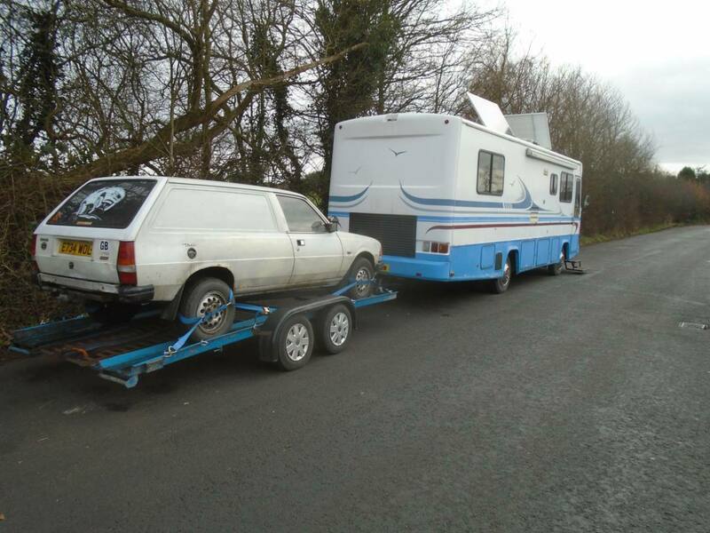

So I have been living in this house for about three months in laybys, the ones that are not right next to the carriage way, more the old curves of an old bit. I've got 5 of these and rotate between them every 4/5 days. The two furthest are about 20 miles apart so a bit of a different outlook every few days. Trees and greenery shizz.  Been doing this to see what the monthly expense is with minimum travel to see how much I can spend on moving further away. Wales is possibility or south coast. Darzet  or Zummarzet.
It's not a way of life for most people but for me on my own and having done it before in a self converted Merc 609 I find it's better than sitting in a small flat till, well, the end to put it bluntly. I jumped into this at the worst time of the year weather wise and it's been a learning curve on how to live in comfort and warmth for as little as possible. Eg combining getting Lpg, engine diesel and red in the same trip so being organised and planning is a must. Google maps are great for finding stopping places and there is an app, of course, called park4nite which is more use to van and euro camper sizes.
