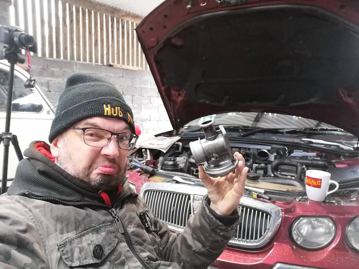

dollywobbler Posted October 13, 2020 Author Posted October 13, 2020 Today, I need to drive to Warwickshire. So yesterday, I broke the Rover. EGR valve clean-out. Not a bad job, if rather messy. But, one thing that hastens the muck is a failed PCV breather, so I set about changing that too. At which point I snapped off one of the fuel return T-pieces on the top of an injector. ARSE. Thankfully, I'd had the foresight to push the Fox out into the rain so I could at least get back home again, where I jumped into the GSA to drive 36 miles to buy four new T-pieces (at £3.50 for the four). Rural life! The Fox was spluttering a bit, the GSA more so - dirt in the carb I reckon on the latter. Seemed better after an Italiano throttle abuse and a dose of redex. May have to have a look in the carb though. I did actually try fixing the broken t-piece before that, by trying to weld it back together with a soldering iron and a cable tie as a filler rod. It did work, but sadly just snapped off again when trying to refit. Fumbler, St.Jude, Supernaut and 6 others 9

dollywobbler Posted October 14, 2020 Author Posted October 14, 2020 11 hours ago, sgtberbatov said: Quick question: did you get the answer for the Lada Riva thing on Facefeck? Sort of. In other news, the Rover made it to The Midlands, but is still sluggish. Which means it's still quicker than the rest of my fleet. I wonder if the exhaust has got clogged. Apparently that can happen.
