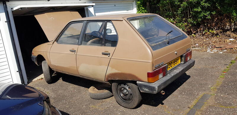

Jimblob Posted April 17, 2020 Share Posted April 17, 2020 LankyTim: I've just spent a long time reading through this post. I did contribute something enthusiastic back in November 2019, but since then I have bought a Citroen Visa. It's almost identical - a Y-reg Special, in beige. I have just about got mine running (need to add some jubilee clips to the renewed flexible fuel hoses, as there is at least one slight leak. As it happens, I have also recently acquired a 2002 Volvo V70 D5 as my daily.... snap! I'm really interested in my car's twin (the Citroen that is) and how you are getting on with it. Hopefully you have stuck with it and got it running. somewhatfoolish, Mrs6C, mk2_craig and 11 others 14 Link to comment Share on other sites More sharing options...
