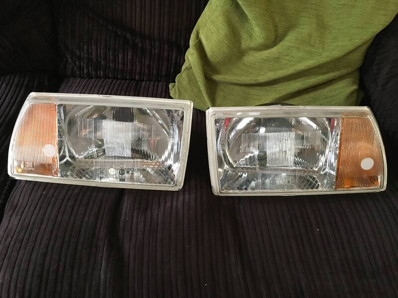

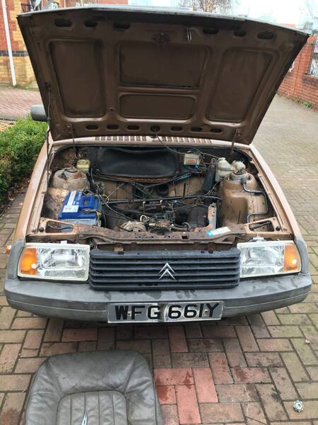

First of all... it’s still not running! However I’ve managed to fit the headlights, what a doddle! 3x clips per headlight and they just pull out. With the new headlights fitted the Visa suddenly looks much better, a bit less of a breakers yard escapee atleast.

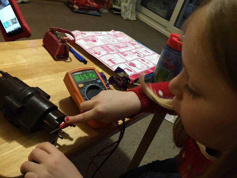

Many thanks to Castro-Bros for sending me a multimeter! Today I got to work attempting to find out if the coil is working or not...
The primary circuit seems to bounce all over the place, from 125 down to 1.0 Ohms, it sometimes settles around 2.5 but I’m not sure if I’m even using this multimeter correctly.
In other news the V5c has turned up and the drivers footwell has water in it AGAIN. Disappointing.
EDIT- I've had another play about with this coil and the secondary resistance is  11000 ohms, the primary looks to be 1.0 ohms (when i can get a good reading) According to the Haynes manual it they need to be around 10200 ohms and 0.6 to 0.8 ohms. I'm not sure if the readings I've got a close enough or not.

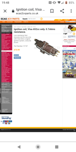

Odd question but what colour is the coil? 2cv coils look identical to visa coils but the (not interchangeable) 2cv coil is black and the visa one is brown; it might be the photograph but yours looks black.
Resistance readings of ignition coils won't identify their most common fault which is a short-circuited turn.
The coil is literally coils of wire, insulated with varnish. A short circuited turn is where the insulation fails allowing contact between one turn of the wire and the next. This short circuit will sap almost all of the energy that should be in the spark but it will hardly change the readings on an ohm meter at all.
This. Absolutely 100% you have a 2CV cool there. I was always told years ago by the 2CV guys that a visa coil is no good on a 2CV and a 2CV Coil won’t work properly on a visa in return. I think you may be needing a brown coil sir.

This is deffo a brown coil, I think the photo just makes it look black. Apparently it ran fine when parked in a hedge 9 years ago.
Fair enough, pic does look black as you say.

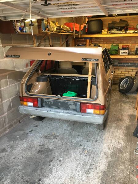

Finally had a clear out of the garage and the Visa is now in the dry for the first time in nearly 10 years. Unfortunately it will get evicted next month when we move house!
