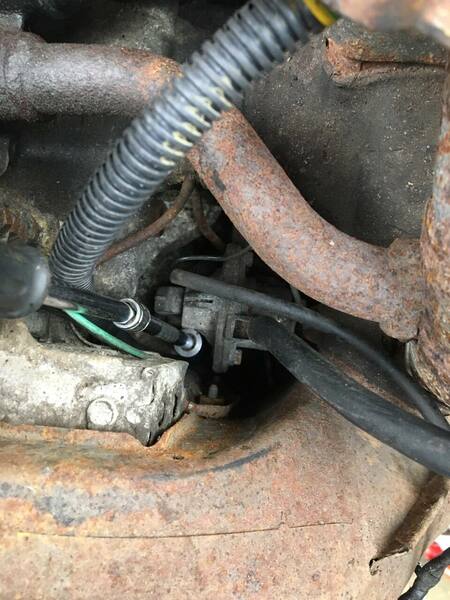

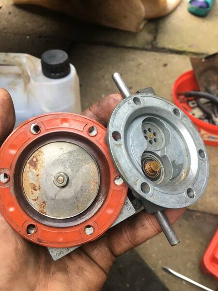

Lankytim Posted November 14, 2021 Author Share Posted November 14, 2021 It’s been a busy weekend so I only managed an hour or so to tinker with the Visa. I decided to have a bit of a cleaning session, the carb was removed and the exterior was cleaned using a diesel/petrol mix to remove the worst of the grime, an airline was used to blow any crap out of the jets etc. It really could do with a strip and rebuild but I’ll have to get that done another day. The fuel pump was removed and cleaned out, using a hand pump used for testing the vacuum on Volvo engine mounts I was able to draw fuel from the tank via the under bonnet fuel lines. A load of crud and stale petrol came out followed by fresh clean pez. On reassembly I primed the system using the suction pump but alas fuel still doesn’t seem to be able to make it to the carb. Maybe the pump could do with replacement. Pouring a drop of fuel into the carb gets the engine running but with the carb dry the engine soon splutters to a halt. Interestingly the manifold seems to have a pinhole in the bottom which allows a certain amount of petrol to leak over the top of the engine should any fuel be poured directly into the carb. It’s like a self destruct mechanism should anyone dare abuse the engine in such a way. The engine gets covered with petrol and bursts into flame when you get a backfire through the inlet manifold. Not that it actually happened to me you understand… even I’m not that daft * Darkness interrupted play and as I’m at work for the next few days it’ll be later next week before I can have another fettle with it. djim, LightBulbFun, cobblers and 5 others 8 Link to comment Share on other sites More sharing options...
SiC Posted November 14, 2021 Share Posted November 14, 2021 Sounds like excellent progress. As usual with old cars it's just like onions. You peel off one layer to then find another to deal with. Hopefully with a new pump/rebuild kit it'll be running again. Presumably the mojo has returned for it? LightBulbFun, Lankytim and Longbridge Apologist 3 Link to comment Share on other sites More sharing options...

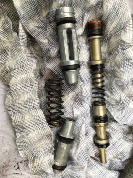

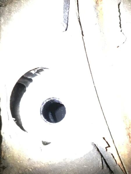

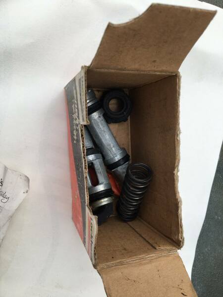

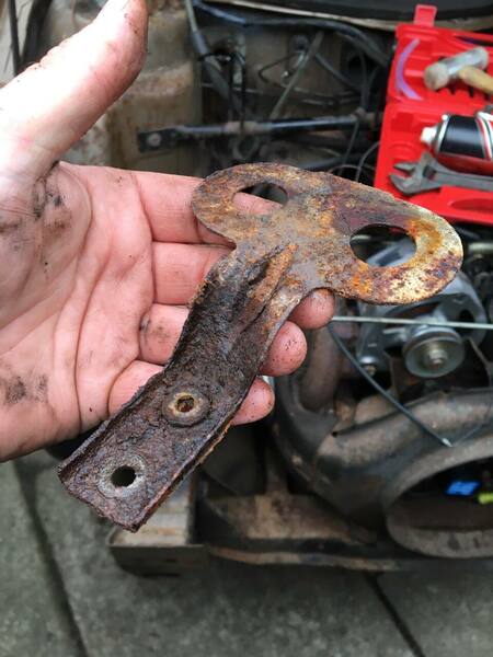

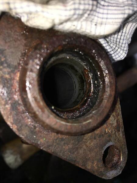

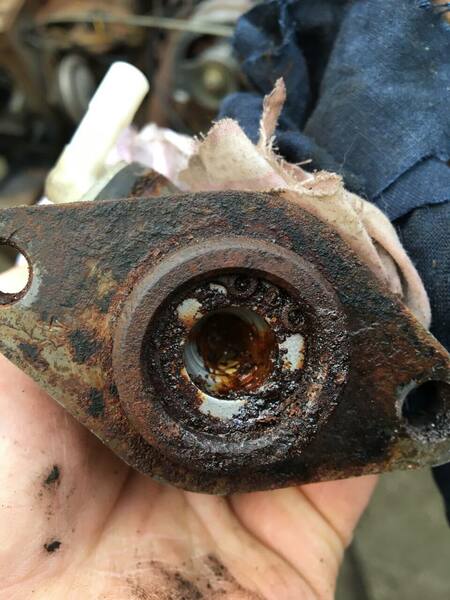

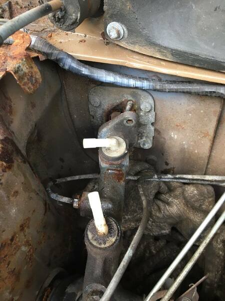

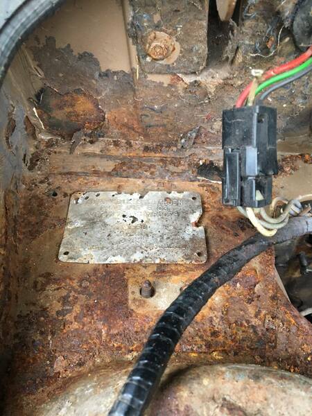

Lankytim Posted November 20, 2021 Author Share Posted November 20, 2021 I took a break from trying to burn the starter out again and turned my attention to the brake master cylinder. It leaks over the clutch pedal and looks mega manky. After sucking all the fluid out I removed the BMC, fluid reservoir and mounting bracket. The area the bracket is mounted is one of the worst looking areas of the car, there’s loads of corrosion. It was mostly caused by a rodents nest in the area, presumably the mouse piss helped to dissolve the vin plate too. The rust is just surface luckily so will hopefully respond well to some TLC. The brake master cylinder was in a bit of a mess, the circlip was rusted in and only came out with a bit of force. Luckily the bore didn’t appear to be too bad, another stroke of luck was the Visa came with a master cylinder rebuild kit complete with a random receipt inside the box. Of course, when I dug it out I found it was for the later model with a 20mm bore rather than my early one which is 17mm odd. From what I’ve seen there’s two types, a cheap and plentiful one and another which is like rocking horse shite and is expensive. Remembering back I replaced the BMC on my Volvo as a rebuild kit didn’t work so It’ll probably be prudent to hunt down a new one anyway rather than fanny about trying to repair this one. The mounting for the BMC looks like it can also accept the other more common sort with a servo, I’m still looking into the practicalities of doing this as it might work out cheaper, plus I’ll get assisted brakes. Does anybody have any ideas if the servo is shared with any more common models I can pilfer from a breakers? AX maybe? djim 1 Link to comment Share on other sites More sharing options...
grogee Posted November 20, 2021 Share Posted November 20, 2021 Is there a vacuum intake you can use for the servo or will you just fashion one on the intake manifold? Servo brakes are probably a decent upgrade. Not that it's going very fast at the moment. We're all behind you though - keep up the shite work Lankytim 1 Link to comment Share on other sites More sharing options...
