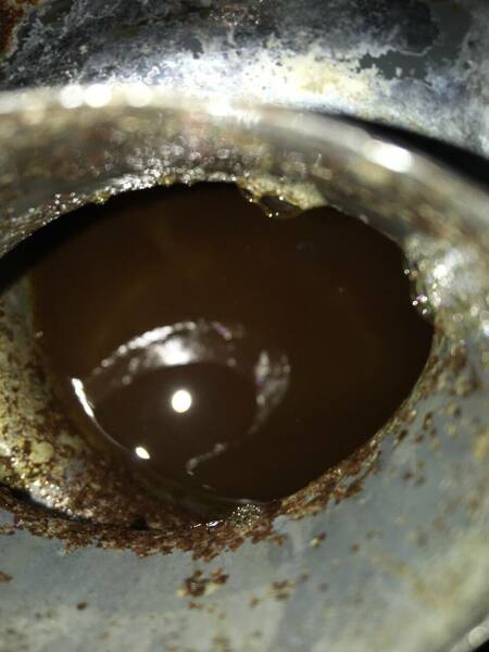

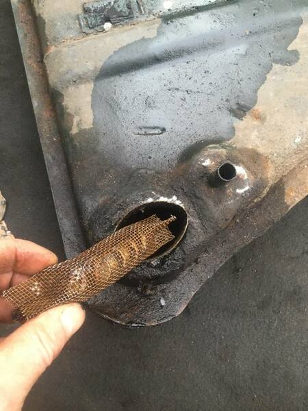

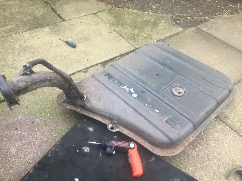

The amount of shite hitting the fuel pump is ridiculous so I’ve removed the fuel tank to take to work and steam clean. It’s been off once before but I didn’t do a very good job of cleaning it out, a house move meant I just gave it a swill and stuck it back on so it didn’t get lost or damaged. Hopefully a more thorough clean will sort things out.

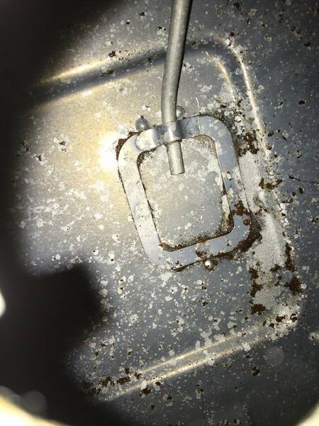

Inside the tank was 5 litres or so of dirty petrol plus loads of corrosion and debris. The fuel sender has certainly seen better days but will hopefully be recoverable. While swilling the petrol around to remove as much crud as possible I noticed a clanging noise. I assumed it was the remains of a damaged fuel sender or filler cap that had fallen inside the tank but it turned out it was one of those bags of lead pellets designed to allow old cars to run on unleaded. They were all the rage in the early 2000s when people started to worry about the damage unleaded petrol would do to cylinder heads and valve seats. Obviously it’s since been proven that these pellets don’t do anything at all. I think it’s the first time I’ve actually seen one of these bags in real life rather than in an advert in a magazine. I’ve kept it to one side to dissect and analyse later.
Im not sure if these 2 cylinder engines would’ve benefited from any sort of “effect” these pellets had, don’t they have alloy heads with hardened seats from the factory anyway?
Yes, hardened valve seats as standard. One 2CV parts supplier said you might as well add chocolate to your tank if you thought a bag of pellets might do anything.

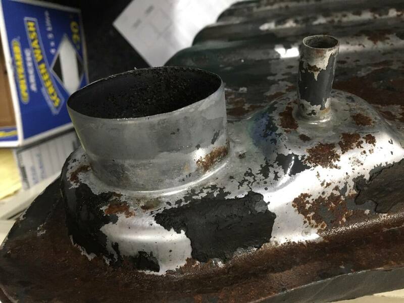

I was surprised at the level of shite in this tank. It’s been laid up for 10 years but I suppose the tank is still 40 years old in total so there would’ve been plenty of time for rust to form when it was on the road. The tank externally is in great shape. I’m praying that there’s not wafer thin areas formed by internal corrosion that will suddenly make themselves apparent when I jet it all out tonight.

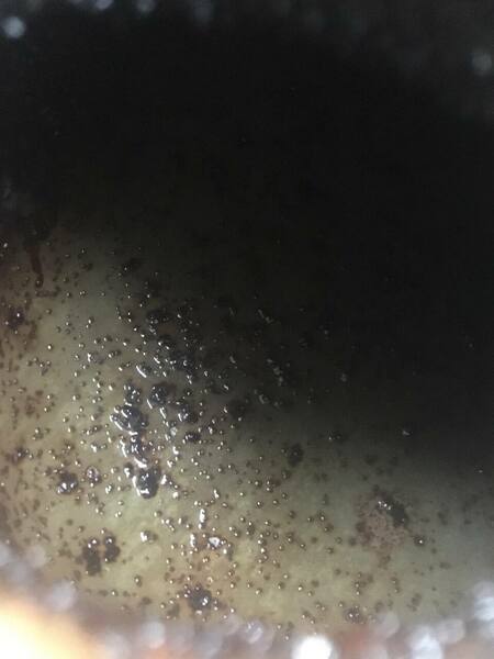

Apart from the rust flakes there seems to be a lot of silt or sediment in there. How this forms is anyone’s guess. Can it drop out of old petrol or something?
I think it's from when petrol starts to degrade into effectively deck varnish and solids form as a result. I imagine powerful thinners would re-dissolve the shite enough to be strained and used as a parts cleaner/lawnmower fuel

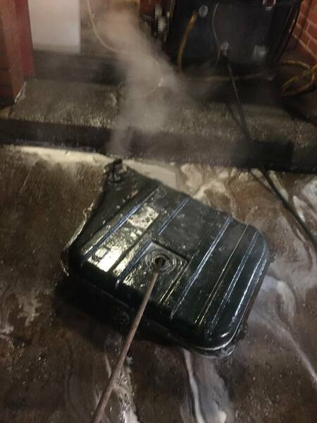

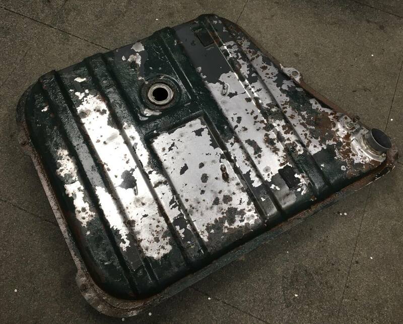

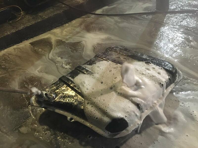

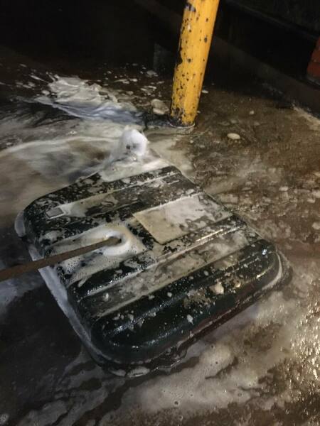

I’ve managed to sneak this tank into work and give it a blast on the steam cleaner. With everything turned up to 11 I set about getting it squeaky clean.

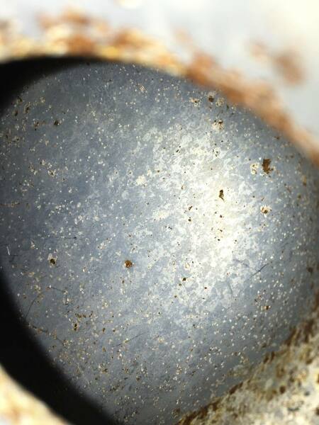

Not much crud was evident when blasting it out, possibly the high pressure jet of soapy water made the debris hard to see as it flew everywhere. I managed to clean the inside and outside of the tank several times before the steam cleaner packed up.  A quick peek inside revealed a transformation but some areas of stubborn varnish like material persisted. I’ve half filled the tank with neat TFR for a few hours in an attempt to get it shifted. The light green tinge of the TFR has turned to a murky brown colour so it certainly seems to be doing something.
The tank seems to be in good shape with no leaks and under the grime is galvanised which bodes well. After another hour or so I’ll swill the tank out with a hose and leave it to dry out.

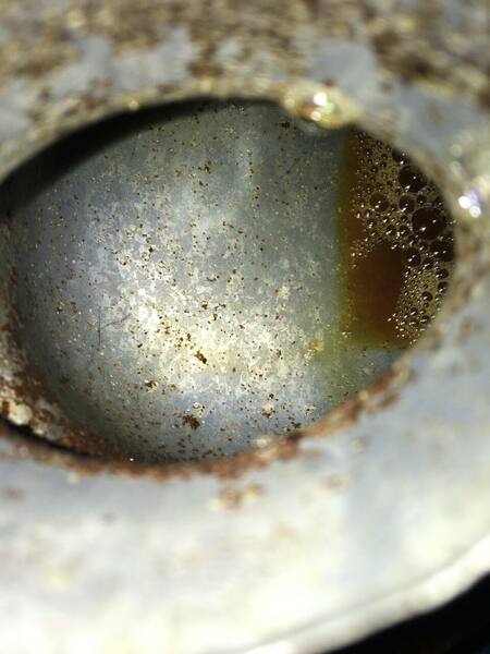

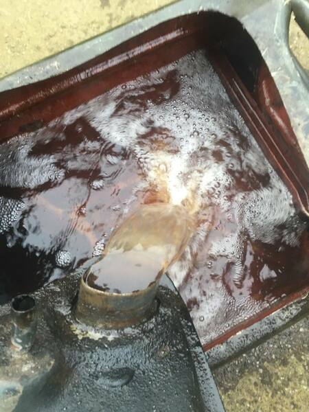

After a final slosh around of the TFR inside the tank I poured it out. I wish I’d taken a photo, the liquid that emerged was a vivid reddish brown colour and absolutely stunk,  It looked a bit like creosote! I used a hosepipe to fill the tank with water and sloshed it around to try and remove any traces of chemicals. After a few swills the water emerging was nice and clear, the tank now looks a million times better inside although I can feel corrosion with my finger on the inner top surface of the tank, although I can’t see it without an endoscope or similar.  It’s currently drying out against a radiator.  I’ll have a look at the manky fuel sender tomorrow and if I can get it to a satisfactory level of serviceability I’ll get the tank refitted.
The tank is currently sat in the living room and is now totally dry.  There seems to be quite a bit of loose dust like rust on the inside of the tank on the top panel that’s falling off and rattling around. I’ve used a Hoover to remove it from the filler neck and after a few taps on the top of the tank to make as much rust as I can drop off it seems to have stopped.

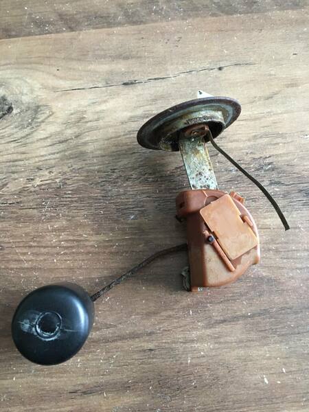

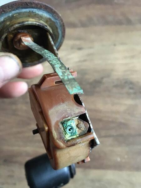

On to the sender… after popping it all apart a whole load of crap was removed, including the usual rust and varnish. Unfortunately I broke the earth strap so that will need repairing before it’s refitted. I’m not even sure if it works or not but it seems pretty simple so fingers crossed.

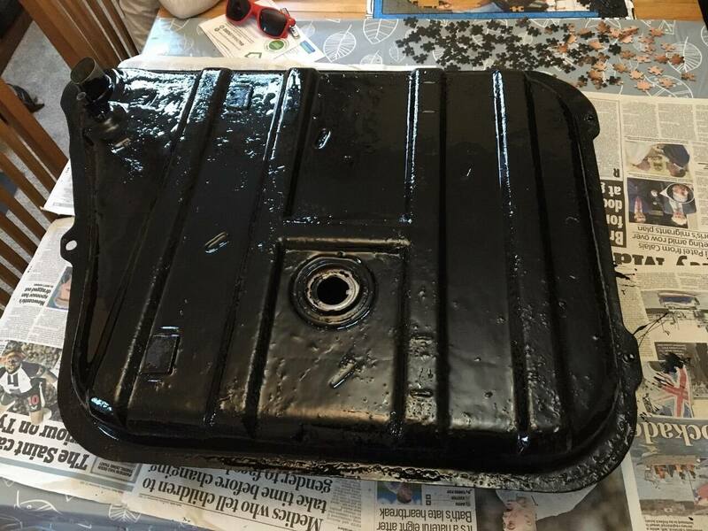

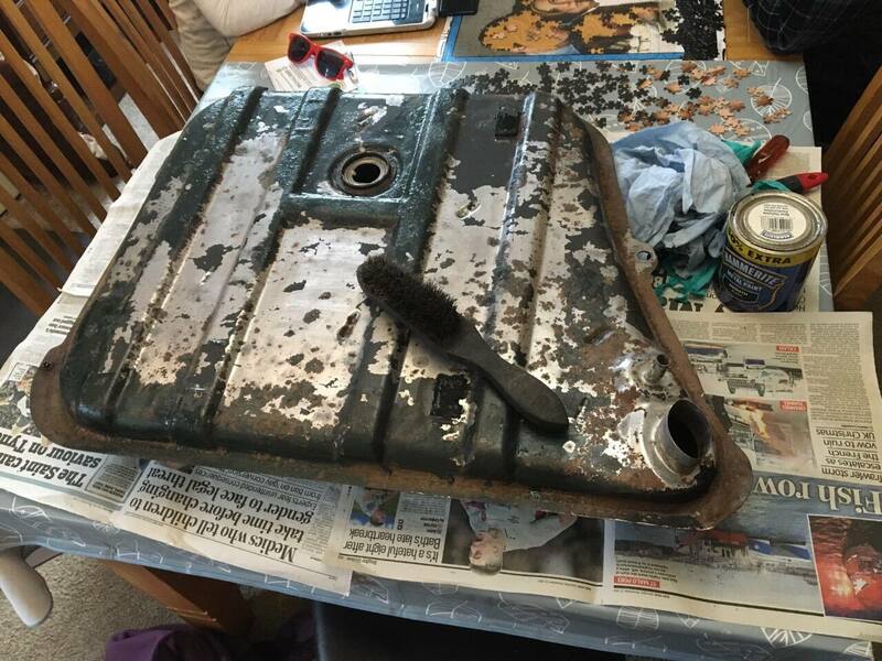

I got the urge today to do some Visa stuff so plonked the clean fuel tank onto the dining table next to the wife’s jigsaw puzzle much to her bemusement. Loose rust was quickly removed with a wire brush and a nice coat of black Hammerite applied. Hopefully it’ll be dry by the morning. I won’t bother doing the underside as it’s already well protected by Waxoyl or some similar product.
