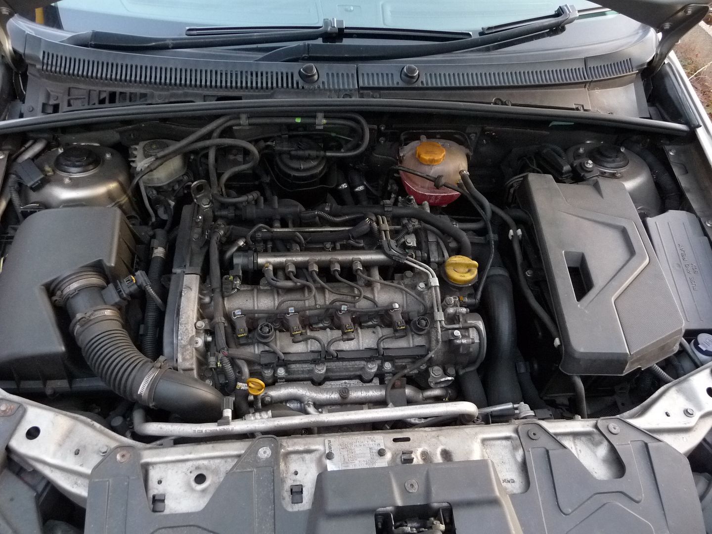

Popular Post Mr_Bo11ox Posted September 13, 2019 Popular Post Posted September 13, 2019 Hey gang, Not been on here much lately as I am decreasingly inclined to interact with other humans generally, but I though you might like to hear about the latest old heap at Castle_Ballsack, if it was a jolly happy story of great success it would be boring right? RIGHT. So a while back I asked on the 'shite for sale' board if anyone had any ideas or leads on a ~£500 diesel clunker that would do me for a couple of years and replace the old Stilo which after 40,000 miles could do with some money spent on it. A few good suggestions came up but I actually already had an idea what I wanted. A Fiat CROMA!! Why did I want one of these? Well the main reason is they are surely one of the most shite cars out there of their era (2005-2009 ish). Rare, a bit pointless, hopefully quite comfortable, cheap, and red-hot shite DNA: Its basically a reskinned Vectra C with cheaper switchgear and odd styling. Most have the 1.9 16v diesel engine straight out of a Vectra/Astra/Saab 9-3/Alfa 147/159 and probably several others. Theres not loads about, so i kept an eye on eBay and facebook and eventually one came up in Nottingham, not too far from me. It looked clean and was up for £550, with a short MOT though. After a week it came down to £450 so I went to have a look. I had a short test drive and it seemed OK, a few clonks from the suspension but the engine seemed alright, only one warning light for a problem with the reversing sensors and it was otherwise very clean and tidy. SO we shook on £400 and I drove it home a couple of days later. Took it for an MOT which it failed on rear 'Banana arms' (upper suspension arms) which are common to the Vectra and cheap to buy, plus a number plate light. Also got advisories for a minor leak on the exhaust flexi and an inner track rod balljoint. I set on fixing this lot then got sent off to China for a week with work so I lost my re-test slot annoyingly. When i got back i fixed everything including the advisories, and took it for another test which it passed with a clean bill. So then i insured it and started driving it 100 miles/day to work. Lets have a look at it: Its quite a tidy old thing, seems to be the original paint all over. Got a few odd scratches and marks but no real rust to speak of. The interior is quite pleasant, you sit quite high up with good lumbar support and the gearlever is high up and falls to hand quite well. Its nice and light in there. The cover is missing off the fusebox cos I had had the old Delphi diagnostic doofer plugged in to help sort the problem with the reversing sensors (bought a new one off ebay for about £8). I havent fathomed out how to get an AUX in wire into the factory stereo yet which is annoying as its limiting my podcast throughput. The ignition key lives between the seats, which presumably is a bit of Saab 9-3 technology thats inexplicably got carried over. (The keys are not quite the same though). ONe problem I do seem to be battling with is that the key fob seems to lose its synchronisation overnight. You can still get in the car the next morning with the emergency metal key, and when you put the placca key in the ignition it re-syncs and the fob then works for the rest of the day. Very weird (and annoying). Something thats really shit is the boot, its obviously an estate car but there is a massive step across the boot floor when you fold the seats down. Lousy for carting wardrobes or whatever. Anyway I got it on the road. With the new suspension bits it rides really well, but I was a bit disappointed with how it went. 150bhp ought to push it along quite well but it felt a bit asthmatic, it went OK in 3rd and 4th gear but was defo not as lively as the Stilo which has 30bhp less. I plugged in the diag machine but there were no faults logged with the engine so I just assumed it was bogged down by its excessive weight (1600kg seemingly). Also despite driving like a massive ponce and making good use of the marvellous 6th gear I could not get beyond 40mpg which is a bit shit. Over the course of the week I read up on these engines and their seemingly endless problems with clogged up EGR systems and wanky swirl flaps in the inlet manifold. The manifolds seemingly wear out for fun and cost £180 for a replacement, plus its quite a war to fit it. I'd noticed a slight hiss or whistle from the turbo under boost which the Stilo doesnt have, and I expected that would disappear with the new front pipe but you can still hear it a bit. Now I'm a bit wiser I think thats a boost leak round the swirl flap spindles. Anyway after about 400 miles, during which I was on permanent alert for funny noises and behaviour, you can guess what happened: Check engine light, and almost zero turbo boost. Uuuurrrggghh. I had kept the insurance and tax on the Stilo so today I was back driving it and the Croma is sat on the drive awaiting investigation. My plan is to remove the EGR valve, clean and free it (if its seized which is supposedly quite common), fit a restrictor on the EGR valve which seems to be a very popular mod and clean out the throttle body and MAP sensor. I'll clear the fault and see what that gives. I also pulled off the placca cover off the top of the engine: You cant really see it on here but I looked at the mechanism that operates these swirl flaps on the inlet manifold. Predictably it was all disconnected and broken!!! Its all little tiny placca balljoints and crank arms and doesnt look like it would survive a week's commuting, never mind 112,000 miles. So that is gonna need looking at too. Seemingly, official Pierburg manifolds you buy now are a bit better engineered than originals and last a bit longer but theyre still quite a big operation to swap out. I also found out that the cam belt is 40,000 miles/10 yrs old so that needs looking at too really. Thats all looking like £300 worth of parts before I've even started!!! https://www.ebay.co.uk/itm/Pierburg-Saab-9-3-9-5-Fiat-Alfa-Romeo-159-1-9-Inlet-Intake-Manifold-7-00373-12/303226983604?epid=252118112&hash=item4699bc94b4:g:e5gAAOSwSQFdLuxp Ah well thats shite livin' innit. You buy a 'new car' and end up lumbering yourself with a shitload of work that now needs doing urgently. I havent fallen in love with this car yet but then again I dont feel its had a proper evaluation because I dont think the engine has been running properly since I've had it. I think this car is going to teach me how to use that Delphi diagnostic computer properly, I can see it getting a serious workout on this POS. Anyway I'm off to China again on Sunday so I will do some proper investigation next weekend. Will let you know what I find. Le sigh...... Split_Pin, Skizzer, Asimo and 57 others 60

Cavcraft Posted September 13, 2019 Posted September 13, 2019 That 150 lump ought to be pulling that along very nicely. Hopefully piss arsing about with the EGR will sort that for you.

J-T Posted September 13, 2019 Posted September 13, 2019 I think there’s a lad on here recently done the exact same job on a Saab, may be worth a read. These manifolds can be removed without disturbing the belt by locking the fuel pump sprocket but if it needs a belt anyway... Are you planning on blanking the swirl flaps? There’s a kit you can buy for these Pierburg manifolds but I always think they look a bit shit, plugs with an O ring just pressed in. Can see them popping out after a bit. HMC 1

Mr_Bo11ox Posted September 13, 2019 Author Posted September 13, 2019 Yeah the manifold blanks look like a bit of a bodge to me. The manifold and head castings must be hugely complicated by having those flaps there, so there must be a decent benefit to having 'em. I reckon I will try to get it working properly, You can get an upgraded bar thing that links all the flaps together, which uses brass ball sockets instead of wanky plastic ones, might look into whether those bring any advantage. Split_Pin 1
vulgalour Posted September 13, 2019 Posted September 13, 2019 Calling someone a Swirl Flap should be a better insult than it is, given how frigging useless they are at doing anything other than breaking and getting in the way. DoctorRetro, Supernaut, BlankFrank and 5 others 5 3
SiC Posted September 13, 2019 Posted September 13, 2019 I fixed my swirlflap arm on my Saab 9-3 back in ~2011 with number plate caps. You can get better engineered solutions now - like this: https://www.ebay.co.uk/itm/For-VAUXHALL-SAAB-ALFA-Z19DTH-1-9CDTi-TiD-JTD-INTAKE-MANIFOLD-SWIRL-FLAP-ROD/231707948220?fits=Car+Make%3AVauxhall&epid=16025892869&hash=item35f2deb4bc:g:RAEAAOSwFrtbNLJb When I did it, it was quite remarkable how much power came back and how lively it was. I did another 25k with numberplate caps stuck on, until the car was rear ended and written off. Sod removing the fuel pump, cambelt and the like to replace the manifold. I believe @dozeydustman replaced his on the driveway though. That key in the Saab would loose sync if you pushed the buttons like 5 times or something when out of range of the car. Maybe the rubber is perished or something and pushing the buttons?

dozeydustman Posted September 14, 2019 Posted September 14, 2019 9 hours ago, J-T said: I think there’s a lad on here recently done the exact same job on a Saab, may be worth a read. These manifolds can be removed without disturbing the belt by locking the fuel pump sprocket but if it needs a belt anyway... Are you planning on blanking the swirl flaps? There’s a kit you can buy for these Pierburg manifolds but I always think they look a bit shit, plugs with an O ring just pressed in. Can see them popping out after a bit. That was me - details can be found here. You can lock the injector pump in place without removing the cam belt using a couple of the Allen/torx bolts from the top cam belt cover. It's a 22mm nut, and may require a tap with a Longbridge screwdriver. It took me 2 days to do because the HBOL wasn't entirely accurate, and I've not worked on a common rail diesel before. And I have huge hands to get in small places. Once the pump is off access is pretty good. Pages 5 & 6 of my thread. You will need Torx bits and sockets. 9 hours ago, SiC said: I fixed my swirlflap arm on my Saab 9-3 back in ~2011 with number plate caps. You can get better engineered solutions now - like this: https://www.ebay.co.uk/itm/For-VAUXHALL-SAAB-ALFA-Z19DTH-1-9CDTi-TiD-JTD-INTAKE-MANIFOLD-SWIRL-FLAP-ROD/231707948220?fits=Car+Make%3AVauxhall&epid=16025892869&hash=item35f2deb4bc:g:RAEAAOSwFrtbNLJb When I did it, it was quite remarkable how much power came back and how lively it was. I did another 25k with numberplate caps stuck on, until the car was rear ended and written off. Sod removing the fuel pump, cambelt and the like to replace the manifold. I believe @dozeydustman replaced his on the driveway though. That key in the Saab would loose sync if you pushed the buttons like 5 times or something when out of range of the car. Maybe the rubber is perished or something and pushing the buttons? If it's just the rod has come off, then you can get away with what @SiC has done, however in my case the swirl flaps were well and truly gubbed. I've still got the old manifold and I was going to clean it up and blank the holes where the spindles go. A lot of Fiat/Alfa/GM specialist seem to do this; the local Saab specialist recommend doing this as well. I'm not sure on the current legalities of removing the EGR system, it would appear that if it can be done without the MoT inspector seeing it's been tampered with you'll get away with it. Some googling produced this ☟ Quote Car Mechanics asked the DVSA for their response to fitting an EGR blanking valve and they said : "DVSA's priority is to help you keep your vehicle safe to drive, ensuring that it meets required roadworthiness and environmental standards. Vehicles may fail the MoT where emissions control equipment has been tampered with but irrespective of the MoT such modification is an offence*. DVSA continues to work with DfT to persue such offences, including taking disciplinary action against any MoT garages found to be conducting modifications." * Road vehicles (construction and use) regulations (Regulation 61a(3)). Removal of an EGR valve, diesel particulate filter etc. will almost invariably contravene these requirements, making the vehicle illegal for road use. The potential penalties for failing to comply with Regulation 61a are fines of upto £1000 for a car or £2500 for a light goods vehicle. egg 1

stonedagain Posted September 14, 2019 Posted September 14, 2019 12 hours ago, Mr_Bo11ox said: Yeah the manifold blanks look like a bit of a bodge to me. The manifold and head castings must be hugely complicated by having those flaps there, so there must be a decent benefit to having 'em. I reckon I will try to get it working properly, You can get an upgraded bar thing that links all the flaps together, which uses brass ball sockets instead of wanky plastic ones, might look into whether those bring any advantage. I fitted one of those kits to a Vectra C , a bit fiddly to fit but it was spot on.
wuvvum Posted September 14, 2019 Posted September 14, 2019 I had a Saab 9-3 with the same engine which kept going into limp mode - that was due to a gunked up throttle body, half an hour and £2.99 for a can of cleaner and normal service was resumed. That didn't have the problem with the floppy pissflaps though admittedly.

Dave_Q Posted September 14, 2019 Posted September 14, 2019 Hey Bollox, for one of these you probably want a £5 eBay VCDS cable and multiecuscan (free download). Should do a bit more than the Delphi thing.On your no power/noise situation, check the boost hoses. I had a Multipla with a 120 MJet engine with similar noise/power issues, turned out to be a split in the hose from intercooler to inlet. It was a relatively big bucks part but I got one that was close enough and bodged it.On the flaps, I think they are only used to reduce NOx at a specific low load point in the old emissions cycle and can be binned with no penalty to mpg, performance or MOT. strangeangel 1
