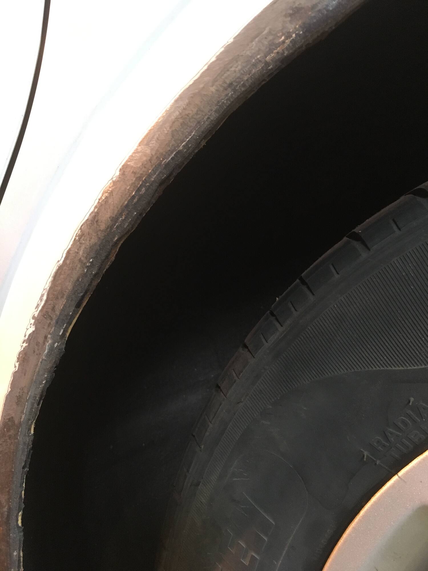

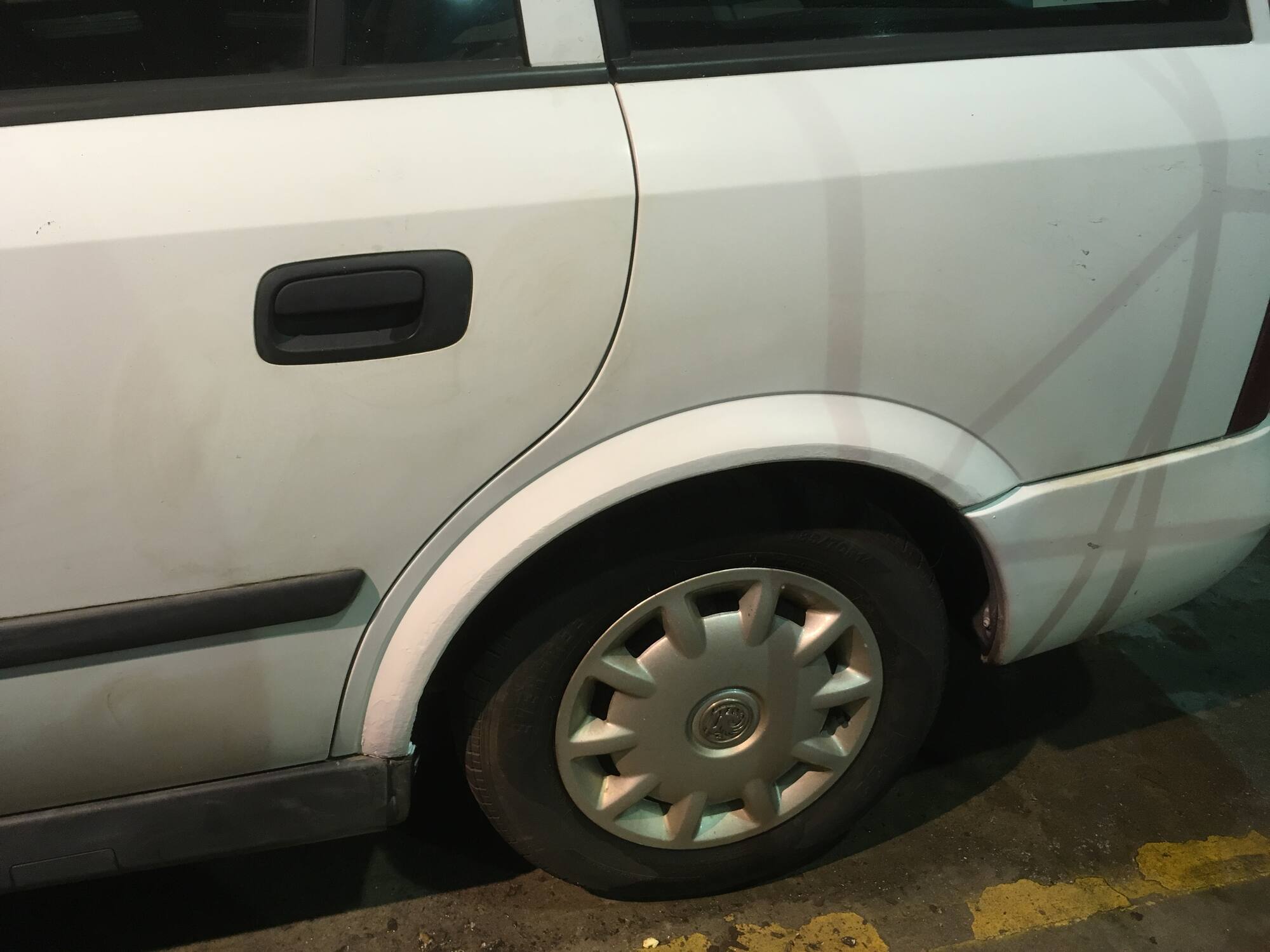

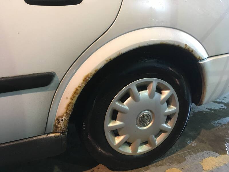

On a more serious note, I dropped by work today to touch up the arches on the N/S rear...
As with the O/S, thankfully it was all surface rust. Only ‘bad’ bits was where they rolled in, which you can see from photos 2 & 3 I just folded out and removed and then added a dab of sealant around the inner arch. Also buffed off some of the surface rust on the N/S front and again painted.
For a quick job, it really makes the car look better in my opinion. You only see it’s a rough arse job if you stop and look!

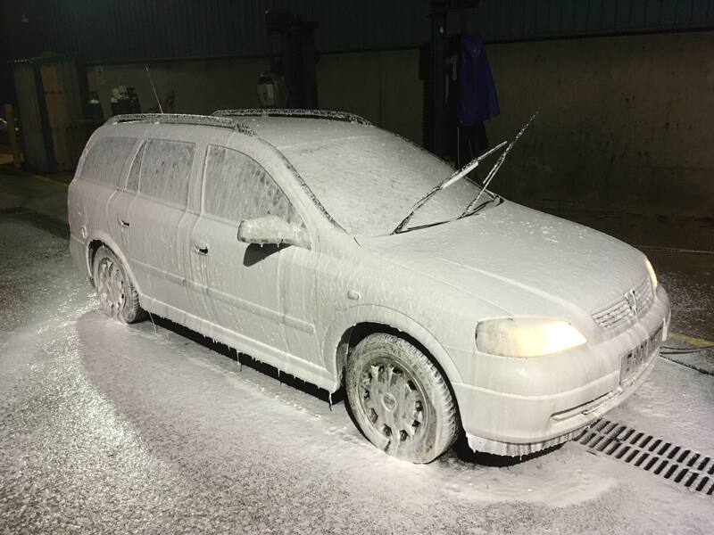

The other week I gave it a wash at work, industrial strength snow foam...
And...
Yes, it’s actually clean. The bodywork is just that good*.

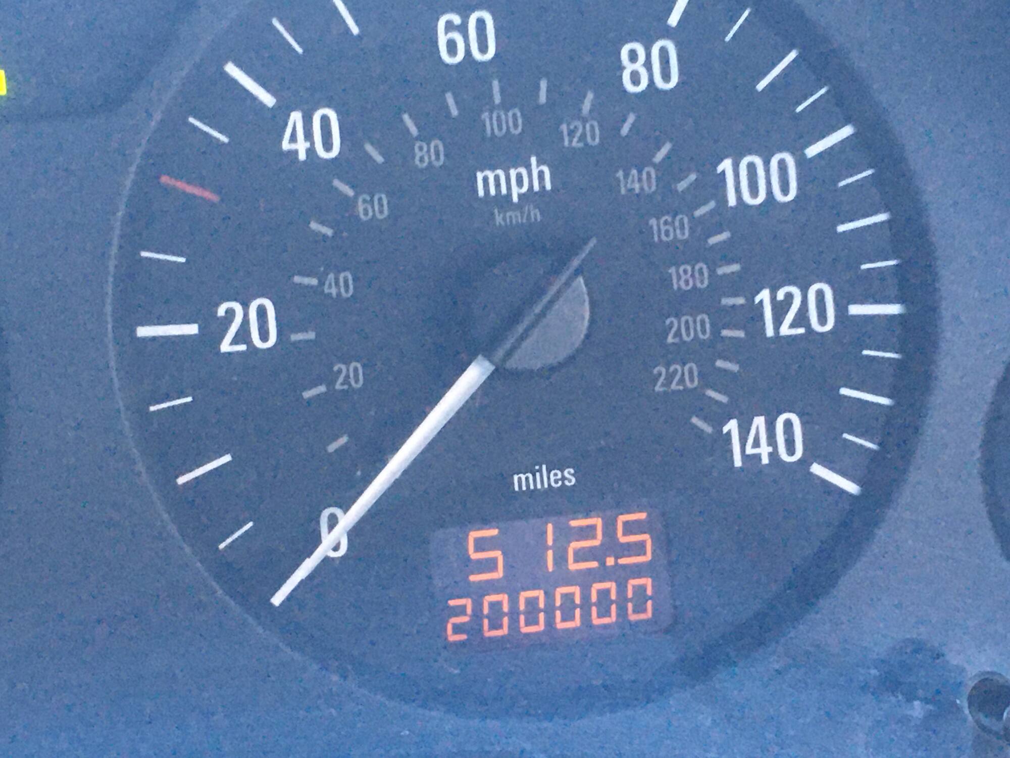

She made it...
200,000 miles!
My Reaction as I quickly pulled over and took the photo to celebrate the moment...
I may have intentionally been driving around a quiet housing estate that I was passing and waiting for the magic number to come, just to get a photo. I then treated it to a near full tank of Shell V-POWWAH diesel as a reward for its service.
My life is that exciting.

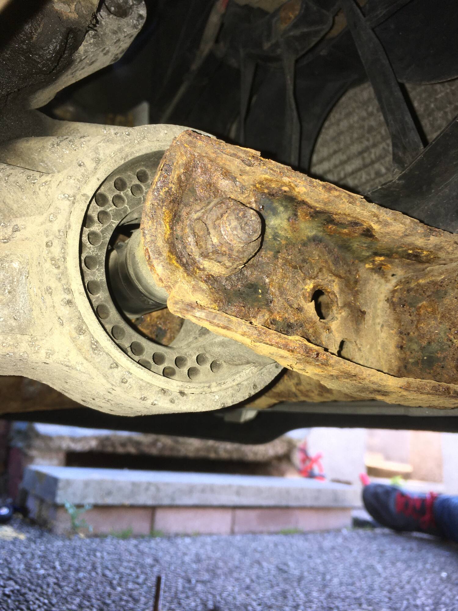

So literally after I hit the 200k mark I started hearing a bad noise, so rather than investigate I just parked it up in the driveway and waited for better weather...that day was today!
And I found...
Yeah, maybe the bottom engine mount is just a little worn. Maybe.

That's actually ok.
They are more of a bump stop than a mount. The new one you get will be just as loose. The tube bit just floats on a thin bit of rubber.
What and when is the noise happening?20200118_150841.thumb.jpg.be520db9d50489ad823daca14408d1bd.jpg
It’s properly gubbed, the rubber around the bolt tube has disappeared and you get a silly amount of play.
Jacked up the front and checked everything I could thing be making a clunking noise.
We’ll see though, I’m not in a rush to sort it.

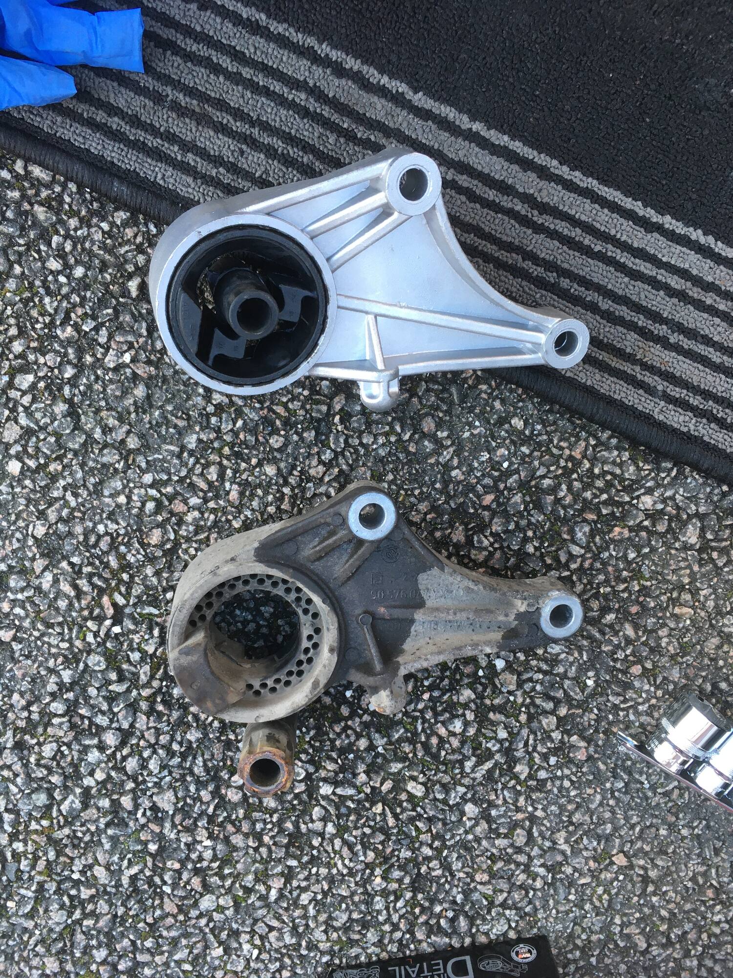

I got and fitted said front engine mount, fitted it yesterday...
New one is a £14 part from a brand I’ve never herd of. Hardest part was when I realized I needed a female torques socket. I have them of all sizes...in my toolbox at work. Bugger, then though “what if, I used a 6-point socket in place of a torques? Ho Ho Ho delightfully devilish Coffees!”
15mm worked fine. Biff bash boff jobs done. Took for test drive, the clunk and squeak sound had gone. Huzzah
