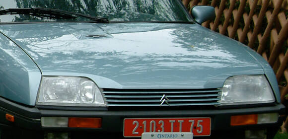

Firstly, what do these red french license plates signify? I heard they were for Diplomatic vehicles but they may have other uses:

Use to see red Ford badges on lots of cars but mk3 Escorts come to mind. I had forgotten about them.
