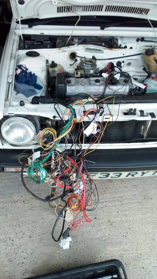

any ideas for a quality loom tape?  got a couple of wires to tidy up
