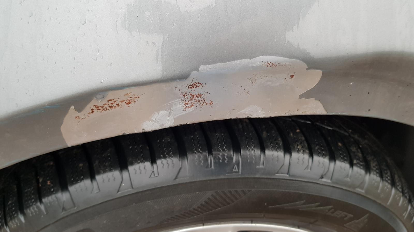

sierraman Posted February 18, 2018 Posted February 18, 2018 Can you use Deox C as a rust convertor to apply by brush or is it just for dipping rusty stuff in?

steveo3002 Posted February 20, 2018 Posted February 20, 2018 Can you use Deox C as a rust convertor to apply by brush or is it just for dipping rusty stuff in? i think they do 2 versions...one that makes up a liquid so you can soak bits n bobs in bucket , and a gel that can be brushed onto scabs and covered with cling flim read up on it...it removes rust , its not the stuff that turns rust black
