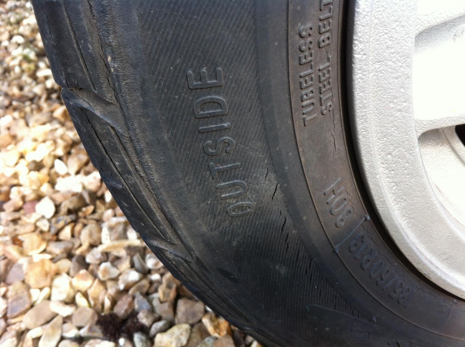

mossymossy Posted April 19, 2016 Posted April 19, 2016 I am looking after philibusmo's fiesta while he is away. It's due an MOT. Giving it the once over I noticed two tyres have sidewall cracks. Is this a definite Mot failure?
SiC Posted April 19, 2016 Posted April 19, 2016 I think its a fail only when the cords/canvas is showing. But I'd still not want to drive at motorway speeds with tyres starting to crack+degrade though.

Sigmund Fraud Posted April 19, 2016 Posted April 19, 2016 IMG_2145.JPGIMG_2146.JPGI am looking after philibusmo's fiesta while he is away. It's due an MOT. Giving it the once over I noticed two tyres have sidewall cracks. Is this a definite Mot failure? No they're not, cracks have to be particularly deep and wide (ooh, er...) for a tyre to fail the MoT. Such shallow cracks (ahem...) seem to be extremely common with modern tyres, I've been told it's due to their composition, something to do with silica content. They do look alerting, but I've driven many thousands of miles on tyres like those and lived to tell the story.

xtriple Posted April 19, 2016 Posted April 19, 2016 I've got cracks between the treads on the dollop I hope they pass 'cos I can't afford any more!
steveo3002 Posted April 19, 2016 Posted April 19, 2016 I've got cracks between the treads on the dollop I hope they pass 'cos I can't afford any more!as long as the cords dont show its advise ...but id not want to go far on shonky tyres xtriple 1
