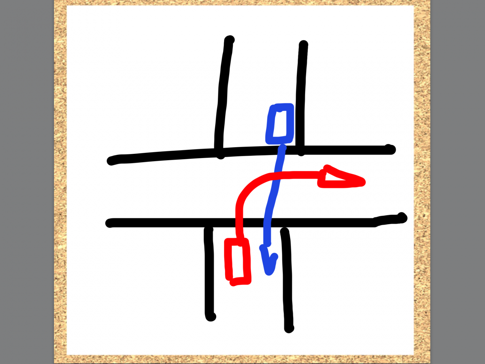

So, in the pic below, two roads meet at main road. I am in the red car wanting to turn right, some random old giffer is in the blue car wanting to go straight across - the main road is clear of traffic, am I right in saying that he has priority ? He sat there for ages looking confused then waved me across, I returned his wave and went on my way.
GM : yes I would agree with cobblers.  Perhaps easier to see when the main road is a wide junction ; then you would have pulled to the middle and waited for oncoming traffic to clear before you crossed their oncoming lane.

I thought you had priority, since once you're on the main road you're crossing his path on the through road and he's at a give way. Imagine if it was an ever so slightly staggered junction, it's easier to picture that he's wanting to go straight over, but there's a car going across in front. Which is you.
And a crossroads is ever so slightly staggered because of driving on the left.

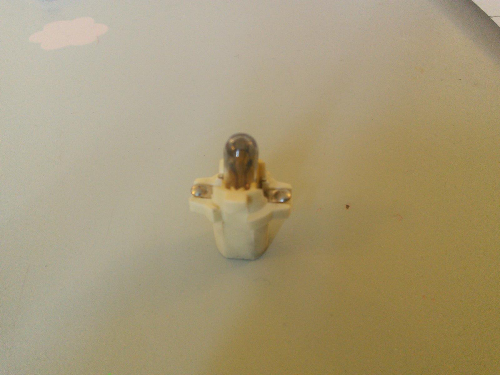

What is this bulb? From my mondeo headlight control. Probably need the whole little unit, as bulb doesn't come out easily. Not a 506ts which is a bit bigger.....
Has number 0593 on the side and also OL and 6 on it.
