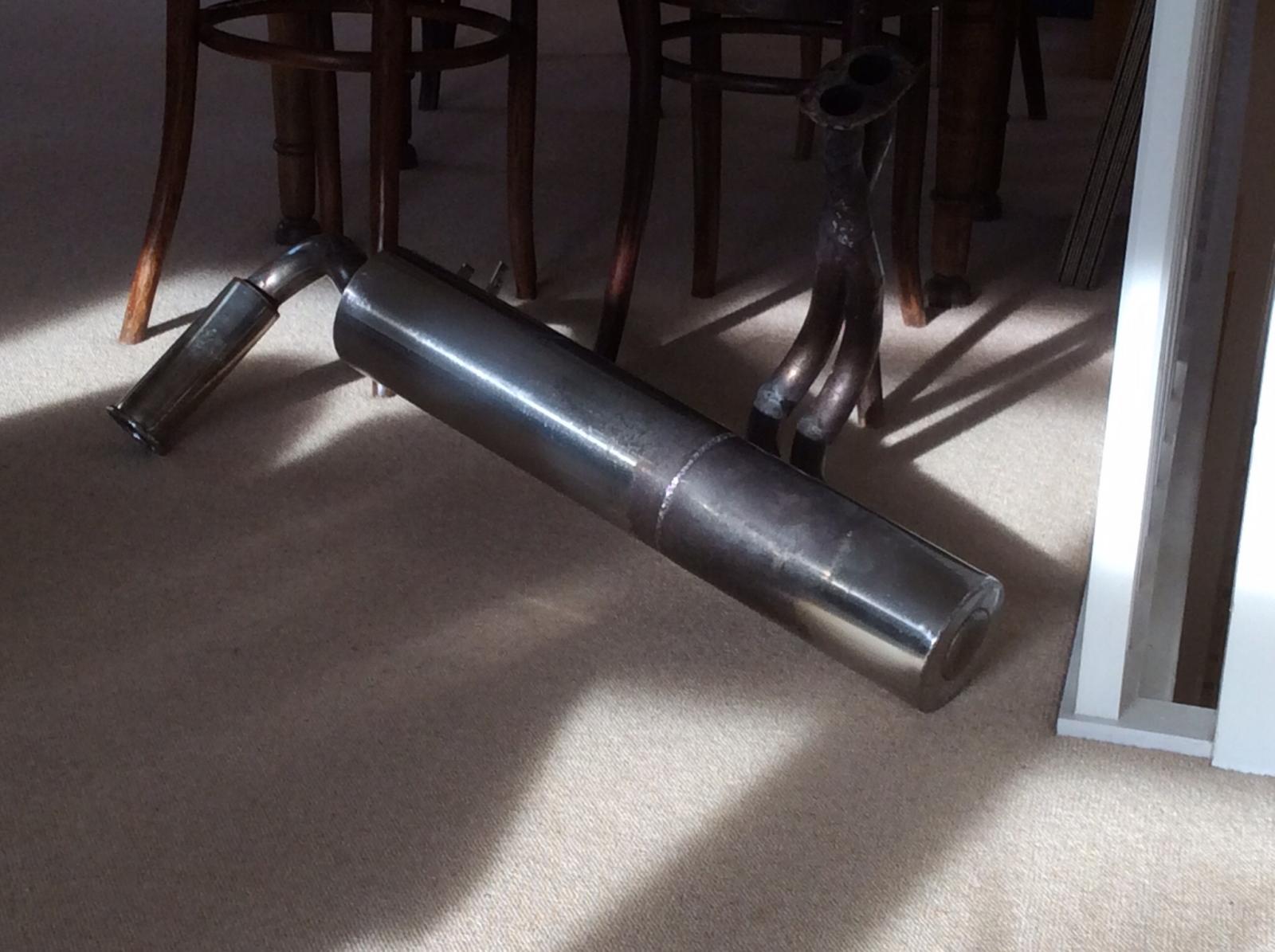

richardmorris Posted May 16, 2015 Posted May 16, 2015 Is fitting a stainless free-flowing exhaust like this, in place of the existing mildly"sports" exhaust going to need attention to timing?
