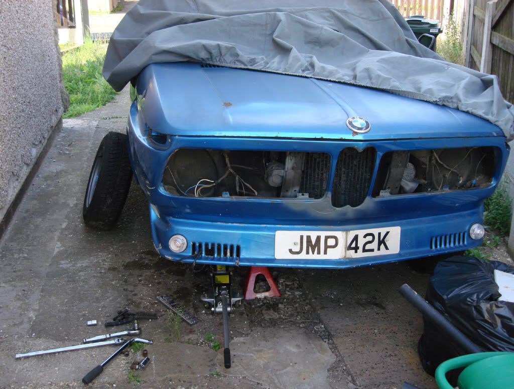

TimothyClaypole Posted February 21, 2014 Posted February 21, 2014 I have/had a Stormforce cover for my BMW, VERY expensive but it's kept it in the same rusty state it was when i bought it for the past 4 or so years (cripes I ought to get some work done on it...) Anyway the recent winds have killed it by ripping it to bits but it's gone brittle from UV I think so just tears easily now but it wasn't too bad lasting 4 or so years. (the cats still piss on it).
