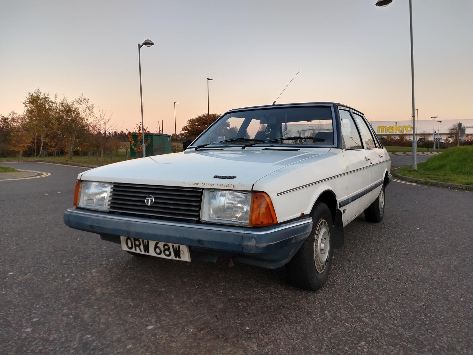

Following on from my introductory post, I have just bought this Talbot Solara.
It arrived with a plastic sheet over the passenger side front window as I was told it would not go all the way up by the previous owner. The driver side controls for the passenger window however seemed to work, albeit only slowly so I gave it a hand whilst pushing the switch and I was able to get the window fully up. The controls on the PS do not seem to work so I will have to look into this at some point, I just wanted to make sure it was watertight for now with winter coming.
More importantly, as this is now to be my only car to get me to work and back, I have to try and sort out this fuel related running issue it has. It will run fine from cold, however once fully warmed (a few miles into driving) it will hesitate and splutter, particularly at low revs whilst using little throttle. As you come to a stop the revs sometimes drop off, going below idle and then it'll want to cut out, not good! Interestingly, if let to cut out, it then starts right back up and runs fine.
So far, I've tried soaking the idle jets in the carb with cleaner overnight (as mentioned in the previous thread during Squire_Dawson's ownership) and refitting to see if that made any difference however it soon after returned. As far as I'm aware, it has a new carb which was also recently adjusted so it may not be this. I'm thinking there is already dirt/sediment in the system which could be disturbing the flow.
Today, I took off the fuel pump to see what it looked like inside - sitting on top of the filter, there was little bits of rusty sediment, which might have been enough to be causing this issue? I cleaned this up, refitted, and also put on an inline fuel filter between the pump and the carb to see if this made any difference and so I could see if anything gets collected on it's way to the carb.
Took it for a decently long drive afterwards to see if this worked and it didn't splutter/cut out at all which I'm happy with! It remains to be seen whether it stays like this though as it didn't used to do it on every drive so we'll see..
Overall, I'm enjoying driving her, the seats are comfy, it has a sprightly engine, and although a bit anti social, I like the noise it makes with the sporty backbox which was put on before I got it.
Here are some pictures of her:

Full winner status has been achieved. That is one sexy beast.
Super work! Whats cooler than a Solara with raised digit number plates and a black vinyl roof? Nothing on earth!

That is gorgeous. One of the earliest Solaras left and what looks to be Coventry registered too. Join the Simca/Talbot club. There are a few well clued up people on there that can help you with spares and advice. Your wise to put an inline filter in the fuel system, Solara and Alpine fuel tanks are prone to corroding internally with age. Very much looking forward to your adventures with it!
