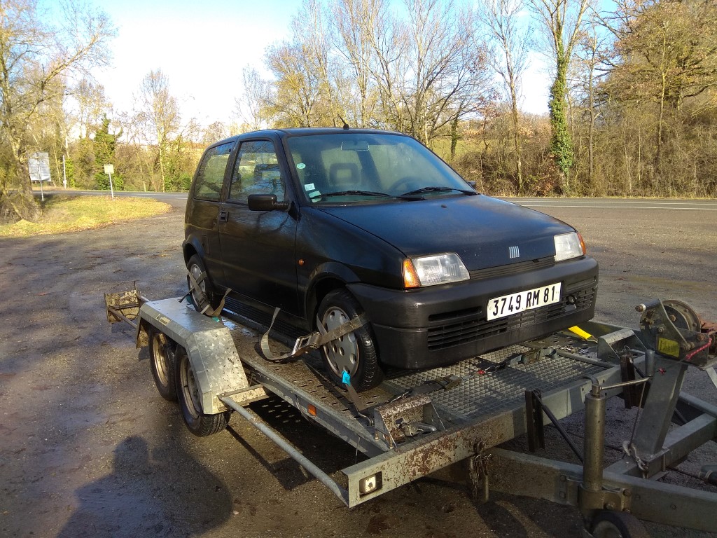

Giffer owned, 85k kilometers, not a spec of rust anywhere at all.

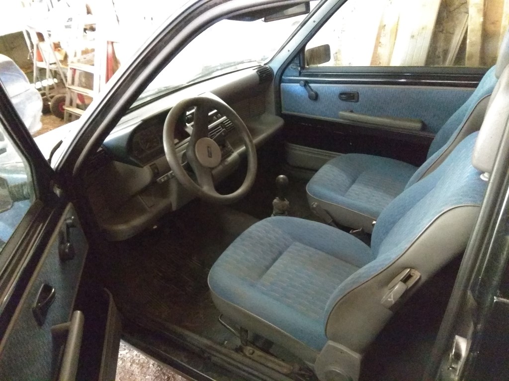

But this wee chunkychicken seems a really nice thing.
Its manky and has some minor giffer scrapes, but its sound and surprisingly well built.
The doors shut with a decent thunk rather than the cheap SPANG noise the panda makes.
Its reassuringly smol.
Nice.

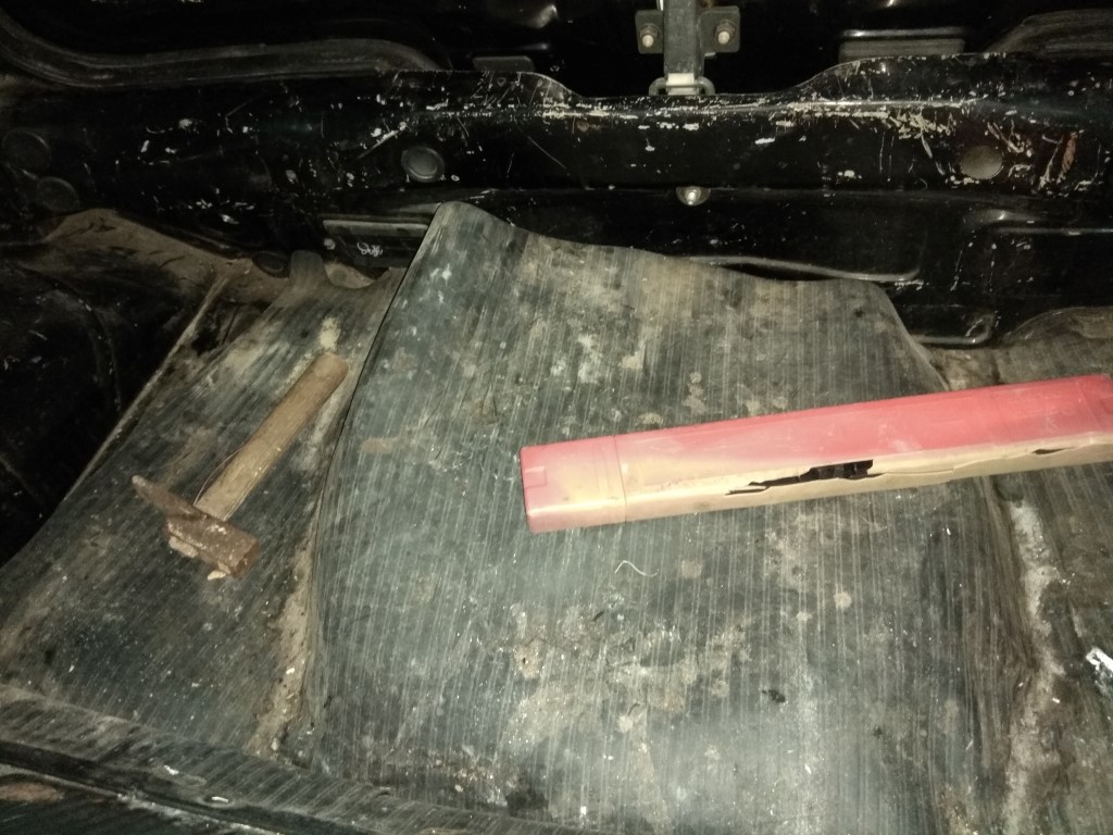

Free warning triangle and rusty hammer.
Under the mat is an unused spare wheel, jack etc and an extending wheelbrace.
Yeah, obviously its broken, but you can have everything, right?

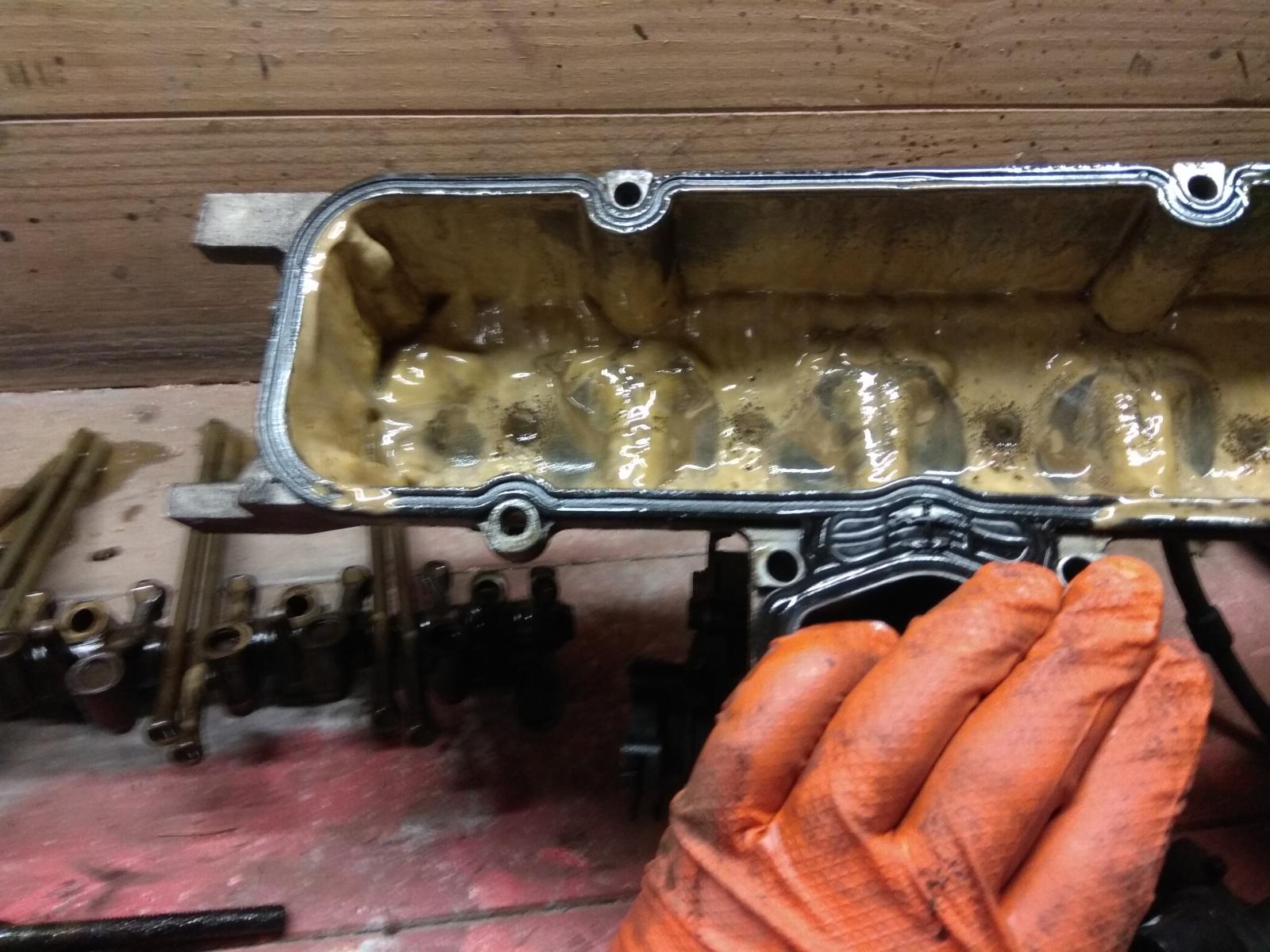

Very obvious signs of gasket failure, but despite this it sparks right up first turn of the key and idles smoothly and quietly.
Its an old pushrod design so changing the head gasket should be a piece of the proverbial.

Before you do anything with the car, please put that hammer head on the right way round!
( Or is it a special Fiat hammer for adjusting rust properly?)
It is right is it not? I bought a hammer like that from Bricomerde and the head was on it like that.

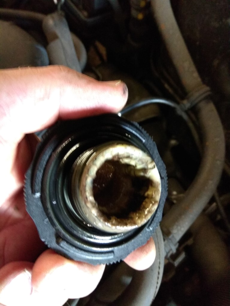

Guarantee by now the radiator is probably toast (and likely the reason the head gasket went), found that the ones that look like air conditioner radiators are a lot more efficient than the multi-flat-tube traditional type.

Edit: also yours is a later one without the bleed screw in the top heater hose. Bleeding it will be a challenge
Aye, no shit. Literally the easiest head removal on anything thats not a lawnmower. Seriously, i have played with Lego Technic that was harder.
Not much to it.
She is well clagged with goop though.
Forgot to get a photo but the gasket is well jiggered with loads of evident leaks between oil and water passages.
