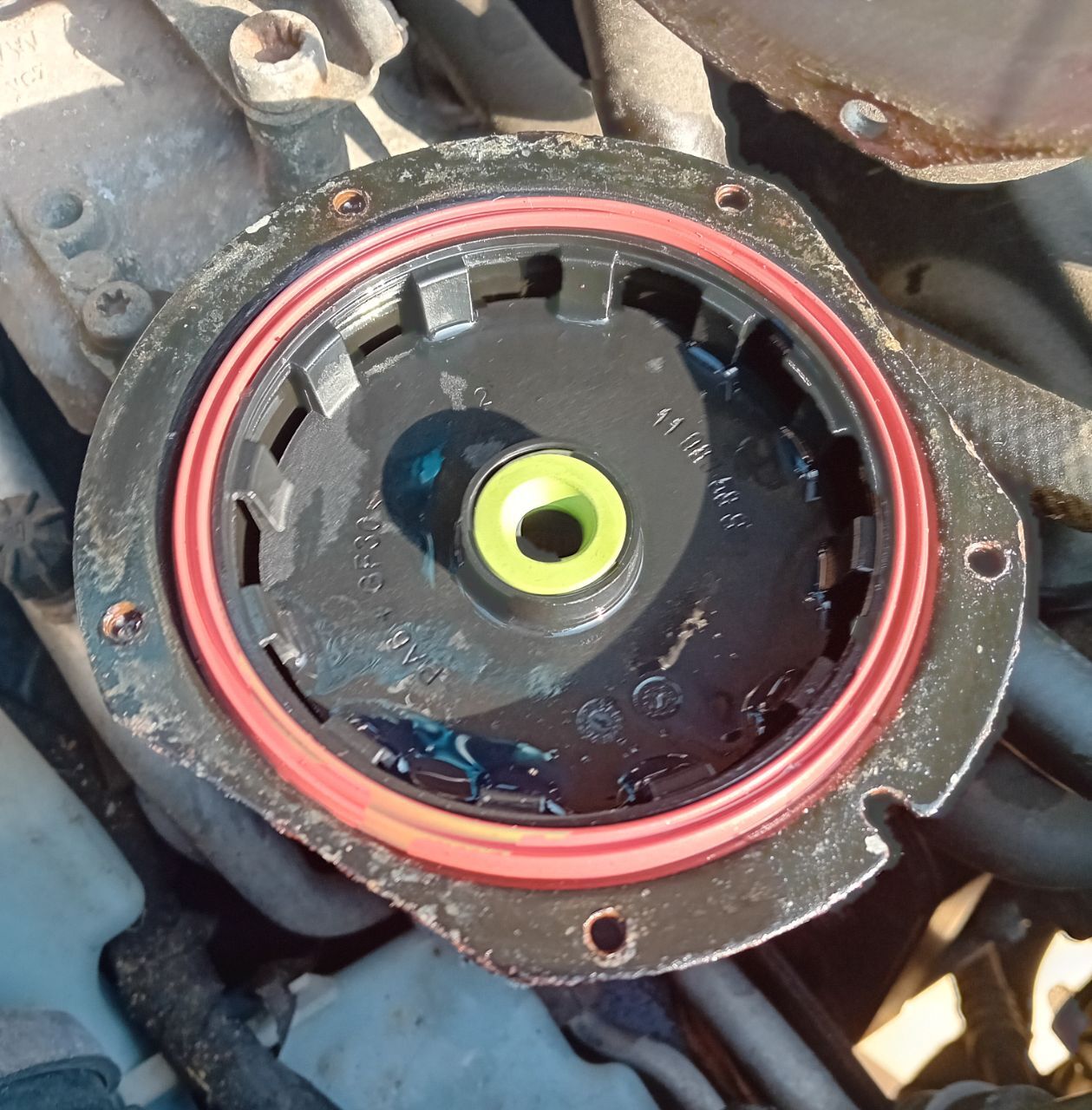

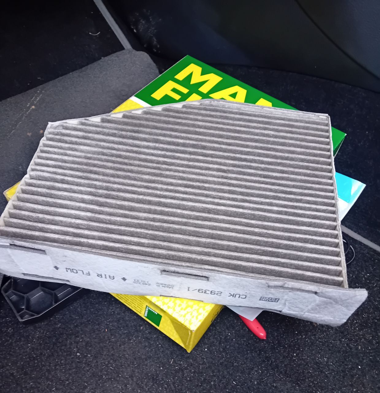

9 hours ago, Popsicle said:
As the Pisshat is now firmly on the fleet.
Quick processing by the DVLA.

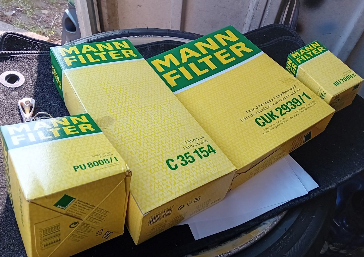

Time for a service. I will admit to being an unashamed Mann fanboi, its a hill I will die on, bestest filters ever.

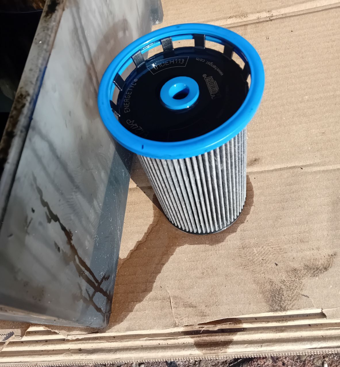

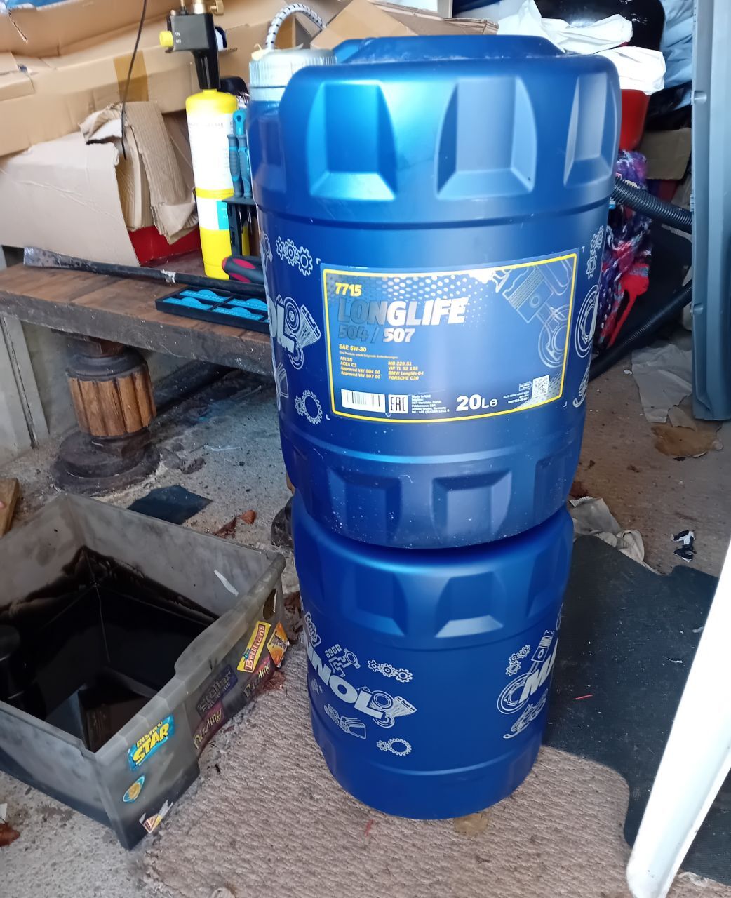

Oil, air, fuel and pollen filters from GSF, I've 40 litres of finest Mannol 507 spec oil as I use it in the caddy - incidentally the cabin and air filters are the same for the Pisshat and the caddy.
Although the Pisshat engine is a bit more modern than the Caddy, everything seems to be set up similarly, so nice and easy to get at everything.
Looks fairly clean and leak free for 214k miles.
The mate who I got the car off said it was last serviced about a year ago, he uses the same garage I use, so I knew it would have been done properly.

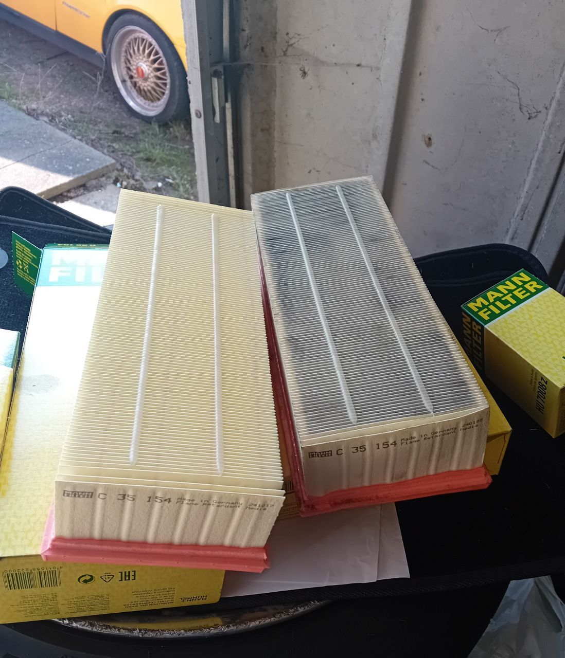

Air and pollen filter didn't really need changing, but I've done it.
Blue one is the old fuel filter, orange is the new one, again probably didn't need doing.
Oil filter was black, as expected, other than removing a bracket out the way to get to the oil filter, it was really easy to service.

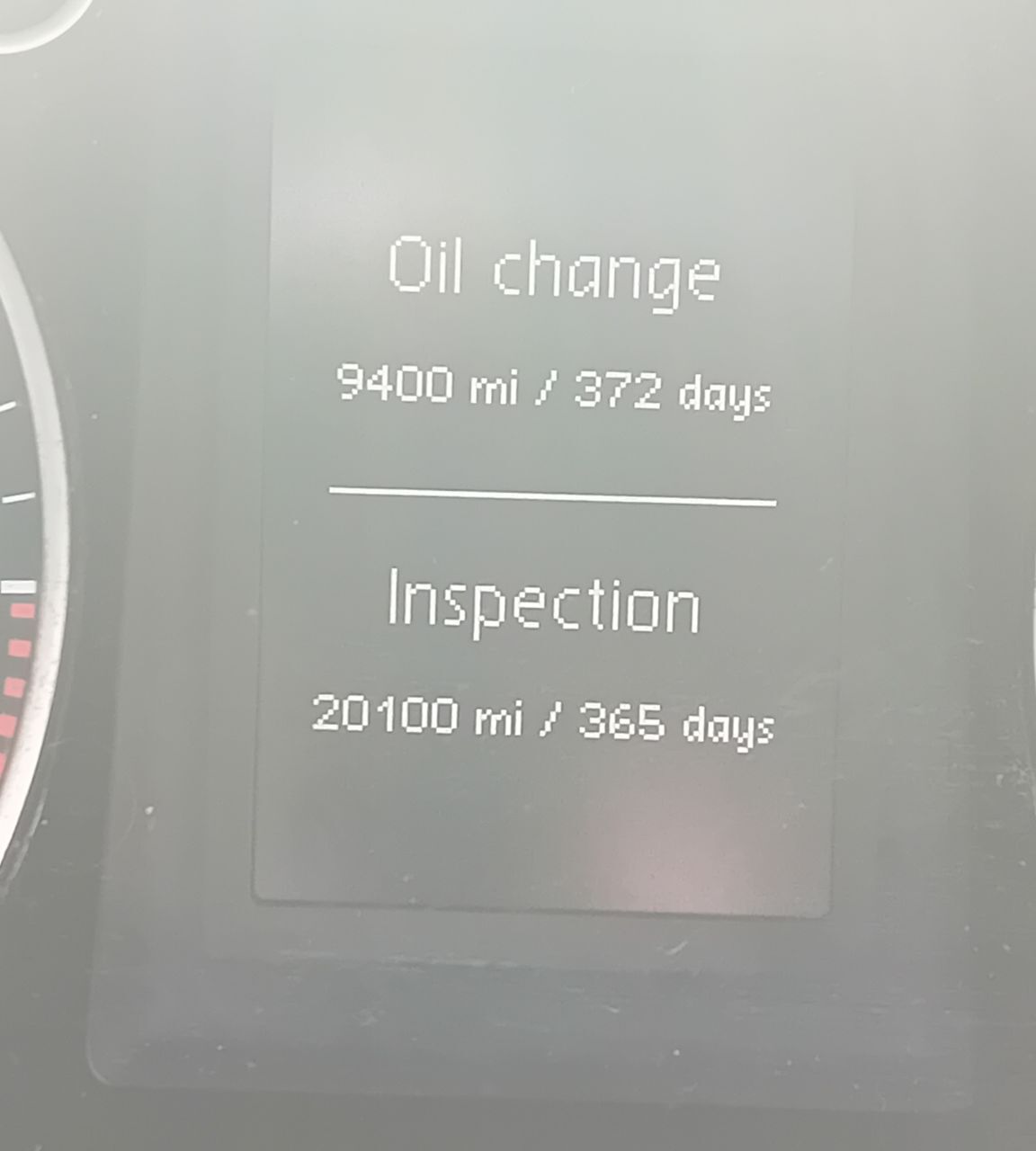

Reset the service and inspection reminders on the dash display, fuck knows why it says a service is due again in 9400 miles? Thought it would be longer than that.

Nice work! The Hengst filter that came out of it is good quality, too.

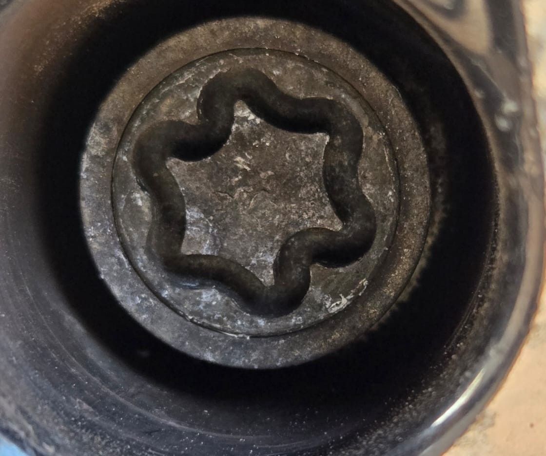

Thought I'd whip the wheels off the Pisshat this afternoon to give the brakes and suspension a check over.
Oh bugger, locking wheel nuts, I can't find the key anywhere. Asked my mate who I got the car off, he had no idea, thinks it must be in the car somewhere as he had a couple of tyres done last year - I've looked all over, can't find it.
I've messaged a matching service on ebay, send them a picture and they send you out the correct socket, £16.99, so pretty reasonable.
It just reminds me why I throw the fuckers in the bin on every car I've had, total pain in the arse - if I was feeling more energetic I'd have forced something on to the bolts and butchered them off, decided to go out for a meal instead.
On my old Passat it took a while to find the locking wheel nut key, the wheel brace etc was in a pouch and there was a small pocket specifically for the locking wheel nut
Thanks for the tip - I've been out and had another shufty, still not found it. There is a pouch in the bag for the wheel brace and jack, nothing in it though.
