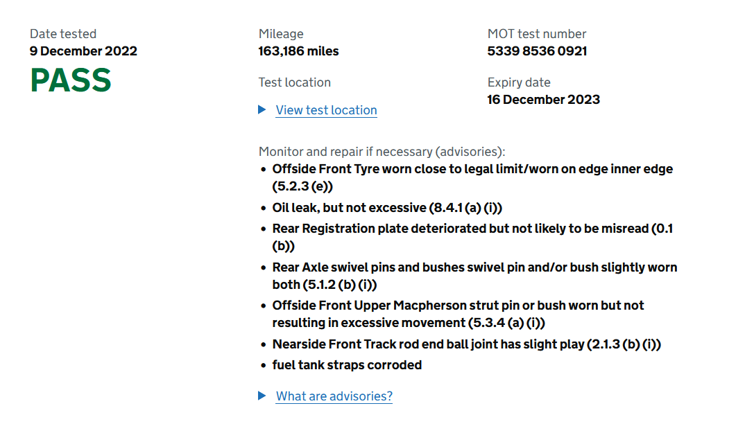

OSF strut pin being worn might explain the creaking noise when I turn the wheel.

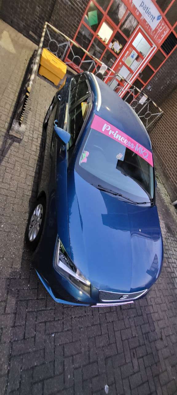

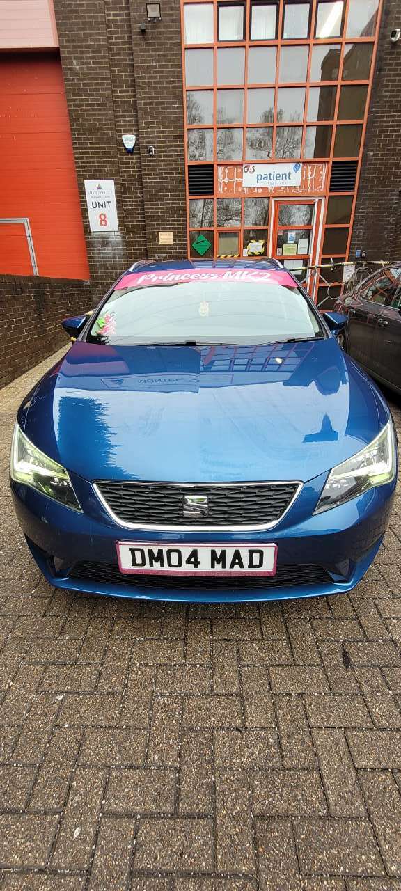

Missus stuboy wanted another sunstrip, so I got the guy who did mine, designed with the missus ideas, yeah some will scoff and laugh but she's happy..  what I'm not happy about was getting my v6 back with petrol light on and more bird poo than bottom of a budgies cage..

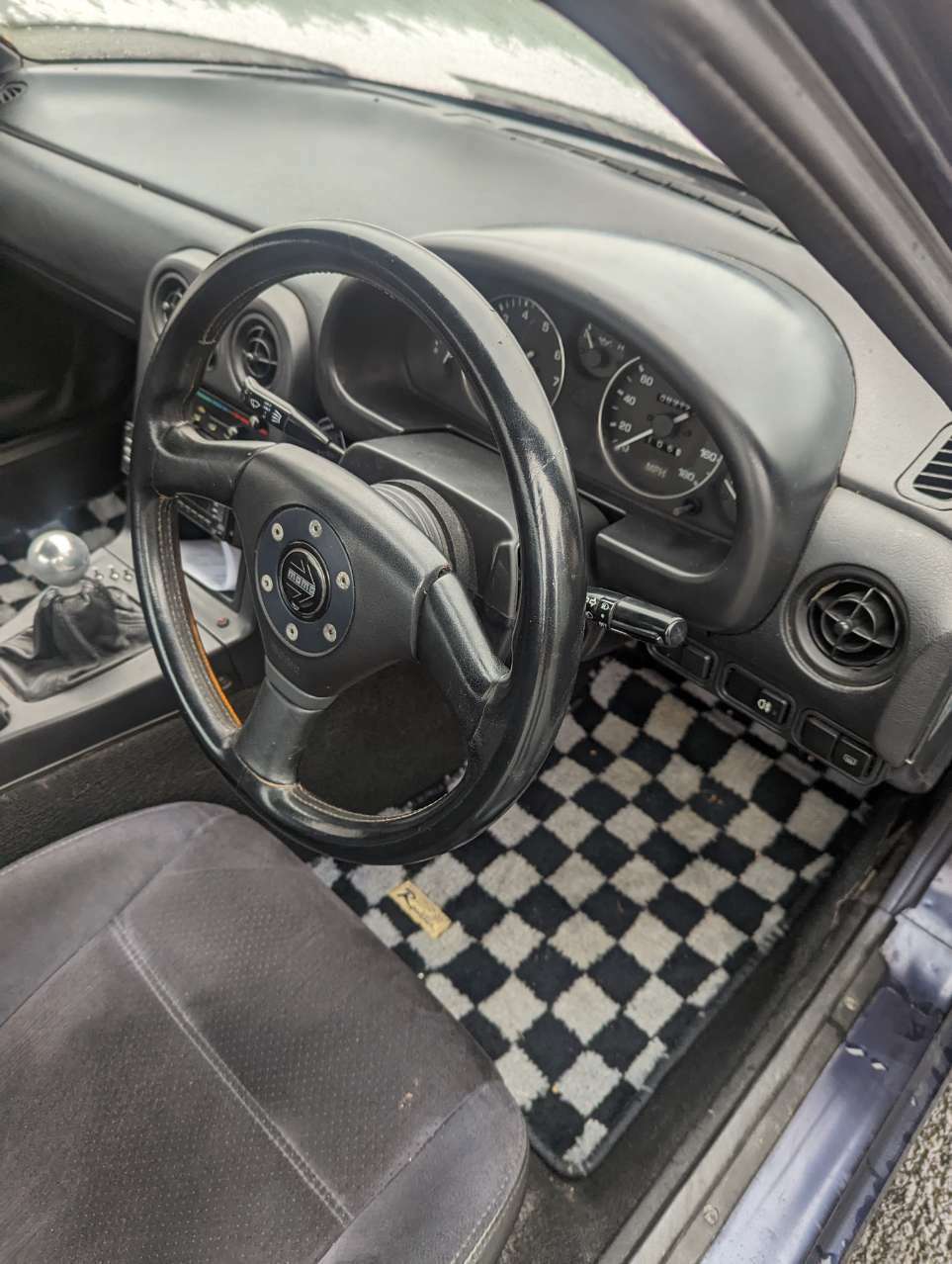

Took the removable boss off the Eunos steering wheel, horn works now and the stalks are comfortable to use. Won't have my arms as bent while driving either. Happy days.

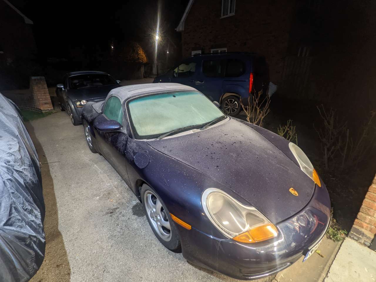

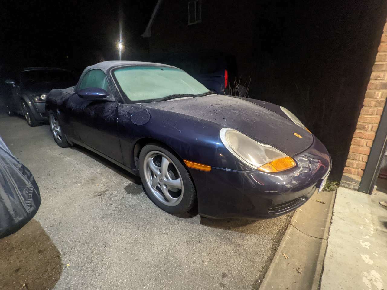

After feeling guilty having the Boxster sitting out freezing itself and unused, I decided today was a good day to sort storage and put it away. Still icy cold out and Quattro certainly hides the slippery roads - perhaps too much. You only really notice when you come to stop and have the abs kick in on touching the brakes. I'll replace the ditchfinders on it at some point.

Boxster then took it's space for the next few months. I really should have cleaned it down before doing this, but (a) the hose pipe is frozen and (b) I couldn't be bothered anyway. Also shouldn't have gone away wet from the frost melting but there we go.
Driving it reminded me of how it's such a great car especially against the TT. Steering gives so much more feedback and is nicely weighted, engine gives power nearly instantaneously and the gear change is precise with a great feel.
I thought the Princess Mk2 was called the Ambassador but I've been wrong before.
