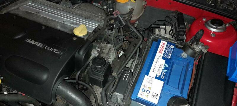

However I noticed that where the Saab had been sitting it had made an even bigger oil mess than before. Bollocks!
Anyway, boshed it in the garage and whipped off the vacuum pump again.

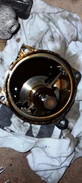

The new seal I fitted looked fine but I split the pump as there is a seal between the 2 halves.
For anyone that cares what a vacuum pump looks like inside here you go:

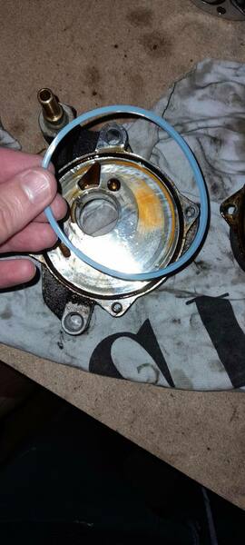

New seal fitted.20220912_191612.thumb.jpg.dd562ea885ec9f1f4f0412bbdeba94bc.jpg
I applied some Permatex to the mating face on the cylinder head to try and get it to seal.
All put back together again. I'll leave it sitting for a few days to make 100% sure the Permatex is dry.
