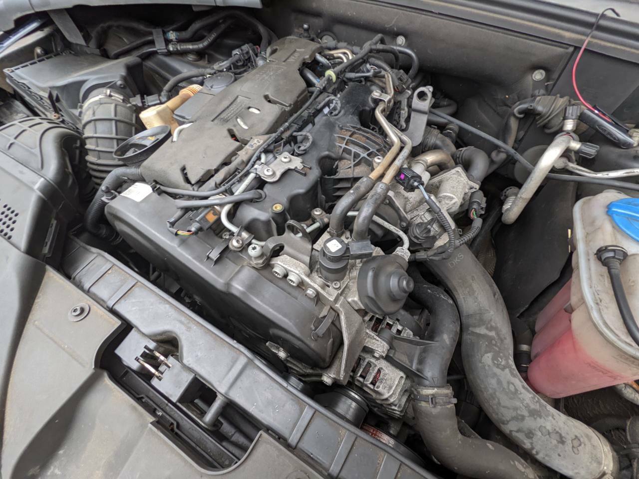

1 hour ago, SiC said:
Fuel rail clearly not building up pressure when cranking…
High Pressure Fuel Pump possibly? Worth a Google and Youtube search. Expensive but probably diy-able for someone with your know-how, I’d have thought.
…that’s if the car is a keeper of course. It has served you well.
Almost certainly yeah. It's going to be either that or the injectors really. Fuel pressure regulator unlikely as that was changed 70k ago. Also would have expected those 3 freeze frame codes to show it not dieing off like that.
Should pull the filter and cut it open really.
I guess could also be an injector leaking but I haven't noticed a lot of regens recently. Leak off test will confirm or deny that likely.
If HPFP then probably should have injectors as well if it's disintegrating internally.
Car take back say £675. In my mind that's the budget to fix. So if it sharts itself again soon after, at least I can get a recent expenditure covered.
It's just when do you call it quits? At least this is a major enough sharting that it's a fairly easy decision. But then given I don't have much to loose, I could DIY it.
Either way I think Mrs SiC will be getting a new car. Then if I get the A4 working, I'll sell the Fabia and use the A4 as the runaround.
Will phone my garage tomorrow to discuss potential options with them and what they'd be prepared to do too.

2 hours ago, SiC said:
Fuel pressure rail too low 😭
Might be terminal
Faulty sensor or pump?

I know that the HPFP on my 75 is nearly a grand new to replace but the accepted fix is to buy a 2nd hand one for £50 and rebuild it using a kit from ebay. I believe its quite a meticulous job but worth it for the saving of around £6-700 quid. I have all the gubbins in the wings should the need arise.
Can you do something similar with the Audi (if it is indeed the pump)

Yeah I'm pretty convinced its the fuel pump or injectors.
Nothing is really inspiring, especially for what everything goes for. To get another B8 that is around 2015 vintage and 100k+, we're looking at ~8k-12k. Not only that, most are lower spec than what we have!
Tbh we are both tempted by a Civic Mk9 hatch. Honda Civic is my go to vehicle in these scenarios. Will feel bit of a downgrade when sat in it though.
I'd go more with the pump. If it was reading over its more likely to be the sensor. Given its reading low, I'd expect the demand from the pump to increase and thus over fueling rather than under. You can see it in the video where the pump eventually builds up enough and then coughs as it drops back down again. Admittedly a sensor is a cheap and easy part to change.
That's pretty much the next plan is to contact my local garage and see what they say. Second hand HPFP aren't £50 unfortunately - more £200-400. There is a HPFP and 4 injectors going on eBay for £400 at the moment. No idea on labour time, but say ~4hrs (iirc cambelt change time) then £200 at £50. All in would be £600. For that sort of money it'd be worth a punt.
Thing is, as you probably well understand, Mrs SiC isn't keen on a car that has blotted its copybook like this. So either way she will want something to replace it. But for £600, I'd sell the Fabia and use the A4 as a run-around instead. Replacing her car will allow us to get something that is Bristol Clean Air Zone compliant too.

@SiC there is a really informative video about VAG tdis with the p0087 fault you described.
Definitely worth a look.
Interesting video, thanks. I knew a lot of it already but good to have a reminder with everything in one place and also a few numbers to test against.
I've just been out to run the pick up tank pump and the aux pump with VCDS. I can hear both running and running smooth which is a good sign they're working. Of course doesn't tell me if they're producing enough pressure though. But fuel should be getting up there at least.
I think the next step will be to take off the fuel metering valve and inspect for any metal particles. That'll be the smoking gun if it is the pump. Unfortunately he also mentions that is a common fault diagnosis!
Also want to do a leak test on the injectors. Interesting that you can also do it with a vacuum pump too. Might dig that out and give that a go too.
17 hours ago, SiC said:
Just rolled over to 210k too!
I think this might be the end of it.
RIP Little Soldier.
Took the fuel metering valve out of the High Pressure Fuel Pump.
PXL_20211223_110107765.thumb.jpg.ab1405d7dd3e083c20a35fb9e5b8bb9f.jpgPXL_20211223_110059401.thumb.jpg.20c6760ff478d009f13a805a84a39b6e.jpg
PXL_20211223_110453892.thumb.jpg.17394bedf7a0df738cb8807f108970ad.jpgPXL_20211223_110609913.thumb.jpg.8273f4c0c96ebff8e404d86e3baec30f.jpg
Verdict?

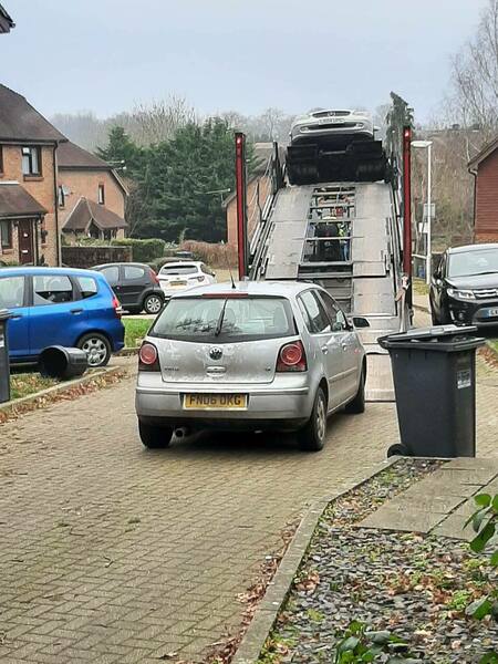

Farewell Polo you served my son well. Bought for £750 two years ago to learn and pass in, serviced twice, the exhaust and discs & pads replaced on the front it was all going so well too until the dreaded valve guide problem started and the final nail in its coffin was the clutch failure 50 miles from home and AA recovery home.
The sh*t exhaust was his choice because yoof but was cheaper from China then a ebay pattern one.
  • Sad 1
