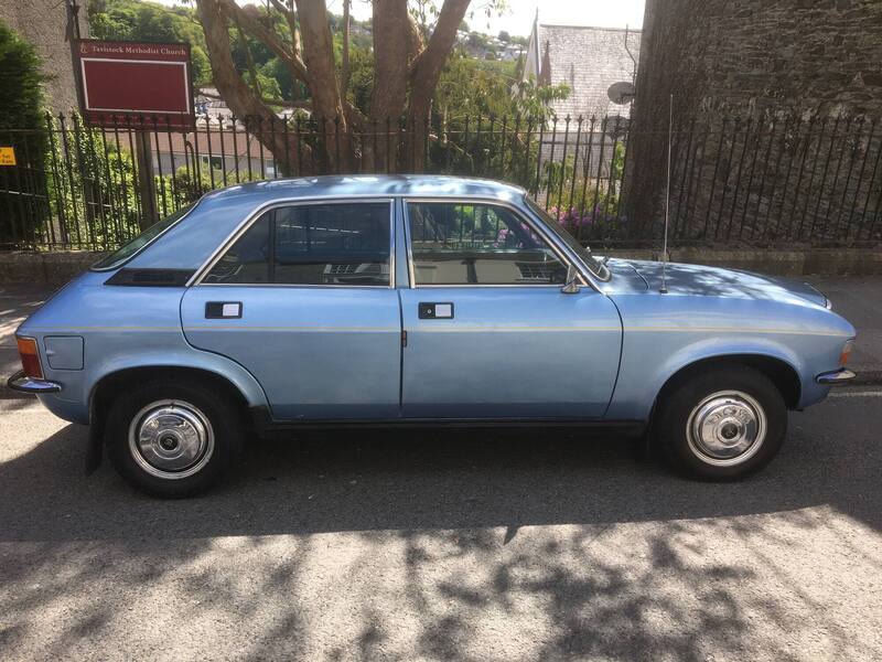

2 hours ago, SiC said:
That does look like a very clean example.
Thanks. It’s one of those terrible colours to colour match so it’s good considering that.
That makes the Allegro look really classy. Were ordinary examples not available in nice colours like this?
Looks really nice that.

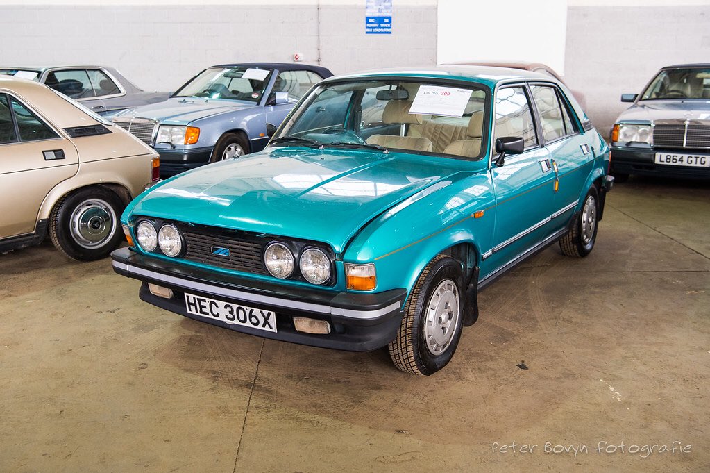

Turns out Allegros were available in some amazing colours that I've never seen. Turquoise Metallic anyone?
EX_tRbfXkAk2nRr?format=jpg&name=medium

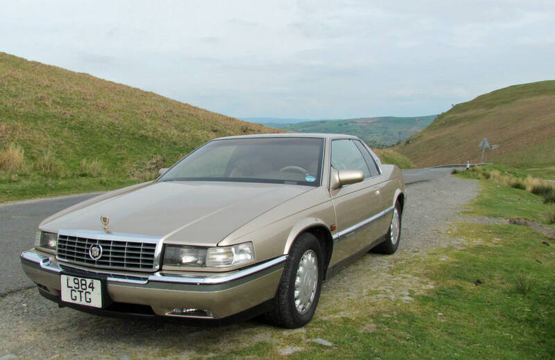

That Mercedes behind it is in the same reg. no. series as my Cadillac! :-)
Phooar what a chodtastic colour

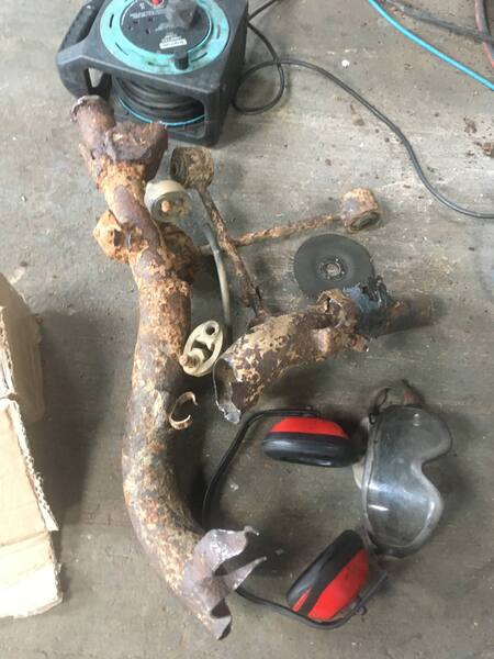

Started to weld up my Daihatsu Fourtrak. It’s had a hard life with 81k on the clocks.
Rear crossmemember chopped out, and lots of loose sealer etc scraped off.
Looks much better under there with the crossmember out. Should get the new one in next time, then it’s just spring hangers, wheelarches, boot floor, suspension rebuild ....

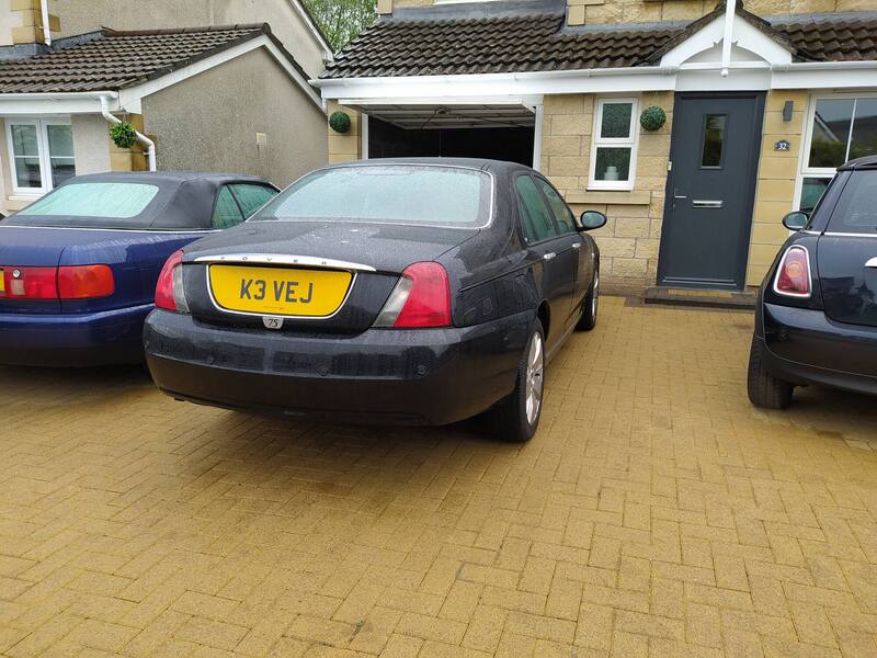

It's here!
The seller was a wee bit late as the OSF caliper was binding but I was not put off as both my previous 75s did this.o
Off out to the shops now.

Glad it is finally here, hope it doesn't throw too many obstacles in your path but all part of the journey.

45 minutes ago, Split_Pin said:
It's here!
facelift - flash decadent fecker ?

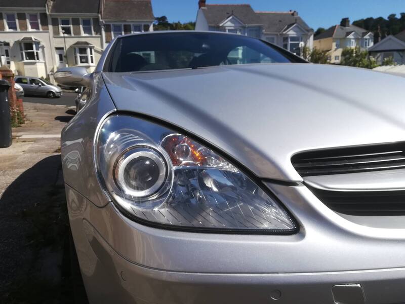

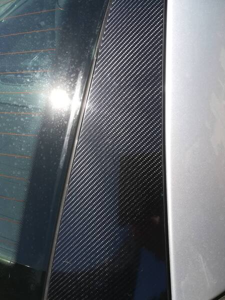

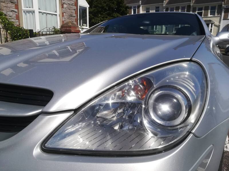

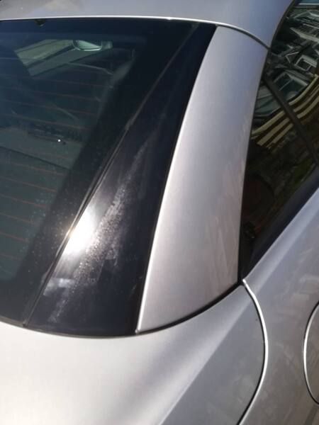

I attempted to clean/polish the headights on the SLuK as they were looking a tad dull and manky. I did a half arsed job and then went and bought the Armoral wipes. They did a great job and it looked fine for about 24 hours when it looked TERRIBLE! All spotty and scabby. There must have been some old lacquer on the lights or something as it reated something awful. Sadly, I had also wiped the same stuff on the black portion of the 'C' pillars... with the same results!
I had previously ordered carbon fibre wrap for the 'C'pillars as I wanted to give it a try but it took three attempts for me to get the measurments correct, plus I changed my mind and wanted posh shiny CF so I eventually ended up with 1.5 X 1 metres of 3M posh stuff and then the other two lots turned up weeks after the initial orders. Ho hum...
IMG_20200514_115001.thumb.jpg.11bfab62087683cdcf1492f116805758.jpgIMG_20200514_115005.thumb.jpg.b11f9e269054e915886f90c113605c3d.jpgIMG_20200514_115020.thumb.jpg.861b726b7563d718977b6a47d21a2356.jpg
These are the before pictures but after I used the Armoral shit...
And these were after! Sorry for the mucky car, I did clean it afterwards... should have been before obviously but... cretin!
So it was back to the headlights. I used the Autoglym kit I bought ages ago, it has dozens of circular pads which mount on a thing that goes into the drill but as I had killed my drill the first time round, I did them by hand! 800, 1500, 2000 and then 3000 had them looking pretty good and then finally with the polish in the pad and using the last dit of drill got them  to a happy place.
When they had dried out and everything had calmed down, I used some special polish (no idea what it is, came with a kit I bought to do touch-ups on the bloody Bentley!) and they look ACE!!!!

I actually logged on just to look for pics of this animal. Looks friggin’ bangin’.

That is a seriously smart looking motor.  I'm mildly jealous.
