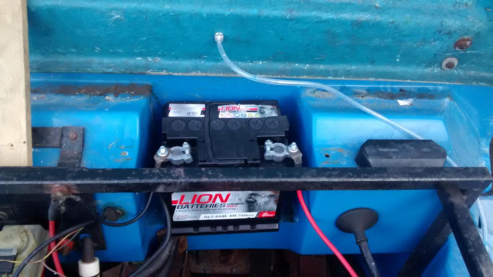

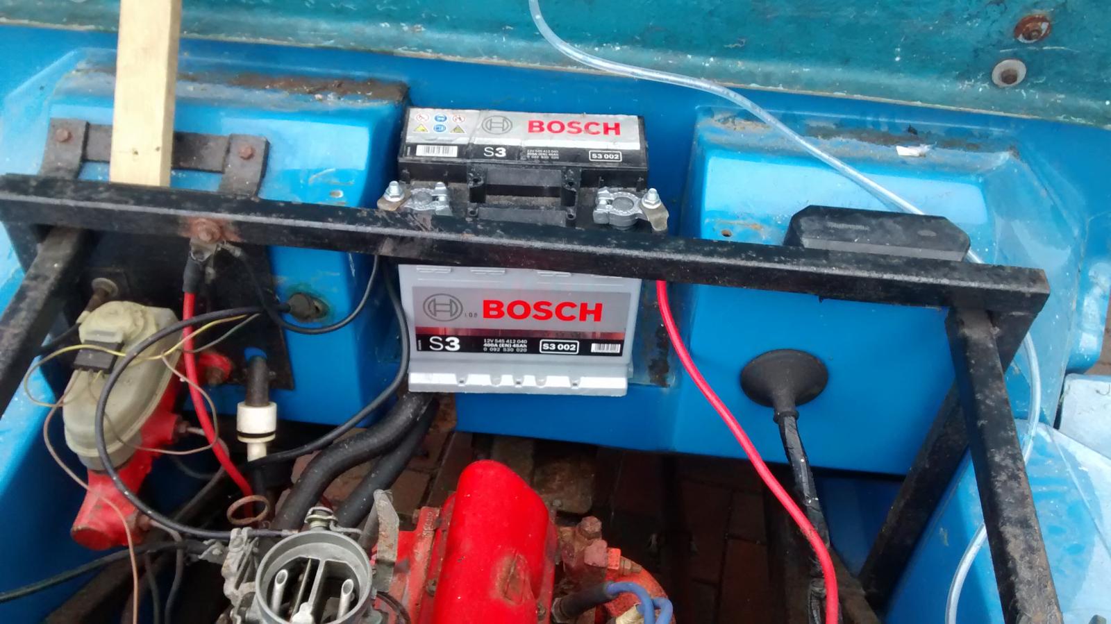

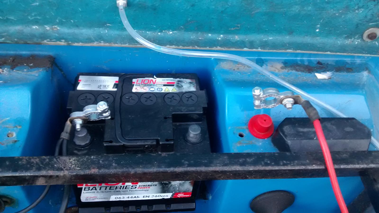

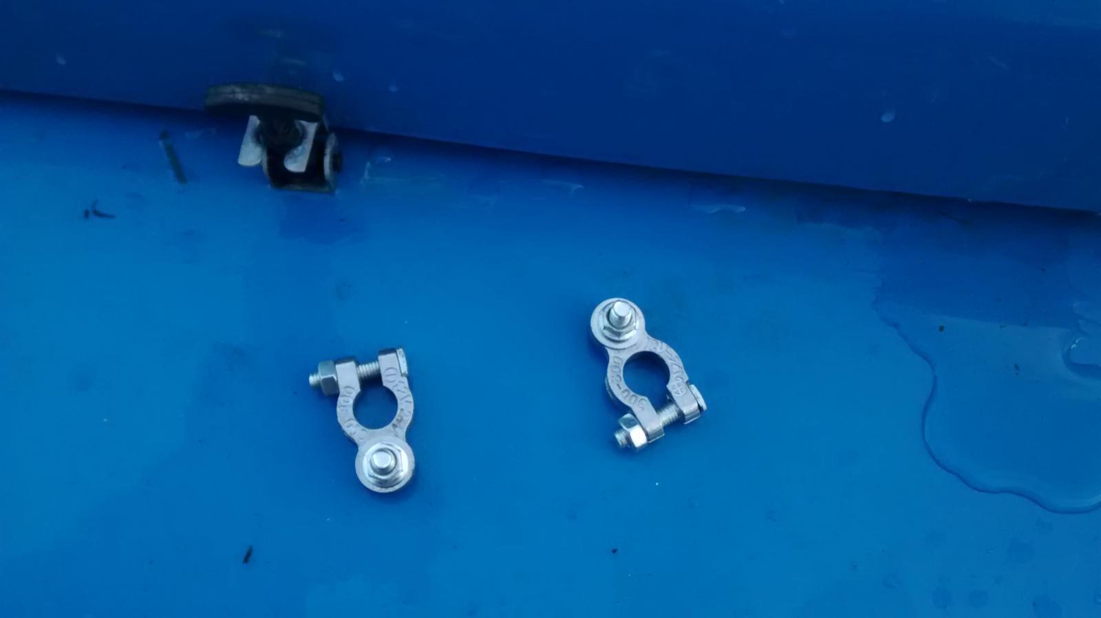

Today my battery terminal adapters arrived in the post, so I set to fitting them to the ends of the positive and negative leads so i can fit a modern battery with cylindrical posts without the use of mole grips.Here they are
I got out the needle file which is fast becoming my most useful tool and enlarged the holes in the terminals  so the bolts would fit
then I realised I'd fitted them the wrong way up, so I undid them and fitted them the right way up
And attached them to the battery terminals. So far, so good.
Next up was to see if they were making a good connection, the ignition and oil lights illuminated which was a good sign so i tried turning the engine over. As ever, it churned but didn't fire. This is getting repetitive and annoying.

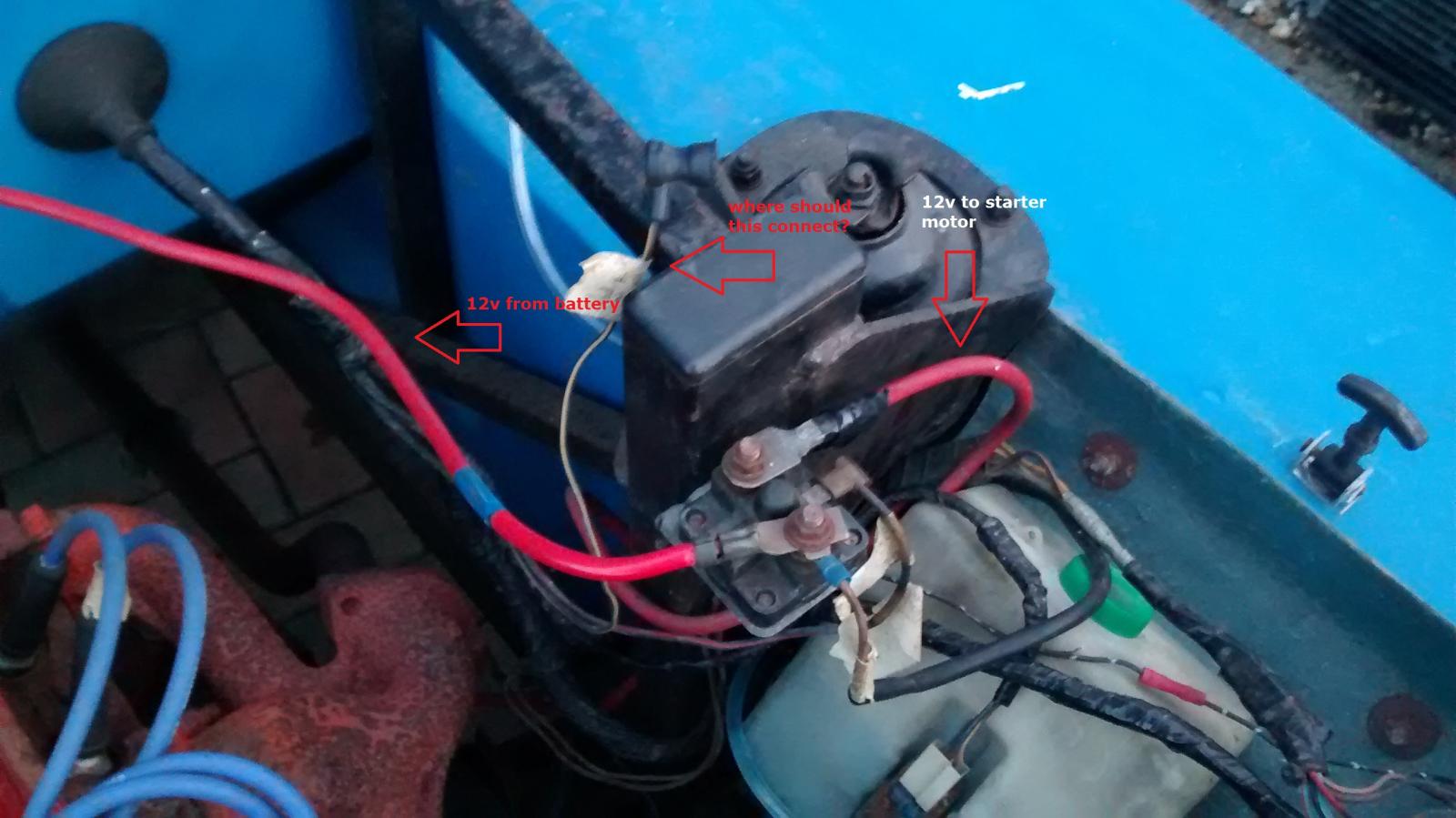

Right, my helpful neighbour who confirmed 100% that there was a spark jumping from the king lead to the manifold when I cranked it over with a bit of metal stuck in the end was 100% wrong.
My daughter cranked the car over while I checked a spark plug to see if it was sparking and nada. So next I popped the king lead out the dizzy cap, inserted the bit of metal I have for such tasks, leaned it so it sat just off the clean metal of the manifold and she cranked it again.
Nothing, no spark, not a sausage. it was semi-dark too so should have been obvious if it was sparking.
So, step back 3 spaces.
We know the coil is good - but I'm still suspicious that there is a wire not connected.. The coil has a black and yellow wire on the positive terminal, a king lead on the king lead terminal and a green and purple wire from the negative which goes down to the condenser under the dizzy cap. The black and yellow wire is NOT plugged into anything at the other end.
This is the solenoid. The red wire coming in from top left connects to the battery positive terminal. The red wire going down under the washer bottle goes to the starter motor. You can see the black and yellow wire with a rubber boot end lying on the chassis next to the suspension turret. What should this be connected to? I think this needs to deliver 12v to the low-tension side of the coil, in order to deliver a spark from the king lead, or am I totally wrong? There is nothing obvious that this should connect to - I'd look at snipping the end off and crimping an eyelet to it and attach to one of the copper terminals of the solenoid, but which one? Or does it not matter? I think it should connect to the one the battery connects to, so it delivers 12v to the positive side of the coil all the time?
Sorry if I am being massively dense, but it makes sense in my head. At least now I know why the engine isn't firing - no spark is getting to the dizzy cap. I shan't ask my neighbour to check things for me in future.
you asked the original owner? he may have done stuff and MAY remember???
He can't recall - only that it did run about 12 months ago. The wire is helpfully labelled 'UNKNOWN?' at the end I think should be plugged in, but labelled 'coil LT' at the coil end.
The coil needs power doesn't it? Currently there is power out via the king lead, and power out to the condenser from the negative side, but no power in to the positive side?
