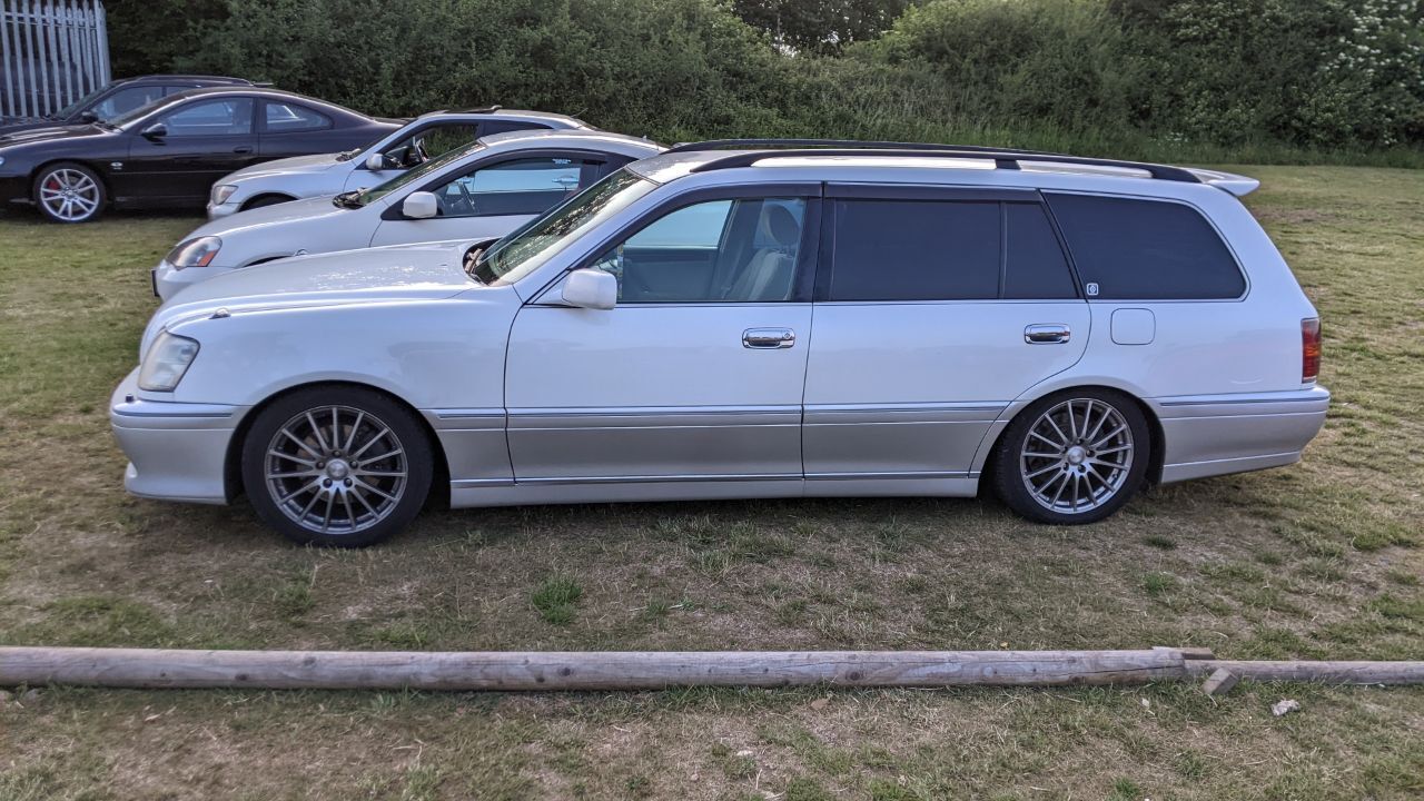

The Yellow Bluebird Turbo  was a honey, 100% stock apart from some tasteful (IMHO) coilovers to give it a bit of stance and aftermarket wheels. Otherwise totally mechanically standard. It was highly velourish inside!
I thought it was a Stagea but its actually (AKSHUALLLLLLLLY) a Toyota Crown Athlete. Was still fit AF, basically a gen 1 Lexus GS300 estate.
