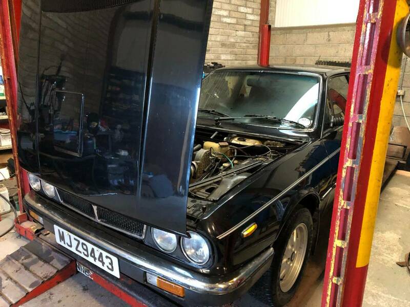

Actually the fuel filler was a good clue as it has the Lancia shield emblem around the lock!
Lovely looking car, but please replace the illegally spaced NI plate!

Amazing find! I aspire to have a car with so many dials in the instrument cluster 😍
That looks great, and no rust on anything Italian of this age must be unheard of.
Fantastic!  I had an HPE 2000ie in the early 2000s - ALE456Y.  To this day one of the best-handling FWD cars I've driven.  I paid £150 from the local auction - those were the days...
Looks like it still has the dealer fitted Pioneer stereo fitted too, well done that man.

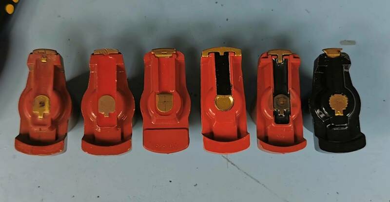

Top tip: If this uses the same rotor arm as the 2000 Trevi, make sure you ONLY use a genuine NOS Bosch rotor arm.  Every aftermarket one I've seen (and I think we were up to about half a dozen before I finally managed to bag a couple of actual Bosch ones) seem to be made to totally the wrong spec and will give you a random miss which you will then spend hours tearing your hair out trying to figure out.
Here was the lineup we ended up with!

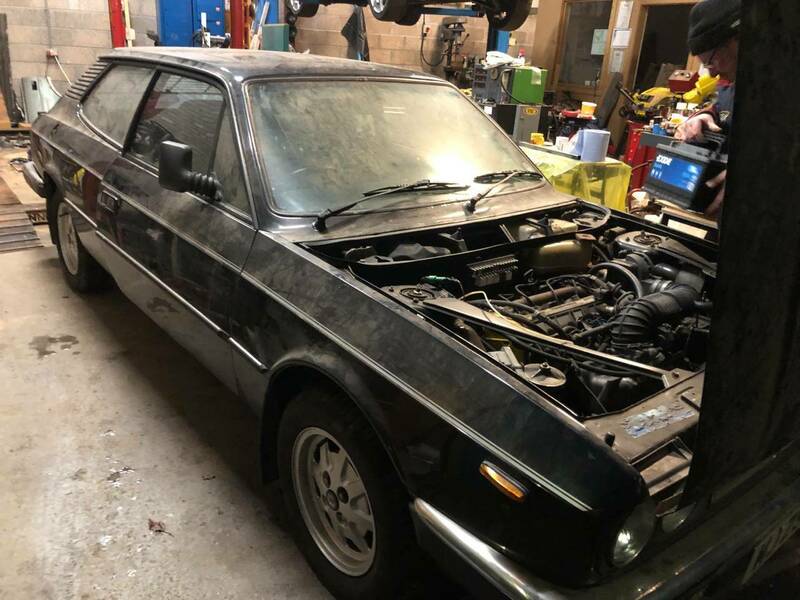

Once at my friends in Arbroath, it was of course dark but the Lancia came off the trailer although as there was just 2 of us we could not get it onto the ramp.
I bought the car cheaply* as the PO had bought it, driven it once where it FTPed so was put in the shed to be looked at later, I thought 5 or 6 years ago.
Aaah. That would be 10 years ago then. The front seat had the ignition ECU on it and there are a few hoses etc disconnected where the looking at had started but that was it.
At this point we decided to stick a battery on it and wind it on to the ramp on the starter. Battery on and........ clunk! Yep, the engine has seized with standing. I am sure it is just a ring or two so today I am making up my favourite anti seize compound for stuck engines, 50% kerrosene (or in my case Jet A1 8) ) and 50% ATF. Plugs will be removed and bores filled and left for a few days.
More as it happens...

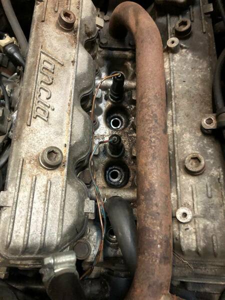

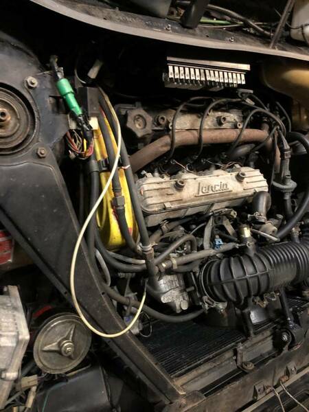

After a morning spent booking taxi/flight/hotel I headed over back to the Lancia. My friend had the plugs already out and had discovered lots of mouse aftermath. The HT leads are dead, several other wires have been chewed and many old nests were hoovered out of the bulkhead area. First job was to mix up the magic brew and fill the bores, next job was a brew and talk shite for a while. After about 40 mins a breaker bar and large socket was applied to the crank, and with very little effort, rotation was achieved.

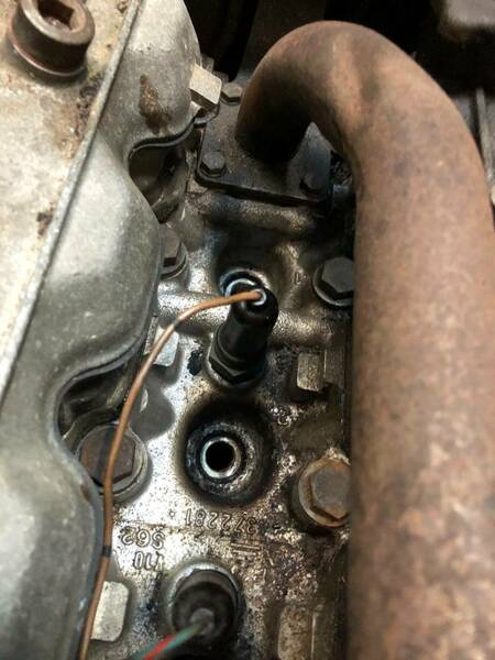

One question that has arisen, is what are these things next to the plug holes? Thin wire would suggest a sensor of some sort, but one on each cylinder?

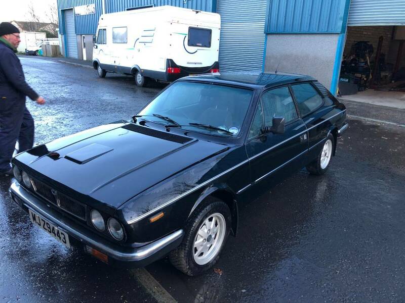

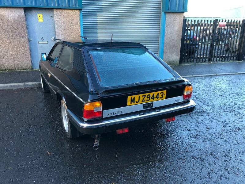

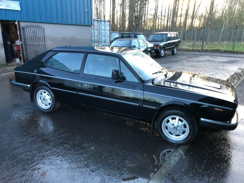

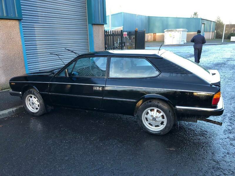

Next job was to push it outside to get rid of 12 years of dust
To quote from one of the best car film opening sequence ever "Pretty Car" 8) There are only three imperfections in the paint that I have found, a bubble underneath one of the D post plastic trims, a small bubble on the sunroof and a rusty stone chip on the leading edge of the bonnet. I will be fetting all three fixed.

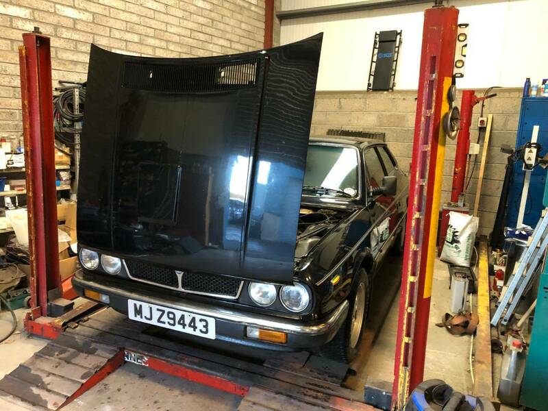

Back onto the ramp it went

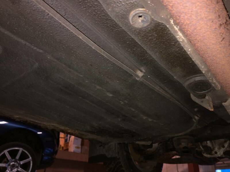

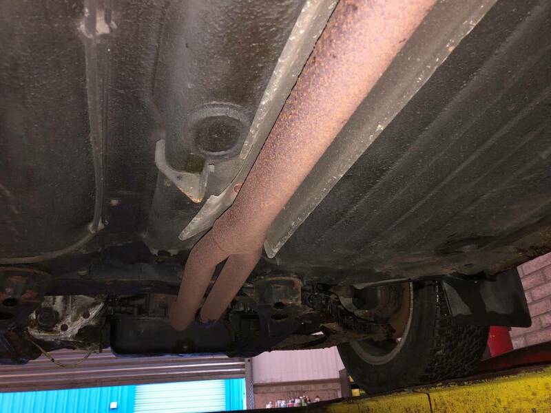

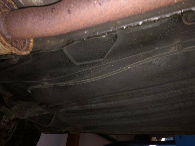

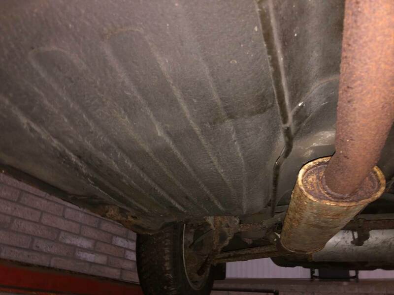

And the moment of truth. What is the underside actually like, remembering this has been stored in conditions that allowed the engine to sieze and more worring, it is a Lancia!
Wow! Unbelievably good! No rot what so ever, and just minor surface rust on components like anti roll bar etc. A wire brush,  vactan and gallons of lanoguard should see it right. At this point I had to leave, and left my friend looking at the Marrelli ignition ECU (at least I think that is what he said it was!)
That looks epic! Can't believe it's that rot free, of it turned over so easily as well are we sure this isn't just a locked up starter?
~My stab in the dark on the weird things, not some early injector thing is it? If it's a carbed system then obviously not but I know some manufacturers had some interesting versions during the take over of injection systems.~
Scratch my stab, didn't inspect the picture enough, thought that was brass pipes going to it like it was carrying a fluid!
