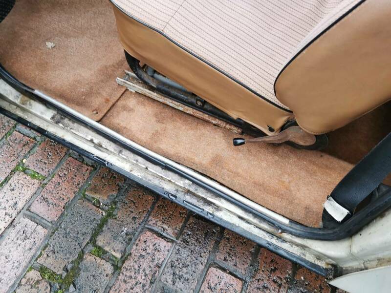

While most areas seemed a good deal drier than yesterday, there was still standing water in a couple of places, so I added a fan to the equation to get a bit of air circulation going inside the cabin.

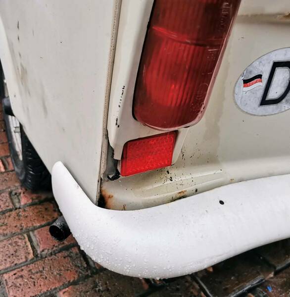

Next up was investigating the wobbly and lopsided front bumper.  This was particularly noticeable as it bounced quite impressively when the car was idling.
While it was bolted in place on the nearside (albeit not very tight), the offside was making do with a zip tie.  Not ideal, even though the bumper really doesn't weigh anything as it's just a bit of plastic.  Bolts were replaced after a little bit of letterbox surgery via the indicator hole in the front panel, and a secure and more or less straight bumper is now in place.
Much better.

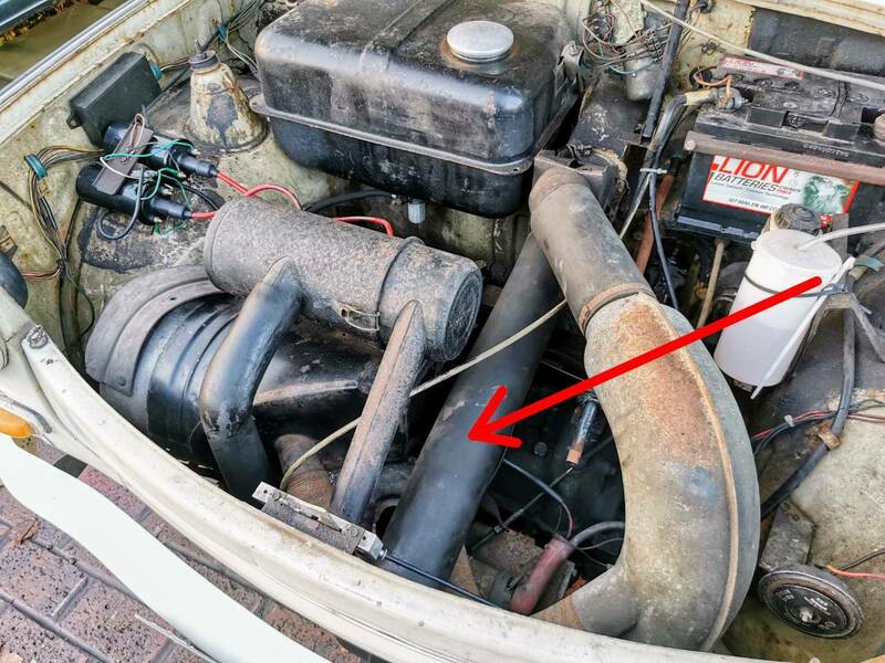

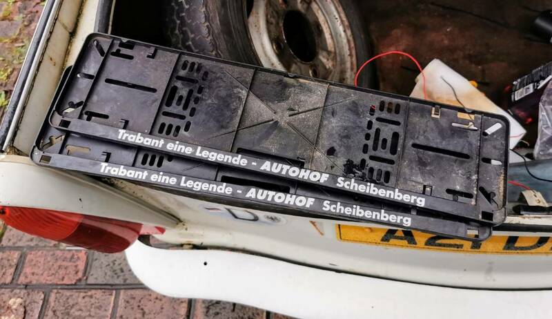

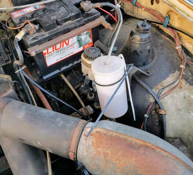

On the subject of ousting zip ties, I also found my eye drawn to this.
Which after five minutes finding a couple of appropriate nuts and bolts was replaced with this from the box of bits.
I don't actually have an electrical feed for the pump at the moment, but it should work fine off the manual pump as it stands.  It doesn't leap out at you as soon as the bonnet is opened now at least.
Interesting to see that this doesn't look to be a modern replacement as it does still say made in DDR on it, with a date stamp from 1989, so not original to the car.

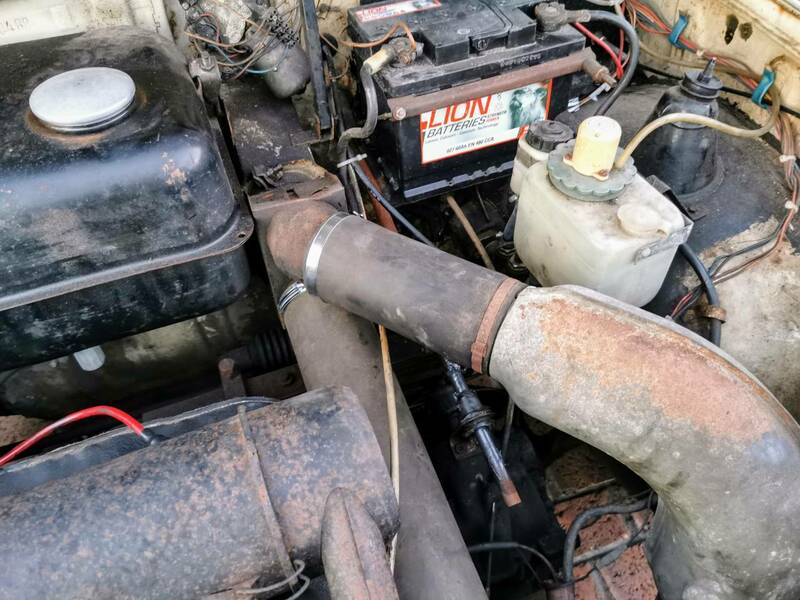

I also found the cool air intake duct for the heater in the boot so that was reinstated between the front panel and the heater air blend box.
I'm probably going to discover that this overwhelms the blend flaps in the heater when at speed and is something that most people fit during the summer and remove at winter which is why it was in the boot!

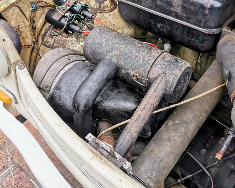

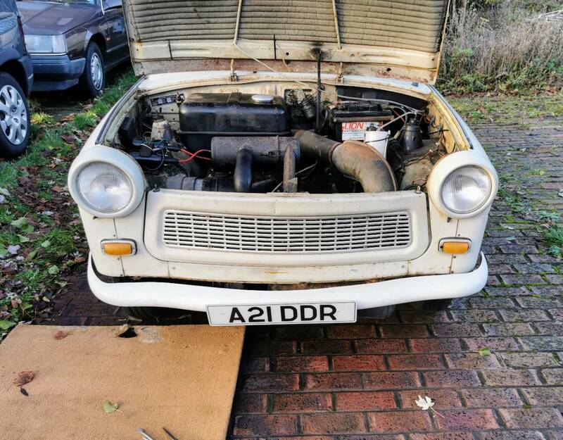

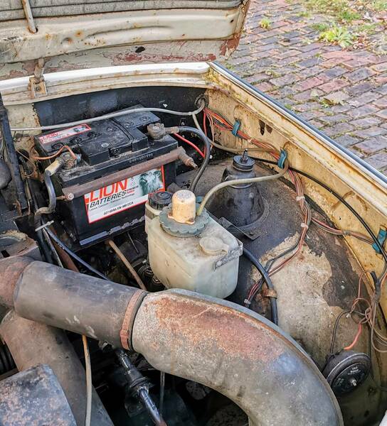

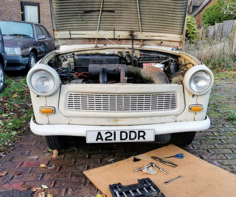

Engine bay looks a bit better I think now.
Really is crying out for a good clean though.  Especially down in the bottom of the inner wings and such there's about 1/2" of greasy mud.

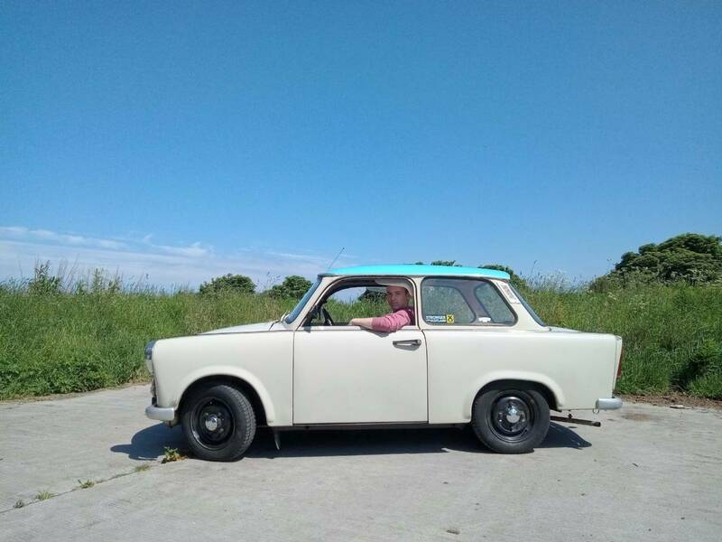

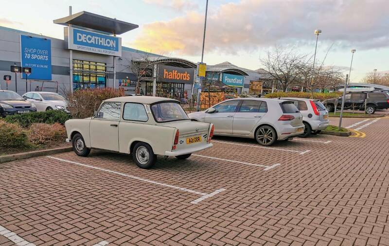

Strangely proportioned little car in profile.
Based on the rear overhang and such, it really looks like there should be about a foot of additional body behind the front doors that someone has just chopped out, and that the doors would be a good bit longer (which admittedly would make entry and egress a good bit easier, it's a bit of a squeeze through the door if you've got long legs).

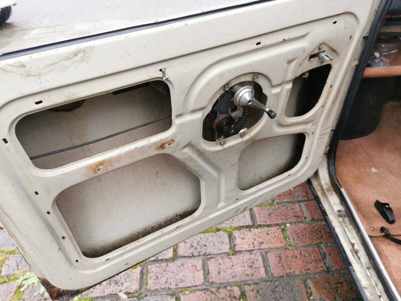

While digging around under the seats yesterday getting the carpets out something which surfaced was the lid for the fuse box I've just remembered so I'll need to get that put back in place next time I'm out at the car.

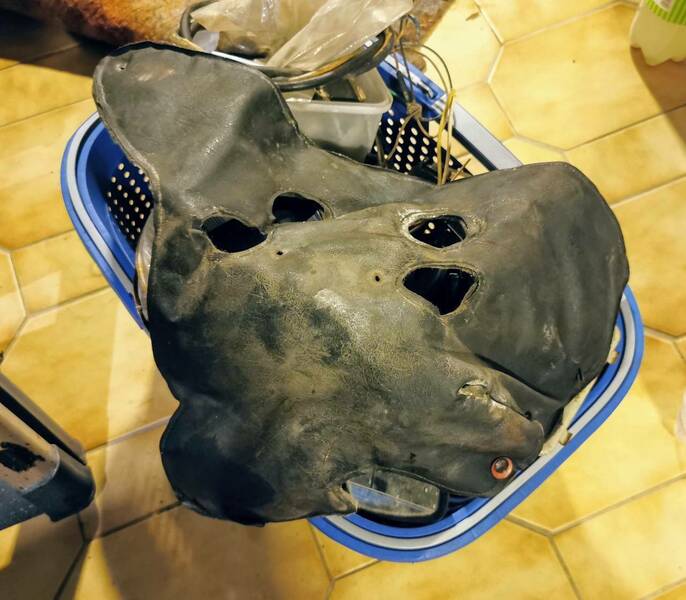

There is supposed to be a little leather and fabric jacket to go over the engine which helps a bit with sound deadening
great work with it so far though, it’s looking way better already!
Thanks.  Hopefully we can keep the momentum going.
I'll need to have a rummage around in the boot, but I definitely don't recall anything which looked like it would have been a jacket like that.  See they are available on Trabantwelt, but a little on the pricey side for something that I really don't *need* at this stage.  Though we'll have to see how long it takes me OCD to give in now I know it's missing!
Edit: Never mind, look what was folded up in the boot.
Will need to figure out how to fit that tomorrow.
It is possible substitute the standard Trabant engine gilét with seasonal knitware.
Does make a bit of difference to dropping the decibels,as you can imagine,nothing was fitted unless deemed necessary!
I have to admit to being curious.  It doesn't seem like something this simple could make a huge difference, but as had been said I doubt that it would have been specified without a very good reason.
I guess it may well be one of those things where even damping certain frequencies by a relatively small amount can make a large perceived difference to the human ear.
Wonder if it potentially helps minimise unwanted air leakage from the tinware, helping ensure as much cooling air gets where it's needed too.
Hoping it will be pretty self explanatory how it fits once I've got everything in front of me, as looking at it in isolation I've not got a clue.

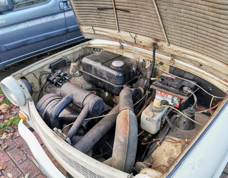

Engine jacket has been reinstated.
Couple of missing clips, but it's not going anywhere.  Also found one of the mounting bolts for the air cleaner was missing so replaced that.
I remain unconvinced of the efficacy of this little bit of fabric in suppressing any perceptible amount of noise, but we'll see.
Also had one of the HT leads come off in my hand when I touched it as it wasn't screwed into the clip at the coil end.
Found this pair of chopped off wires leading into the engine bay.
I do wonder if these may have originally headed to the windscreen washer pump, need to check.  The wiper switch fitted is definitely the one for a car with an electric pump.

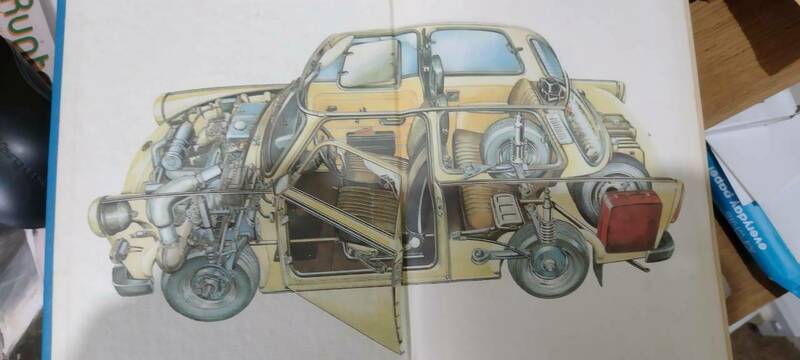

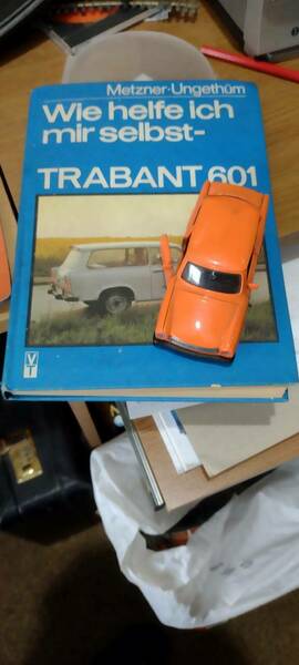

Mind you, the cut out drawing inside that German version of HBOL I bought on a second hand market in German years ago is nice.

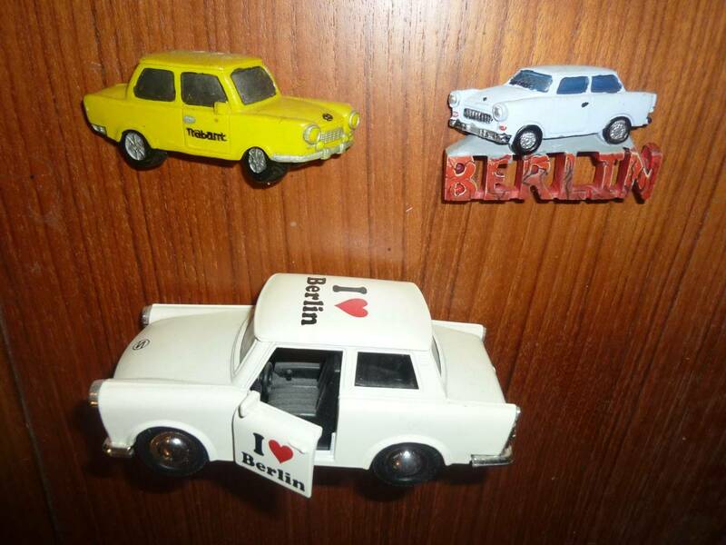

I've got a fridge magnet of that. I bought it from the DDR Museum in Berlin ^^
I love a Trabant. Such a cool and quirky car. Definitely on my bucket list

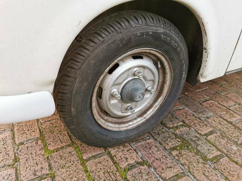

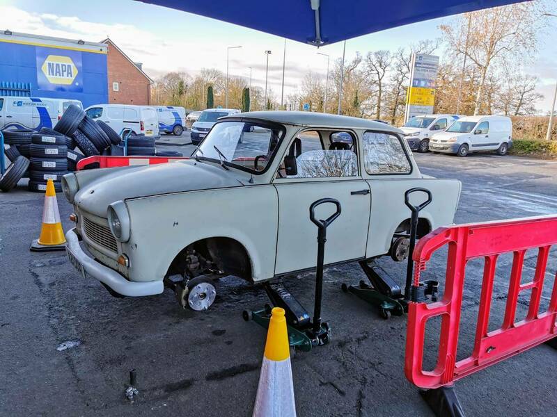

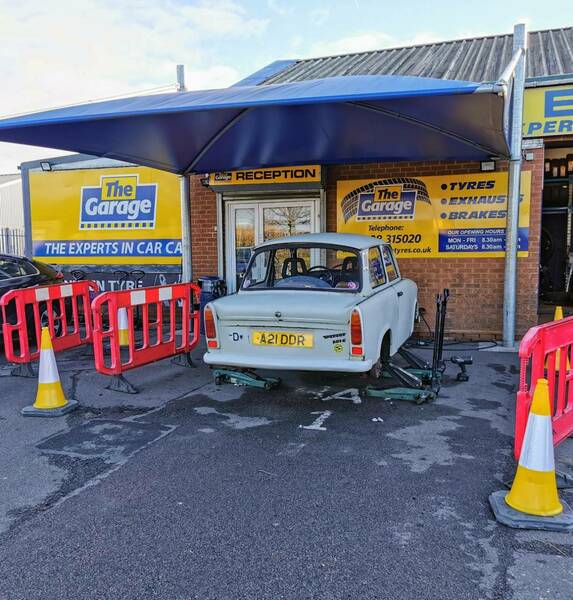

We made it four days before I rage quit on the mishmash of budget tyres on the Trabant.  Wouldn't have been quite as bad if the two matching tyres were actually on the same axle, but the tendency for it to attempt to rotate clockwise every time you so much as looked at any surface water wasn't going to be something I would put up with.  Three tyres had varying degrees of perishing from minor to major present anyway, so on go a new matched set.

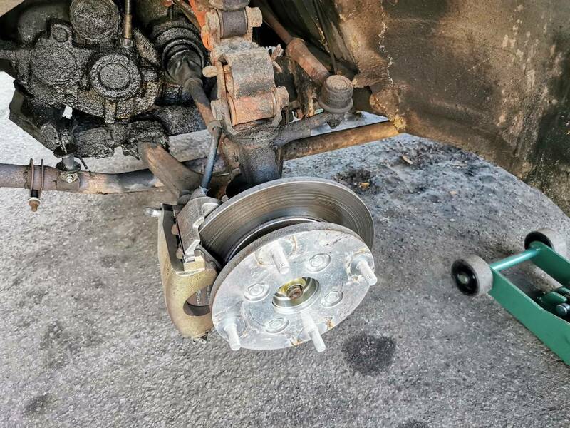

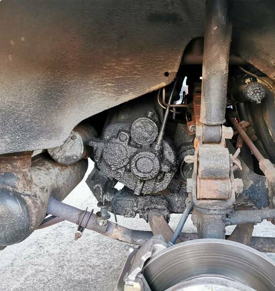

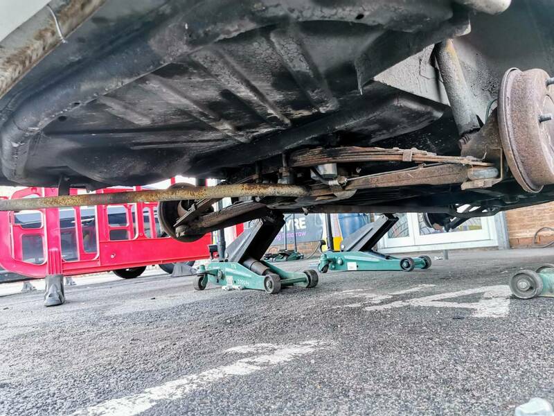

Here's a look at the disk brake retrofit arrangement for those who expressed curiousity about it.
Though we did discover that the wheel from a later car is also something that's part of this as the dish is fractionally different and if you put the older wheels on the front they foul on the caliper.
Noticeable that we have a very, very oily looking gearbox there.  Will definitely need to check that the level is correct ASAP, then see if I can figure out where the oil is escaping.  Given where it seems to be mostly concentrated I'm tempted to point at the speedometer drive initially.  I reckon top up then go after the whole general area with the pressure washer and some degreaser is probably going to be the starting point though as there's no chance in hell of figuring out where it's coming from just now as there's a 1/8" thick coating of slime over the whole thing pretty much.
While the gearbox is very oily, the suspension spring it's very obvious is very much the opposite...I have to wonder when that was last greased.
Same looks to be the same for the rear.
The rear arms looks to be in fine shape.  There is a bit of rust on them but nothing scary.  A good wire brush, some Vactan and protection to prevent them degrading further should be fine there.
My choice of tyres will surprise absolutely nobody if they've followed my motoring nonsense for more than five minutes.
Car already feels are more positive, and most noticeably actually brakes in a straight line now - it always pulled slightly but noticeably to the right under braking before the tyres were changed.
As usual the guys there took quite an interest, including the manager of the place who seemed quite taken with it.

Does anyone else think a Trabant in profile looks a bit like an over-inflated Wolseley Hornet/Riley Elf with massive wheels? I hadn't thought of that until I saw this photo but now I can see some similarities - the shape of the glasshouse and roof is very Mini-like, both have fins on the back and the overall stubby proportions aren't too dissimilar.
To me on the side angle they always look like they've got a broken middle. I.e. to my eye it looks as if both ends sag down with it higher in the middle.
Great progress, and thanks for the disc brake pics... looks a neat conversion.  I wonder how much stronger the brakes are.
The gearbox is a bit oily, but I don't think Trabbi engine bays are ever that clean tbh!  The 'boxes take around a litre of hp68 hydraulic oil iirc, although the manual also says you can use SAE 30 motor oil.  I found some of the hyd stuff at work a few years ago, seems right enough.  TW sell it obviously, used to be around £7.
It's interesting to me to see a later one... Although mine is registered as a G (1989), shes actually an '82/'83ish car.  Apparently they were sometimes refurbished by the factory, given any upgrades and pumped out as new!
I still have the old six-volt regulator in place, unused as she's fitted with the 12 volt setup including 'Ebza' electronic ignition.  I also have the slimmer b-posts, yours are thicker (meaning the rear side windows are slightly different),  which was a 1984 change.
Rosie also 'keeps it real' with the old manual 'push-pull' windscreen washer pump, and I don't have the 'modern' dash switches you do.

Would be fascinating to compare the two side by side one day.  Bit of a hike between us though at the moment!
Think this is a record for the shortest time between me getting a car and getting a message from someone saying "Was this you?" relating to a post somewhere.
Yep, that will have been me.

Car definitely feels a lot better for the new tyres.  Really has changed the feel of the steering completely, and it's definitely less bouncy than it was - a bit anyway.
I never realised these had 13" wheels, I always assumed they'd be 12". It's like it's a real car!

The doors definitely appear to be a major source of our water ingress based on where the witness marks show up.
I'm sure the seals themselves have a part to play there as they're basically totally solid chunks of plastic which may have at some point been rubber.  I'm sure as a result that they're really not doing much useful.
There's also no form of drip shield present in either door behind the door cards which also won't be helping matters either.
So I'll need to look into making up a replacement for that.  I'm assuming there would have been some sort of sheet in there originally.

On a similar note is this rear light surround which I'll need to find a replacement for.  if I had the broken off bit I could probably glue it back together, but sadly I don't.

Did find a pair of number plate surrounds in the boot which obviously date from the car's previous life in Germany.
I'm really not a fan of fussy things like this on cars so they'll probably just be carefully stored to be handed on to the next owner with the car when it's eventually moved on rather than put back on the car by me.  Interesting to see though.
