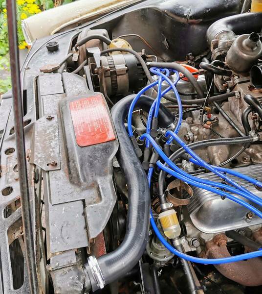

Not thrilled about the quality of the moulding of the new top hose, the radius of the curve leading to the thermostat housing is too wide so it wants to kink there a bit.  Not badly so and once the system has a bit of pressure in it definitely won't be prone to collapsing, but it's a bit disappointing nevertheless.  Sorry I didn't apparently get a photo of that.  Admittedly, several of the current hoses on the car aren't the best fit either - the heater hose you can see below the thermostat in the above photo is basically wedged in place.  Will see if the replacements are any better.  I may be able to improve the fit of the new hose by just trimming the end a bit as that will naturally straighten out the bit that's trying to kink a little.  I'll take another look at that when I'm feeling a bit more human.
I didn't have the opportunity to take the car for a road test today but the temperature at idle stabilised around here.  Which doesn't look unreasonable to me for a car that's stationary.
Hopefully it sits somewhere reasonable when we're actually moving as well, though that will need to wait till the weekend to find out.

See what I was meaning about that top hose?
Radius of that bend at the thermostat end as moulded is too wide, it's essentially trying to connect to a space roughly halfway between the thermostat and the driver's side rocker cover.

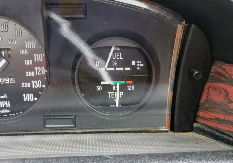

Nevertheless, topped up the coolant today and went for a proper test.  Seems to sit around here when driving normally, albeit after peaking quite high on the gauge before the stat opens.
This is higher than I'd generally expect on a car of this age, especially on a coolish day and when I'm still treating the car pretty gently.
Though I have zero prior experience with a P6 so I've no reference to know what's normal.  I also don't have huge confidence in the accuracy or otherwise of the gauge as it certainly doesn't feel or smell to me to be running warm - so I'm leaning more towards the gauge just being a little on the pessimistic side.
I'd just tend based on prior experience with cars old enough to have an actual gauge rather than some lying ECU controlled nonsense, for the temperature gauge to generally sit probably somewhere covering the 8 of 85 unless you were sitting in traffic.
Open to feedback from others who know these cars better there.

Have you got an IR thermometer? I usually keep one hanging around in a car until I can be fully confident in the gauge accuracy. Checking the hoses and non shiny surfaces for temperature.
You can usually recalibrate the Smith gauges pretty easily. Have it going through a known resistance (manual should say), 10v source and then between the two calibration dots. Admittedly I can't see those two dot but possibly hidden behind the bezel?

I have been meaning to check via my IR thermometer via a couple of places.  The radiator end tanks being painted matt black is helpful there.
There are indeed dots there on the gauges.  Here's a contrast enhanced closeup.
It is worth noting that the 10V rail on this dash is probably more stable than it originally would have been given I've replaced the dead bimetallic regulator with a semiconductor one...
I had idly wondered what those dots on a whole bunch of gauges were for, calibration makes a whole lot of sense.

Looks like the gauge is at least reasonably accurate.  Highest temperature I saw measured on the top of the radiator end tank immediately adjacent to the inlet was in the low-mid 90s after the car had been warmed up and then idling for about 20 minutes.  If my math is right the boundary between the green/red sections of the gauge is near as makes no odds 100C, and we were sitting a little below there.

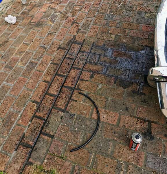

Did run into an issue when I subsequently took the car out to cool it off a bit before shutting down in that after two or three minutes driving it started to cut out under load.  Felt like fuel starvation.  Engine would idle fine, but fall flat on its face if you gave it any sort of throttle.  Idling for a minute or two got me another minute or so of normal driving before it would happen again.  Which makes me think fuel delivery even more as during a period of low demand the float bowls were being able to refill.  Of course as soon as we got into our neighborhood where I had somewhere safe to stop the problem immediately disappeared.  Go figure.
Rebuilding the fuel pump has always been high on the to do list, so that's now been moved to the top of the to do list as failure of that would result in exactly this sort of behaviour.  I did check we didn't have a vacuum forming at the tank end and we didn't.
I just need to figure out a reliable way of stemming the high pressure jet of fuel that's going to want to escape as soon as I disconnect the inlet side of the pump.  Going to investigate if I have any random fittings of the right type as just sticking a hose on there which extends above the height of the level in the tank would be the easy solution.

Unfortunately I managed to drop the pump and get it wedged between the block and inner wing while trying to reassemble things, so only caused a *minor* ecological disaster due to the amount of fuel spilled.
The fuel unfortunately decided to hit the side of the dropped pump and just sprayed pretty much everywhere except into the catch pan I had in place under the car.  I knew we managed removal of the pump with far too little mess.

Well that would do it.
A 3.5 litre V8 isn't going to run on that under load!

We definitely have a pump or pump drive issue.  The original fuel filter that was in the car was really badly discoloured but there was actually virtually no gunk in it.  The inline one I've had in there since relatively early on has only collected a minute bit of rusty sediment.
There is no pickup screen on the main outlet, only on the reserve - though we get no difference irrespective of which feed we're drawing from.
If you actuate the pump manually it pumps strongly, both a good volume and with decent pressure, so it seems that it simply isn't being driven properly when in the engine.
I'm assuming there isn't supposed to be a spacer present between the block and pump?  As that would impact where the actuator arm contacts the cam which drives it.  The manual I have helpfully has zero diagrams or photos which would be helpful there.
I don't have a good photo of it, but the actuator arm doesn't look excessively worn to my eye, there's a shinier spot where it obviously runs, but it looks just like all the photos I could find.
Not really sure what I'm looking at here.
I'm guessing the thing roughly centre frame is the fuel pump cam, and the cleaner line is where it runs the pump.

The electric pump shifted in about 20 seconds more than the mechanical one did in a couple of minutes - and that's pulling *through* the mechanical pump as I couldn't bring myself to unbolt the thing from the block yet again to bypass it, though I will before we do an actual road test tomorrow.  Have run out of time for today now though.
This however seems to have proved that we don't have a restricted supply actually from the tank.
Which I kind of knew already given it flows out merrily at the pump both inlet and outlet under gravity alone.  Just the mechanical pump isn't doing anything meaningful.
