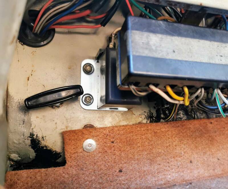

Another hopefully quick and easy one now the part has arrived.
This is the changeover relay which toggles between dip and main beam.
Undo two bolts, unplug wiring after noting what goes where, out comes what's left of the old one.
I also removed the one bolt that holds the fuse box in to give better access, though you don't technically need to do that, just makes your life easier.
That would indeed explain why I had no main beam, and why the relay wasn't clicking.  The whole armature being gone would do that.
New one in and fuse box re-secured.
I can now confirm that the headlights are now fully functional and toggle correctly between dip/main now.
Just need to find tune the beam adjustment a touch then can call that system done.
A few seconds over seven minutes from stepping outside to back inside.  Long enough though as it's chilly out there!

What's the ?pull-handle next to the fusebox for?
Bonnet release.
Isnt that headlight relay the same as '60s/'70s VW Beetle?  I remember our 1967 Beetle 1500 (vertical headlights) pull indicator stalk to flash, or if headlights on, change to main or back to dip
Wouldn't surprise me given how physically close the factories were, or at least an East German clone of the part.  I've basically zero experience with Beetles so wouldn't know myself.
That relay is a surprisingly simple solution to toggling between two fairly high load circuits using a single fairly low current impulse.
2 hours ago, SiC said:
Looks like.  That seems to work much the same way.
Only ones I've personally used before have had a separate set/reset coil though rather than just cycling using the one.

8 hours ago, PhilA said:
Looks like it just see-saws the contacts with each impulse?
Sorry, missed this comment.
Yes, it connects two pairs of diagonally opposite terminals using essentially just a rocker switch with a cap that's shaped like a more flattened out letter W.
The way it's arranged is that the centre peak is shifted over-centre in either position, so each time the actuator arm comes down it pushes the switch into the opposite position.  Very simple using the bare minimum of components really.  Unlike one of the push buttons that lives on my desk which does something similar, but using a drum, spring loaded ratchet mechanism and a cam to operate four micro switches.  I really need to actually use that for something one day...

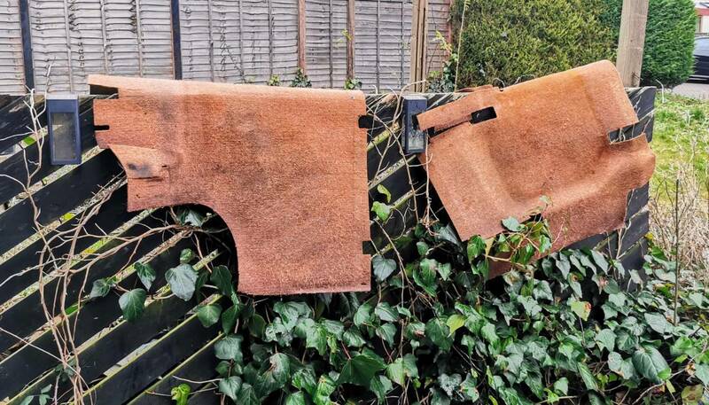

With the weather seeming content to stay outside the car now I wanted to think about putting the carpets back in - though before doing that I wanted to clean them as they really did need it.
The front section in particular had a very distinct tide mark where the water had been running down the bulkhead.  Plus was just generally grubby.
The rear carpet wasn't quite as dirty, but had a good amount of rust staining from where there was standing water in the footwell for a long period of time.
I gave them a bit of a scrub down with a solution of hot water and washing up liquid before blasting as much of the gunk as possible out using the 20 degree nozzle on the pressure washer.
Have to see how they look once they're fully dry, but judging from the amount of gunk that came out it can't have been a bad thing to do!

The carpets are still a little damp, but I've got the underlays both back in the car now.
Hopefully get the actual carpets back in tomorrow.
