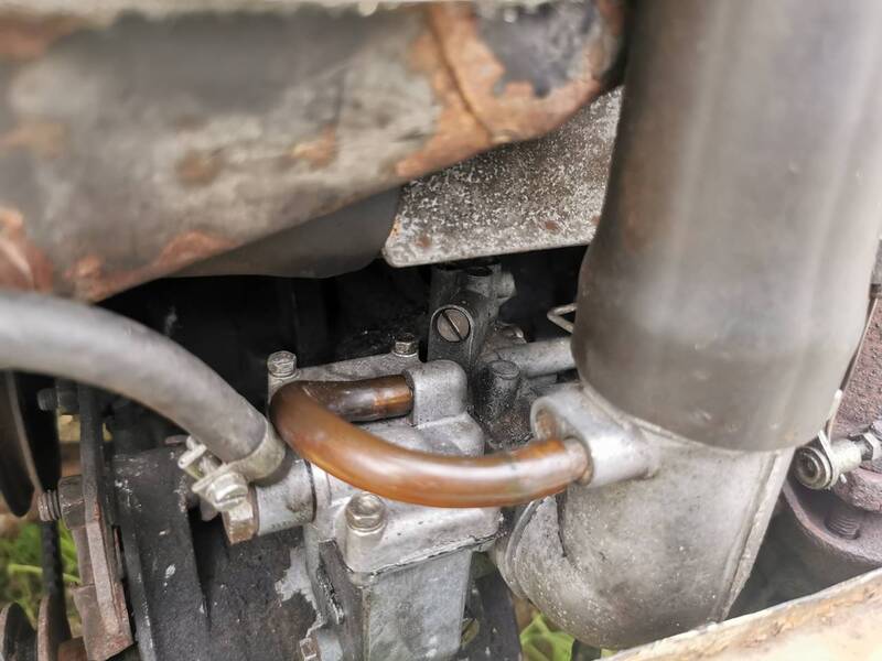

Had a quick nosey this afternoon.
Pretty sure we do have an air leak somewhere.  Blocking off the carb has virtually no effect on the engine for at least a second or two.  So that's something which will need to be fully investigated.  Could be as simple as the carb to block gasket or the bolts being loose (they're a bit of a bugger to get to as the alternator, carb itself and exhaust are in the way, or could be crank seals or even jug gaskets.  All of the relevant gaskets I do have in stock.

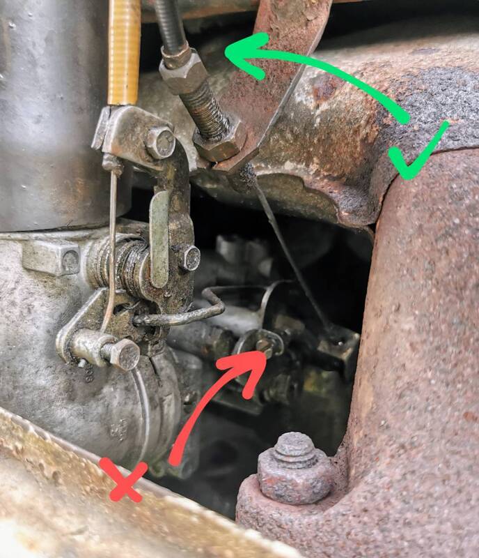

Taking a look at the carb settings, the idle mixture screw is the large one roughly centre frame below.
This is nice and easy to get to.  The main one is somewhere up on top of the carb I believe based on the diagram I found - but I can't even see it with everything in situ.
This screw was all but ready to fall out.  It was at the point you could easily wobble it around with your finger.  Had to screw it in four full turns before it had any effect on anything whatsoever.  Very little resistance on it though, so I suspect the O-ring is well past it's best.
We also have a bit of a leak from the bowl gasket.
Nothing dire, but needs to be tended to.  So I think it's time to pick up a carb service kit.  May as well grab a set of crank seals while I'm at it as I'm sure I'll need them at some point.
I did bring the idle up a bit (probably a bit too far actually).
The adjustment a lot of people seem to think is for the idle speed is a screw which *looks* like it's for the idle speed - but that's actually to do with the choke linkage to open the throttle a bit to bring the idle speed up when you're on choke.  The only adjustment for the idle speed itself is just done by tweaking the cable apparently.
Seems a bit odd for me, but I guess is a good and simple way to ensure that you're always getting some amount of fuel (and oil) into the engine even when the throttle is notionally closed.  I guess it also speaks to the "keep it simple, stupid" theme that runs through the car as a whole.
