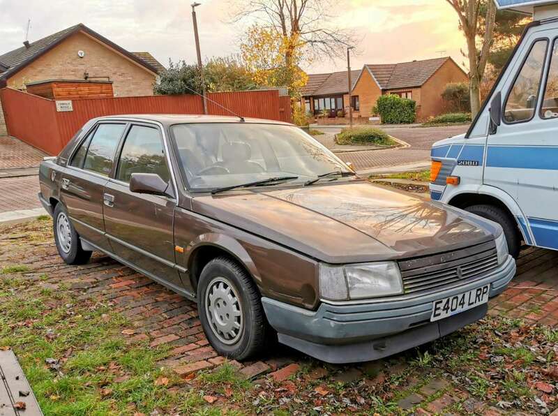

28 minutes ago, Zelandeth said:
Oops.
Well I've just A - Made a load of work for myself.  B - Ensured my imminent demise. C - Made a load of work for myself.

Yes, all that is true, but it is also brown.
how much brown?
fucking all of it!😁

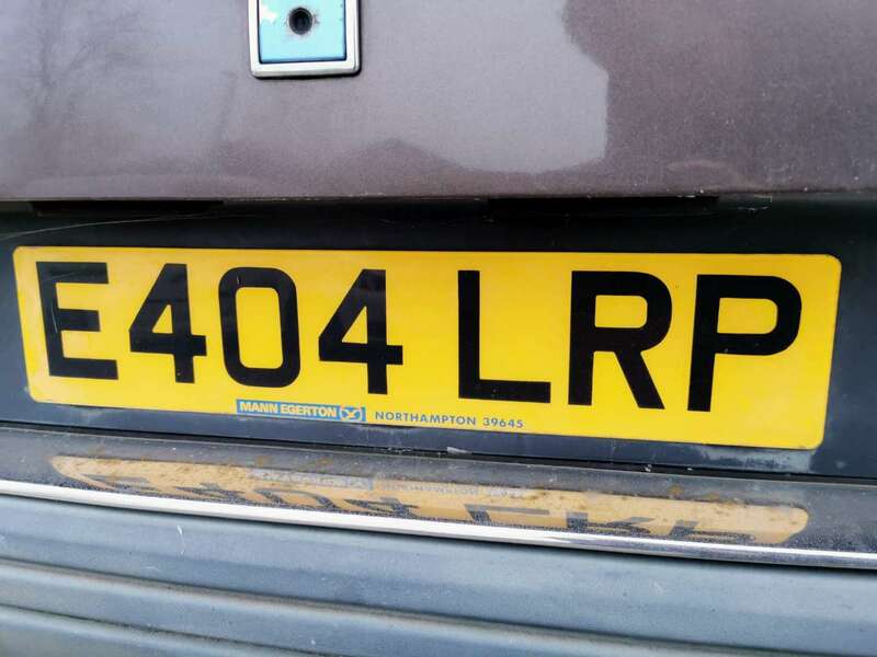

for what its worth, your ( :) )  Monaco is correctly registered as a Monaco with the DVLA under the proper Make and Model codes L2 198
so it is likely one of those 2 taxed cars in that statistic!
Bronze thank you very much.
I actually like the colour - especially when it's actually clean and we're not looking at it on a grey December day so you can actually see it's metallic!

yeah, yeah, whatever you say!🤓
That is a brown car.
As we know, brown cars are good. You have nothing to be ashamed of.

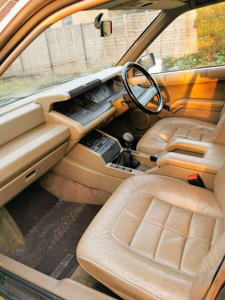

Gorgeous. The interior will be a beige leather fest. I love Monaco interiors they're just soooo cool.

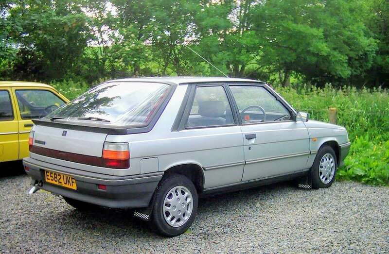

This Renault 11TC was £125 I think.
Sailed though the MOT and I got a decent year's motoring out of it.  I only really sold it on because it turned out that this straddled the line between the pre and post facelift car and had been assembled from whatever they found laying around the factory floor.  A lot of things didn't even vaguely match what either the phase 1 or 2 cars should have had.
Plus by then it had done the main thing I wanted it to, which was keep the Metro out of the worst of the winter.

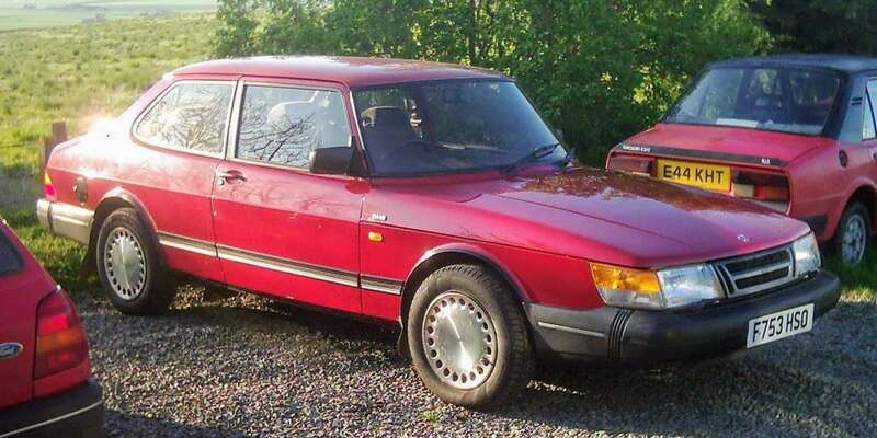

This Saab was £60.
This was the good side, the other one had a huge poor accident repair on which had been painted with what appeared to be red telephone box paint.  It was also absolutely rotten around the driveshaft tunnels and boot floor.  The gearbox had serious issues and the engine hadn't had an oil change in about ten years and made some truly interesting noises.  This was bought as a "run it on nothing unnecessary till the MOT runs out" basis.  It did then yeild a good number of useful spares.
The front wheel looks odd in that photo because I was in the middle of replacing the wheel bearing so things are just sitting there - which I think was about the only thing beyond a service I really did to it.  Think I maybe changed the thermostat.
It basically expired about a week before the MOT ran out when a missing manhole cover in Aberdeen ripped out the lower nearside ball joint.

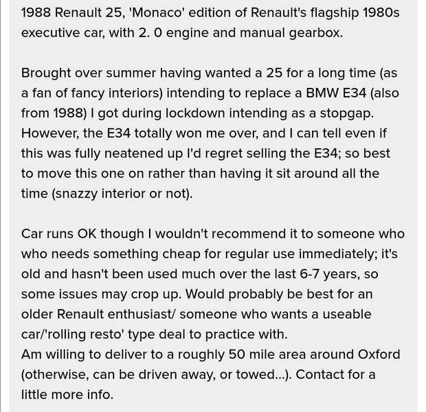

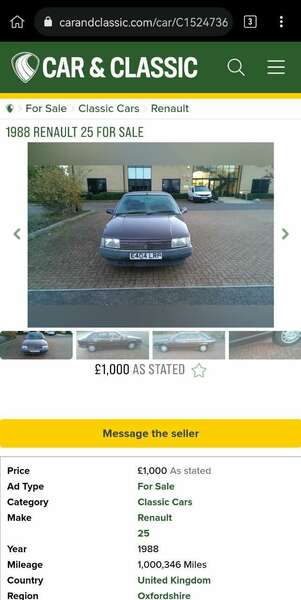

Until someone in a Telegram chat posted a link to the C&C classified as for this a couple of days ago.
Is was clearly somewhat scruffy, the photos weren't great but the ad sounded like it was written by someone who was into cars.  Plus it was actually written in real English which in 2022 feels like a real rarity.
Initially I sat firmly on the "I absolutely do not need another project" idea.  However having then looked up how many were left and realising it was pretty local I decided it had to be worth a look.  If I didn't I'd forever question if I'd made the right call, and am not expecting to find another pop up.
This is despite the fact that the car I'd already got on my driveway for the spring 2023 project was parked on what used to be my front lawn because I'm already out of space.  So if I bought it something would absolutely need to move on - one in, one out and it isn't optional.
So I sent a message to the seller.  What followed was an entirely pleasant E-mail conversation back and forth completely out of character with any experience buying or selling a car to the general public that I've had in the last ten years.  It was arranged that I'd pop over this weekend to have a look at it.

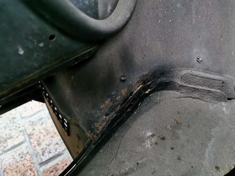

The only rust I immediately found which will want attention sooner than later is some on the inner wings where some seam sealant has blown out.  The outer wings bolt on and I don't think it will be the end of the world to sort once they're off.  Might actually be far enough away from the strut tops because of how far back they're set not to be an MOT issue - but it wants sorting either way.

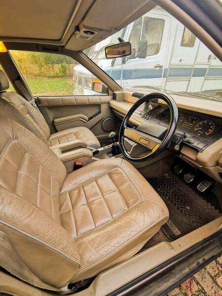

Interior was in decent shape, leather desperately want drowning in leather feed, but everything's there and looks in decent shape.  Bit of obvious wear here and there not no splits I've noticed yet.  Especially glad the Monaco specific door cappings are okay as they'd be an absolute nightmare to find replacements for I imagine.

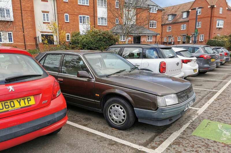

So a deal was done and we headed for home.  I'd originally expected to take Six-Cylinder along to drive it back as I'd generally found short term insurance (I'll get it transferred to mine on Monday) to be really steep lately.  So when it came back at £19 I was surprised - and just set that up there and then and off we went.
No petrol station shot as the seller had already filled it up for us!  So have one in a random Waitrose car park instead.
It's always a little unnerving driving a car back when you've bought it - especially a 34 year old French barge which even when it was new had something of a reputation for flaky electronics.  Double that when it's barely turned a wheel in the last five years.
However she wafted the 40 miles or so home without missing a beat and in utter comfort.

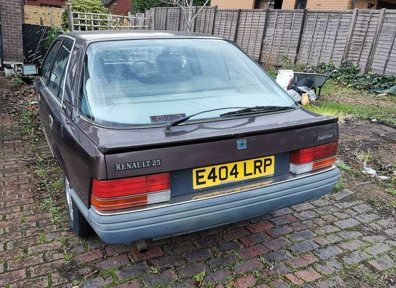

So...issues.

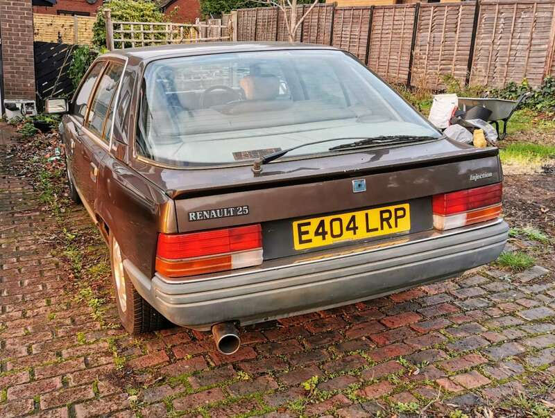

Initially I thought someone had stuck a silly rear exhaust section on.  I recall these being annoyingly expensive even back in the early 00s, so that wouldn't have surprised me.  However a bit of quick investigation...
Figured out it was just a trim...so that's now gone.  Much better.
She needs a clean.  Like really, really needs a good deep clean.

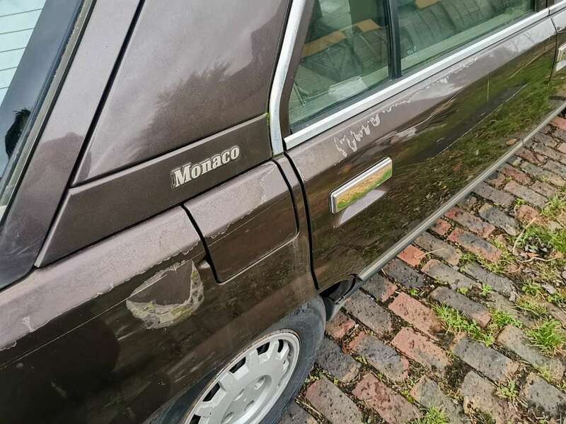

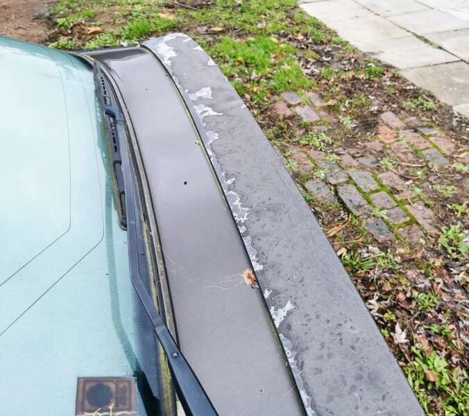

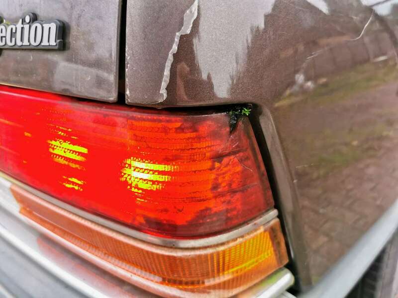

Exactly as per the advert, the paint does indeed need help in several areas.  There's some pretty epic clear coat peel.
The radiator grill is peeling particularly badly too.
Plus a nasty scrape running a good portion of the way along the driver's side.

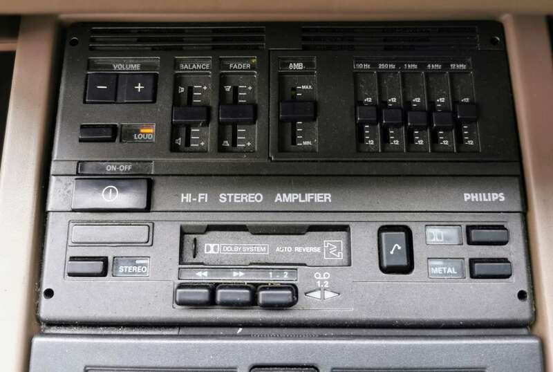

The LCD display for the clock/stereo/outside temperature display clearly needs either a cleaned zebra strip or replacement ribbon cable.

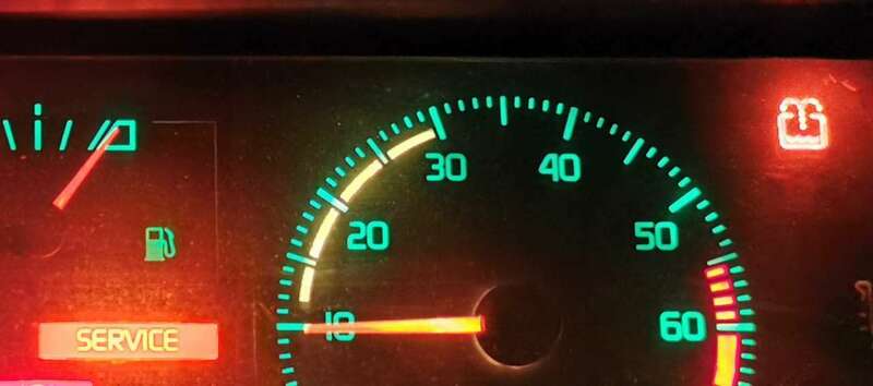

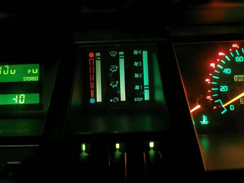

Few lamps out in the dash/switches, but nowhere near as many as I expected.
Does look good at night.
I do remember thinking that the style of lights they used on the central cluster in the dash with the brightly lit symbol on a dimmer field looked really smart.  Still do.

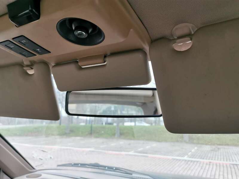

Though speaking of the dash, it's hard not to mention this strangeness which wouldn't have been out of place in a Citroen to be honest.

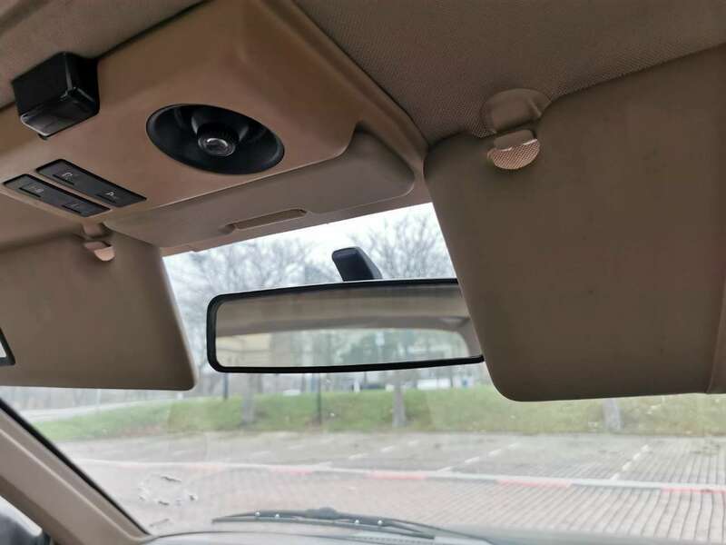

I haven't tried the windows yet, nor the sunroof - which I didn't really notice until we were underway - that will definitely not be getting touched until spring!

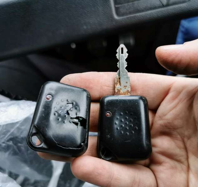

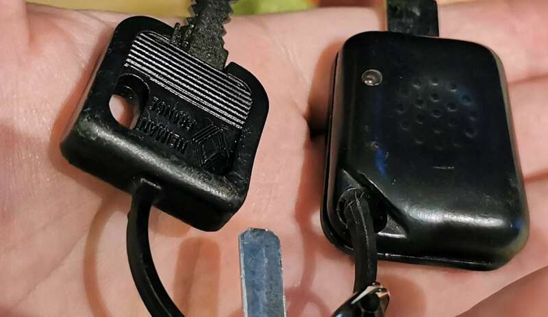

Central locking does try to work, though it doesn't quite manage to actually get all the doors locked.  Sure a clean and grease of things will sort that.  I do only have one set of keys (and no remote sadly), which I'll need to resolve sooner than later - though it remains to be seen how much of a pain that weird door key is to get cut.

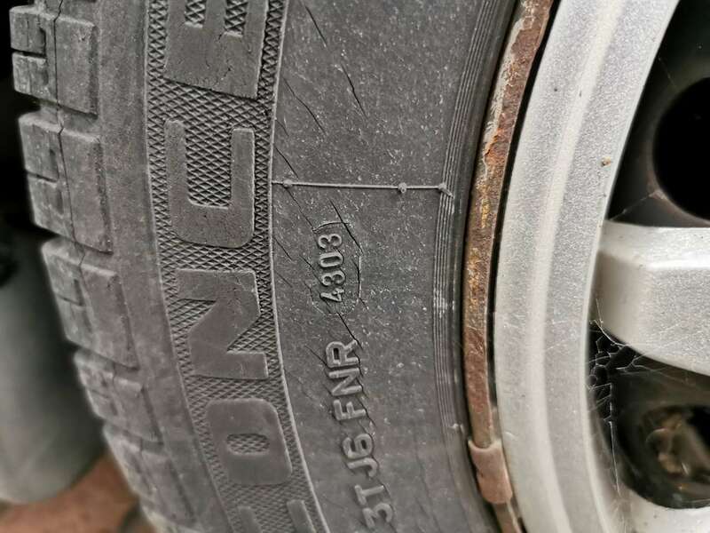

I always find it slightly surprising when people go and spend major amounts of money resurrecting a vehicle...
Then don't change things like tyres.  The newest tyre on this car dates from 2003.
With two of them being from pre-2000, they're all budget brands too.  So a full set of tyres is going to be number 1 on the list.

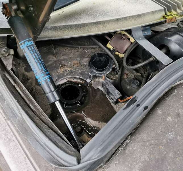

In an effort to extinguish the washer fluid level warning light I checked that - oh look, it's full.
So that will be a problem with the level sensor then.  Unfortunately it's not a simple matter of unplugging it as both the washer motor and level sensor use a combined connector - curse you Renault!
I have a sneaking suspicion given how long this car sat around off the road (and that the tank appears to just be filled with water) that the reservoir will be somewhat full of slime and the float is probably just stuck to the bottom of the tank.  I'll really need to get it out of the car to investigate though as it's pretty much impossible to even look down the neck of it in situ.  I need to delve into the scuttle anyway to clean and lubricate the heater blower motor which is a little squeaky anyway so may as well hit both of these jobs at the same time.

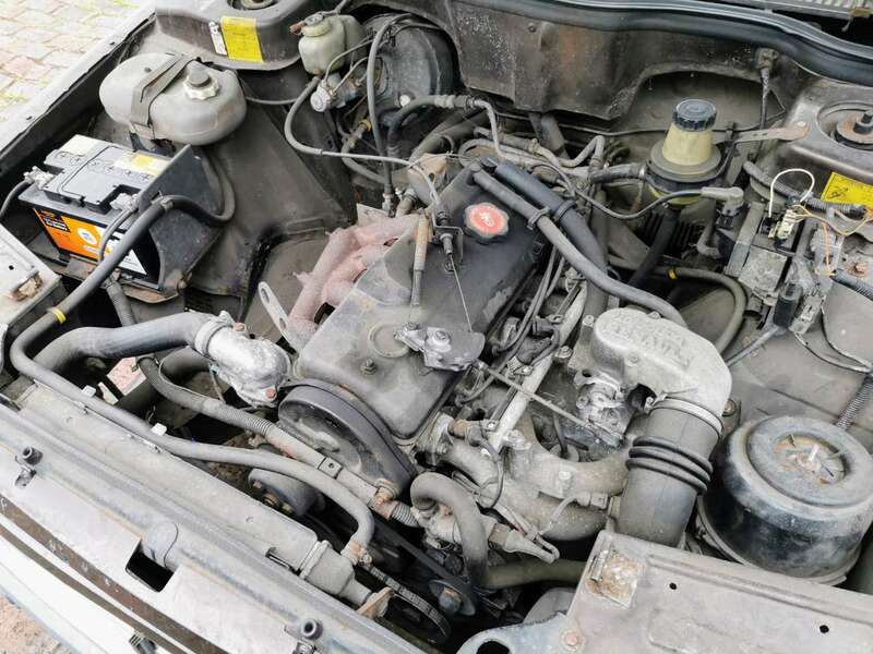

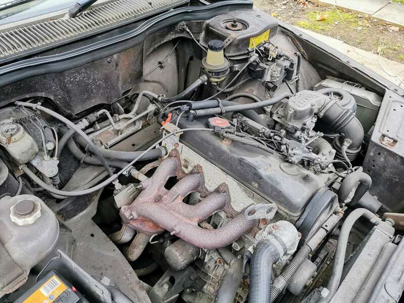

The engine bay is filthy.  Though astonishingly free of bodges for a car of this age.  The only obvious thing I've found is an aftermarket cooling fan having been fitted and the wiring for that being a little untidy (though perfectly serviceable)
It always felt to me like that manifold should have a heat shield on it, though I've never actually seen one on any of these.
Edit: Thought about the studs on the exhaust manifold - hot air riser for carb models?

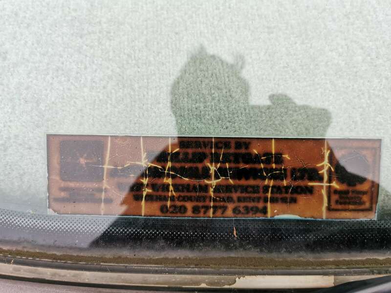

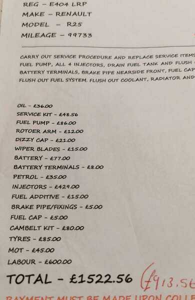

Though this does pretty much confirm my suspicion that while the car was serviced when it was put back on the road in 2017, it's not had one since.
So that will be happening pretty much ASAP.  The oil isn't horrible but it definitely isn't what I'd call clean.

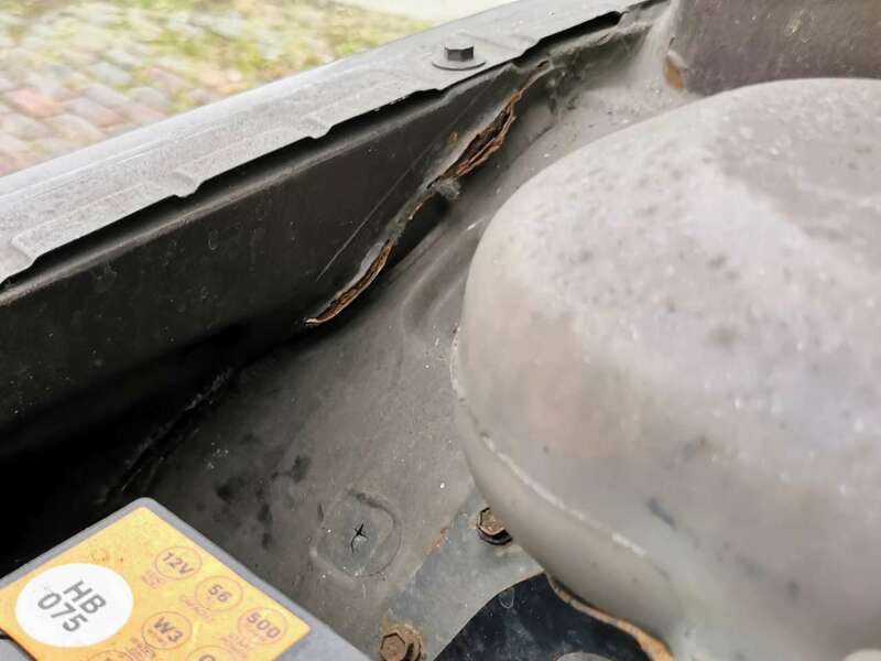

Under the bonnet contains the worst corrosion issues I've found so far.
Plus a little hole down here.
Which isn't anything which fills me with too much dread.  The outer wings bolt on, and once they're off access to do a proper repair to these areas shouldn't be a problem.

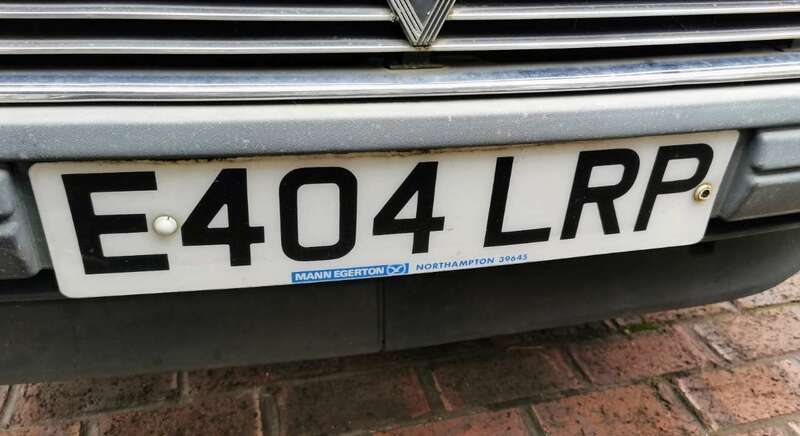

Given this is a Northampton registration number, I'm guessing these may actually still be the original dealer plates.
This sticker in the rear window has fared slightly less well.
One nice feature I was glad to see what still there was the original stereo - these were rather special by the standards of the time and were very much part of the look of the dash.
Sadly I've not been able to get any audio out of this save for a soft thump when it's powered on - though that may well be tied in to the issues we have with the digital display as if there's a problem with the comms to that panel which might make it think a button is being permanently held down it could lock the system up.  Failing that I'll need to do some further digging.  This wasn't just a flashy looking bit of bling either, the stereo in these cars sounded really good, especially by the standards of the time.  I remember being really impressed with it back when I had my previous one in 2003, and my home hi-fi wasn't exactly poor then either.
There are quite a lot of nice touches on this car, one of which I'd forgotten about until noticing it this afternoon is the mini-sun visor in the middle.
Which does away with the usual gap you get between the left and right ones around the mirror.
There are (really rather large) door pockets hidden away under the arm rests, which you could be forgiven for missing entirely if you didn't know they were there.  A nice way of reducing visual clutter, and keeping stuff out of the way of prying eyes.
I am in the market for a couple of parts.  Firstly, an offside tail light as this one has a crack in and has a small ecosystem merrily growing inside.
I'll clean it out and seal the crack up, but it will want to be replaced long term.

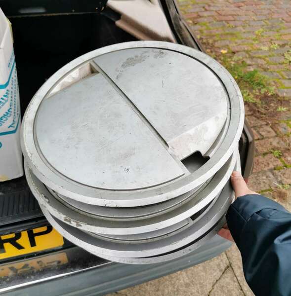

Interestingly the boot was hiding a box full of a set of wheel trims...which while for a French car, not *this* French car.  If anyone with a BX wants these, drop me a PM.
Few scuffs around the edges of a couple but they could absolutely be cleaned up.

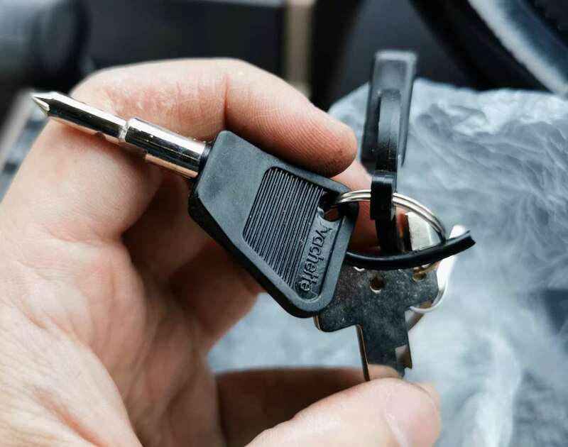

I went to pick up to dispose of what I thought was an empty plastic bag sitting down by the handbrake only to discover there was actually something in it.
Keys!  Most importantly a spare door key as I was expecting getting hold of one of those to be a right war as they're such an odd type.
Also present was a key blade for fitting to a remote fob...and two of said fobs...one in decent shape, one rather ratty (this key isn't for this car by the way which is why I've not bothered keeping the bitting of the actual key hidden at all).
My theory was that the one that was falling apart was for this car, and the other one was from a scrapper intended to donate the case.  The innards of both remotes worked with a fresh set of batteries, but sadly neither locks or unlocks the car.  Shame, but it was being a bit optimistic.  As I understand it these remotes are paired to the car at the factory and there's no way to sync a different one with the car after the fact.  So unless I could get one coded to the car from Renault (which I really rather doubt at this point) I'm probably out of luck there.
Does mean I've been able to assemble a remote style key for the car though, so I can use that instead of the "backup" style one shown to the left below.  This is a good deal less fiddly to get into the ignition it has to be said.

When I bought mine,the PO had strapped a big plastic bottle of water to the inner wing. He was a bit cagey about it, saying it was just in case. Like yours it'd had little recent use. It was July last year and pretty warm. Noticed the temperature would rise quite rapidly if the car wasn't moving, dropping pretty rapidly once underway. Soon realised the fan wasn't cutting in. Cleaning the connector soon cured that. Decided to change the coolant ASAP. Found the hose to the overflow bottle was completely blocked and needed poking out with a stick as flushing with mains pressure did nothing. Flushed the radiator and blew core out with compressed air. Had awful trouble refilling and getting air out. It had also had trouble with the automatic choke which seemed impossible to set right. To get it to tickover cold it would be much too fast when hot and vice versa.A good tickover is important with an automatic. Struggled with this for a while, finally realising the choke worked off water temperature and wasn't warming up. The water flowed through the inlet manifold, through the heated carburettor flange to the choke heater. The carb flange was completely blocked and had to be poked out with a small screwdriver. Once all this had been done, it all worked as well as it's likely too. Regarding the seat belt, I tried mine and it doesn't seem too bad, though I have to have the seat right back to get enough legroom,being quite tall. One thing I like, there's plenty of room under the bonnet to access things. Timing belt was almost a pleasure to do.
Thankfully the lines on this are clear, the water in the expansion bottle moves when you squeeze a hose.  Equally I also don't have carb adjustments to deal with, which kind of surprises me with yours being that much later.  I wonder if the injection option was part of the Monaco package.
I find it highly amusing that the handbook seems to have precisely as big an issue with clear coat peel as the car!
4 hours ago, LightBulbFun said:
the change from the 1st keeper to the 2nd happened in 2003!
so you could well be onto something!
Is there any way to see the previous keeper's details any more? Swallow Crescent was the address, and the date fits with when we moved in!
these 2.0 litre renner lumps cooling system can be an absolute see you next tuesday to bleed
my b-i-l used to service a 21 and it usually took 3 sesions to bleed!

That is an amazing purchase, really well done! I have similar feelings for a long lost R21 Savannah diesel we had. They are extinct now of course, but the one we had was just perfect even though it was shabby. Still miss it and would have another.
