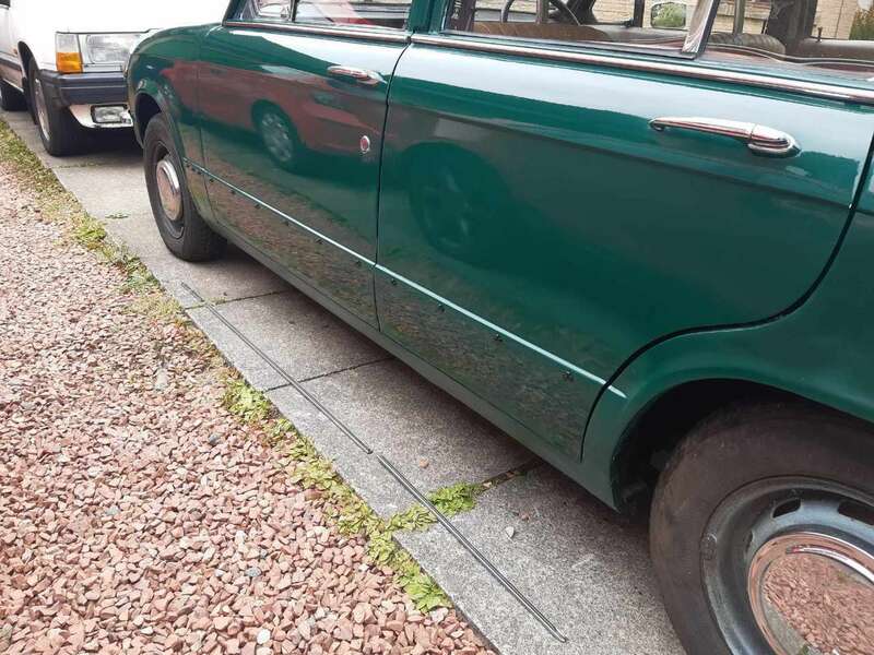

So, the last few weeks were pretty busy with me getting the car ready for FOTU.

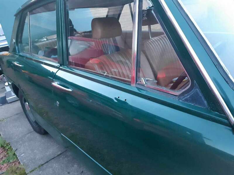

Polishing the entire car and refitting missing trims.

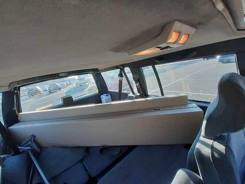

Also got the parcel shelf refitted.

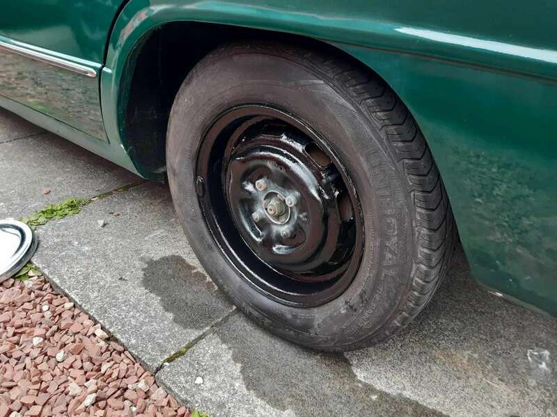

Gave the steels a halfarsed satin black.

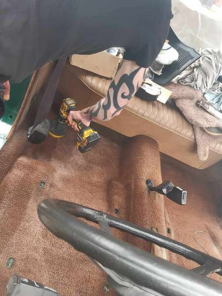

@davidfowler2000 popped over with a wet vac and the interior was cleaned, seat runners greased etc.

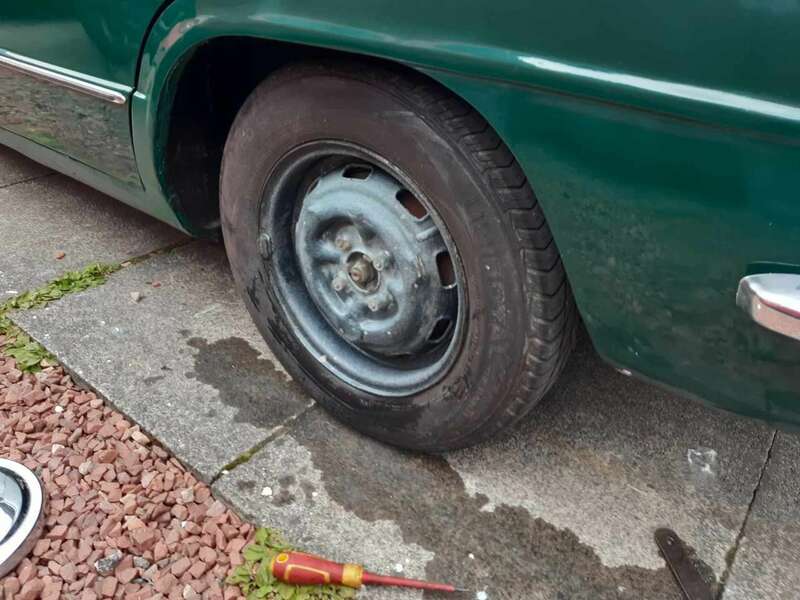

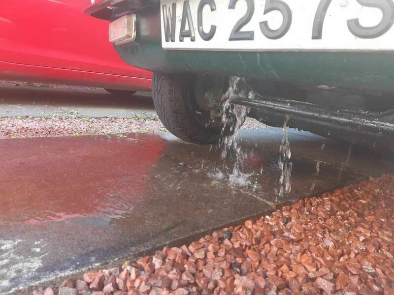

About 15 miles in I noticed it was getting hot, over 1/2 on the gauge. This never happens, it rarely ventures much above 1/3rd. I flicked the heater on and reduced cruising speed to 55mph as I had been going pretty hard and didn't fancy stopping on the hard shoulder with the girlfriend in the car unless absolutely necessary.
Pulled into Hamilton services with the gauge tapping the red marker. Heard something hit off the undercarriage and spotted something roll off towards the lorry park in the rear mirror.
Met up with @blackboilersuit and @Supernaut and then jogged over the road to see if I'd ran something over or something large had fallen off. It's not uncommon for me to leave tools in the engine bay... Imagine my surprise when it turned out to be the crankshaft pulley nut.
@blackboilersuit and @Supernaut launched off back to Mr Suit's house to acquire a BIG SOCKET to reinstall it while I had a nose at the coolant system.

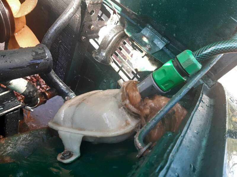

It hadn't exploded out of the overflow but was clearly very hot and opening the rad cap with a very long screwdriver revealed a lot of foamy coolant. I quickly whipped out the thermostat to make sure it hadn't stuck, but it seemed find.
We then refitted the crank nut (with Loctite this time) with me manning the bar while the radiator was held up out of the way.
341927319_359557165_805265041260338_4615275392076995888_n(Copy).jpg.e086f76a314496618391b1f028a1278e.jpg

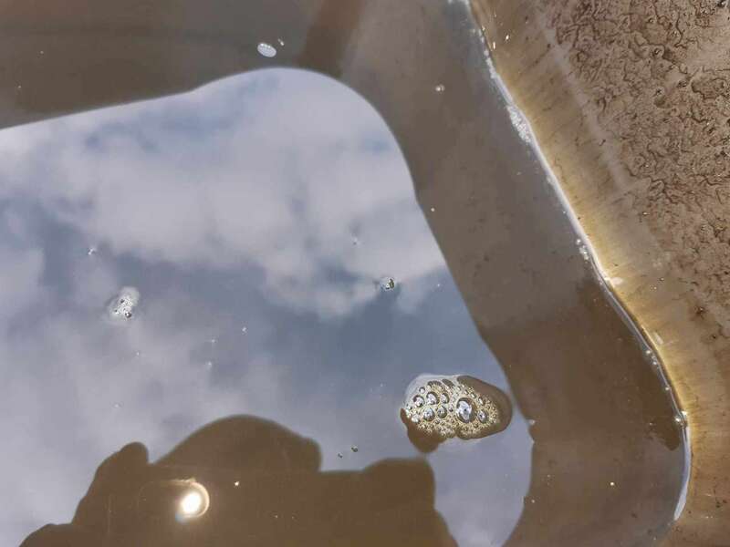

Then we could restart the engine. This showed that the water pump was working but with the rad cap off revving the engine would overflow the rad with foamy coolant. I went to check the oil and found it reading slightly overfull, and the car nearly stalled when I took the dip stick out. HGF M9.
Coolant was topped up and I toddled back home at a steady 50-55mph with a check of levels at the halfway mark and no issues. The car also never got massively hot, although admittedly the 'stat was still out of it.
My best guess is that when I'd flushed the coolant 2 days prior and ran the car around the block I actually had an air lock somewhere in the system. I've never had an issue with air locks but @MrsJuular had loads of issues getting the air out of her mechanically identical Toledo. The car didn't really get used much the next two days as I was out of the house 12-14 hours at work. Throwing the car at the motorway and sitting at 75mph then cooked the cheapo head gasket.
It wouldn't be the first time I've had a generic gasket fail not long after fitting, but I couldn't get hold of a decent Payen one for this engine as they seemed to be out of stock everywhere. At least a head gasket is only a 2hr job and there doesn't seem to be any major mixing of liquids... Jury is still out on the oil level as neither my driveway or the place I'd broken down were on level ground.
