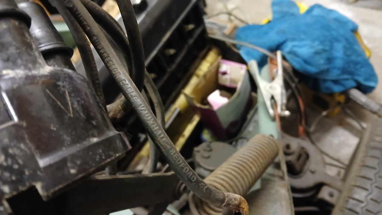

Today I was messing about with the 740. Checked the continuity for the 3 wires that go to the alternator and they're all fine. Pulled the alternator.
As you can see it lives under the oil filter and in the path of the inevitable rocker cover gasket seepage.
There was evidence I was not the first person to have removed it...
The bushes were a decent length, online seems to suggest they can be nearly flush with the housing before they are totally dead.
I tested the resistance for the diodes and then rigged the alternator up to a battery and ran it off a drill for bench testing.
Completely dead. Will need to dig into it further. Don't get why the battery light in the car is going out, despite no charge, when my test light doesn't.

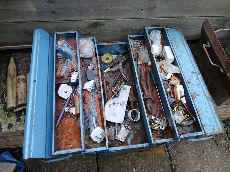

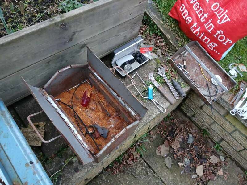

I also finally sorted out the stuff that was recovered from Girlfriend_70's gran's shed.
The metal toolboxes were right underneath the hole in the roof.
The big cantilever one has actually rusted through on the bottom. Most of the contents will have to go in an acid based de-rusting solution of some description and we'll see what will actually be salvageable.

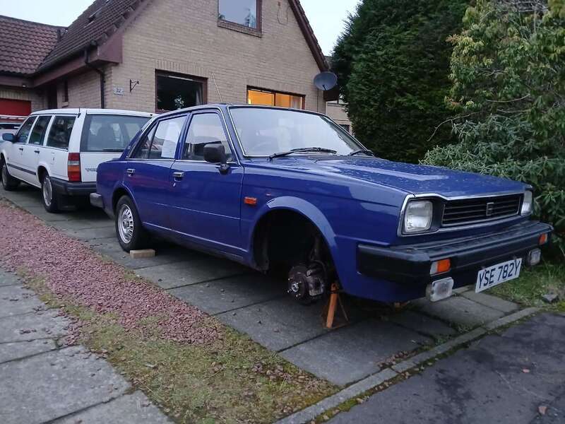

Perfect. With this in mind I have immobilised the car in a new way.
This is because the mobile tyre fitter is coming over tomorrow to replace these...
Which could be charitably described as "well used".
I prefer to remove/refit the wheels myself if possible, prevents squashed sills/chassis rails from being jacked up in the wrong place and means I can do the wheel nuts up to a torque which allows roadside removal in the case of a flat.

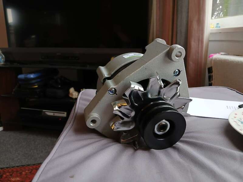

@MrsJuular kindly volunteered to test the 740's alternator and found the bridge rectifier was fucked. Replacement was £130 odd from Europe so just bought a new alternator.

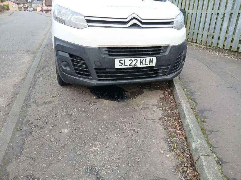

Obviously I went out to the work van this morning to find it sat in a puddle of oil...
This really isn't my problem but it'd be rude not to look...
Naturally, having been serviced last Tuesday, the sump plug was loose. Tightened it, drove to site and it was still dripping but with it hot I could get an extra 1/2 turn on it which seems to have stopped it.
The last time it was serviced they left a rear brake bleed nipple loose... As I discovered approaching a roundabout outside Redcar, downhill, off a dual carriageway, at speed.
And people wonder why I try to avoid having garages work on my cars...

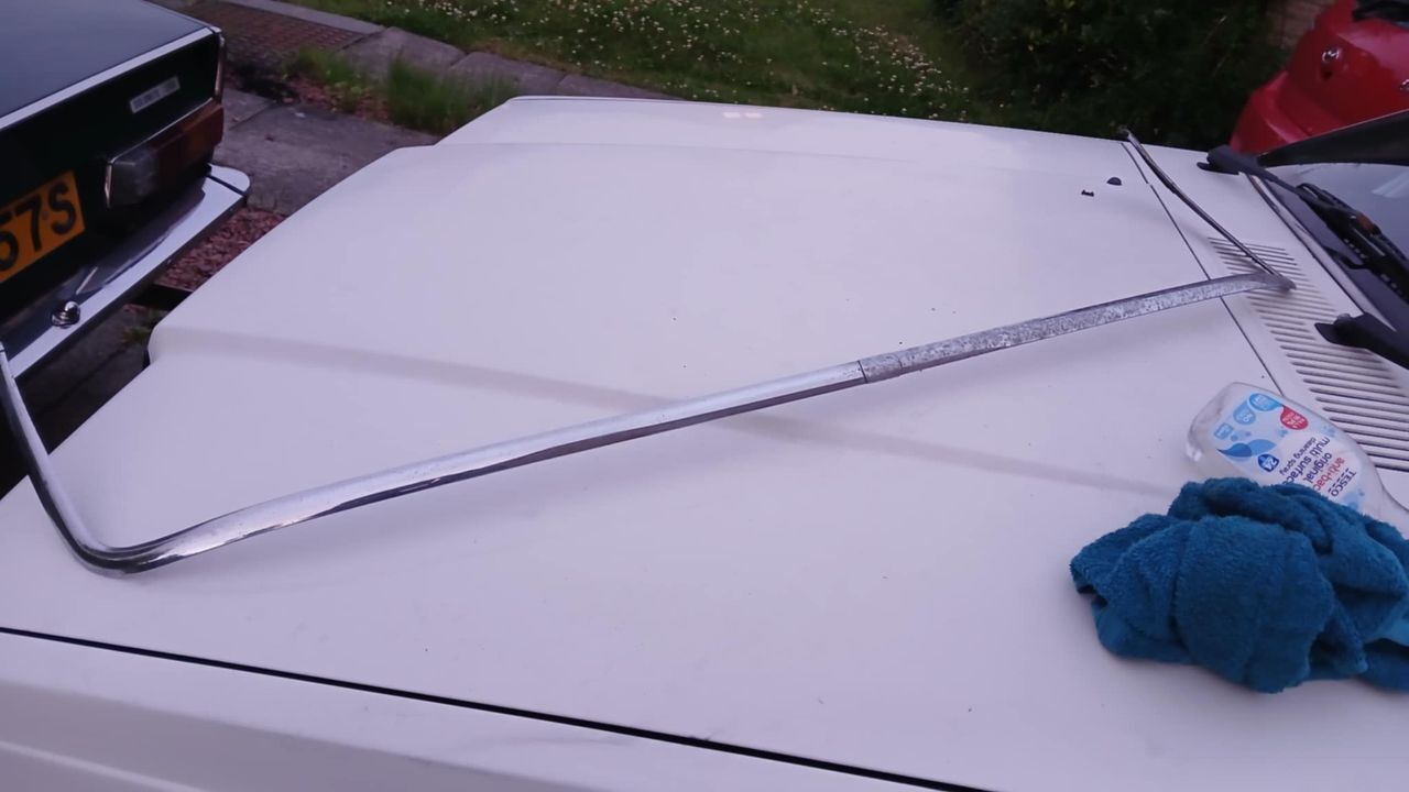

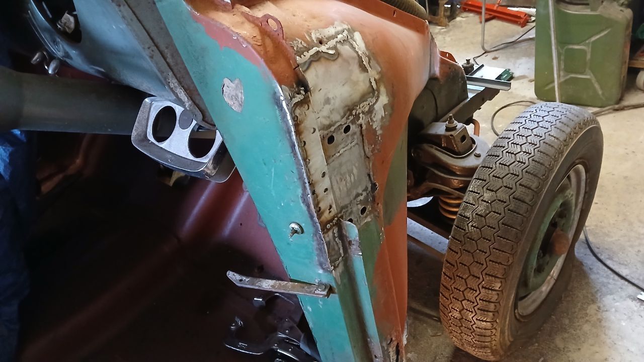

Finally started working on the Cresta as well... First time since November...

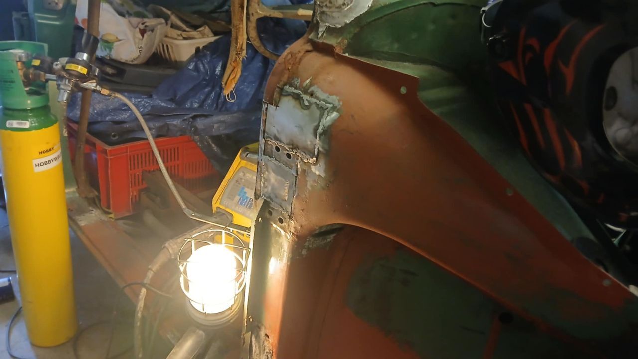

I'm being a bit haphazard given how much of this is hidden by chrome and lead. I need to get used to being able to put a bit of heat into the panels, it's a different beast after the Acclaim!

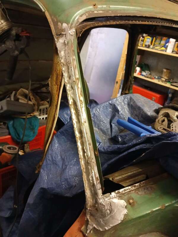

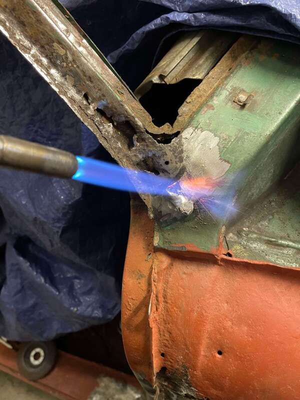

I made a start digging into the A pillar but ran out of gas...

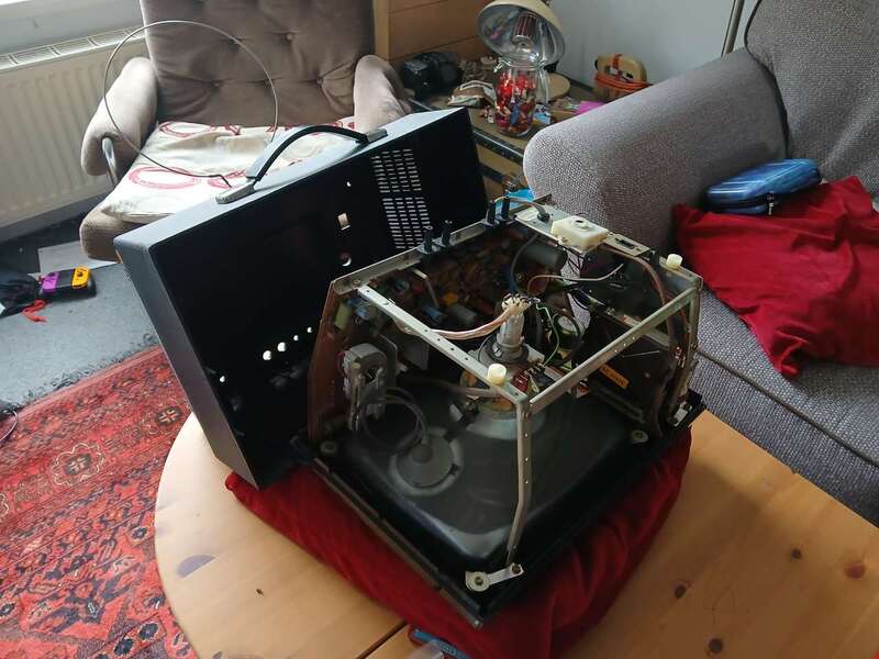

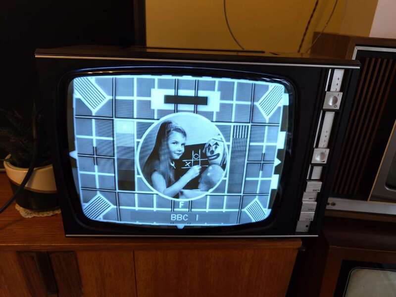

I did get my telly working though...

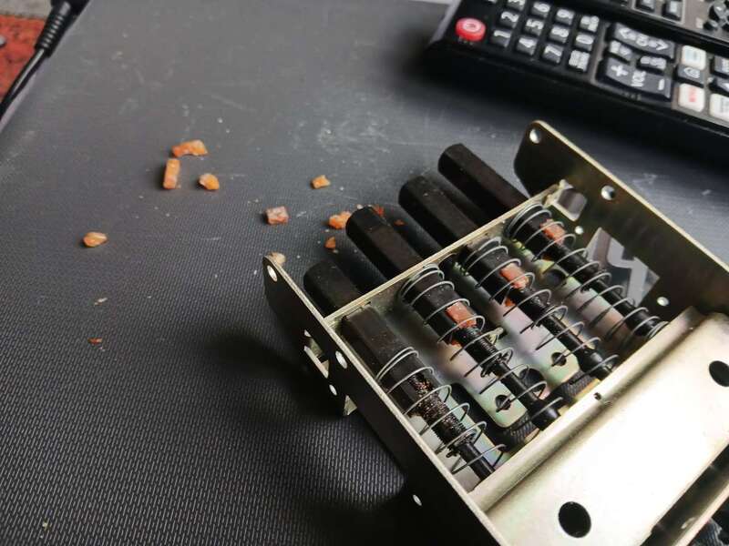

As @MarinaJosh had suggested may be the case the tuning buttons weren't working properly. You had to hold them in to maintain a picture.
Got to be a bit cautious with these things as they can hold voltage and launch you into low Earth orbit...
Those yellow chunks were once spring retaining washers. I found suitable replacements and reassembled and now they latch in place properly.
It is being fed signal through the finest Chinesium.
£19 from eBay. I remember when I was last looking for a CRT back around 2010 such a gadget would be nearer £100!
Sadly the capacitors show evidence of leakage so it'll need more work to be properly preserved.
  • captain_70s changed the title to Rusty Triumphs in Scotland - Now in black & white! - 26/02/25
Nice one! I can't see any signs of leaking caps in that board pic, the crusty looking stuff looks more like solder flux. I have also spent some time today playing with a 12" monochrome set!

Fitted the new alternator so it's back to being a functional car again.

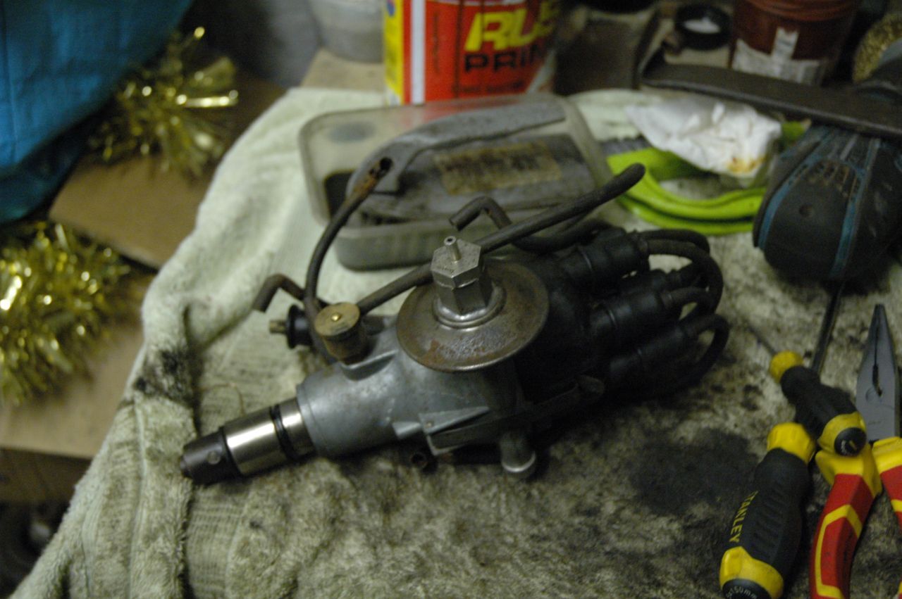

Lucas DMZ6A. Again, in good nick, nothing seems worn out, sucking on the vac advance made stuff move. Lots of grime, condensor is probably dead but the points cleaned up.
The dizzy cap has been scored with the cylinder nos!
The HT leads are pretty crusty but it'll be a shame to get rid, as they're almost certainly the originals.

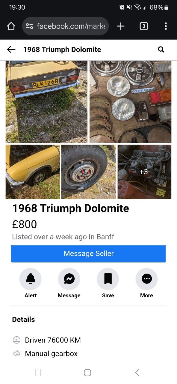

Don't think she's coming back...
  • captain_70s changed the title to Rusty Triumphs in Scotland - RLK 126R surfaces - 13/06/25

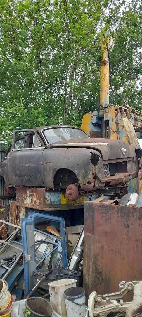

@captain_70s,this is a bloody long hike from you, and I don't know if anything is compatible with your cresta, but MK2 son spotted this wyvern in a breakers near Ely, Cambridgeshire last week.its been there for ages, he didn't know what it was.
They're quite an accommodating lot, might be able to post bits if you needed, or roadtrip? 😁
If you want contact details pm me, cheers
Throw a set of wheels on and drive it home, surely?
MOT exempt m8.
Pity about the yellow peril but that looks too far gone even for me and I adore these. The fact I'm in Kent doesn't add to the 'go save it' urge I'm afraid

Then a return to welding. Got the upper door hinge area structurally sound. There are four overlapping panels in places here. Awful moisture trap.
Also made up and trial fitted a simplified gutter design.
I reckon it'll work, may have to weld on a few tabs to grip the stainless trim. Good test run for my new metal shrinker/stretcher anway.

Chrome trim looks like it'll come back surprisingly well after a quick scrub with a scotchbrite!
That trim has cleaned up mega well all things considered.
I was quite pleased with it. Not entirely sure what it is, plated aluminium maybe?
All the pot metal castings have gone to shit, as they do, but there is quite a bit of stainless which is all pretty mint.
More welding the past few days.
Around the hinges was four layers of overlapping spot welded metal which all had to be dug out and built back up layer by layer.
I'm trying to replicate the original designs although not putting much effort into making things pretty. This will all be hidden when the wings are on.
Mildly concerning this is the good side of the car, but hey-ho...
