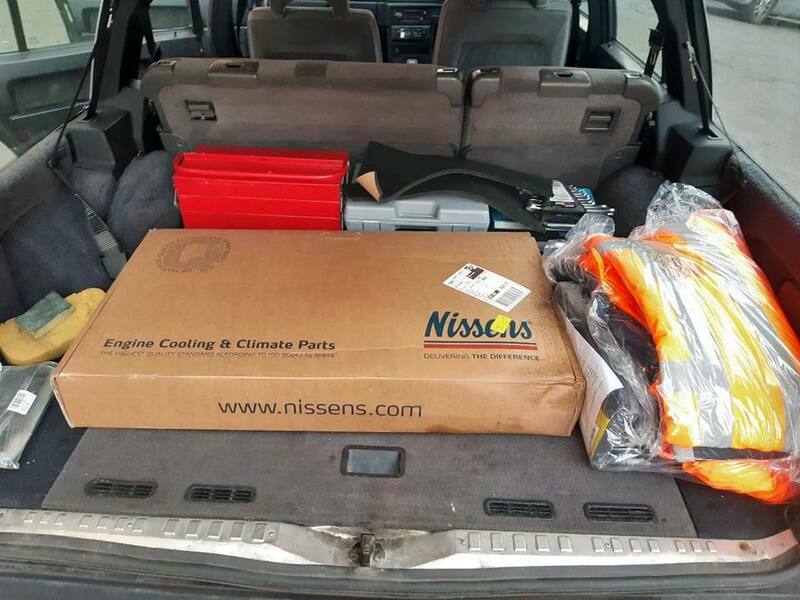

What is in the box? A Mk3 Polo radiator, generously donated by @jaypee which will be massaged into the Acclaim at some point.

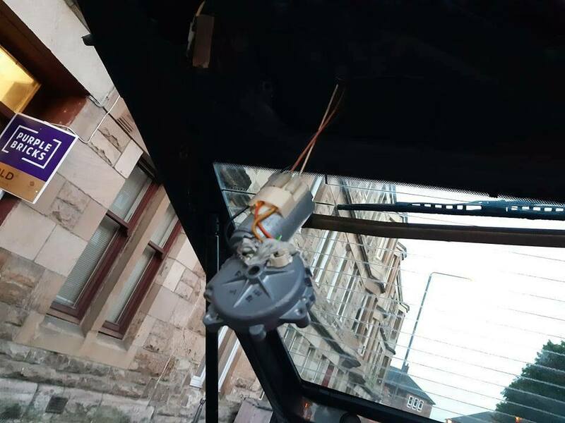

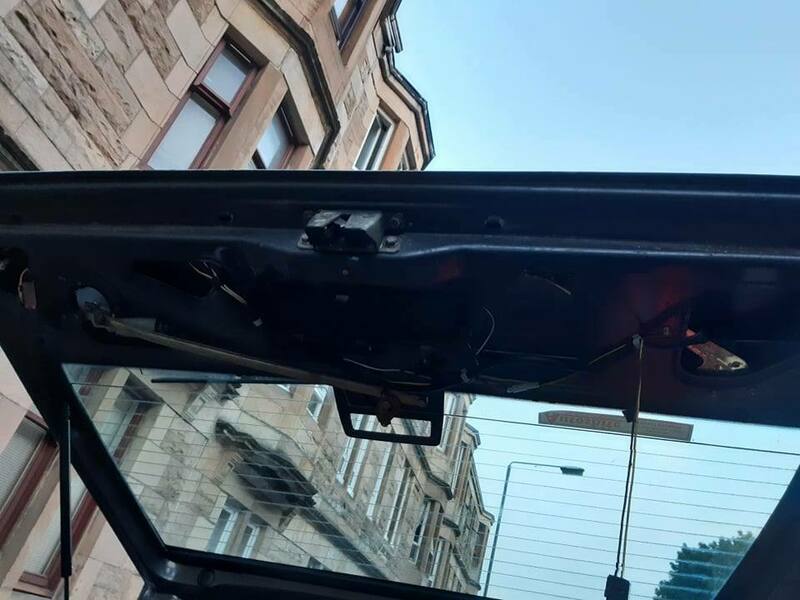

With the earthing problems yet to be discovered I found the biggest issue was that the rear wiper ran with the headlights. Obviously the solution to that was to unplug the rear wiper...
219004444_789228458625888_6254731380338898007_n.thumb.jpg.4471679c3b0fbfae09f8401222442df9.jpg
The plug for the motor is behind the motor, it is inaccessible, the loom that feeds it is also inaccessible.
219267355_423341962197212_3284966969545419697_n.thumb.jpg.086d6372aa6ec95bd2723222eab285b4.jpg
So I jettisoned the entire motor.

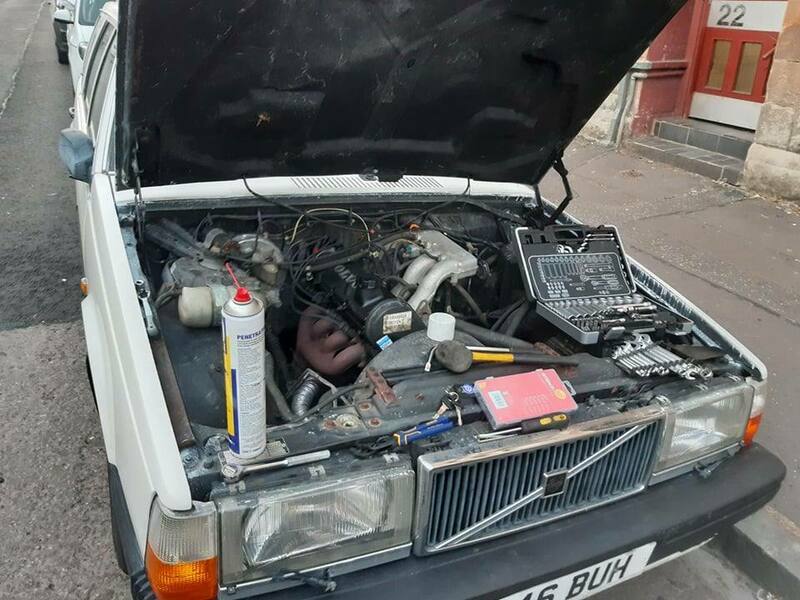

Then it was time for greasy stuff.
219822687_214707810442042_6100909363246609257_n.thumb.jpg.ca75959e0961b918822228b83bd1c72a.jpg

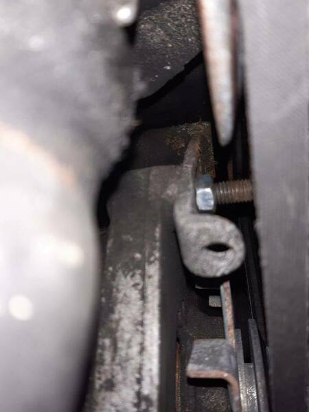

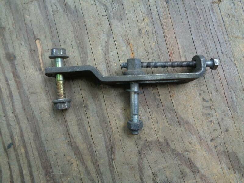

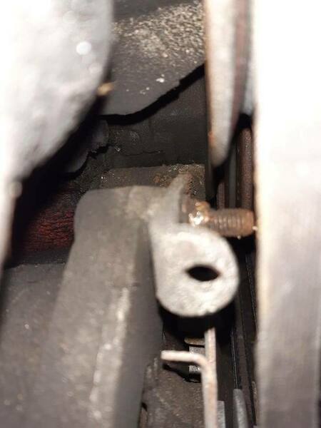

The alternator belt had also started screaming, so that needed looking at.
219032663_553064562557781_3331614364988636567_n.thumb.jpg.44c2202051fe3e4183c2247450235ee1.jpg
Yes, that'd be an issue. Actually more of an issue than you'd think because a large chunk of the tensioner was missing. It should look like this:
In it's absence all I could do was pry the alternator with a bar against the engine block and tighten up a new nut on the slider.
220840045_597063427945541_2384897234897102059_n.thumb.jpg.fba76a913fe4a4fdbe1cecd794b53914.jpg
The PAS pump has a similar set up, but less of it was missing.
221734310_802251493818049_4593452522533180940_n.thumb.jpg.07d89af283e878c45958f8274f0d5cef.jpg
I found a bolt that was long enough to work and reinstated it.

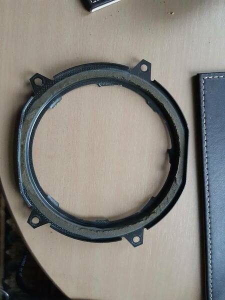

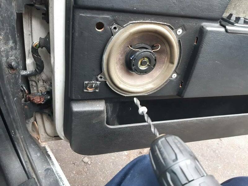

Finally, as I'm going to house sit for my parents this week I needed to swap out the blown driver's speaker.
236400862_567164614286405_107924566165822674_n.thumb.jpg.7c9914d50bcc14538a2233695690dddd.jpg

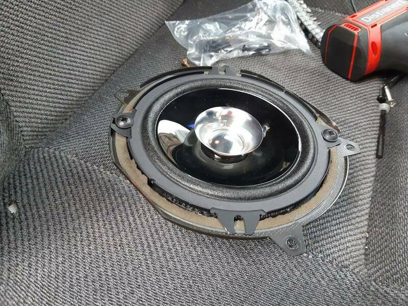

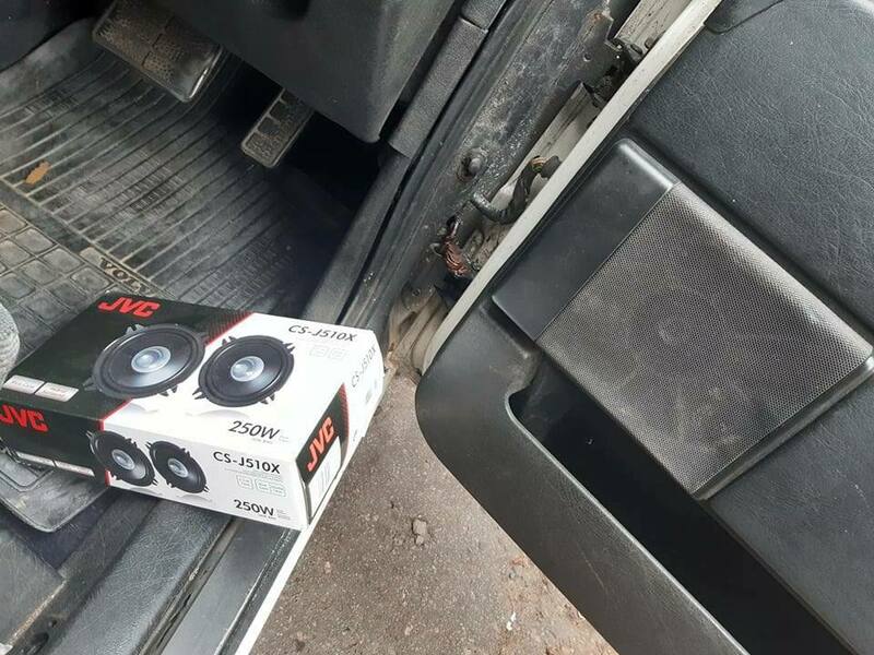

£15 worth of shit speakers. Should be easy, right?
236395057_1181078372411356_3905709527593349983_n.thumb.jpg.ce808d95e93cf7a67e13ac12672b1b1a.jpg

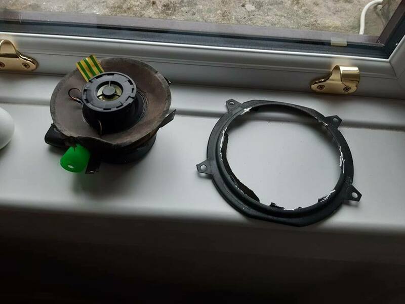

Of course Volvo riveted their speakers in...
You may also note the shape of the speaker. Not round. Well, kind of round, but with squared off edges.
Fun fact, stock Volvo speakers sit between common sizes. A round speaker of the same diameter fouls the cover, so I bought a size down, bringing a different set of problems...
236469115_127111729555320_892486140583129854_n.thumb.jpg.45070c217a378360755b4411a6d2bad0.jpg

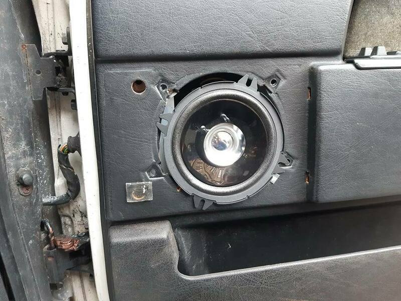

I was going to drill new mounting holes but they were just too close to the speaker cut-out and the door card just fell to bits. Right...
236183388_196917125753678_2544827517757786307_n.thumb.jpg.63cb693fcf9e58d2caccc98d52ea2b8f.jpg
237498420_846645659564973_2155287180432165950_n.thumb.jpg.54e1fa0be855599f2860dc19378a6d47.jpg
235884374_244433010862282_2701500082876362789_n.thumb.jpg.b2aa55348b9cd5620cf22a30a4d2ab89.jpg
It was @Tickman's idea to use the original housing to mount the new speakers in. You can get adaptor plates, but not fast enough for them to get here tomorrow...

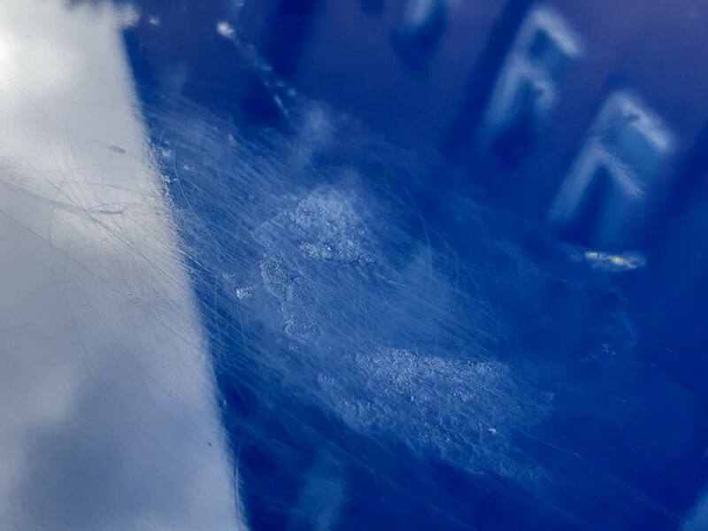

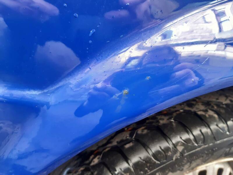

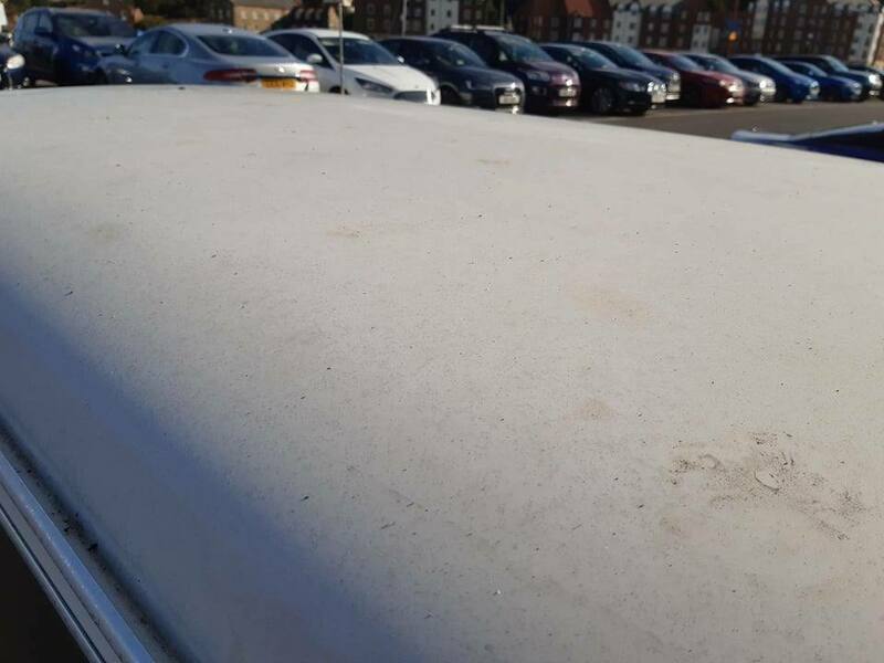

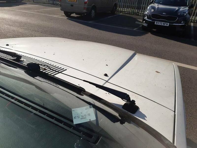

To folks saying the Acclaim's paint looks not too bad. This 24hrs of bird shit wiped off with a wet cloth...
Fuck't
13 minutes ago, Split_Pin said:
Ooft, that paint looks quite soft eh?
Still, at least it's attached to the car. I'm envious of that.
Scratches with a stern look, don't spray a car when its -3C outside, kids.
I need to locate a passenger side wing before respraying the car, the current one is humped on the inside and is already blistering.
It was patched up as well as possible but if you chopped out all the compromised metal there'd be no wing left.

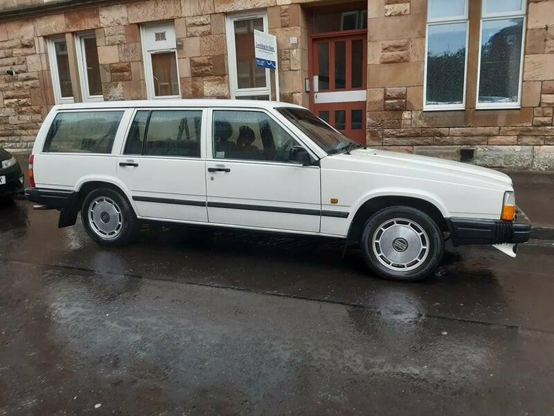

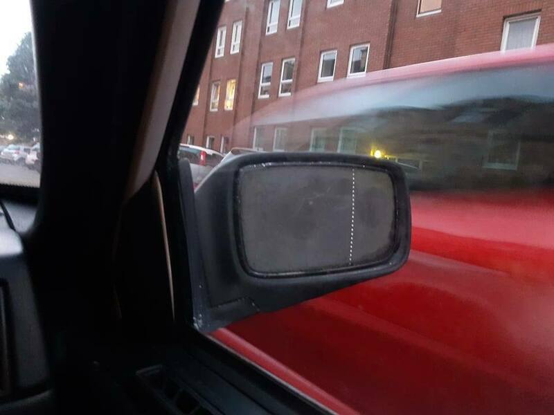

The other day I came out of the flat to find the Volvo's driver's side mirror pointing in some random direction. Weird.
Readjusted it, hit the road and thought nothing more of it. Until I set off from a set of traffic lights a bit harshly and while most of the car lurched forwards toward the horizon the mirror glass instead flopped out and shattered on the ground in my wake into a billion pieces.
243762474_552474519314392_5986873923919744910_n.thumb.jpg.e94c0c66c367702c3c84a2523460ccbf.jpg
Closer inspection show some scuffs to the mirror casing, so something has smacked it and dislodged the glass. Bit odd as the mirror wasn't folded back or anything. Whatever, replacement sticky back glass ordered.

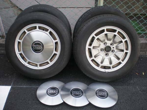

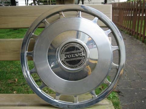

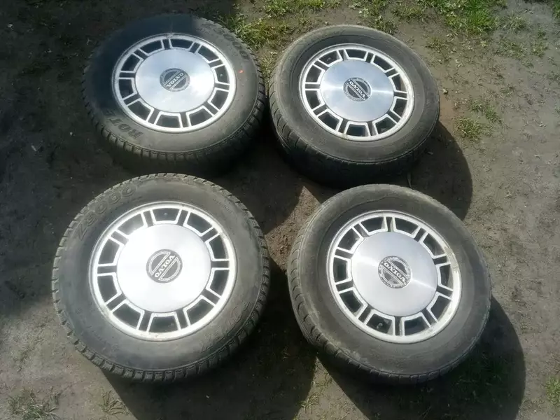

Don't think they have any way to be tied on, they're stainless trims on a 15" RIGEL alloy wheel, tabs grip them to the centre hole. They're quite tight, they click into place quite securely.
There is also a 14" wheel which follows the same concept.
Earlier cars got stainless trims over 14" steel wheels.

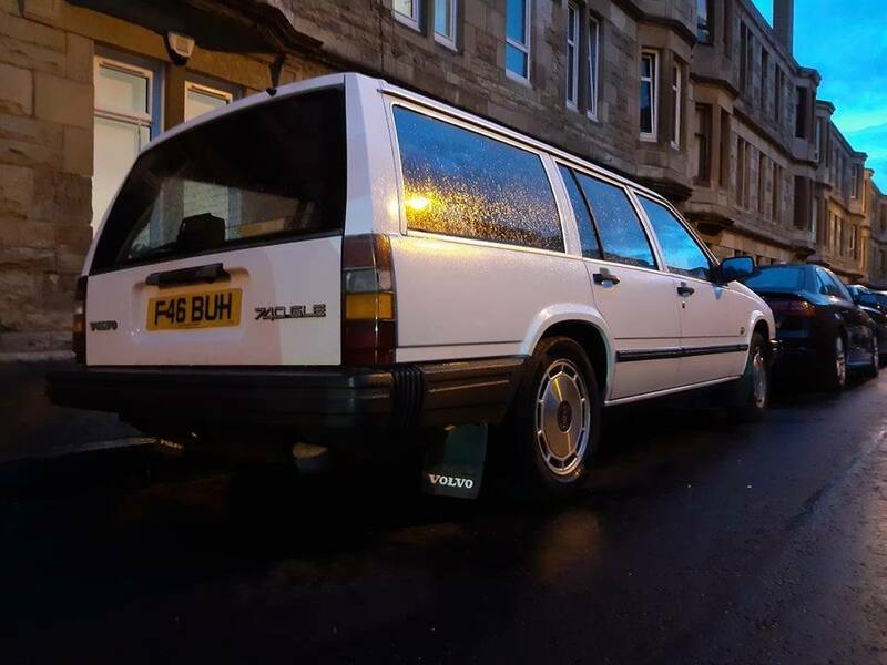

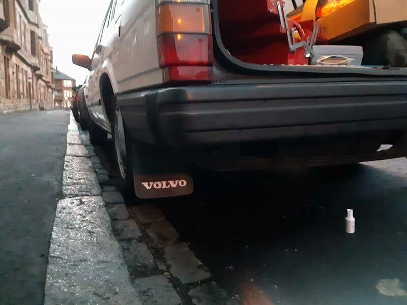

The trims and flaps have deffo elevated it from old junker with holes in the floor to cherished classic with holes in the floor.
Almost a retroreflective quality to the tipex repair,,Safety flaps

Previously the extent of the dash lighting was three out of four bulbs in the instrument cluster and that was it. Now we have new bulbs in the heater controls and behind all the switches, the wiring for the radio was rejigged so the 'leccy antenna is now working again and functionality was restored to the fag lighter/12v socket.
We also spent a while pulling relays and flicking switches to try and diagnose some of the electrical chaos. Current suspects are the ignition barrel and intermittent wiper relay.
I also spent some time underneath t'other day trying to identify a rattle from  the arse end of the thing, I couldn't find fuck all and am starting to think it's a bit of interior trim... The amount of suspension travel is obscene.
244395956_576413967138603_766201684776384341_n.thumb.jpg.006140e00f347bb588d8287dc7ac8b64.jpg
The thermostat also seems to have jammed open as it is running a bit cool. It's two nuts to change but I don't have one and me and Girlfriend_70s are fucking off to Scarborough for a week tomorrow so it'll have to wait.
