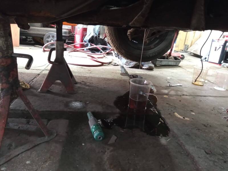

So, engine was in, most of ancillaries bolted up. Went to wind up oil pressure with an adaptor on a drill. Nothing, no pressure. Eh? DOA pump perhaps? Then I notice the rapidly growing puddle of fresh 30W growing on the floor. Fuck.
Paint cups were deployed and several litres of oil salvaged.
The engine was separated from gearbox and shuffled forwards in the engine bay so we could see where it was leaking. Turned out a plug was missing from one of the oil galleries. Oops. Went to wind pressure back up, still no dice... Eh? Then the drill adaptor fell off the drill... and vanished straight into the engine. Fuck life.
So the engine was removed from the car entirely, sump drained and removed and the adaptor salvaged.

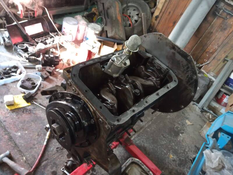

We then found the engine wouldn't turn, at least not without a lot of effort. Plugs were removed, bottom end was checked, nothing wedged in there... It was @GingerNuttz Dad who suggested the crank might have shifted with us heaving it out of the car, a tap on the pulley nut with a hammer had the engine spinning again. Fuck.
Crank float was checked, it was now at 0.025mm. FUCK. When checked out of the car it'd been at 0.018mm, dangerously close the max tolerance of 0.020mm. Well now the project is stalled (much like the engine would be if I ever tried to use the clutch in it's current state) until I can source custom oversized thrust washers. No idea how the tolerance has grown so much, perhaps I wasn't prying the crank hard enough when testing on the stand? Perhaps it was just favourable circumstances when we tested?
@Jikovron also just messaged me to say there is a gallery plug at the front of the engine too which will also be missing. That'll be the cause of the still missing oil pressure, bet it's behind the timing cover plate too. Why build an engine once when you could build it TWICE? ?
The good news is that this was all discovered before we fired the engine up and it destroyed itself...

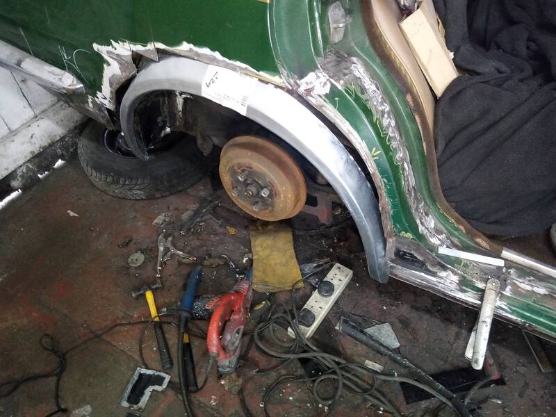

In bodywork news Mk2 Golf inner arches have landed are are being modified to fit.
As they arrived.
Following mild butchery.
I also bought this:
We need this to arrive before the inner arch shape/depth can be finalised. The leading end of the arch will still have to be fabricated but we have the opposite side to use as a template...
So essentially the project is stalled until the arch panel arrives or a thrust washer solution can be developed. Shouldn't take forever but still a bit of a bastard.
Did you do the tolerance test with the thrust washers well oiled?  It's entirely possible to get a film of oil behind the thrust washer, and then another between the crank web and the thrust washer.  Times 2 for the other one, and suddenly you've gained 0.005mm that isn't really there.  Usually when checking crank endfloat you need to apply a reasonable amount of force to the crank to ensure that it's definitely solidly up against each of the washers in question.  Also, it should be very repeatable on a dial gauge.  If the reading varies by 0.001/0.002 mm each time you check it, that's usually a sure sign you have something amiss.
What's more concerning is why the slightly excessive float is causing the engine to jam up.  There shouldn't be anything that by just moving the crank 0.005mm further than it should go then binds it up.  If you have the engine back out of the car, I would be looking very carefully to see what is causing the stiffness (ooh matron) when turning the engine over.  Can you hear anything clashing when you try to turn the engine over?  Also, which direction of movement of the crank causes it to bind up?
On the plus-side though, that's some superb work with the inner arches.  They can be an utter pain to get right, but the work there looks superb.  I highly highly recommend a hole or two drilled somewhere in the car so that you can get a waxoyl lance (or similar) in to the gap between the inner and outer arch and once the work is complete you can regularly flood that area with cavity wax and prevent corrosion in that seam.
Entirely my fault!
I reckon the crank grinding outfit I used put big fillets on the journals, and it looks like the shells go full width on the 1st and second position, I'm kicking myself as if I'd spotted that as a bind situation I'd have dressed the shells narrower so the crank could float freely.
Looking at the stock washers they only have a 10thou life before your into the backing steel which is probably a replacement interval of 20-30,000 miles or when 12-15 thou has been added to the float.
Custom ones will sort this, and the fillets will clearance faster than the washers wear.
Aye the bronze wear material on the washers is pathetically thin and once it's gone it's steel on steel with very little room for wear until the crank is FUBAR.
117909844_2762483087186121_65859784645003638_n.thumb.jpg.4eccd7c494e9a5d00e328214d3fba863.jpg
Commercially available  oversized examples simply have a thicker steel section, so they don't last any longer. Making them out of solid aluminium bronze would likely be the best option as that way even if they wear excessively they won't cause any damage until they physically drift loose. It's easy enough to check the crank float periodically and when they wear down drop the sump and install new ones.
I think @Jikovron's assessment that the crank has been ground with filleted edges and is riding up on the block with excessive fore/aft movements and causing the engine to lock. Would also explain the suddenly changing float measurement, with the engine on the stand I probably never lent on the crank hard enough to drive the crank up onto the fillets, with all the heaving the engine out the crank was forced all the way giving the "true" reading. I then had a better levering technique the second time and was doing the same effort.
The oversized thrust washers should sort that problem as well by simply keeping the crank from ever moving far enough for the fillets to be an issue. We know it doesn't have any issues when working to the factory tolerance and only binds in one direction of travel, so we should be all good to go with Operation Custom Thrust Washer!

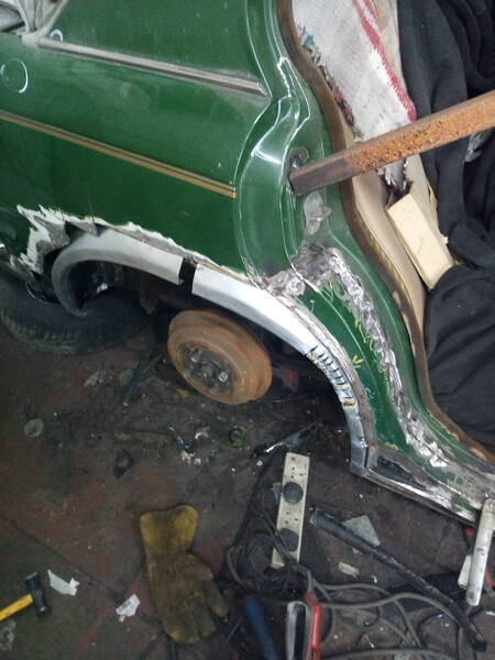

This also arrived today.
117963879_1222873344729423_6252728895465682182_n.thumb.jpg.ab4b9aa38ef35e48693daed82c5d9614.jpg
£60 for half of a cheap repair panel, but it's the best you can get these days and it'll make life loads easier...
117801591_305167144134568_2259110884953507836_n.thumb.jpg.80f2ba51d9a9afe4ced1b01d495faa75.jpg
As for rust prep the whole thing is being plastered in zinc paint and then drowned in wax. No box section or internal surface will be spared, on hot days it'll leave a puddle of rust proofing products oozing out of drain holes...
