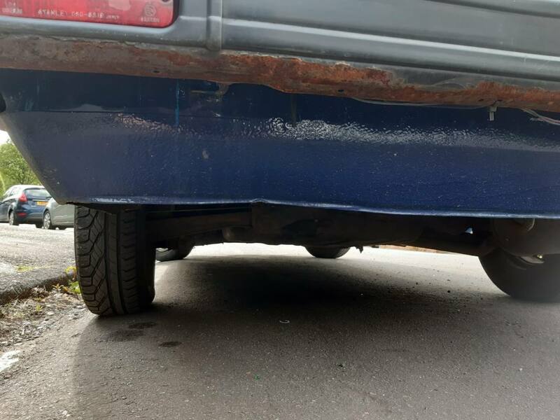

The Acclaim managed to gain a dent in the rear valance, fuck knows how. It's been pushed a good inch inwards. Also that bumper is fucking hideous, Jesus wept...

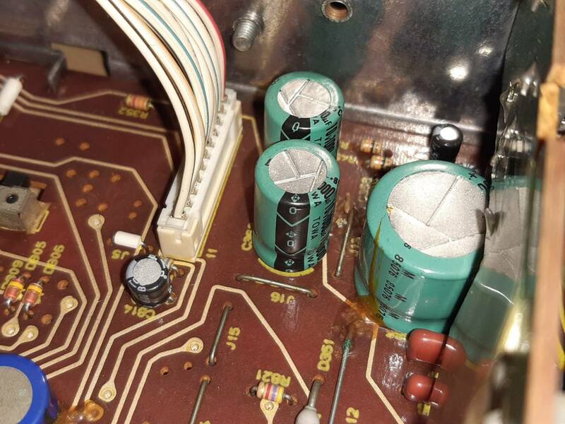

Firstly I phoned my local Volvo dealer and got the radio code, with the head unit unlocked it powered up but did nothing. I then found the fuse for the amp was blown, so replaced that. Now I had sound from the speakers, just nothing one might want to hear.
Pulled the unit apart, tried cleaning various connections etc and managed to get some genuine reception out of it. Sporadically. Kind of. Smacking the chassis of the radio with a screwdriver handle would cause the unit to work with violent stabs of interference and wavering volumes through various speakers but never consistently. I tried twiddling the pots and wiggling various boards to find no symptoms that could be replicated. Then I noticed it had gotten very hot around the back by the fuses.
I'm going to assume the capacitors aren't supposed to be leaking... Given the price of these units (£120+) I've ordered a soldering iron and shall attempt to repair it. I have a valve radio that needs the same work on a larger pre-circuit board scale, so I may practice with that...

I've been reliably informed the gunk on the capacitors is probably actually glue. Makes sense as I'd only ever seen capacitors burst from the top before, but I didn't see why they'd bother gluing soldered components. Seemingly it's 'cause they're heavy and it reduces stress on the joins, fair dos.
Yeah it looks a lot like glue to me, and as you say its there to reduce stress on the solder joints
however going by how it reacts when you whack it with something I want to say there might still be some dry (broken) joints somewhere still
not surprising given all the vibrations and stuff a car radio has to go through in its life time
so it might be worth taking the board and just reflowing/touching up any suspicious looking joints and seeing if that fixes anything :)
it might also be worth cleaning up the potentiometers with some contact cleaner or such
as a side note capacitors can still leak out of their arse, you mainly see it with surface mounted ones (many a vintage computer has sadly been ruined like this by leaking capacitor juice, which eats away at the copper traces and such)
so it is something I would still keep an eye out for just incase :)
The flickering front lighting along with the variable sound when being "tapped" suggests that you might have a cracked PCB and/or a cracked ribbon cable between PCBs.  Fingers crossed it's actually nothing more than dry solder joints, but tapping like that doesn't often make solder joints work again like that.

Aye, it's the original Volvo CR 702 unit, which are known to fail.
It seems to cut out various bits of the circuitry when prodded, but I've struggled to find of any particular movement changes things. It's a bitch to test too as the plugs and separate amp means it needs to be fucked about with while in the car.

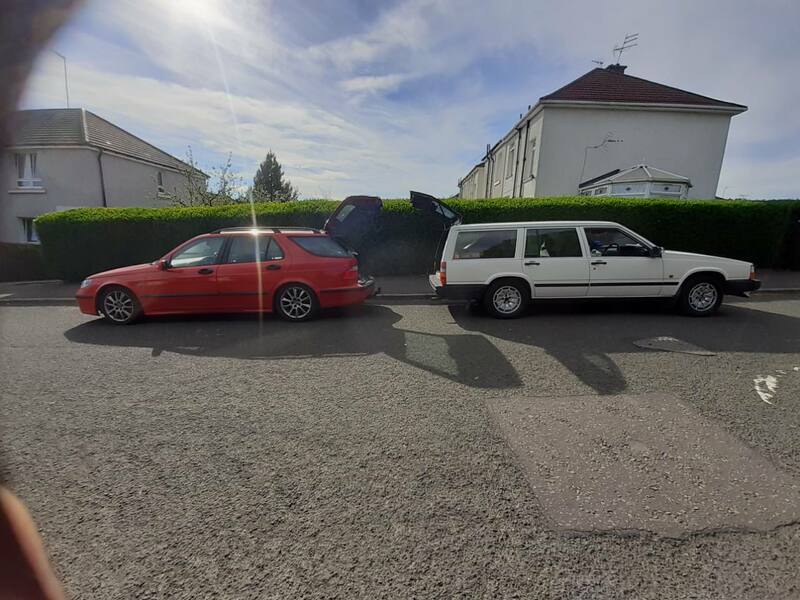

I transferred boot loads of shit and gave @blackboilersuit his Saab back. I realised it could be bump started if it wouldn't start with the key so strategically parked it facing downhill.
While it majorly saved my arse over winter I simply couldn't fix it. I did try and take the ignition barrel out but was utterly defeated and gave up before I ended up breaking it...

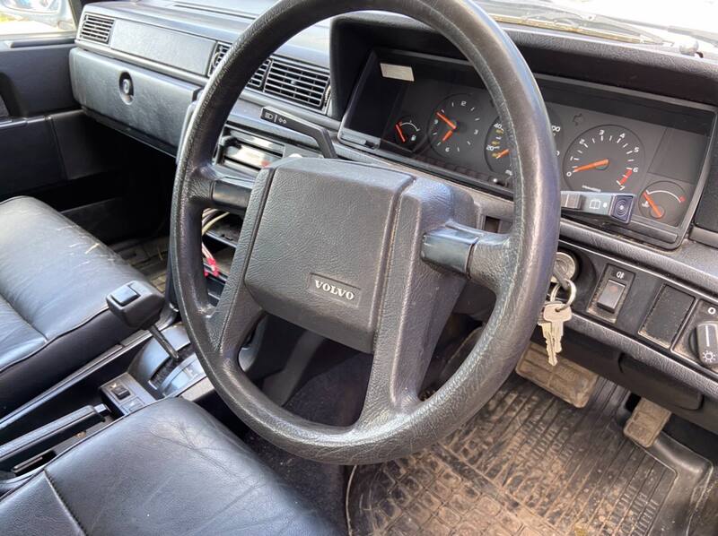

Volvo dash still looks like this:

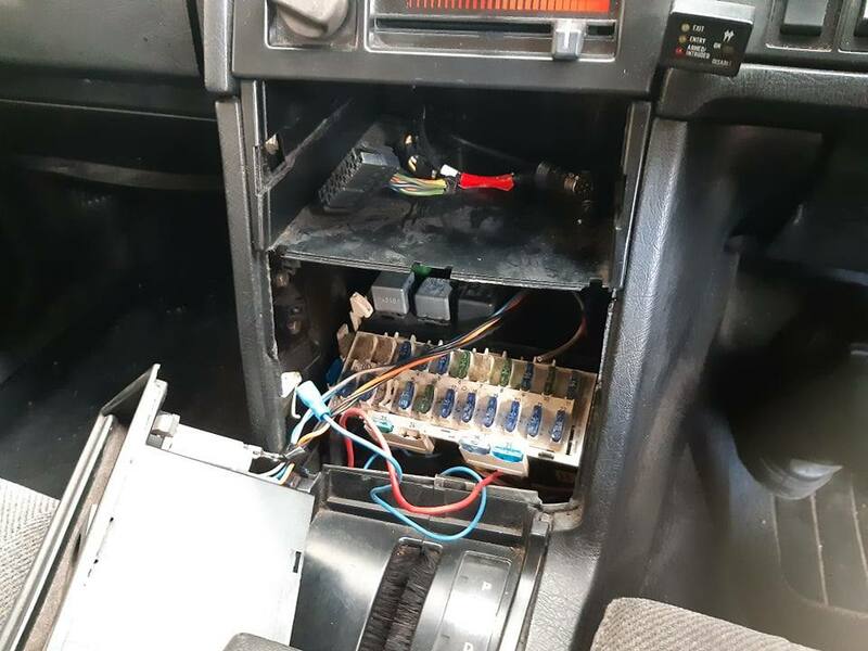

@cms206 may have a spare head unit, I've bought a £8 adaptor so facilitate fitting a normal head unit and bypassing the factory amp without butchering the loom if required.

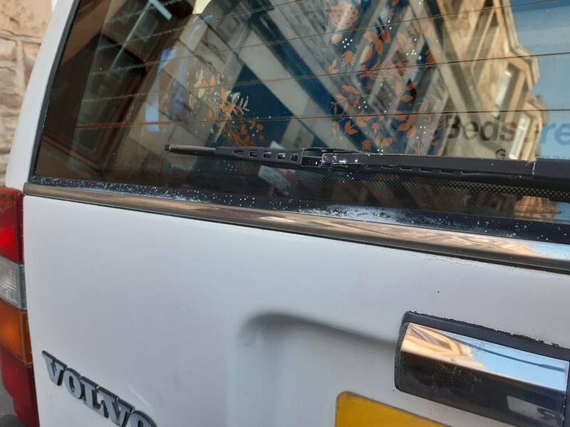

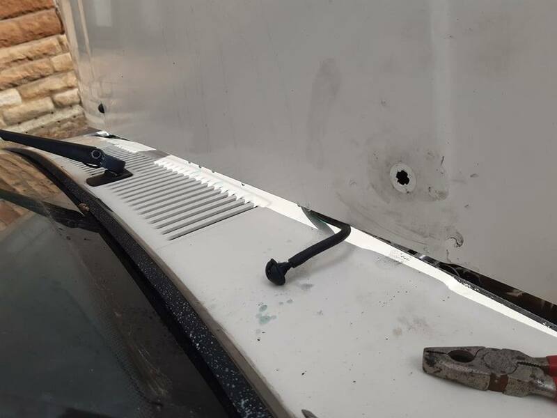

Then the windscreen washers stopped working, blocked.
199341857_214954947121643_3237240748577242203_n.thumb.jpg.59c12864edce1e1225697536802df769.jpg
199716232_184593740260316_3098146950431292395_n.thumb.jpg.bac3a7c97d34751bf39d8b697dffc652.jpg

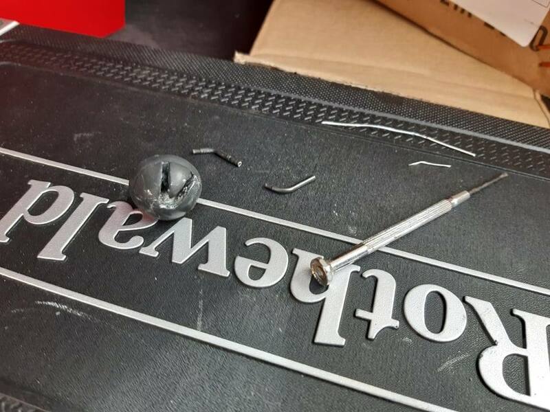

0.8mm welding wire fits in one end, but then it closes up to 0.6mm and I was using a safety pin. Managed to get three jets out of four working.

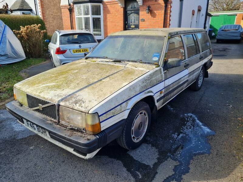

I then started looking at cosmetics... Due to the car sitting under a tree for 16 years it had a fair amount of growth on it when recovered.
This seems to have been cleaned off with TFR which has stained all the rubbers, scrubbing brings them back mostly. I've lost my linseed oil so no blacking has occurred so I'm still rocking grey mirrors...

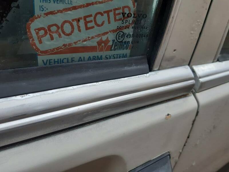

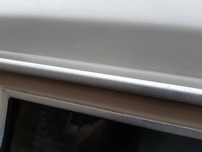

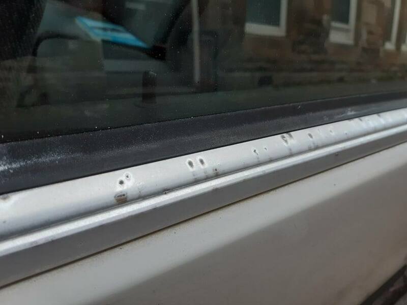

The trim has also gone cloudy and corroded in places. It's some sort of plated/varnished alloy and I couldn't get it to clean or polish.
198962415_354350082772626_1654383146949234658_n.thumb.jpg.fb7f1972f517bf4ae4801f0827974152.jpg
So I bust out the sandpaper on the worse bit.
200084430_1132175907275103_3263088023006456082_n.thumb.jpg.ef5351d58fbd5bd0c2e1111308eedf94.jpg

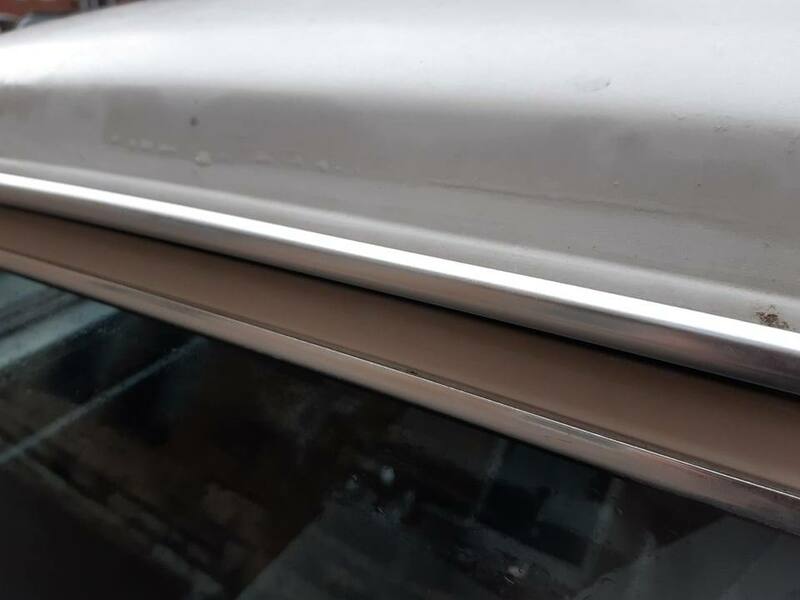

That's a quick going over with 800 grit, then 2000, then hand polished with Autosol. I reckon with a bit of effort it could come up fairly well, albeit a bit darker than the original finish.
For the gutter trims that were less corroded and just faded I went straight for 2000 grit and polish to finish.
198504839_2692609571030718_920719661341379465_n.thumb.jpg.2e9533bff1c3a3d3179df807aa70ed52.jpg
200473592_1414369212253207_2375402562152017205_n.thumb.jpg.c43991278a0b9d3d6a4c2e1ea71d8a92.jpg

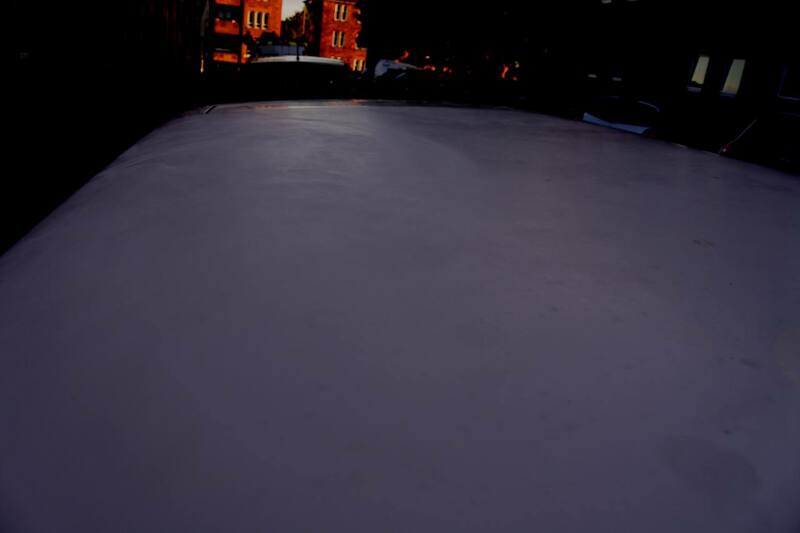

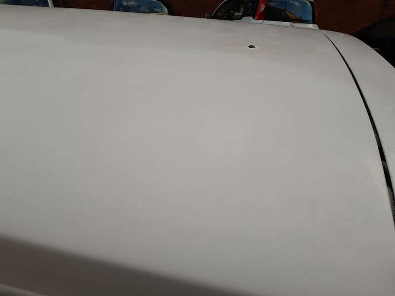

The not blind amongst you may have noticed the paint is... Poor.
The car was originally metallic grey but was painted white for it's duties as a site security/first aid vehicle. It seems to have been painted once to some sort of standard but then yellowed really badly and been blown over in white again at some point.
The roof was the worst bit, where the lichen had essentially dug into the paint and left big stains in it. I went ham on the thing with 600 grit sandpaper and quickly came to the conclusion I'd run out of paint before I got rid of the marks...
199509749_212391800599638_2028923078648035064_n.thumb.jpg.44f5870b71f16424848b59900b9a374e.jpg
It is mildly improved, but still massively shit. It looks alright from 20ft which is good enough. It could be painted, but It's the sort of car that is useful to double up as a workbench and can be used and parked around without worrying about damage...

I also got the door/boot switches for the interior lights working, and discovered the ultimate in luxury:

I even got mega brave/stupid and got the sunroof working on tilt...

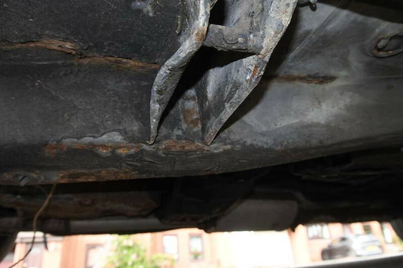

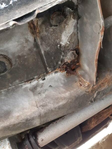

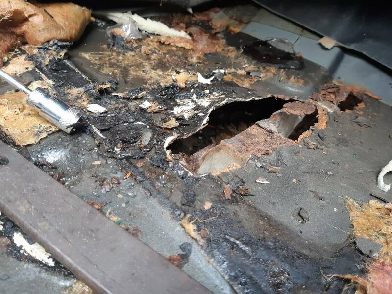

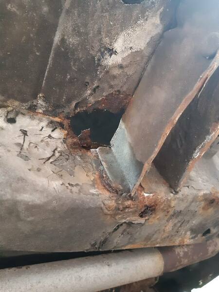

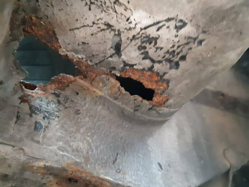

I knew the driver's floor looked a bit grotty around the chassis leg seams...
*prods*
*prods but with a hammer*
Fucking LOVE cars.

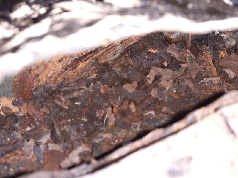

The chassis leg was full of shit. Leaves, plastic bags, rust, snail shells... Evidently it'd filled up over it's 16 years of sitting and rotted from the inside out.
It's not fair that rust can be magnetic and make a nice metallic ringing sound when tapped. That's AGAINST THE RULES.
