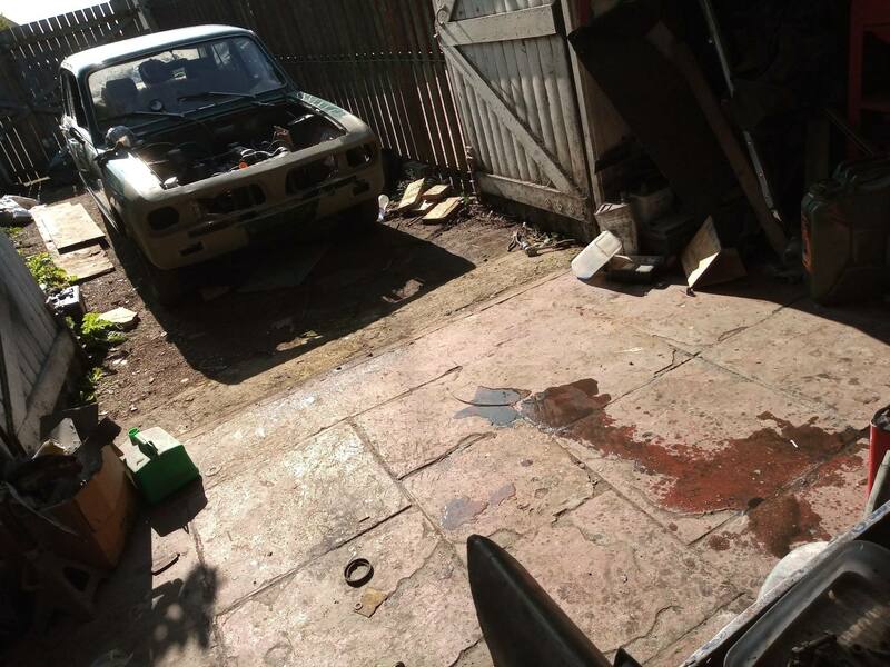

On 9/17/2020 at 11:20 PM, captain_70s said:
we did a compression test, 25psi per cylinder... Ah. Either we've fucked up the cam timing or somebody has sneaked into the workshop overnight and nicked the pistons.
I laughed too much at that.  25psi does suggest the cam timing is 180 out too.  Is it an easy mistake to make on that engine?

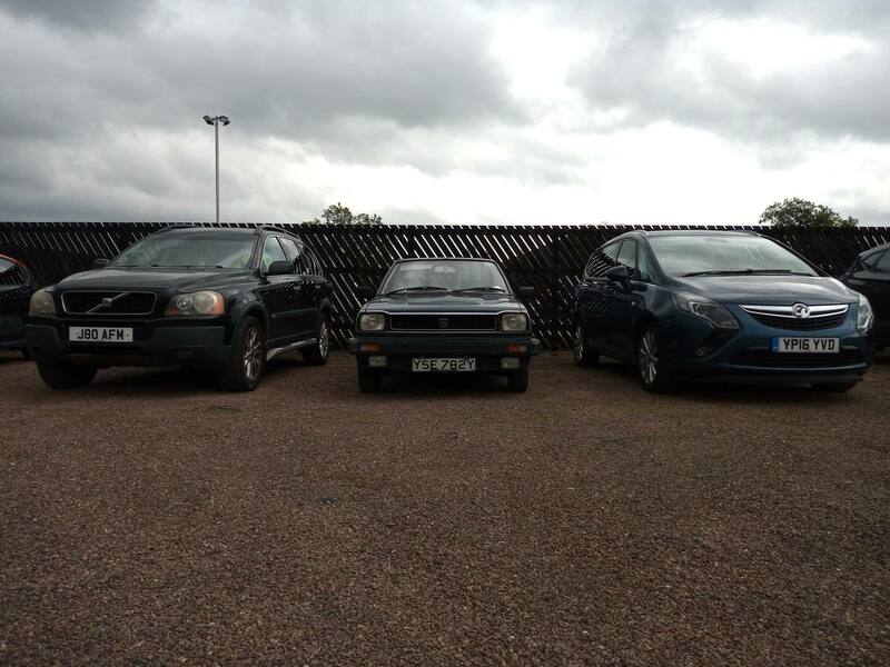

Running the commute as usual. Need to adjust the handbrake. MOT due at the end of November.

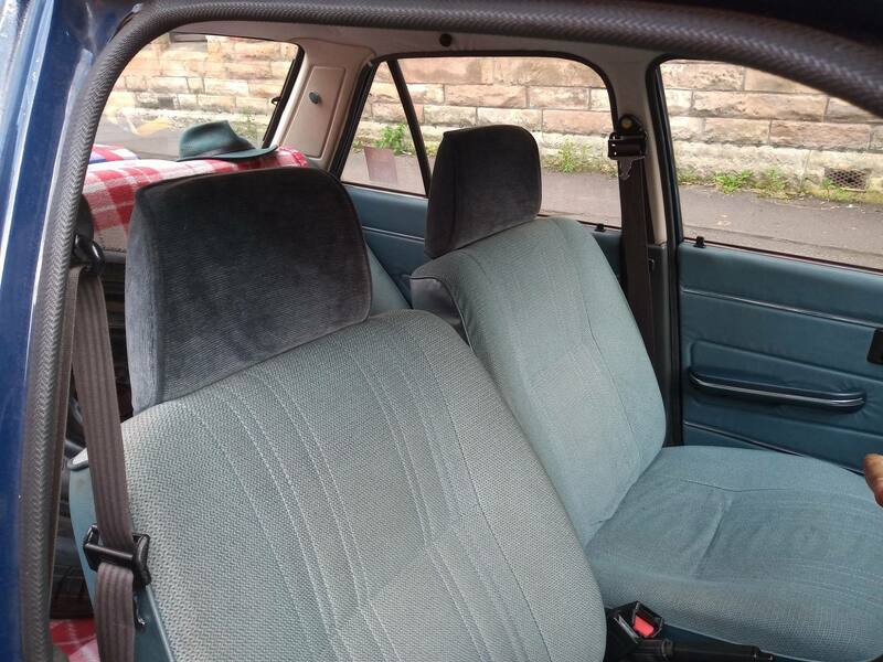

I've further defiled it's basey goodness by fitting head restraints, so at least a 15mph shunt won't decapitate the occupants.

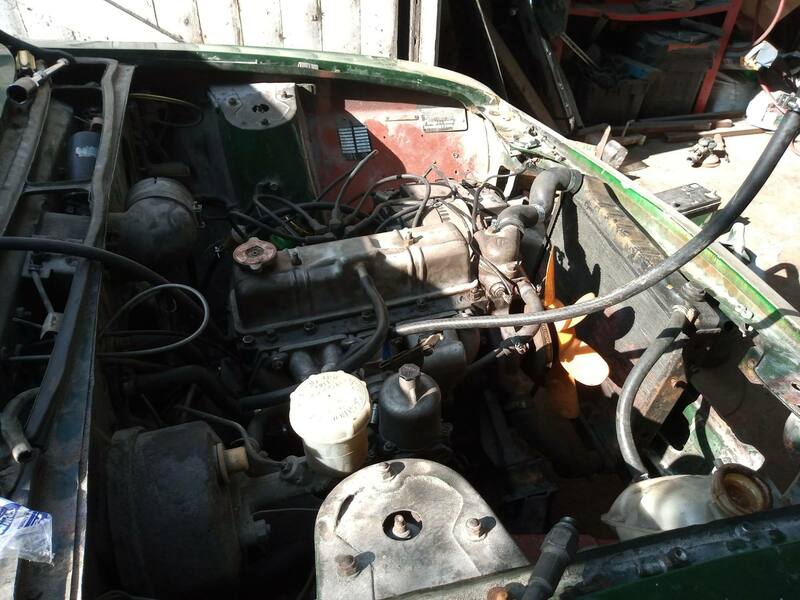

Me and @GingerNuttz had been discussing potential causes for the lack of compression and refusal to start and I'd been talking with @Jikovron about the same. Essentially it had to be cam timing, as losing such a huge amount of pressure anywhere else would be majorly obvious.
@GingerNuttzset the cam timing exactly the same as he did with his Herald using a micrometre to get the maximum lift on No.1 piston and aligning the cam sprocket with a degree wheel. This brought the compression down to a less than optimal 0psi per cylinder.
Right. The books were consulted, research was done, timing marks were checked and when I arrived on Saturday I was informed that the timing had been set again and we now had compression! Turns out we were probably 1 1/2 teeth out on the cam timing, enough to ruin compression but not enough for valve/piston interfacing. When it was done the second time it must have been 180 degrees out.
So, we went to fire it up. Nothing, not a cough. Checked spark, was acceptable. Fuel was being gravity fed straight to the carb so that was good. We looked at the dizzy, from memory I placed it roughly how it was back when the car last ran and from that we positioned the plug leads appropriately. Now it spluttered.
Right. Initial break in procedure is to start the engine and immediately take it up to about 2,500rpm for 20mins and run it up to temperature while full of 30w break in oil....
This is a pant shitting experience. If anything major is going to go wrong this is when it'll happen most spectacularly. I both didn't want to explode my new engine or get a rod through my face.
As it transpired nothing at all happened, oil pressure was great, coolant temp was stable, nothing leaked. After 20mins of solid running with my varying the throttle between around 2000-3000rpm we dumped all the break in oil and swapped filters. In doing this we drained the hot oil into a leaky bucket. Hence this picture:
119888316_3062340613877144_2615163977298647282_n.thumb.jpg.a331eba850fe4de631f360c674d05bdf.jpg
Yes, there was no disaster, merely a cunning jape. Hohoho.
Then we filled it up with regular 20w50.
A compression test was done, 150psi per cylinder. Absolutely bang-on. Hot oil pressure at idle is 25psi, gaining another 10psi per 1000rpm, ideal. Crank float while using the clutch is 4 thou, right at the low end of the tolerance.

Right. Engine confirmed good. Need to replace the springs in the dizzy as the timing wanders and rebuild the carb... Then find another HS4 and go for twins...

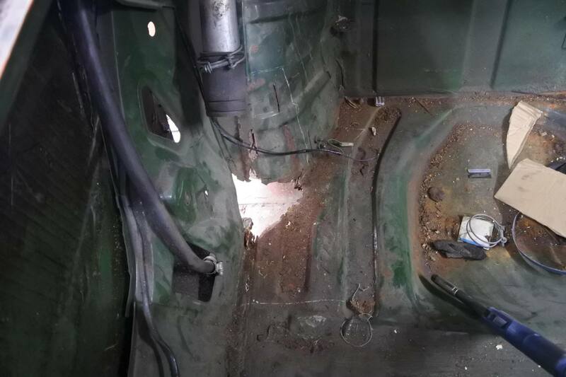

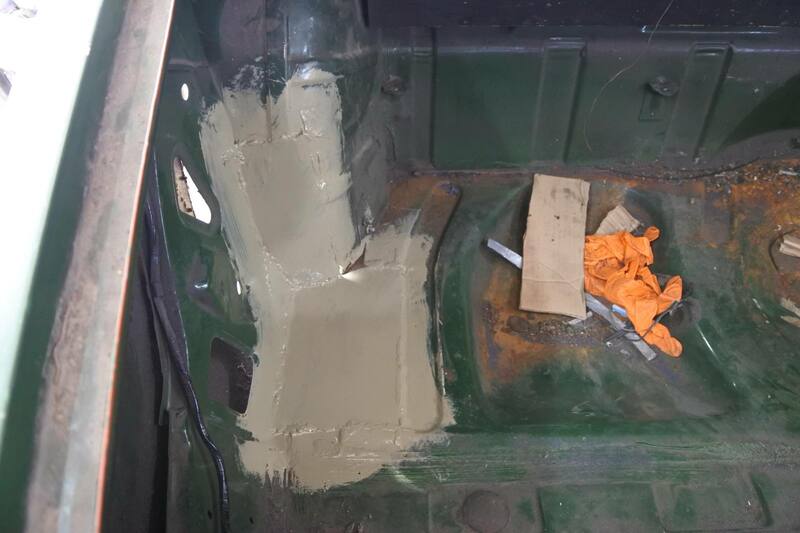

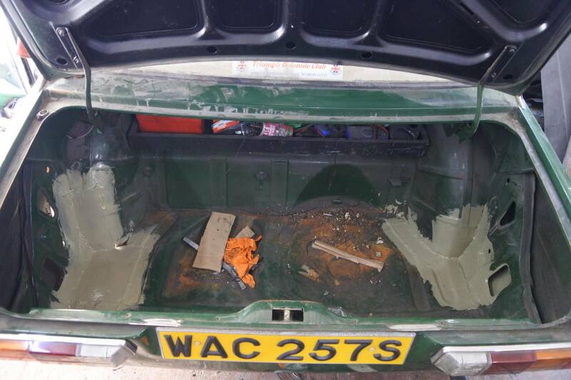

Not a whole lot to report really. I'd bought a MIG welder from @Tickman and today was the day I got to test it out.
Hole:
No hole:
No, I didn't bother to replicate the body pressings. It's 1.2mm steel so it'll be strong enough, it's been wafer thing crap for the last 30 years so that'll do, it also lives under the petrol tank and will never be seen.
The car is now one small triangle of steel away from have an entire boot floor for the first time in God knows how long...

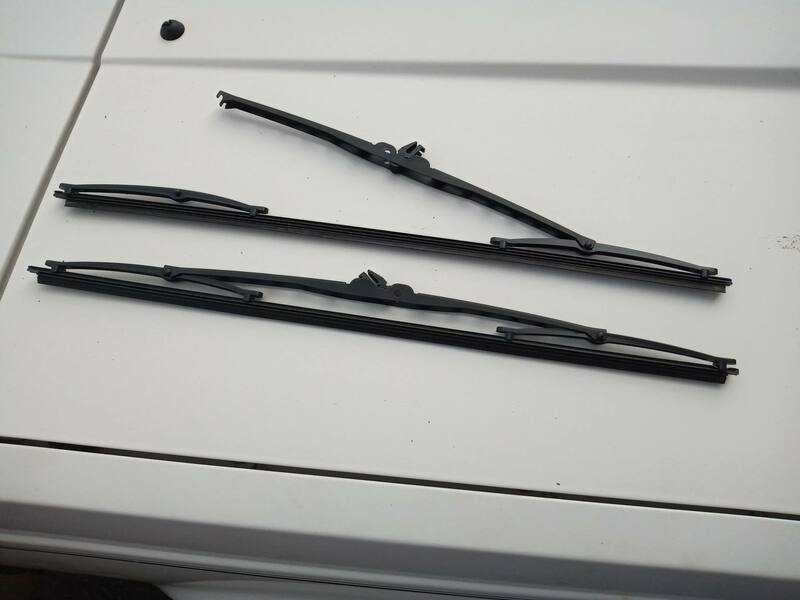

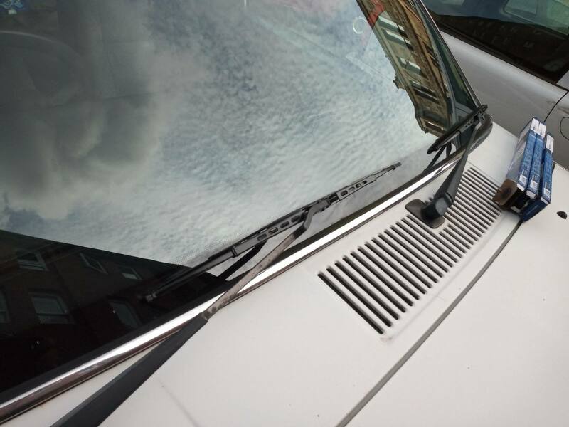

Firstly lights and wipers on the Volvo.
Bought a load of bulbs for the thing, didn't need any. The non-functional fog and reverse lights were bad connections, as was a dead side repeater. Oh well, more for the spares stash.
120043311_715396405711199_626083502484764588_n.thumb.jpg.c4075a0dd4484020dff7a679a9250a28.jpg
120198365_334651527871019_1861431527455111699_n.thumb.jpg.88ada1bc3ebe7c6eb111dd613ca0bc4a.jpg

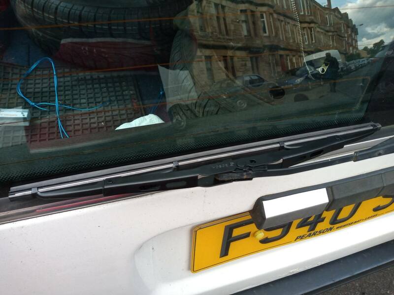

Never had a wiper fall to bits on removal before, the rear one was mouldy. Explains the rubbish performance...
120060835_2712351899014647_947693838052121313_n.thumb.jpg.c1ec7c8ad78f79106e24acc549d9f5ef.jpg
120047182_376811276667700_5354532604861837127_n.thumb.jpg.3fcc5ff1bf24f156526796c445756d3e.jpg
Shiny new goodness. Bosch because they were super reduced on eBay.

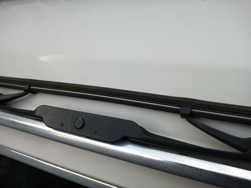

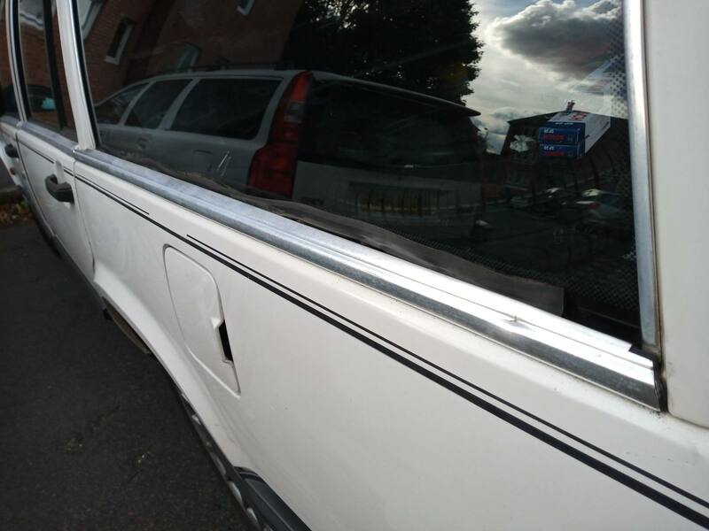

Next I reattached the weather stripping for the rear window that's been flapping about in the wind since I bought the car.
120075177_767728587361425_7516954293523962273_n.thumb.jpg.046d17f4f5e425547832894adcde2b0d.jpg
Yeah. I think that' might be a bit past it's best... Also evidence the car has had a blow over at some point under the trim.
120115436_1037593150044246_3231718786414820189_n.thumb.jpg.6dd165a472cc27d4a15d829e432d1305.jpg
Explains why the paint is flat as fuck.

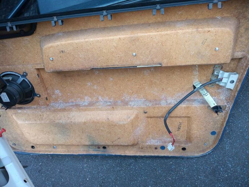

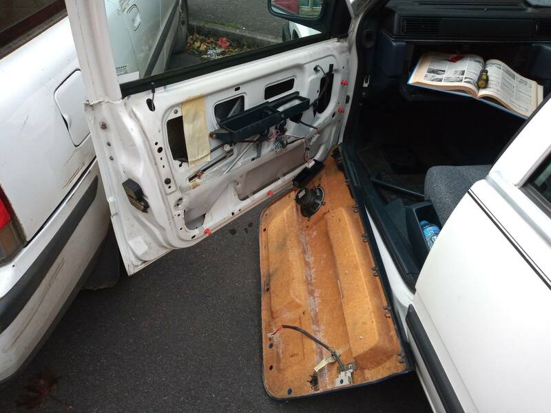

Then I started trying to work out why the passenger side window won't work.
120046118_243170417124535_6846128442666339276_n.thumb.jpg.be1357762cd7a45a2b1ef9c13902a0c2.jpg
120133461_1976805219128425_6969701286473303280_n.thumb.jpg.4f9dbb034492c2777c5c5ec9ea2f4cb6.jpg
Mmmmm. Mouldy.
120100009_436725380625010_1025006701348398994_n.thumb.jpg.03830ff415d10ba80bba3a00f5403481.jpg

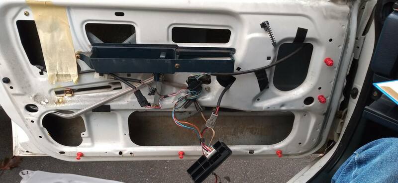

Having wiggled all the wires, cleaning all the contacts and battering the motor with a hammer my electrical repair techniques were utterly exhausted and the window still doesn't work.
If you press up on the switch the motor clicks, pressing down does nothing. This is the same on both the passenger and driver's side switches (driver's side window works fine). I suspect the driver's side switch goes through the passenger side one and that's what's not functioning.
At this point it was starting to get cold so I put it all back together again. I then scrubbed up the interior a bit and cleaned some of the mould out of the door jams/boot surround. It's also parked next to a descendant that is wearing it's years a fair bit worse...

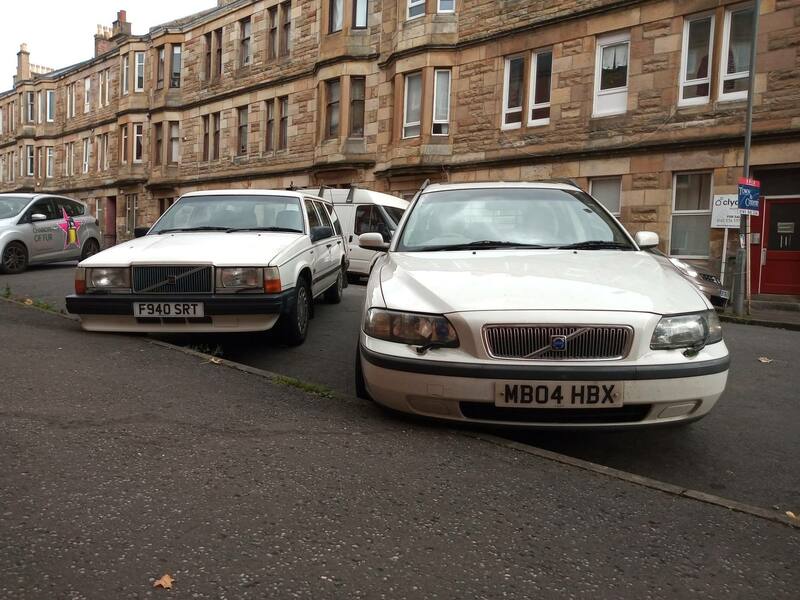

Also, a bonus shot of the Acclaim being tiny in the works car park from Monday.

that rear wiper blade doesn't fully clicked home to me
