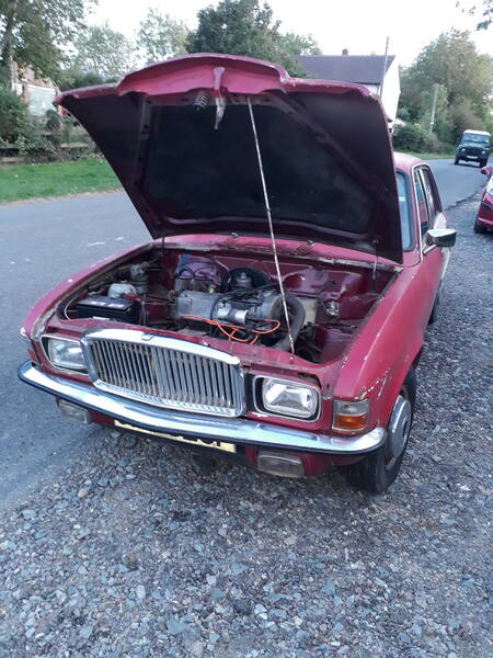

After a few days of top down waftage in the CLK. I returned to chateau 6 tonight to continue the remainder of tuesdays plan of taking the VP back to mine for a cheeky tickle with the sparkle stick.
Coffee consumed, keys exchanged and i hit the road.
30 seconds later

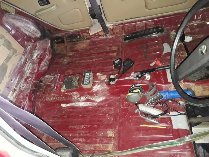

Thankfully just a slightly misleading fuel gauge resulting in lack of juice. A quick dash to the station for a jerry can of tescos finest and we was back on the road and from then it was plain sailing.
Interior was cleaned out and the damp carpet / seats and woodlice removed.
Whilst its probably possible to weld it up with this in place id rather not have the same experience someone whos  previously welded on it had! Crispy.
Stripped out and all the fluff from the insulation stuff removed.
Ha, is that a jumper stuffed in there? Dare you to wear it...
I pulled it out,  its 3 pairs of knee height socks!

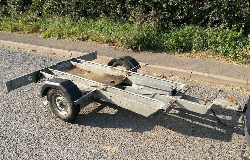

I have just read a post on FB of a friend enjoying croquet and fizz in the sunshine this afternoon , me I bought a motorbike trailer!
The seller asked me why I was buying it but I could not give him a good answer.

You do have several field bikes... 🙂
