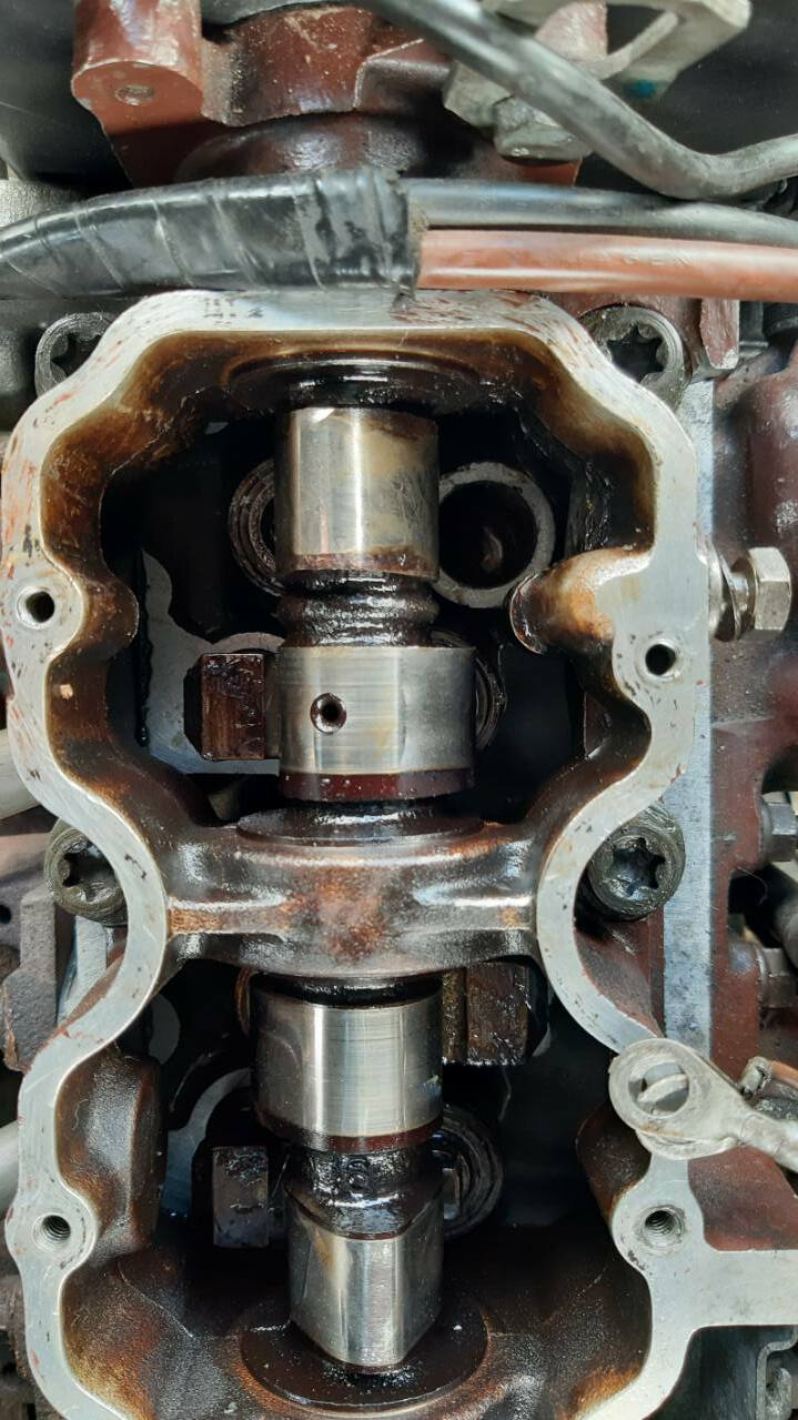

Well, after looking somwhat further into this, the "misfire" has very much been found:
On 4/20/2021 at 11:37 AM, Talbot said:
Followers and stem caps fitted with a swipe of grease to hold them in place.
AHAHAHAHAHHAHAAAAA FAIL.
It's not hugely clear from the photo, but what you can see there is the top of the Hydraulic adjuster (which is the "fixed" fulcrum point for the rocker arm) and the rocker arm that has come off the fulcrum and is now lying sideways, jammed down the side of the hydraulic adjuster and the valve spring.
The exhaust valve wasn't opening in the slightest.  That means the exhaust stroke of that cyliner wasn't actually exhausting, it was simply re-compressing the hot exhaust gasses, the inlet valve then opened and a blast of hot exhaust was shooting into the inlet.  That was then being drawn into other cylinders, meaning that when they ran their compression stroke, the mixture was already massively over-hot, so it was pre-igniting in a fairly massive way.  Hence the very nasty knocking, and the rather random nature of the knock.
By disconnecting the spark plug on Cyl 1, it was no longer firing red hot exhaust gas back into the inlet, meaning there wasn't pre-ignition happening randomly throughout the engine.
So, it's cam cover off, and get the rocker out.  Got the hydraulic adjuster out as well to check it for damage (thankfully none found) and luckily the only damage anywhere was a tiny dint in the very end of cylinder 1 exhaust valve lobe.  It's majoratively on the area of the lobe that has clearly never contacted the follower, so in terms of the engine it will make sod-all difference.
At this point, there's two options:
  1. Take the cam carrier back off again, which means removing the head bolts.  That then leads to the thought of do I just wallop the same bolts back in again without disturbing the head, re-compressing the gasket?  That also would mean completely stripping the timing end of the engine again... something I have zero appetite for.
  2. Use the tool mentioned by Andyrew previously and hope I can get the rocker/follower and hydraulic adjuster back in, on the cylinder with the least space to work in.
1 is off the table.  So it has to be 2.  Quick message to Andyrew, and by utter luck, the tool needed is instantly to hand (it could have just as easily been buried under 2 tonnes of "stuff"), so he brings it up.
an hour later, and after some rather fiddly and careful work, the adjuster and follower are back in.  The basis of the tool is that you end up compressing the valve spring *much* further than the cam would ever do so, meaning it's as far down away from the camshaft as possible.  The rocker follower goes in next, but pushed over to one side (and on it's side) to keep it out of the way while the hydraulic adjuster is dropped back in.  Then with varous bits of pokey wire, needle-nose pliers and a lot of fiddling (and a modicum of swearing) the rocker can be manipulatied back onto the fulcrum.  The tip of the rocker can then be carefully lifted up and the tip follower (which goes on the end of the valve stem) gently put back in.  After checking that everything is lined back up, the tool is removed *VERY* carefully, putting the spring load back on the follower and keeping everything together.  This has to be done absurdly carefully, as the rocker/follower and valve stem/tip follower will fall off at the slightest provocation, and I couldn't get any more grease in there to stick it all together.

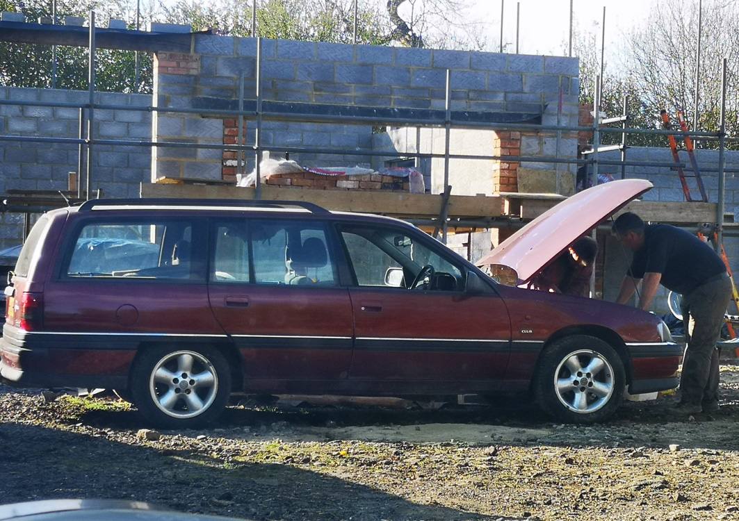

The strange hosepipe activity was not punishing the car, but to flush the brown gung out of the heater matrix.

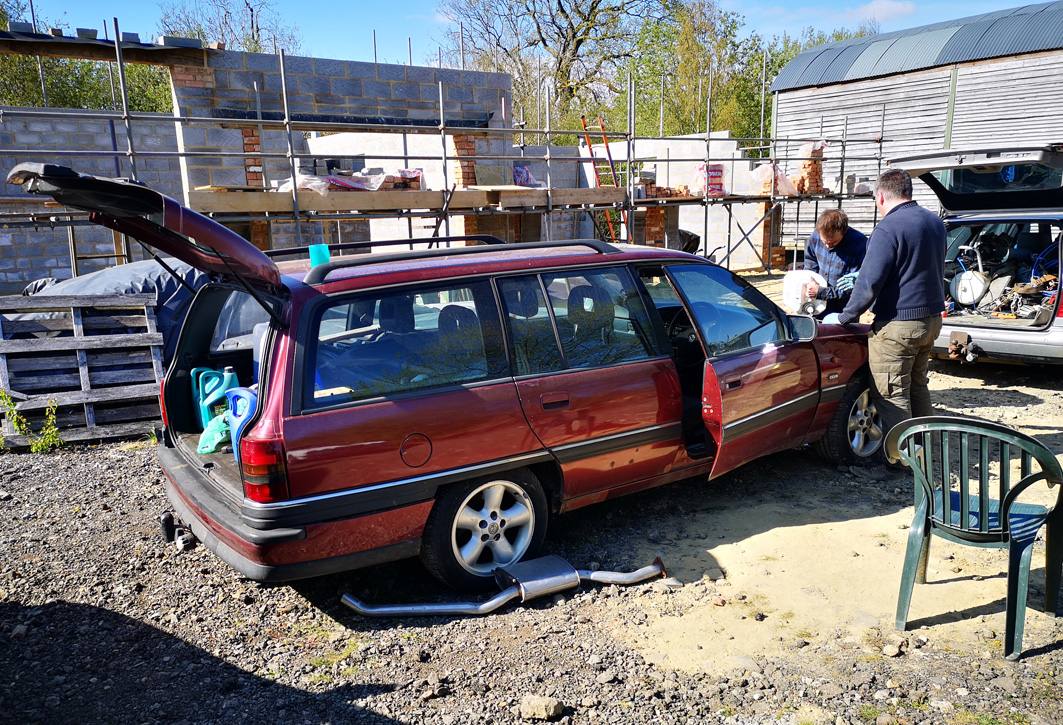

Worth noting that the car was running with about 1/3 of an exhust system at that point, so the slightly spluttery nature of the engine running on 2-year old petrol was significantly accentuated.
After driving it a few hundred meters, it did clear up somewhat.  Still needs MOAR exhaust pipeage.

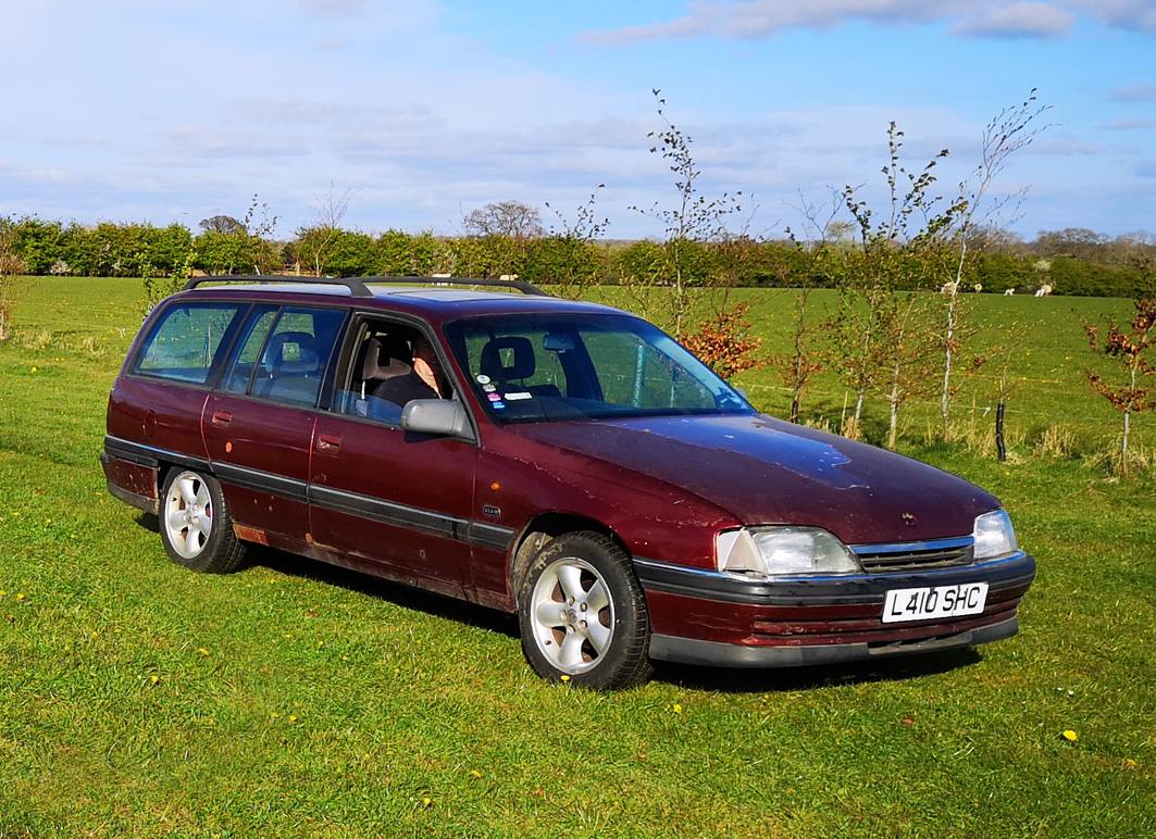

It's quite odd to think that there's only 17 years between these two cars.  That's less than there is between a 53 plate car and now.

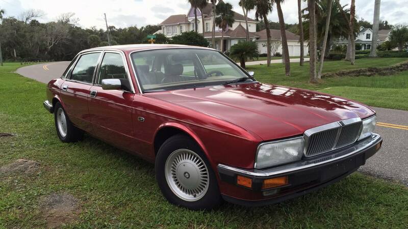

Then a 1993 XJ6 has a family look to a 1976 car.
