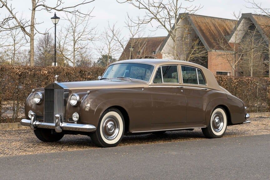

What about painting it Sand and Sable like a baby Rolls Royce ?1681482702643963ce0b62c_dsc07241.jpg.f80faeea920fdc885820b4f5281beebf.jpg485aaf80-551c-421b-a243-cd60cb4f73a4.jpg.b44310f294f5ec5589505b958991a4a9.jpg

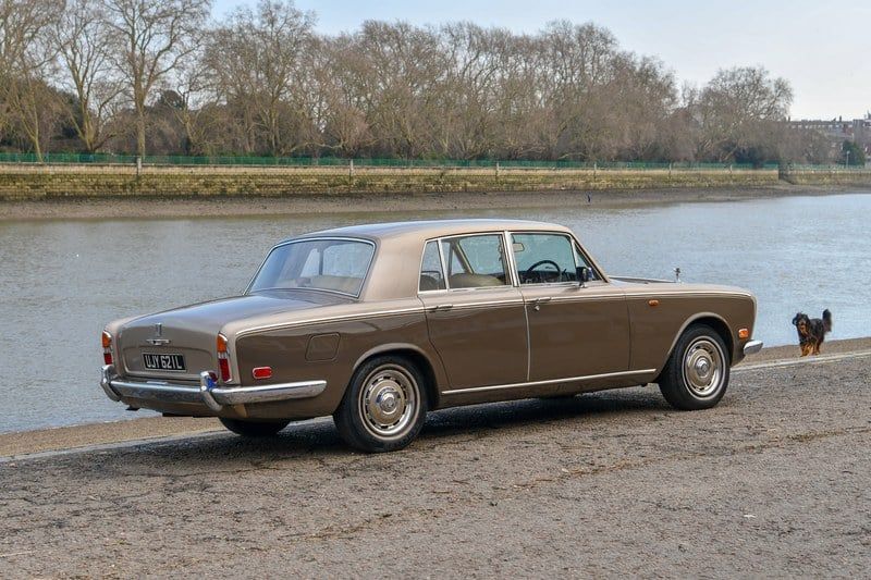

As you have dark blue seats now then maybe the Rolls-Royce scheme of Silver Mink over Seychelles Blue would be suitable

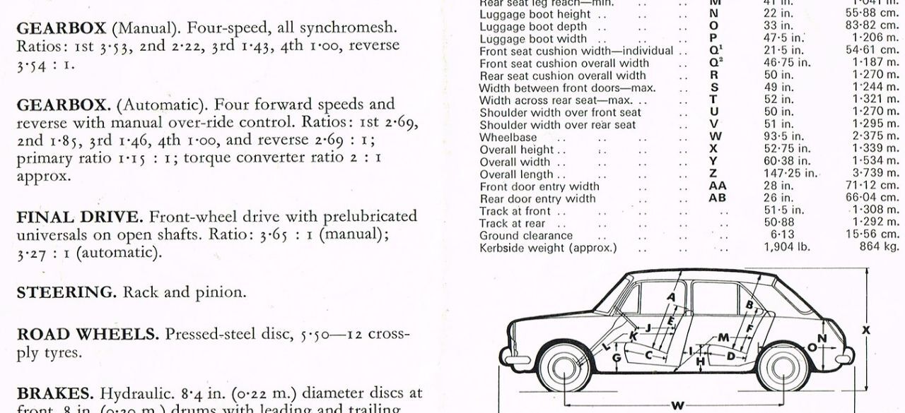

Interesting.
That would suggest the auto should lower revving at speed with its 3.27 diff.

21 hours ago, N Dentressangle said:
Interesting.

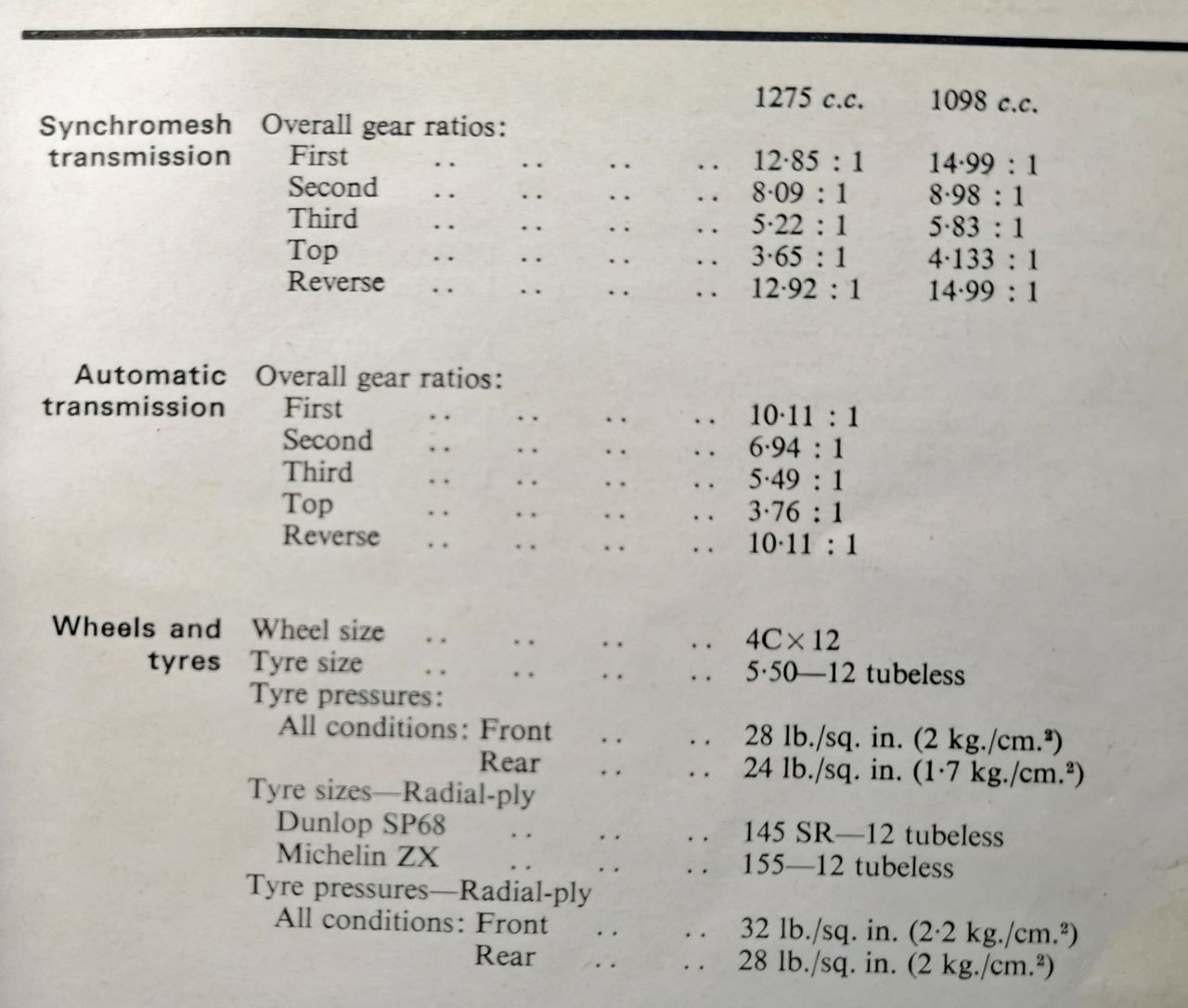

The handbook for my 1968 Morris 1300 Mk2 says overall gearing for the manual 3.65:1 and 3.76:1 for the Automatic so not much in it.
I can't find an exact data match to my manual Morris 1300 to be sure of the mph per 1,000 rpm, but 16.7 mph/1000rpm seems to be a common one. That makes sense peak power 5,250 rpm and listed top speed 88mph. I cruise at 60/65 mph and it seems happy at that.

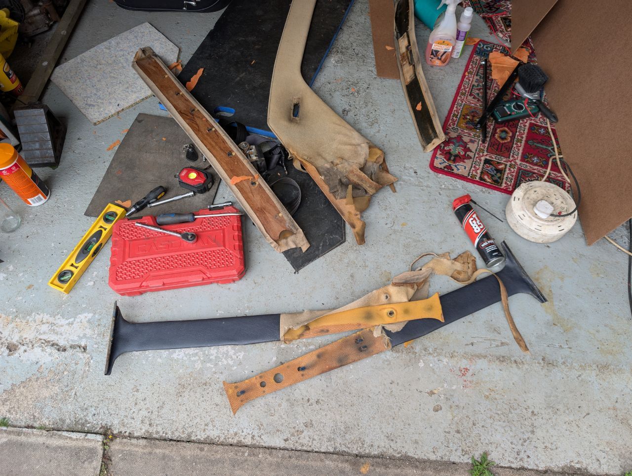

Bit of an update. One that should have written a while ago but simply not had the time or energy to sit down and write it.

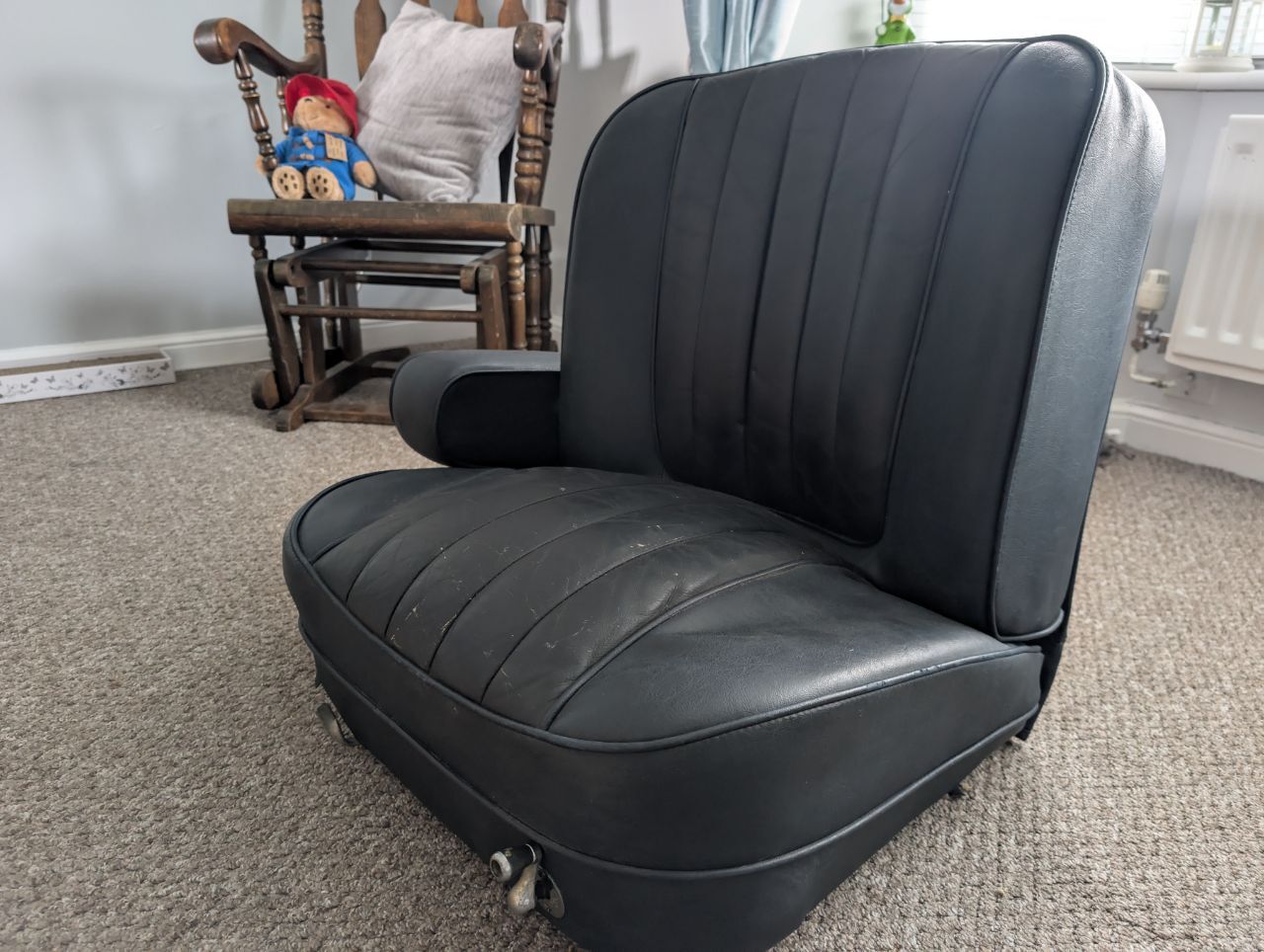

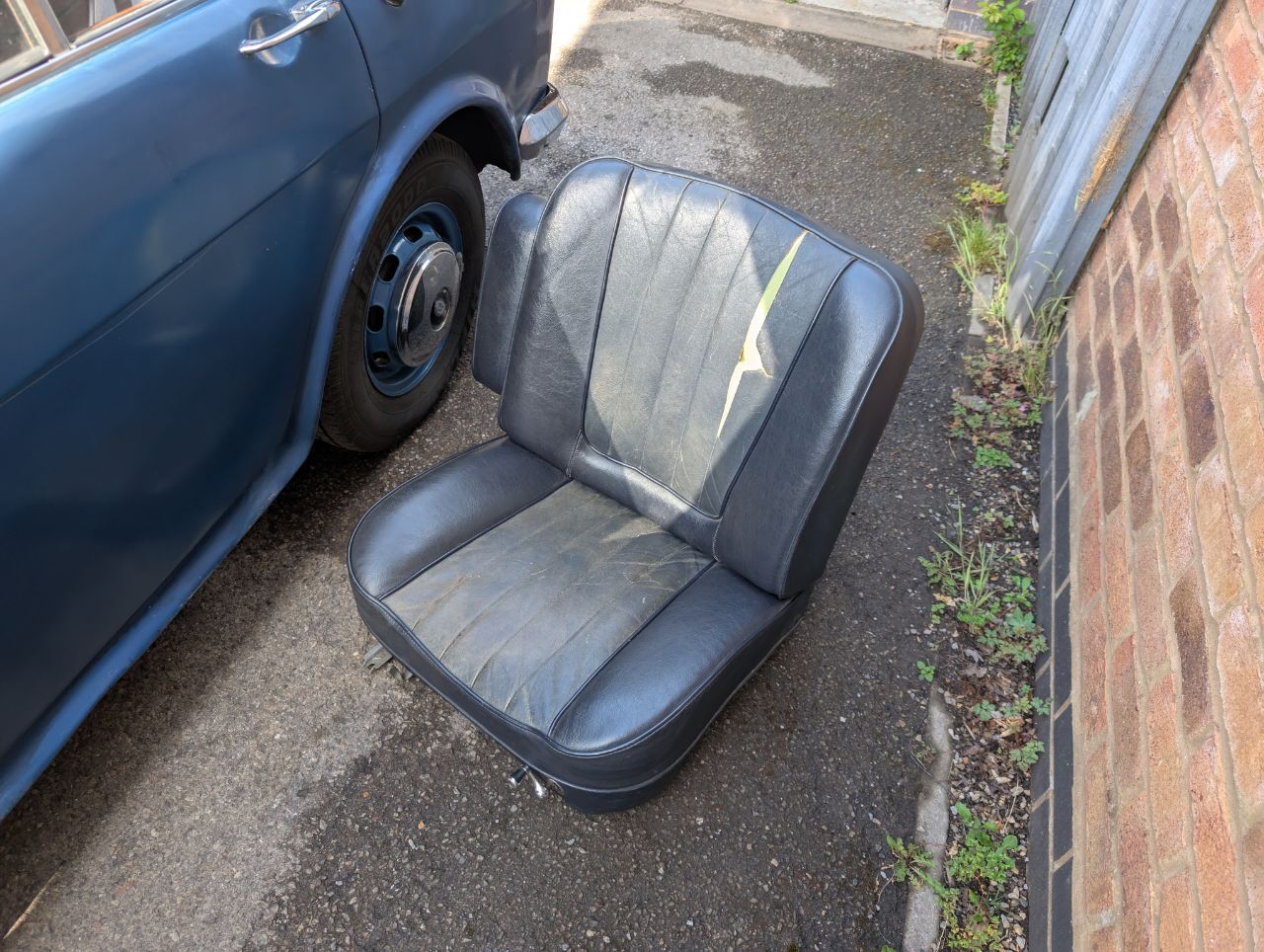

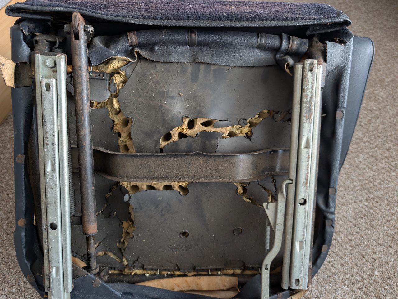

I gave the replacement seats a good clean and also looked at how bad the seat membrane was.
It was knackered.
Foam was alright though

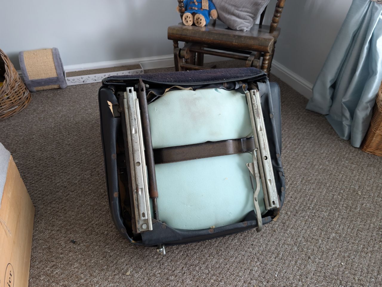

Replacing the seat membrane involves pulling the seat apart and I didn't really want to do that while risking damaging the seat material.
Instead I shoved some upholstery foam in with a bit of wood to provide support.
Which ended up with a comical amount of bugle in the middle.
Taking the wood out made the bugle less of an issue but just less hardness to the seat. Tbh it's just fine and stops the original foam from bottoming out.
I then took the old ones out. These had actually a membrane in decent condition. But trying to get this out and fitted into the old would almost certainly be a massive fight without disassembling the replacement seats. Plus the membranes have lost a lot of their elasticity anyway.
Old seats fabric is knackered. I've put them on Facebook and on here if anyone wants them. No interest so far, so unfortunately they look destined to the tip.
Removing the seats is pretty straightforward. Four bolts - two front, two back. Driver's side has seat runner extenders on. Iirc Andyrew put these in as his mate he went to Scotland with was too tall for the full back position.
I also took some time to give the carpet a good hoover.
I was rushing to put the new ones in as my in-laws were arriving and I knew my FiL would want to have a go in it (he's insured on my classics). In the event, I didn't get it done in time.
After they left, things escalated quite quickly.
I removed the seats again and ....

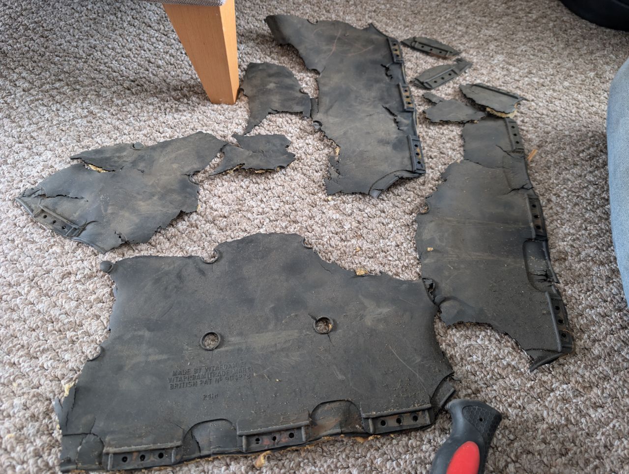

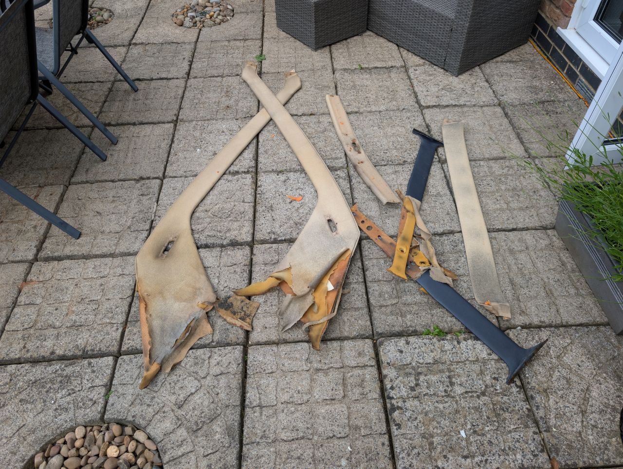

... decided to rip out the entire headlining and shoulders up of soft trims.
You can see the half arsed factory paint job where they didn't bother doing all the ceiling and other covered areas.
Rear view mirror was only the slightly fiddly bit of hard trim piece to remove. After a bit of fiddling I found I needed to remove this cover first and then the mirror could be pulled off.

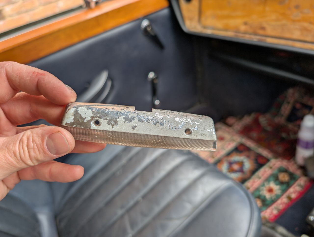

I need replacement interior lights. The plastic chrome has completely buggered on all three. I did try chrome spray which has taken it from 1/10 to 2/10 and still looks shite.
The ceiling board I tried really hard to keep intact but it unfortunately snapped when trying to get it through the door aperture. Officially it should be removed through the rear window but sod trying to replace a window seal especially with modern rubber quality.
The top headlining was filthy. We did attempt to clean this with a Vax spot wash but all it achieved was loosening the adhesive between the two.
I was fearful after that the backing material might have been asbestos. However it burnt pretty easily so I assume not? Felt like rockwool type material and itchy as fuck on the skin.
The side trims give an idea of how knackered the headlining was. I think a combination of moisture and mould deteriorated it. Definitely not worth trying to repair as there was nothing worth saving apart from the backing board.
This is the primary reason I did this job. Knowing replacing it would substantially improve the niceness inside the car.
