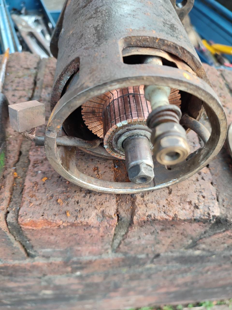

jonathan_dyane Posted October 26, 2024 Author Posted October 26, 2024 To update things to date... My new starter brush springs arrived. It transpired they weren't identical to the originals but with slight manipulation close enough. I cleaned the commutator and the inside of the body/magnets with thinners and reassembled. I had measured the brushes and they were fine. Put it back together and it worked great. HOWEVER when I had reassembled it I noticed that there was corrosion on the magnets and initially the commutator bound on them before I gave the magnets a further clean with a suede brush. Unfortunately I have discovered that when the car is left the starter 'binds up' and I have to free it off with the square on the end of the shaft before starting. I suspect the best approach to this will be to dismantle again then clean up the magnets with emery then maybe paint them with something heat proof? Any suggestions appreciated! After getting her running again I went for a run and it rewarded me with periodic thick whitish smoke. Given the disappearing brake fluid clearly this is the servo being knackered... The other day I whipped off the back drums and (unfortunately no photos) found everything serviceable in there, plenty meat on the shoes and wheel cylinders are recent replacements which is great. I also pulled out the old radio. A look inside it didn't show anything obviously blown or melted, it may be repairable but not for me. It will probably go in the bin unless anyone wants a project in which case it's yours FOC. They were high end receivers back in the day, I think it's a Radiomobile 601. It is however positive earth only. I decided I shouldn't really drive it until I replace the brake servo but today was such a nice day I decided to go fill up with petrol then stop at a nearby country pub. Unfortunately about a mile from home it was apparent the brakes were binding badly. I managed to limp into Asda car park and wondered how I was going to get back home. Helpfully I had brought a comprehensive tool kit. Yes like an idiot the only thing I had with me was a miniature adjustable spanner. I decided to see if a hard brake application would help release things. Naturally this succeeded only in locking the brakes on more firmly 𤦠I then gave the servo cylinder a good wack with the spanner. Naturally this achieved nothing. With nothing to lose I then decided to see if the adjustable spanner would loosen one of the hydraulic pipes into the servo. Remarkably the pipe loosened and brake fluid under pressure was ejected and I found the brakes had released. I was then able to limp home without using the foot brake (before anyone asks this was a reasonable course of action because the foot brake was still in operation and full braking was available to me if required although they would probably have locked on again). Definitely new servo time. Saabnut, Yoss, Surface Rust and 10 others 13
